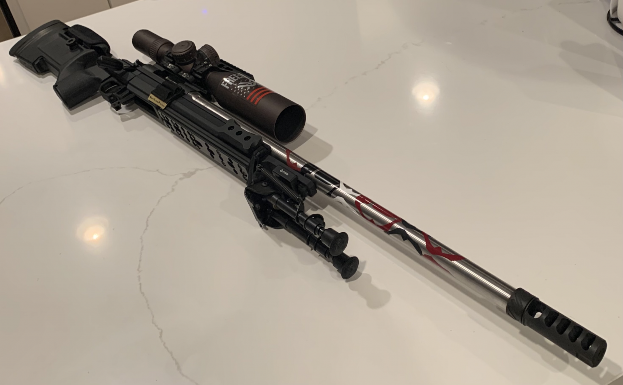

Just wondering if anyone has added weights or anything with significant load to the front M-lok slots of their KRG Bravo? I've contacted KRG but basically said they never tried so can't guarantee anything. Just went with a lighter barrel looking to add roughly 1lb(.5lb each side) up there.

I was talking about the mlok on the sides. I know the arca on the bottom is also bolted to the chassis, but on the side it's just polymer area with no support on the top, front, or back. Wasn't sure if it would cause the stock to crack or shift.

I already have the t-slot weight but just want to be able to easily switch from hunting to bench. I figured forward weight would balance better without adding too much overall weight. Switched to a superlite 6.5prc barrel so it's a little rear heavy with the scope.
The M-LOK weights work fine on the side, just don't over-torque the screws or they could pull through the polymer.
Apply blue Loctite to the M-LOK screws, attach the weights, but stop at snug/solid on the screws and let the Loctite dry and do its thing.
