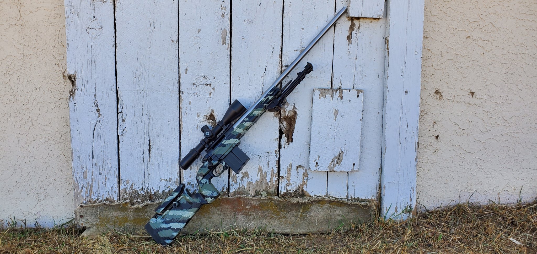

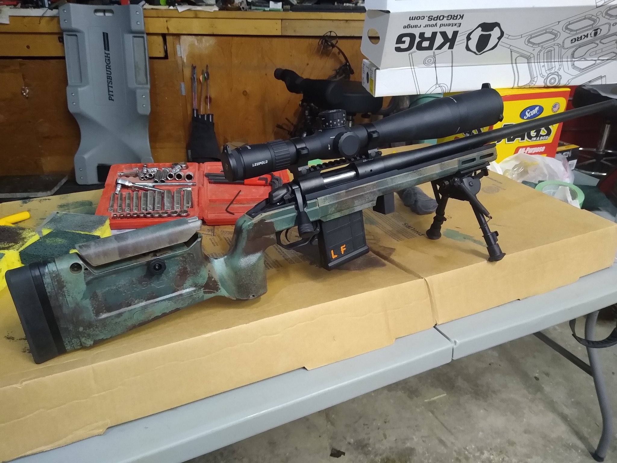

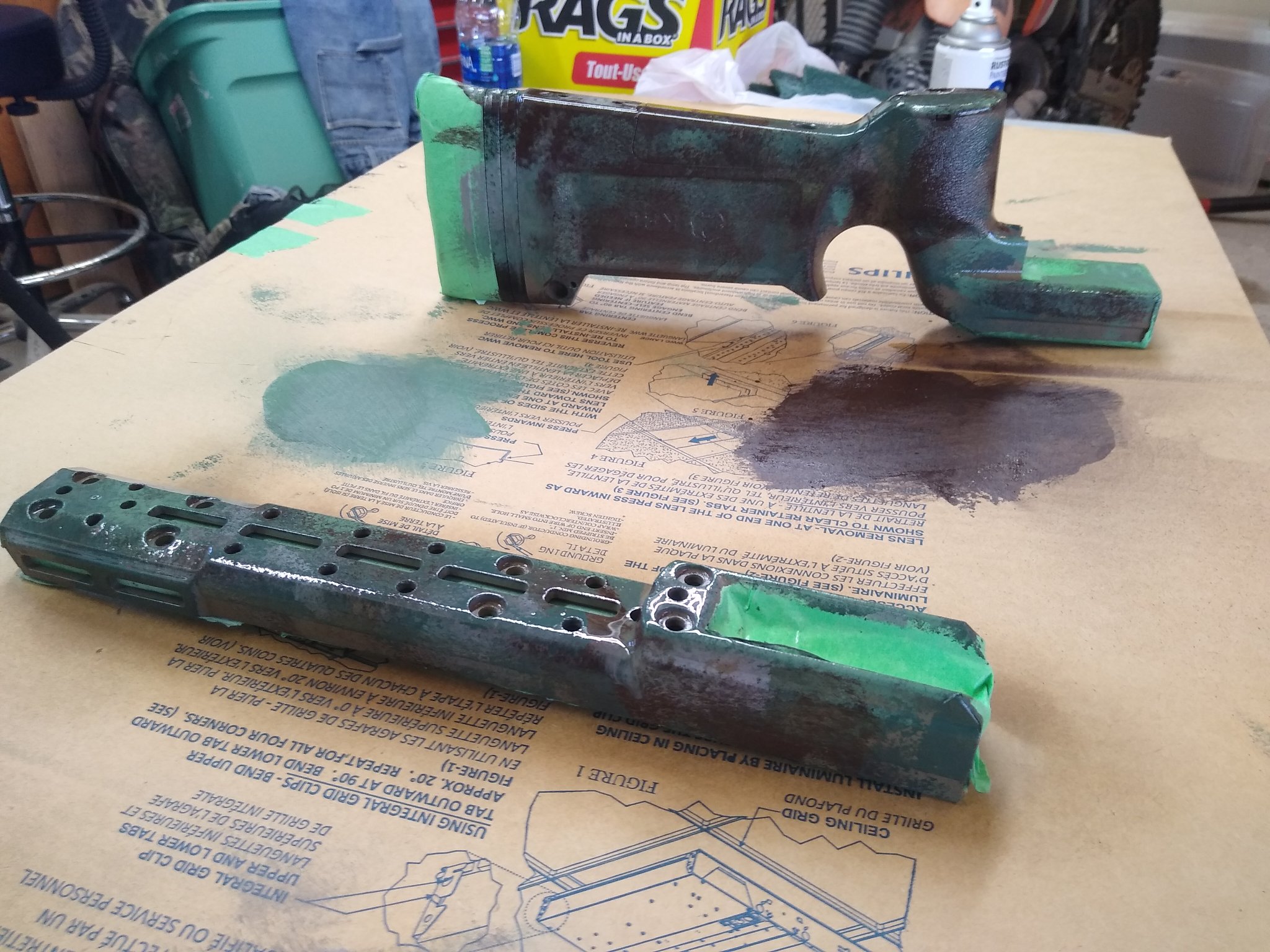

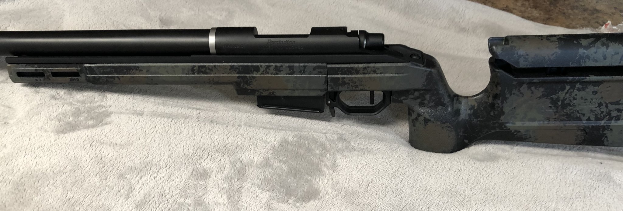

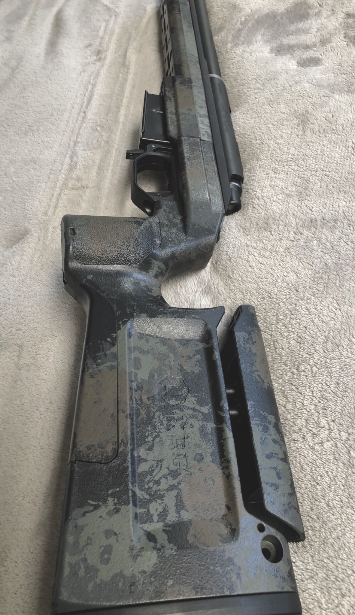

Well I've been getting a lot of PMs asking about how I did the paint job on my Bravo. If figured I'd do a write up and make an easy spot for others to find and reference. I have a few other stocks laying around and would be willing to make a video if need be.
I'm happy with how this turned out and it was beyond easy. So here's what I did.

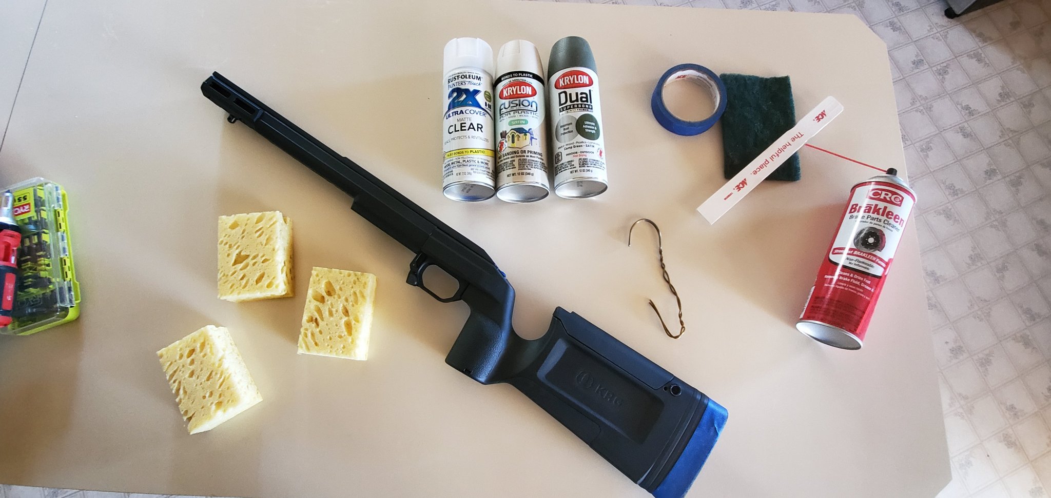

Scotch bright green pads
Brake cleaner
Tape for the inlet and anything else I didn't want to hit.
Sponge that I found at ace. Some people say you need a natural something rather sponge but really anything coarse that will hold paint.
I scotch bright everywhere especially on parts where the paint is naturally thinest like corners.
Hang it and blast it off with brake clean.

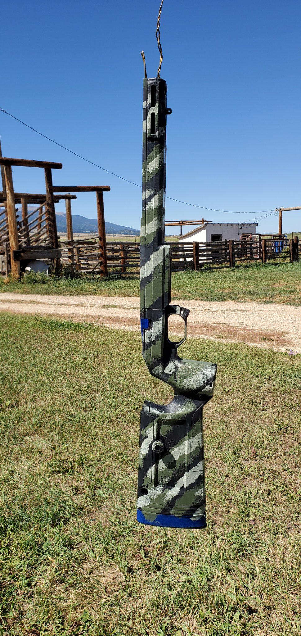

I mixed some paint just to get it the way I wanted and dabbed it on with a sponge I had cut into a narrow wedge (may 1 1/4" wide) , trying to follow the same angle all the way. I had one where I either got too much paint or pressed too hard and it dripped but it was easy to fix. Lesson learned.
As long as you're happy with how it looks you dont need to worry about multiple coats because the clear coat will add strength..
I let sit between coats maybe 25-30 minutes. The paint will go on thicker than it would if you were to spray it on so give it some time.
Things to note:
The base is the black stock and not paint. The scotch bright will scuff it up ever so slightly but the clear coat will fill the scuffs and get rid of any chalky color.
The bravo stock takes paint extremely well, testing my pattern on some glossy cardboard was discouraging but the stock was much more forgiving and held the paint much better.

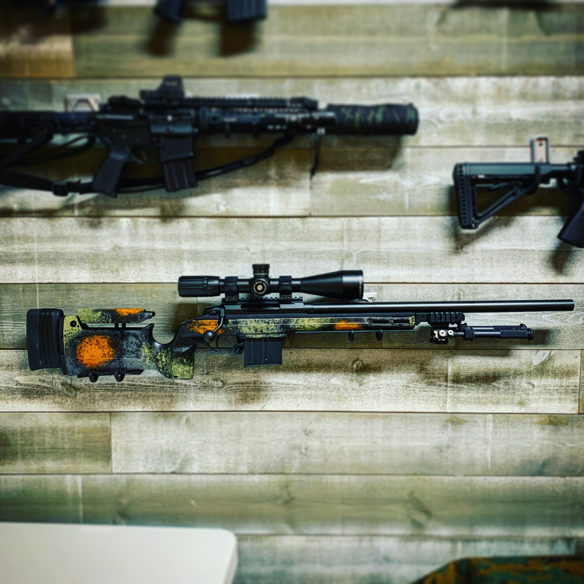

This rifle inspired me to do one and I had a big plan to pretty much copy it. I practiced on some black plastic trash cans but once I started the plan went out the window and the rifle became what it wanted to be. I like it more than the plan I had. Lesson is just go for it, you can always sand it and start over if you don’t like it. Key for me was getting the right sponge and getting the hang of how much paint/pressure to put on it to get the desired effect.

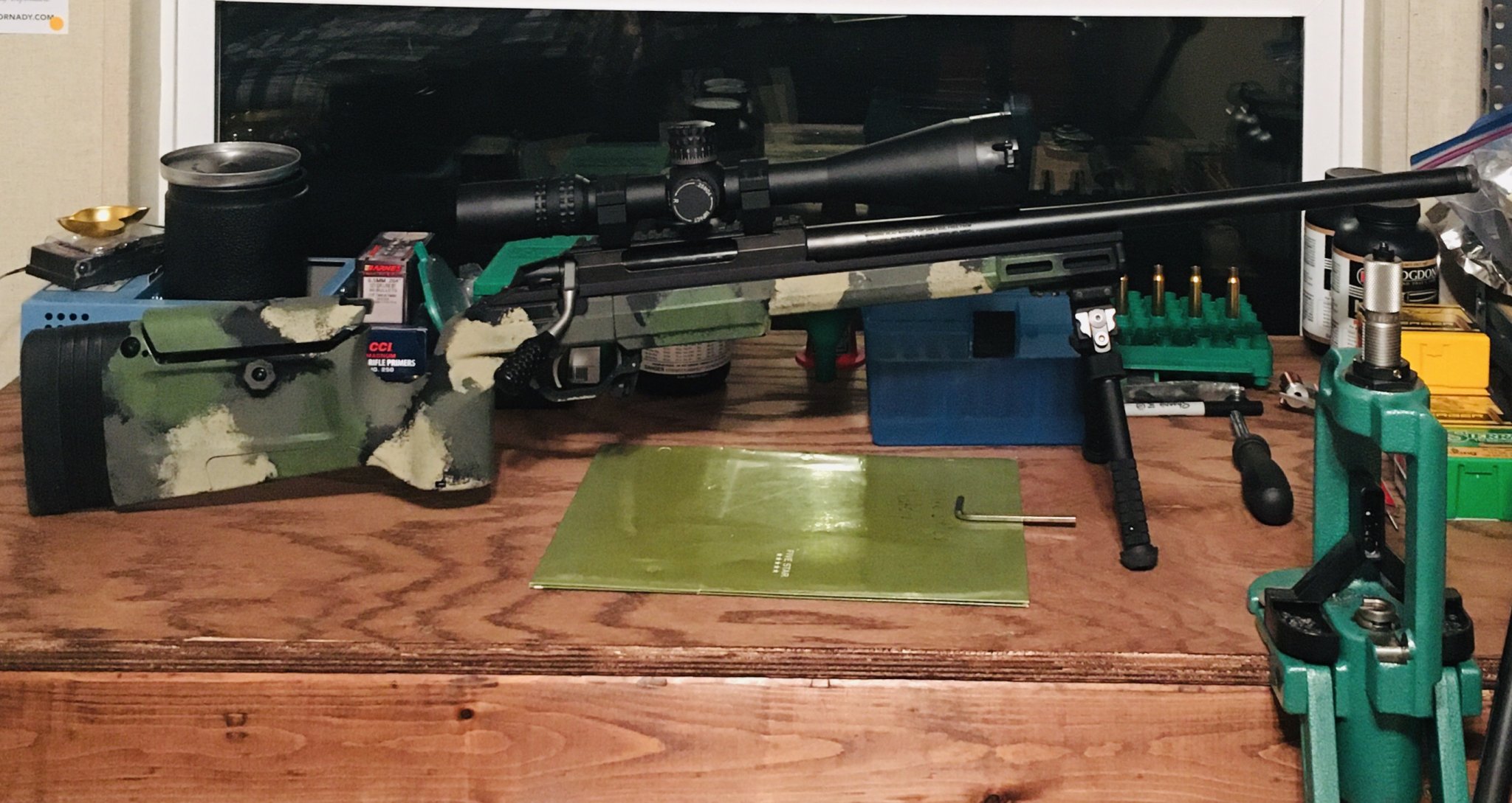

Green, Khaki, gray. Put it on with a car washing sponge.
Oh ok. Trying to get that worn look a little faster?
Naw, just going to hydro dip it when it wares out.

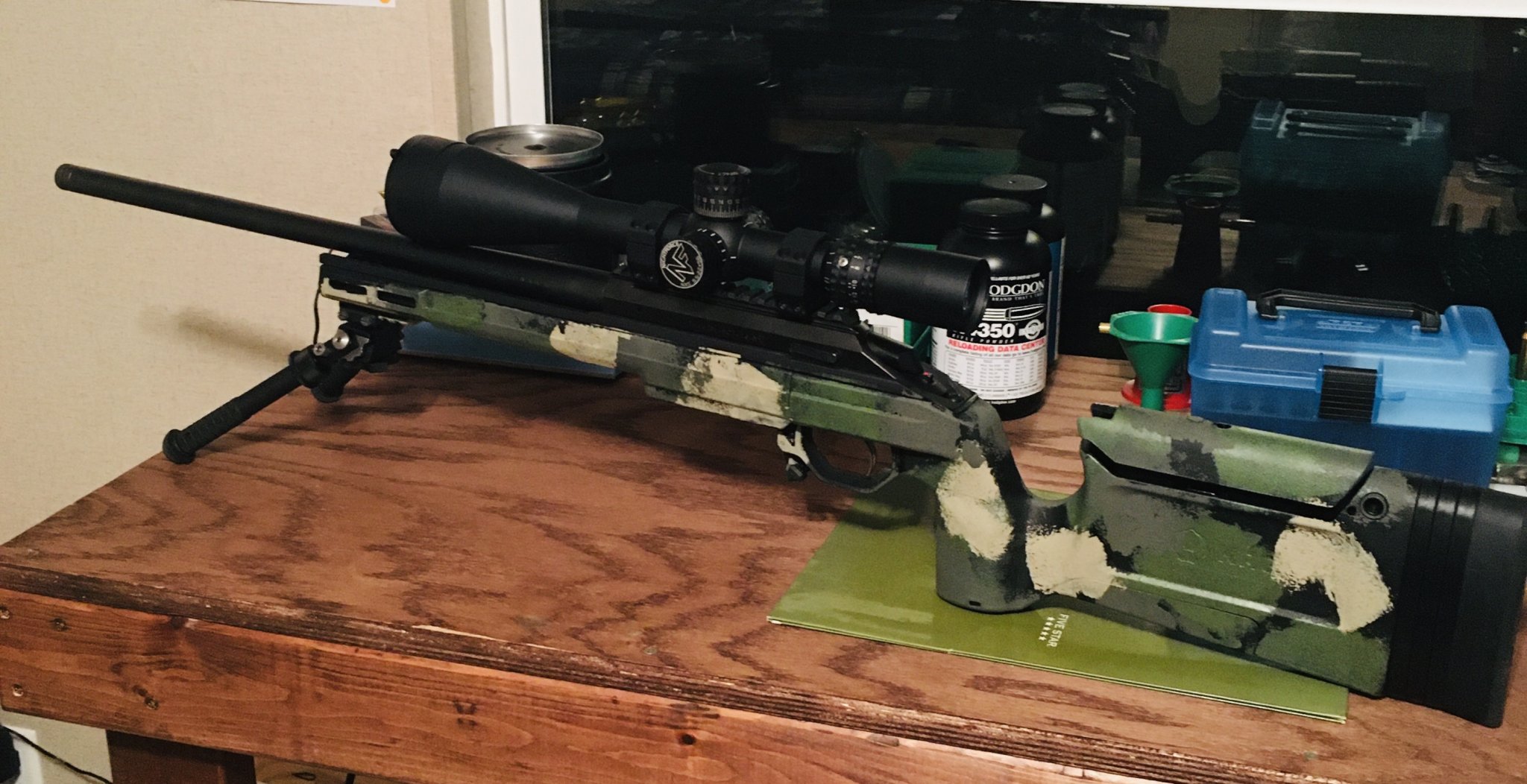

I let my kids loose with the sponges. They decided to smear, dab, and generally randomize everything. It's not boring anymore so I'm happy, and they were excited enough about gun arts and crafts we need to paint up a few cheap ar's now.

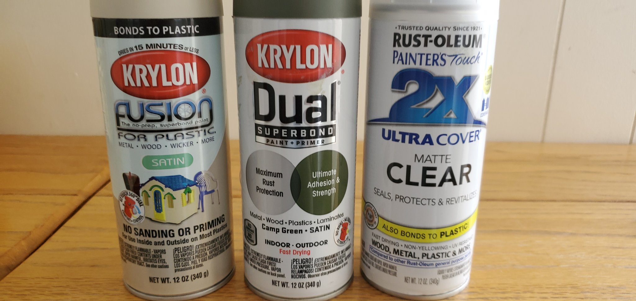

Krylon gray, moss green, hunter green, Walnut brown and matte clear.
They didn't leave much of the FDE, but it's a boring color I figured would be a good base to paint.

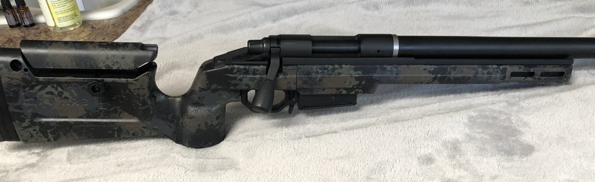

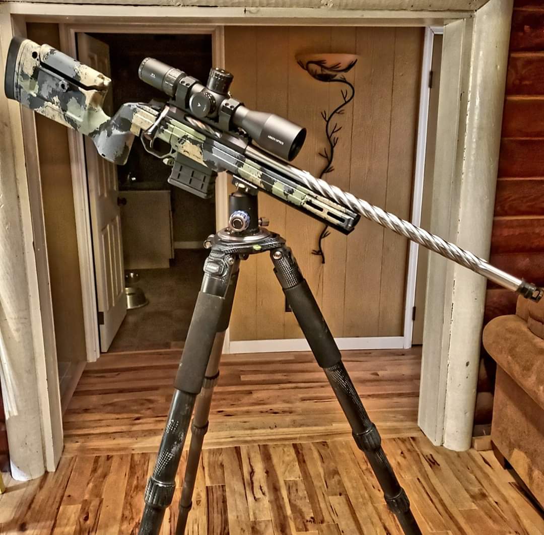

That KRG came out looking great! I like how you did diagonal lines, it looks sharp
