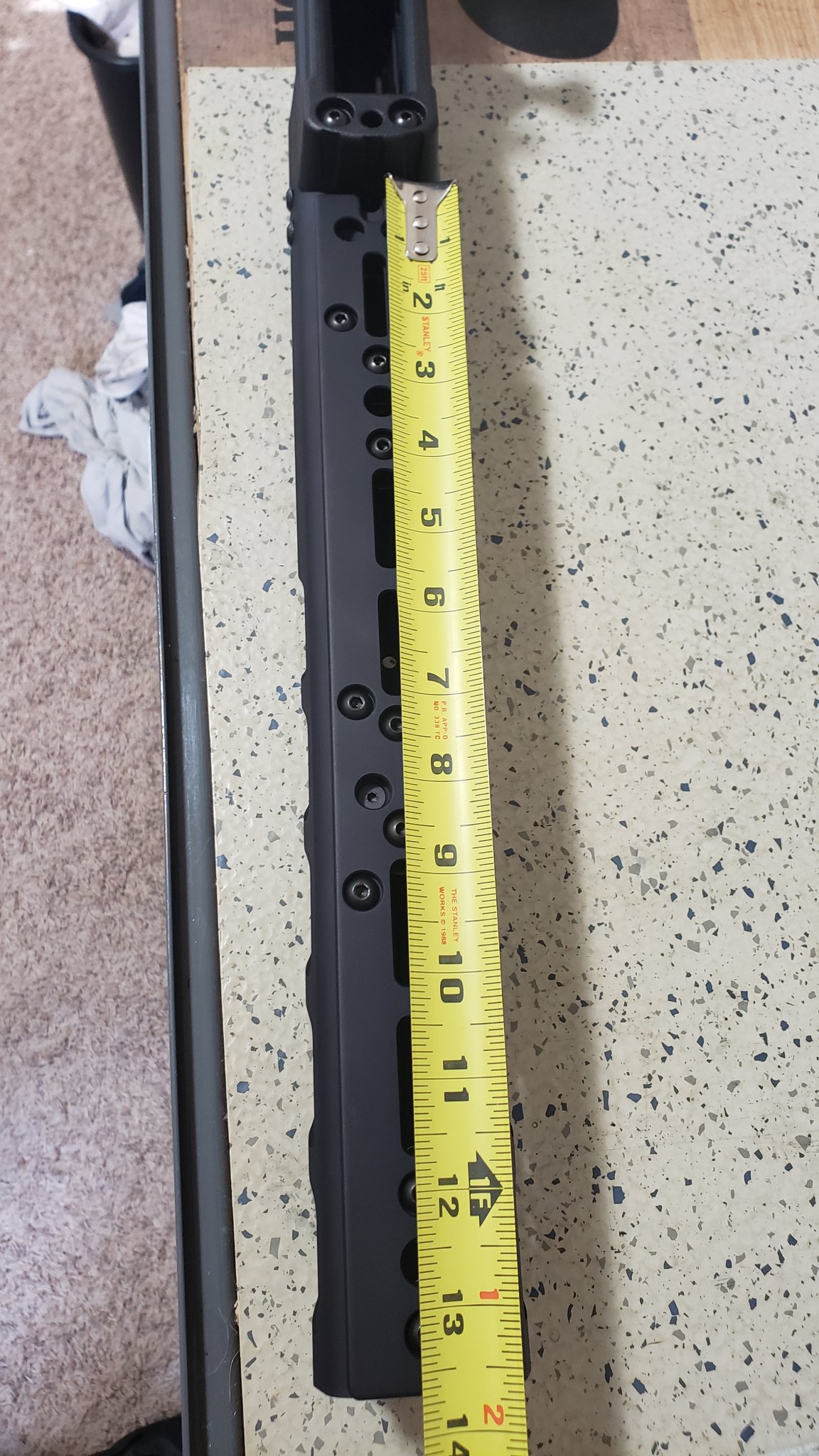

    Can someone tell me what the mounting situation is on the bottom of the KRG enclosed forend. I'm going to get one and I want to go ahead and order an ARCA rail for it but I cant find anything specific as far as the attachment setup. The actual KRG rail is out of stock. I'm assuming its MLok, but I'm not sure and I can't find a length either so that would be helpful too. Much appreciated
    It's mlok.
    Oh shit, totally misread your post. Can't even blame it on bourbon!
    So then it is specific to the enclosed forend and any ol mlok arca rail will not work?
    The only issue you might have is clearing the button head screws that attach the enclosed forend to the chassis. I'll take mine apart and post a picture of what I mean.
    *Edit* nevermind. The button head screws are only for the long action chassis.
    Right under 13.75"
    I'm sure any mlok would work. It's just not how the KRG one attaches.
    Right under 13.75"

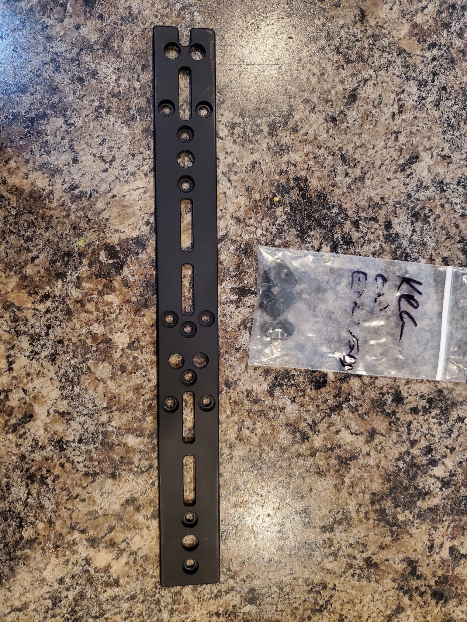

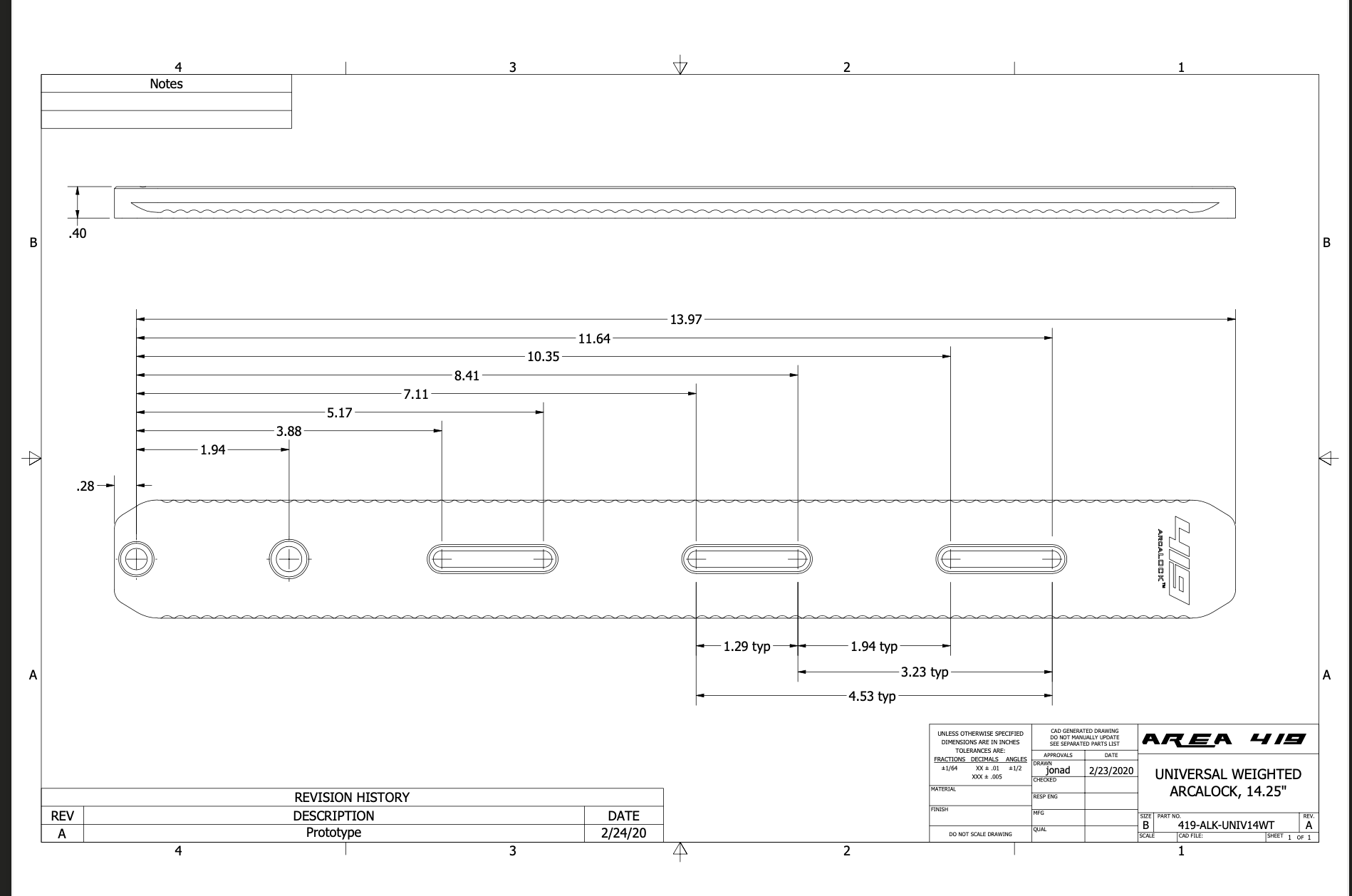

    I found this print on Area 419's website for their weighted rail. Looking at the print, can you make any predictions as to the fitment?

    Please report back. I just got my KRG enclosed rail and was looking to put on something. Area 419 has the 14 inch version. They have showed pictures of it on a Whiskey 3 chassis but not the enclosed forend. Be curious what it will look like. Also if KRG will be getting some ARCA rails in.
    I just got an email back from then (only took like 2hrs !) and they said they don't have an ETA on the ARCA for the enclosed forend

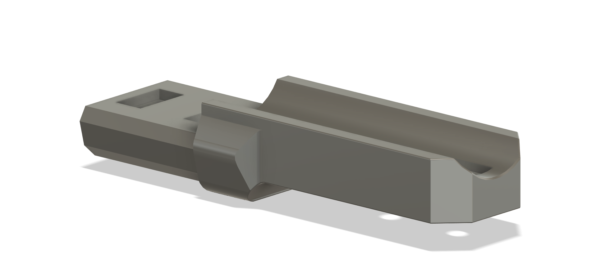

    First time using Fusion 360 and had my buddy print this in PLA+. Uses a slight press fit into the channels in the forend, and is anchored down by two screws and retaining plates from my giant box of KRG hardware. Quite rigid, no complaints thus far.

    Soguys are saying the spigot with the enclosed forend is a no-go, did you have shade tree it or is it actually made to fit? And that's an awesome setup. I was on the fence for like two months over Bravo or W3, which I guess seems odd because they're very different in many ways.

    The spigots are designed to attach to the backbone of the chassis. The enclosed forend is longer than the backbone, and would completely cover the spigot if installed in the designed location. So no, you cannot just add the spigot to the enclosed forend without a relatively significant amount of work. There’s a reason you don’t see everyone doing it.

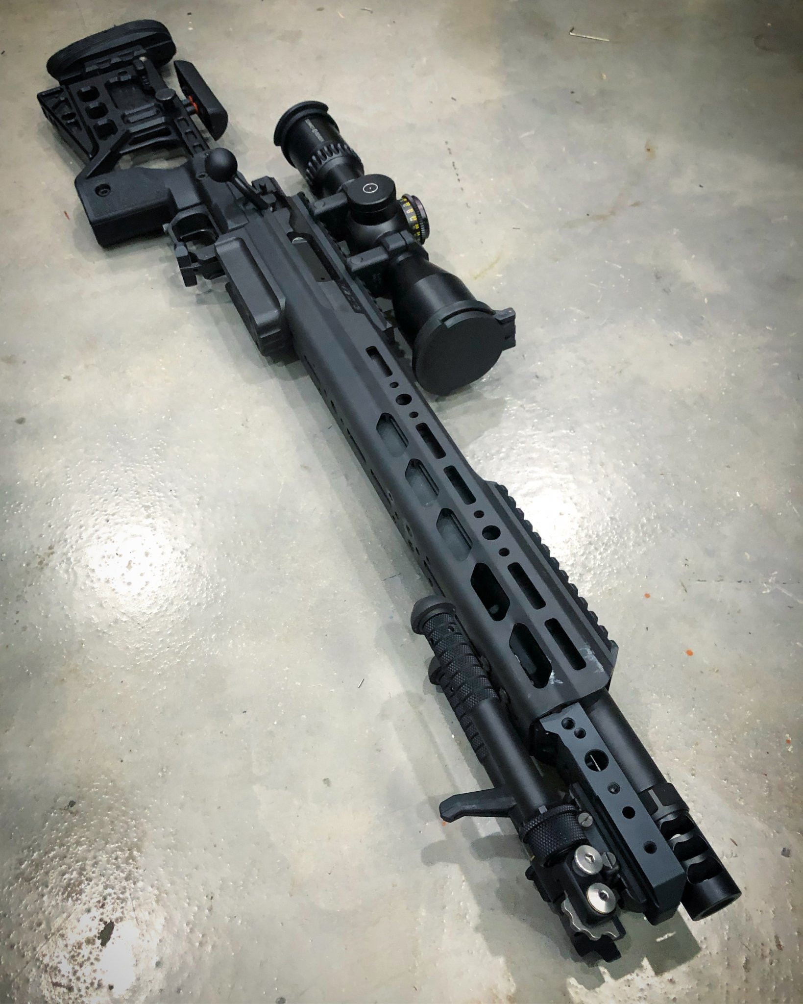

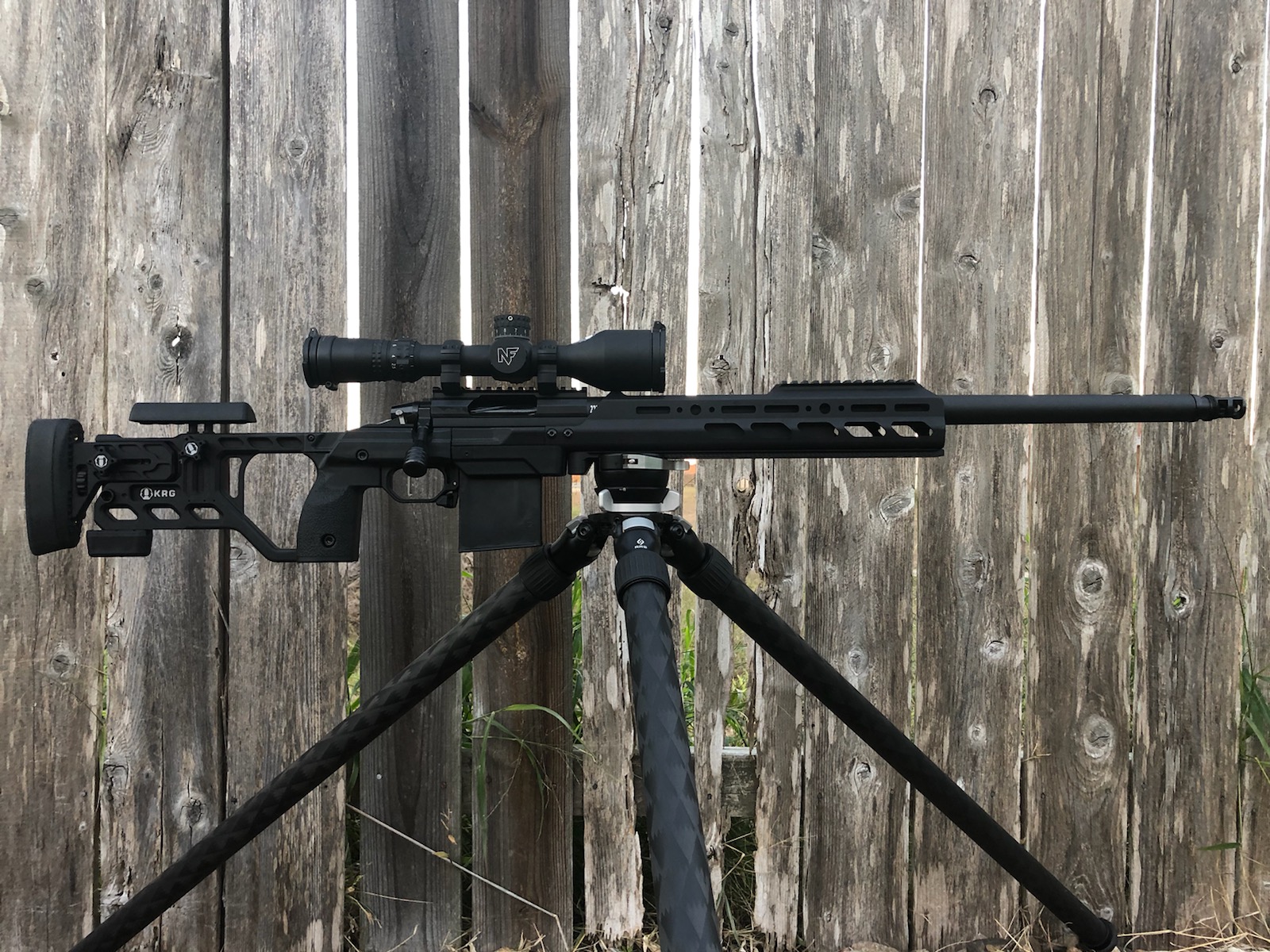

    I have an enclosed forend, myself. I wanted to buy a Sawtooth one because his quality is excellent and I have it on my MDT chassis. They didn't offer one for the KRG enclosed. I contacted Matt @sawtooth and he made me a prototype. They were supposed to go on sale live in March but I don't know what happened. Either way, I'm happy with the prototype he made. I don't use my KRG rail now.
    I may have to message him as that looks exactly what I wanted.
    Yea that's awesome. I sent him a message but haven't heard back but when I do I'll bring this. I'd be happy to pay a ridicules premium just to get the thing
