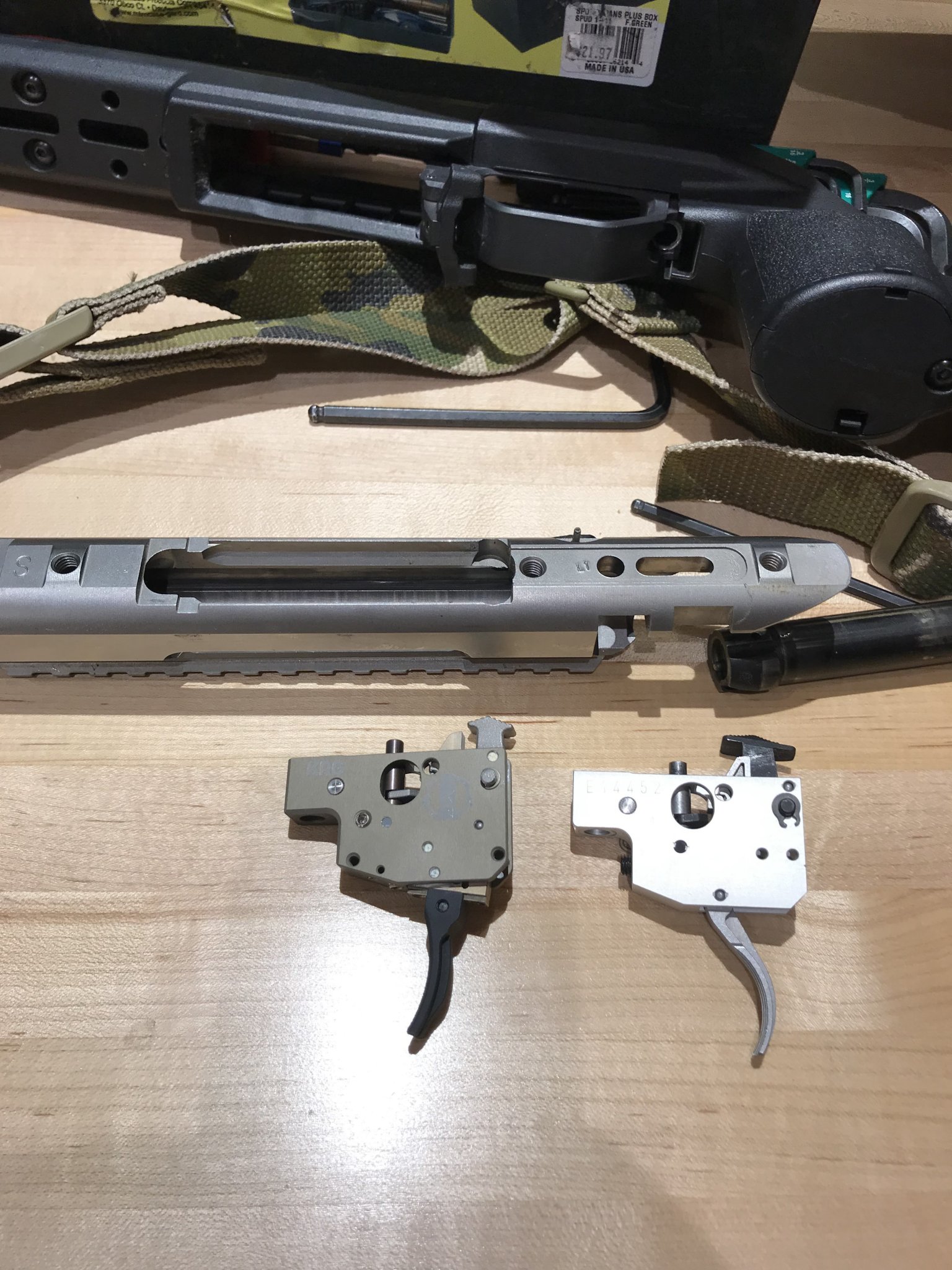

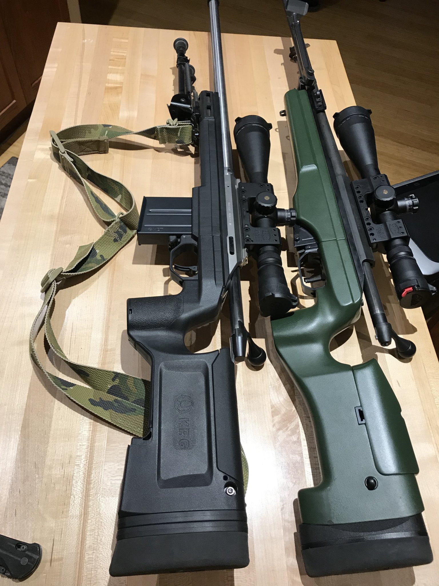

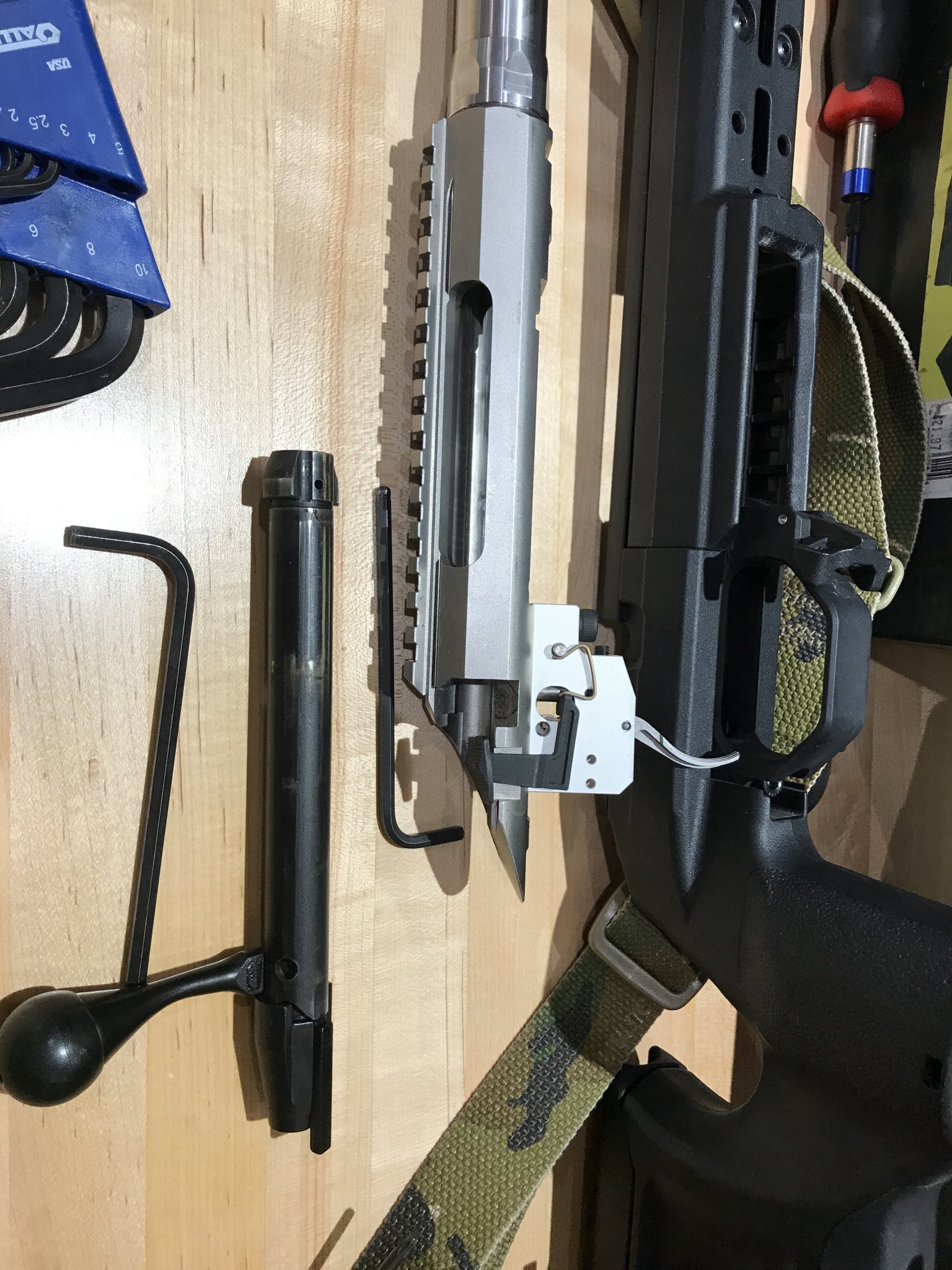

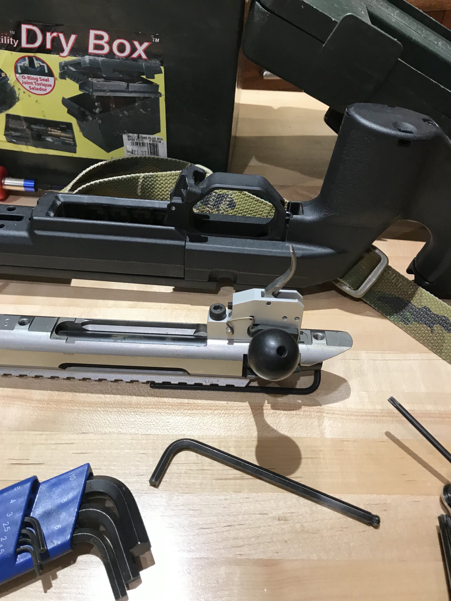

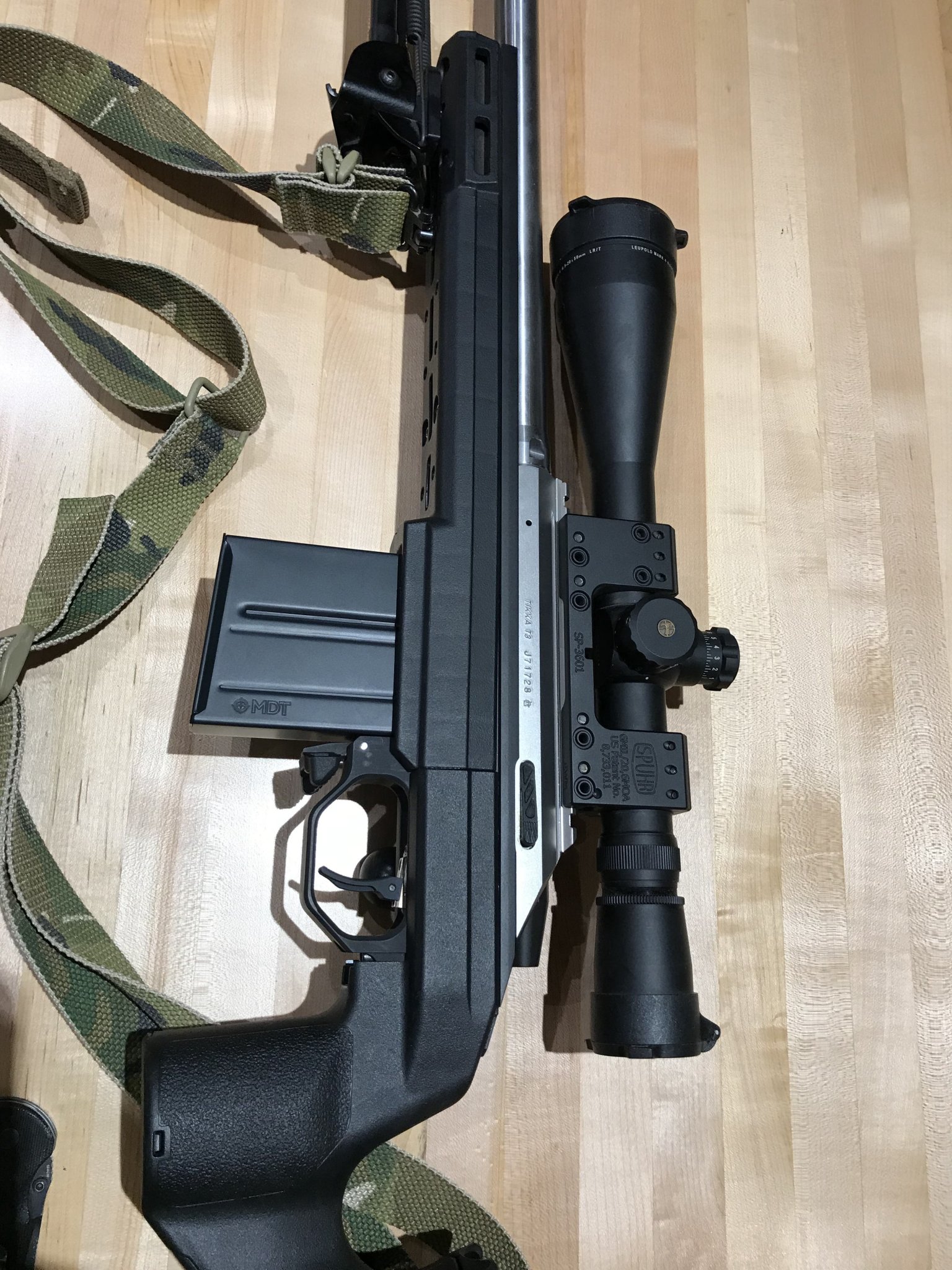

I got my Midas today in the mail. The trigger was delivered in a very nicely embossed tin. Installation was very straight forward and no surprises as far as that was concerned.
My goal with my Tikka build is to get as close in feel to a Sako TRG 22 as I could for as little money as possible. KRG was naturally the vendor to look to for this project. First was a KRG Bravo chassis to emulate the TRG stock and chassis. Next was a Sterk bolt shroud in TRG style. Now finally, a KRG Midas 2 stage trigger to complete the project.
My impression of the Midas trigger so far (30 mins) is that it is definitely an improvement over the factory single stage and the Tac A1 2 stage. I finger banged a Tac A1 at the gun shop and was not very impressed, sure it was a 2 stage, but it was not particularly clean and crisp. Bear in mind I'm comparing everything to a post 2013 TRG 22. I still think the TRG 22 has the better trigger though I am not certain what it is that makes it feel better. I notice that the bolt on the T3 turns downward when the firing pin is released and I'm not sure if that is what I'm feeling through the trigger. The TRG just feels more solid and even though there is overtravel in the TRG trigger, it still seems to feel more definite and crisp. The bolt hardly moves when the firing pin moves forward which is why I think the bolt design on the T3 has something to do with the feel. There is practically no overtravel in the Midas. I look forward to actually shooting this trigger and see if it improves my shooting. My only wish is there be an adjustable trigger shoe that adjusts in multiple axis like the TRG and have a plastic finger piece to make cold weather shooting a tad more comfortable. Not really a complaint so much as I'm really trying to get as close to a TRG as possible. Overall, I really like the new trigger. I'd like to compare to a Timney trigger someday.

Received my 2 today... wanted to compare them to the 2x Timney 2-stage triggers I already had in my rifles.
Disclaimer: I'm using them in my 2 Sako Quads. The Quad and Tikka triggers are equivalent though.
First impressions... triggers look good, sear surfaces look to be ground nicely. 1st stage, 2nd stage, and overtravel setscrews are easily accessed from the bottom, although if you run the trigger shoe all the way to the rear of the dovetail the 1st stage weight setscrew will be covered up.
Trigger shoe feels pretty good, although they were both rather difficult to slide forwards/backwards on the dovetail. KRG decided to have the screw head directly grip one side of the dovetail rather than machining a slit in the trigger shoe near the top and have the screw pinch the halves together like most adjustable dovetail trigger shoes; this means when you loosen the screw there is no "relaxing" of the trigger itself to make it slide easier. I meant to take a trigger shoe off one of my AI's and see if it would fit on the KRG dovetail but I forgot to check tonight.
The KRG trigger has a bolt lock / firing pin block with the safety on like the factory Tikka triggers (which the Timney lacks.) If you don't like the bolt lock, it looks easy enough to remove a c-clip, slide the safety lever out, remove the bolt lock pin, and then reinstall the safety lever and c-clip. You'll give up the firing pin block, but the safety will still block the sear.
Next up... adjustment. Just for a baseline I totally removed the set screws for the first and second stage weight adjustment to see what the absolute lowest pull weight was with no extra spring pressure. One trigger/rifle combo was 1lb, 4.5 oz, the second trigger/rifle combo was 1 lb 5.9 oz. So that's the absolute minimum pull weights they would allow with no extra spring pressure on either the first or second stage in my rifles. I didn't try bolting one of the KRG's into my Tikka T3 to see if the extra firing pin spring pressure of the centerfire T3 vs the rimfire Quads made a difference in minimum pull weight.
Next I reinstalled the second stage adjustment setscrew and adjusted the second stage weight to 1# 8oz, then reinstalled the first stage adjustment setscrew and adjusted the total pull weight to 2# 8oz. You can go lower on the first stage weight and lighten the total pull weight, but 2# 8oz felt good to me. First stage wall is very crisp and second stage break is also very crisp; I'd say the overall feel of both the first and second stages is better than the Timney 2 stage. The feel of the Timney isn't bad by any means; the KRG just feels more precise.
The triggers only have minimal overtravel past the break point even with the overtravel screw backed all the way out. With the overtravel set screw backed all the way out, the trigger will only pivot slightly rearwards after the break before it contacts the crosspin that the first stage spring plunger presses against. I was hoping the triggers would allow more overtravel; being I have an AIAT and AIAX I'm used to ample overtravel after the trigger break, and I was hoping the KRG would allow similar overtravel. Still, the overall feel of the trigger is excellent and compares favorably with the CG Mod 22 in my Nucleus-- and that's good, because I really like the feel of the CG Mod 22. The CG Mod 22 will allow much lower first and second stage pull weights than the KRG however.
One thing to note that may or may not affect you depending on your stock and bottom metal; the wider KRG trigger shoe will not clear the opening in the DIP bottom metal I'm using with the Manners T4 stocks in my Sako Quads, and the opening in the DIP bottom metal is also not far enough back to allow the KRG trigger shoe to be adjusted all the way to the back of the dovetail. I need to both widen and extend the opening in the bottom metal rearwards to clear the KRG trigger shoe, I'll stick them in the mill tomorrow.
Hopefully get to go shoot them Friday, but for now dry firing feels extremely good.

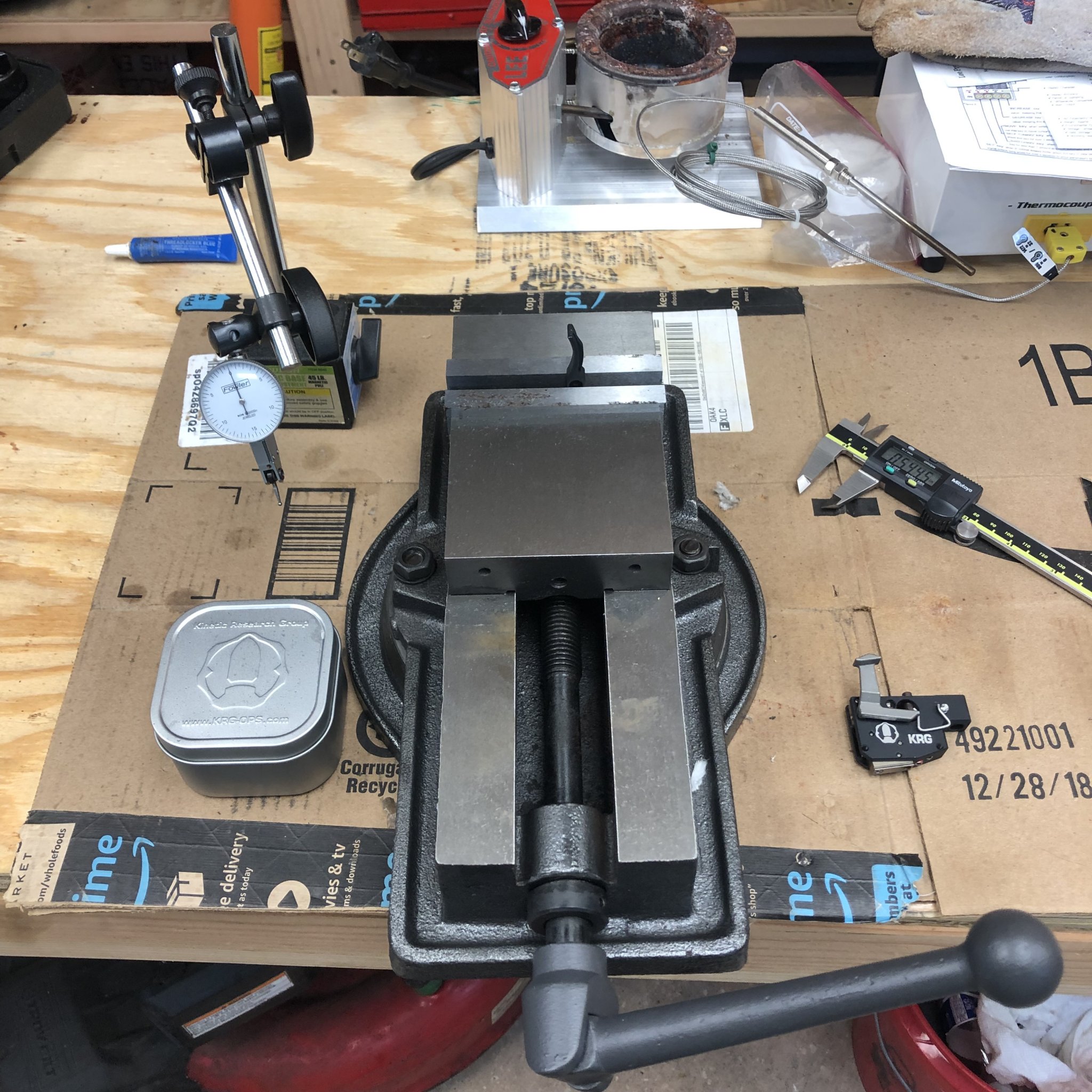

I installed the trigger on the barred action and went to seat the action in the stock...
Well, shit...

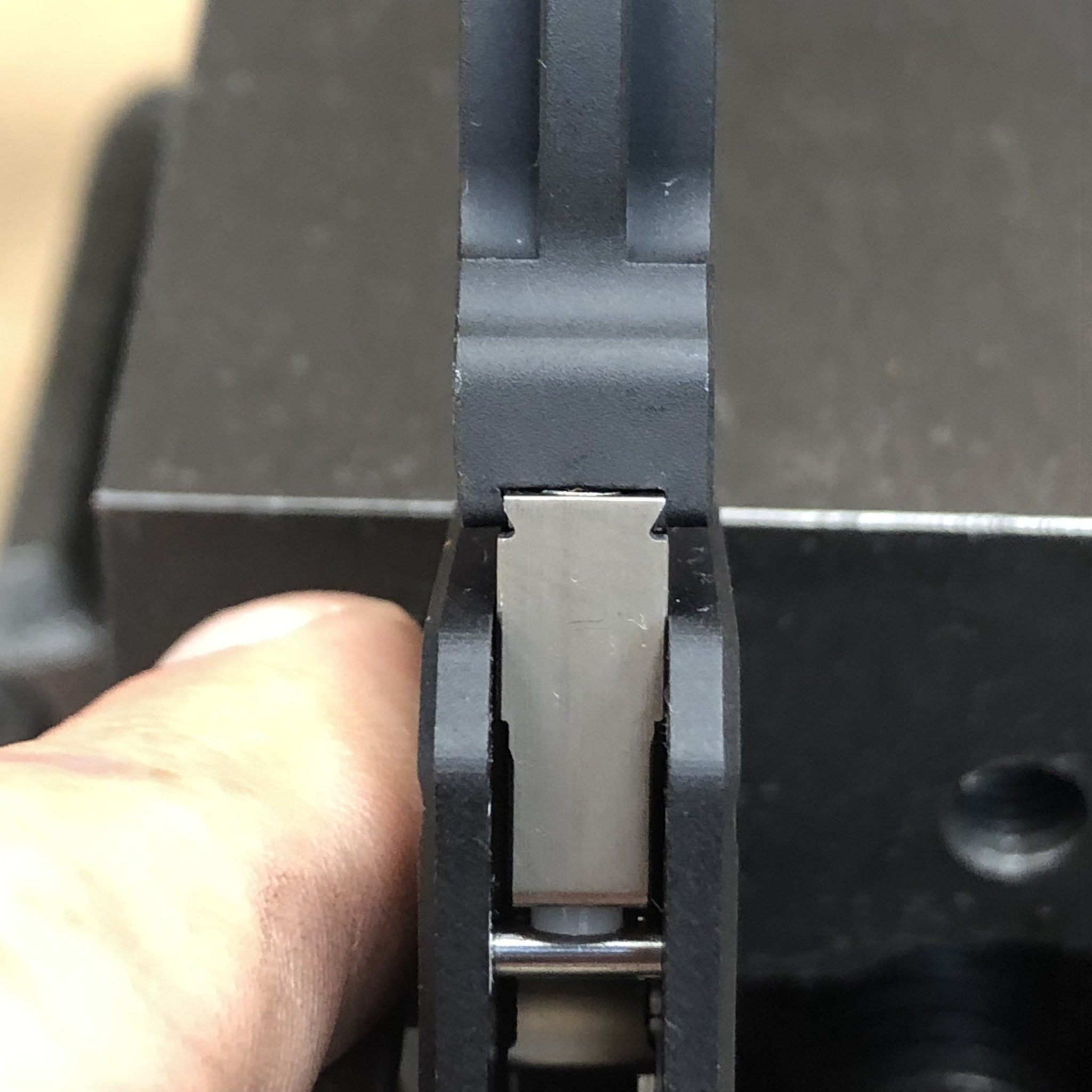

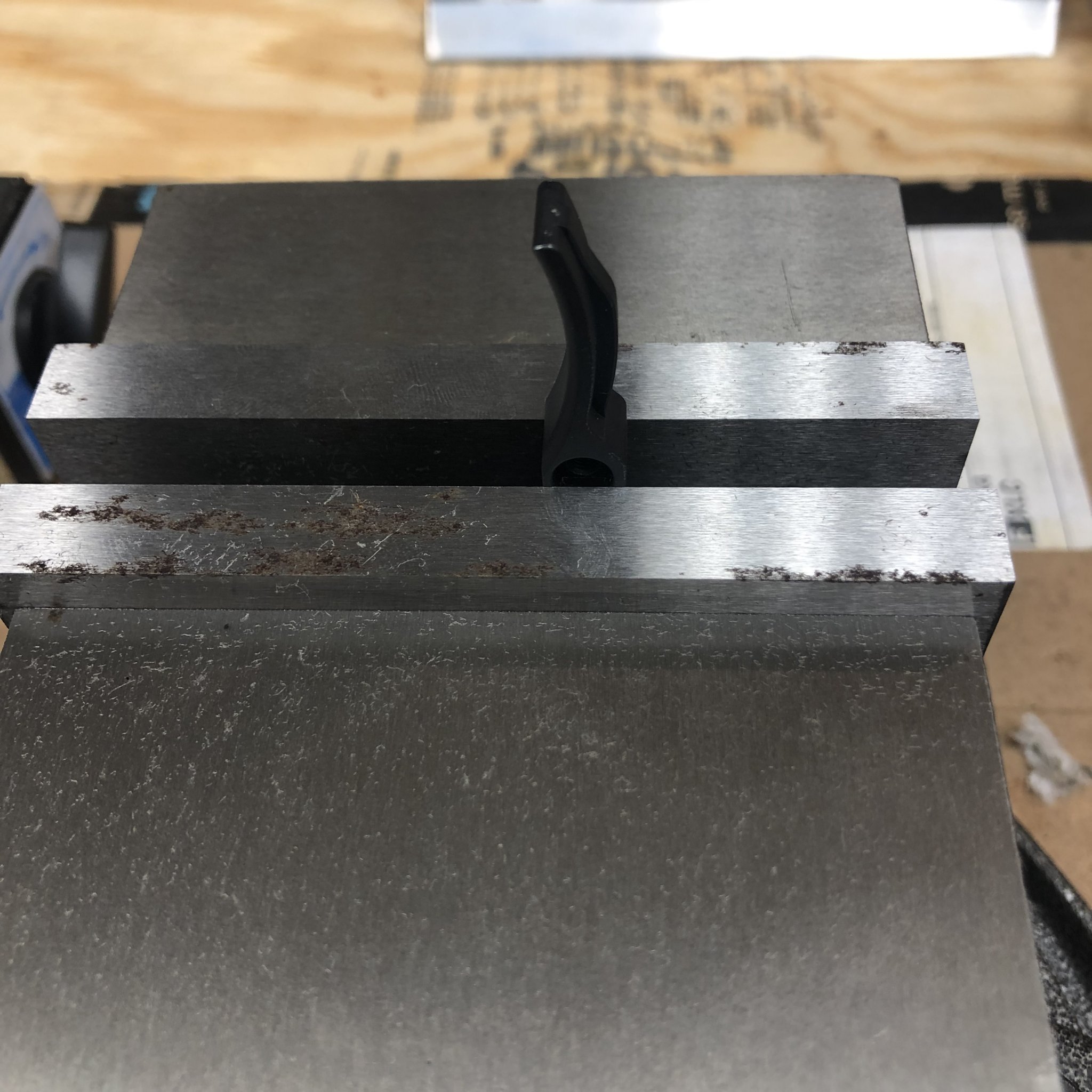

The Midas trigger shoe is about .050” wider than the trigger slot in the factory CTR bottom metal.
In the conventional wisdom of “ Modify the least expensive piece, I’m guessing the OEM CTR bottom metal would be in excess of $100, where as the trigger shoe should be much less than $50.00.
The question now is can I get a replacement trigger shoe if I trim the shoe to fit and want to go full width later when I get a chassis ? @Massoud - this is your department. Anything on the horizon for an “Upgrade” or is a replacement even possible..
I could mod the bottom metal without too much effort once I get it out of the stock.

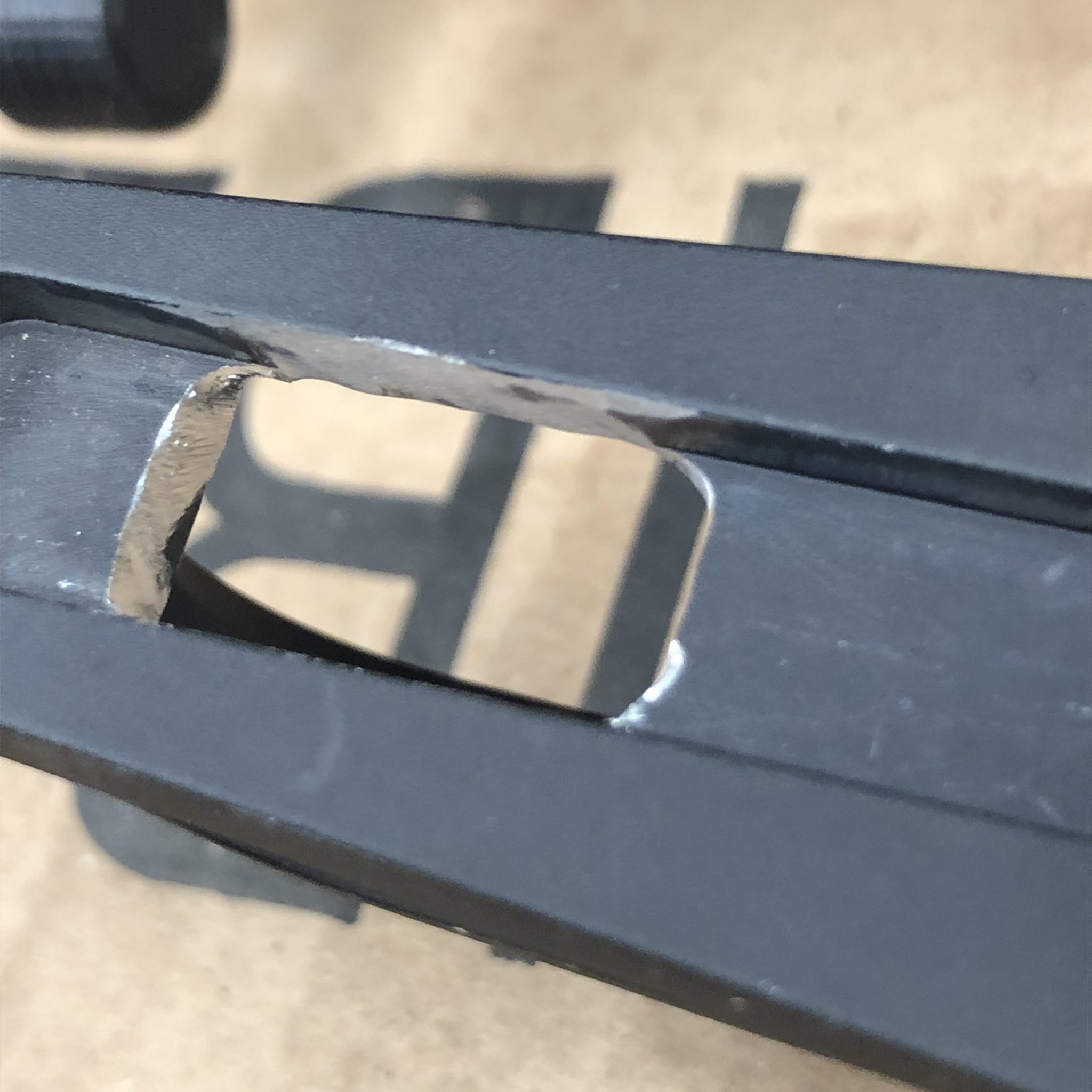

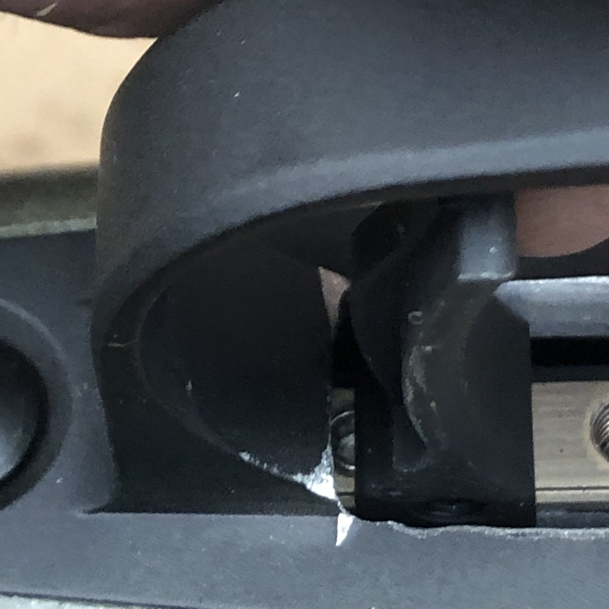

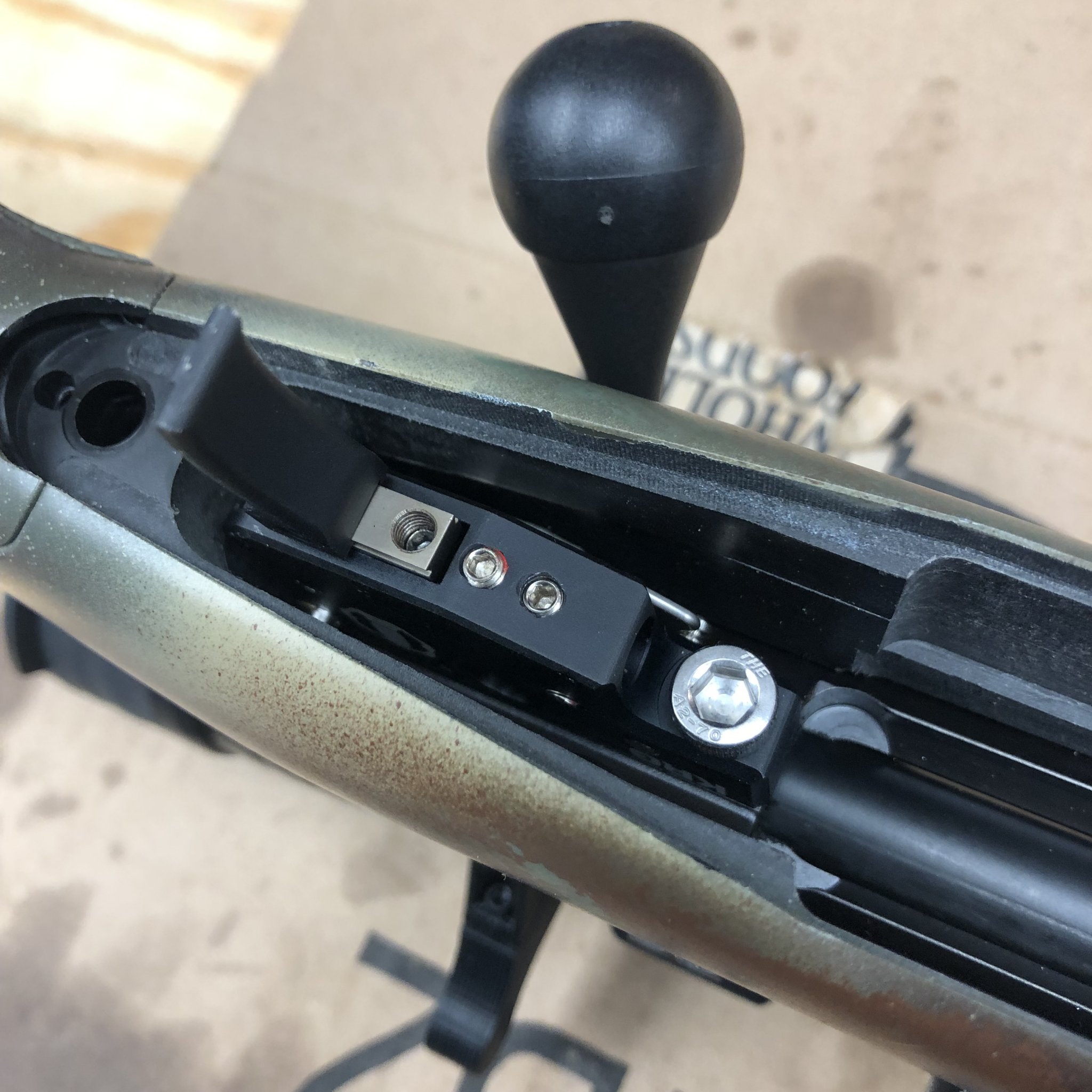

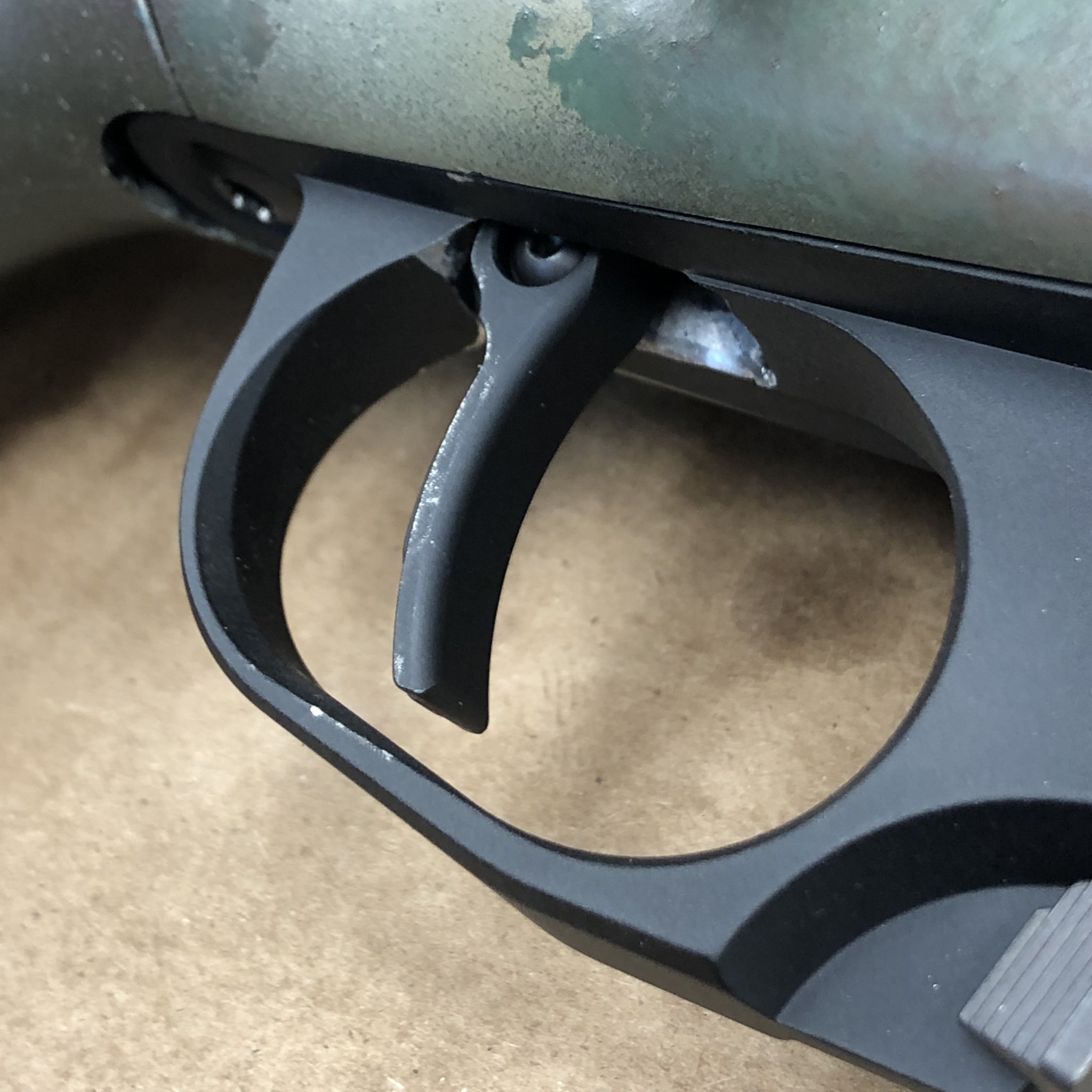

The new Midas Trigger installed on the barreled action and set in the stock:
7059574

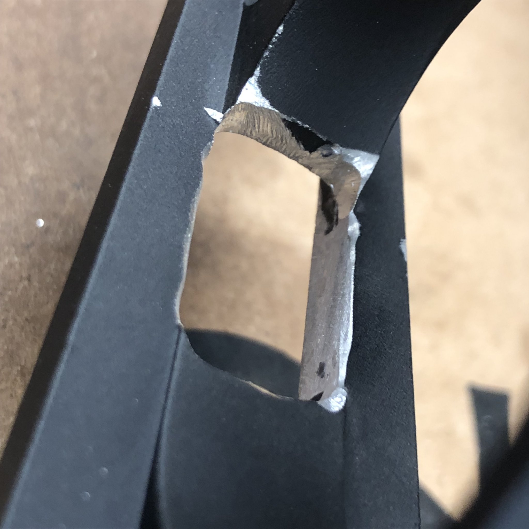

It took a little bit of work, but I relieved the trigger guard enough to make it all work.
I had to widen the slot inside the top of the OEM metal - I didn't take a photo before I started but there was a narrower width slot for the OEM Trigger shoe. This photo was the rough cut in between fitting into the stock.
Another photo before cleaning up the tool marks
7059569
I had to take some material off of the rear face of the slot to allow the shoe to slide back to get the distance between the trigger face and the grip to where it's comfortable.
7059880
This should give an idea of how far back the shoe is on the dovetail and the "Running Clearance" I have between the back of the shoe and the interior of the slot in the bottom metal. I may set the bottom metal in the mill ( After i get it wired ) and remove some more material at the rear of the slot so that I can move the shoe back farther and get it closer to the trigger bow.
I did clean up the tool marks and radius / deburr with an emery polishing point on the dremel before I assembled it for the final time, this time...
7059881
Hope this helps with anyone doing a trigger swap on a CTR.
It's not quite "Plug & Play", but its not something that requires a 5 axis CNC to make it work either.

I recently got mine in too, of the new batch. The trigger show slides very easily when loosened, but oddly, it tilts out to the left of the trigger guard when tightened. If it tighten it good and finger tight, the bottom of the shoe will sit outside of the left side of the trigger guard.
It sort of works out for me since I’m left handed and could do with the trigger being a little closer, but I wonder if that’s as intended? I checked to make sure it’s on both sides of the dovetail. It’s almost as if when I screw it down, the head of the screw slips past the dovetail, forcing the shoe to tilt. I’m going to contact krg about it, but aside from that, the feel is great and dropped into my Cadex chassis easy.
Edit: I think I got a fix for the time being. It felt like as I was tightening down the screw, the screw clamping down on the dovetail would start to slip and push the trigger. I found a precision aluminum 3mmx6mm spacer and used that as a washer. This was a slightly tighter fit in the bore than the screw head, plus as a washer it doesn’t turn as I tighten the screw. I’m still going to contact KRG about it, not sure if they loosened the fit or tolerances over people complaining about the trigger shoe being tight, or maybe just a couple thou of tolerance can cause it. Either way, it functions, and if anyone else has this issue, here’s at least a temporary fix.
