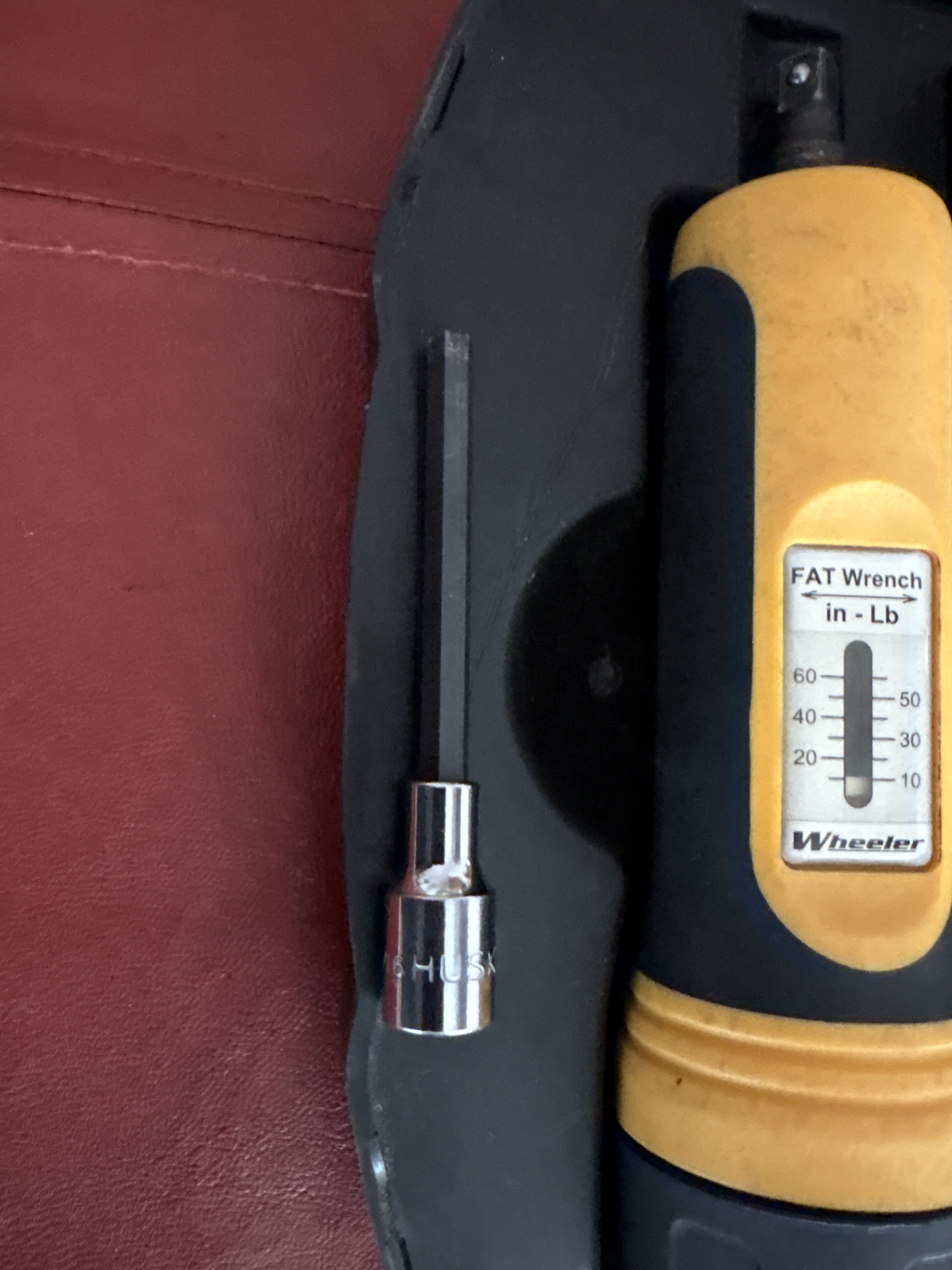

I saw the long hex bit sockets at Home Depot and just assumed they wouldn't work because of the circumference.
Turns out they did, thanks for the suggestion.
El cheapo-cut a 6mm hex wrench and use a 6mm socket-- You could epoxy those two together.
Yep - That’s what I do for my bravos (3/16). Just keep the socket and cut Allen wrench in the torque wrench box. A single Allen wrench from the hardware store was like $2.

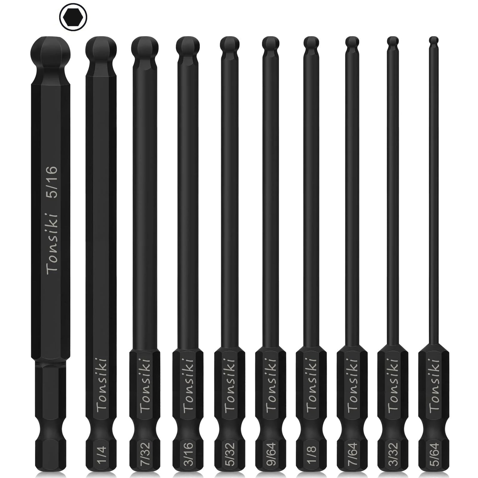

I got extended Allen bits off Amazon, but in the past is just drilled the hole of it out to fit what I had
