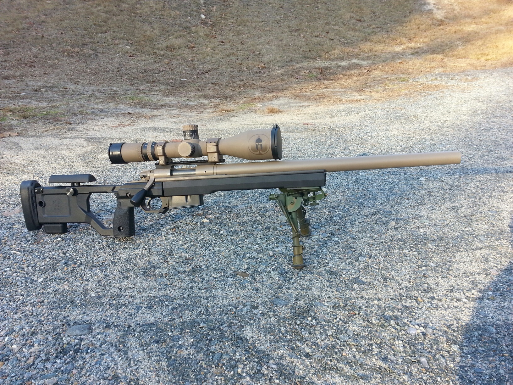

Great review and I can concur with every statement made above. The KRG X-Ray is a joy to wrap your hands around, like being in bed with a sexy lady. It is almost three pounds lighter then my old AICS with better ergonomics. Mine is off getting paint from ShortBus but I have already had mine to the range and not to hijack the thread here is what she did. First round was low right due to the change over and the next five made a nice little hole. I also run a Timney and HV barrel on mine so more then enough room. Bottm line, this is now my favorite chassis, and I have a serious chassis addiction.
