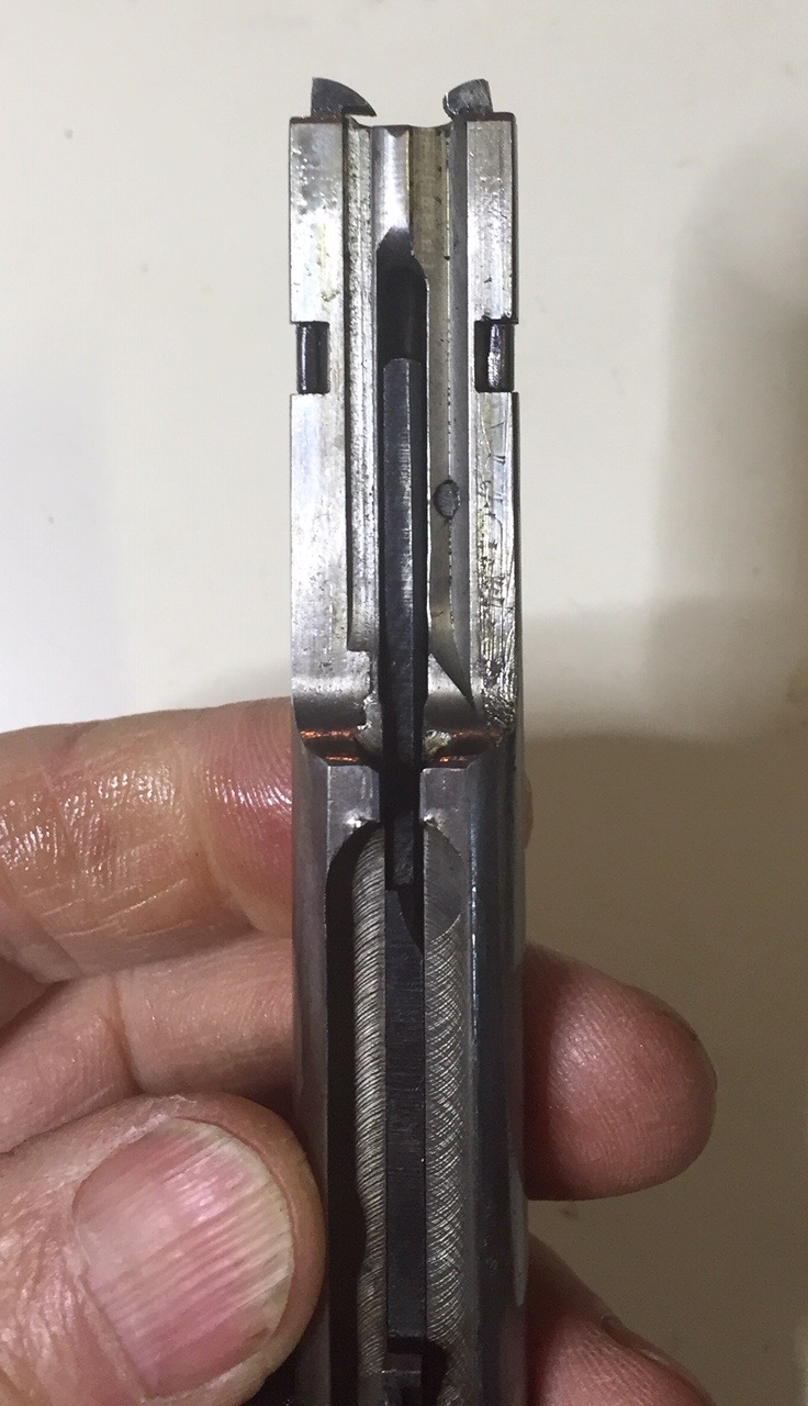

Hi,
I'm new to the whole gun topic though im slowely getting around it. My question comes from the purchase of a 1962 Krico rimfire firearm that looks very much in tact. I've been pulling it apart and exploring it and I've come to the extractors on the pin (see image).
I can't find images for what the extractors on this particular bolt should look like, though I wanted to ask the forum if the one on the right is damaged or it in fact is meant to look the way it does? Reason I ask is that both extractors look considerably different. Any ideas?
I think the only the one on the left is an extractor. The one on the right is a holder. I’m not familiar with the krico but the bolt on my cz looks the same.

Supposed to be that way. Provides side tension to hold the extractor over the rim. 22 rims can be hard to grab by some guns, especially as they wear.
Reactions: Jumbofinks
