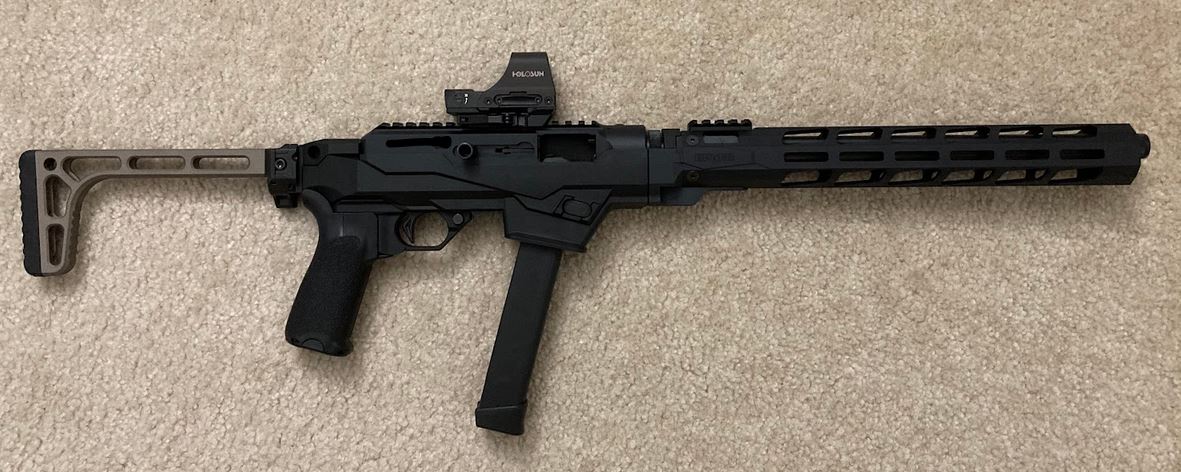

My Ruger PC Carbine (19122) is far more consistent and precise, averaging 2.94" 5-shot groups at the same distance with the same ammo and optics but it has a weird issue where the shots form a line followed by a flyer and I was able to reproduce it. Could be an issue with the barrel locking ring loosening, optic loosening, etc... I just cleaned/lubed everything so I'll be able to check it again soon.

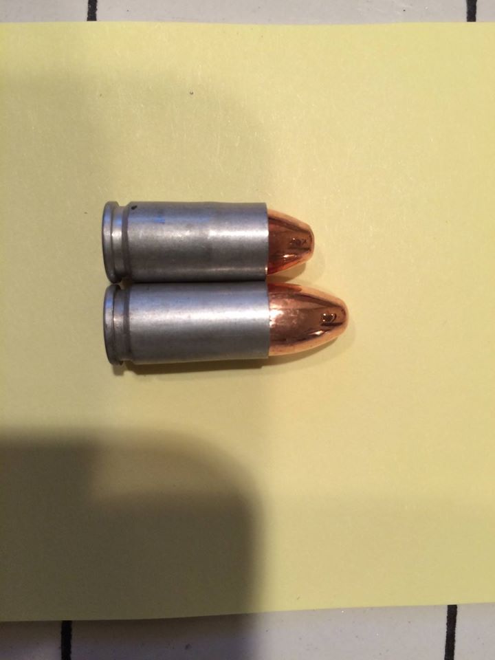

And be careful with CCI Aluminum case in PCC's, I have had quite a few setback in my Colt pattern PCC. ( YMMV ) ( Bottom Photo )

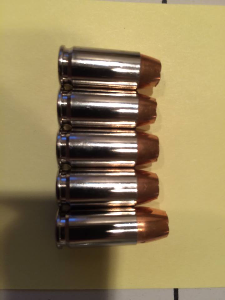

And the SIG V-Crown also was a setback King. All bullet weights( Top Photo )
