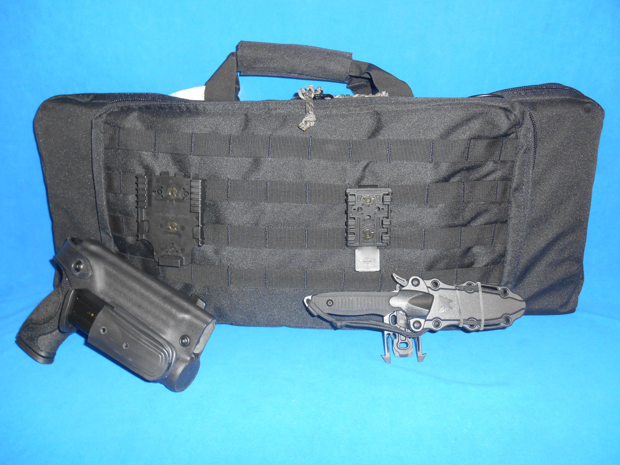

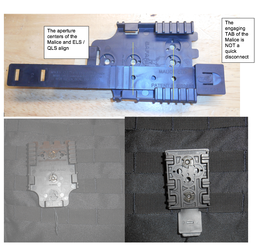

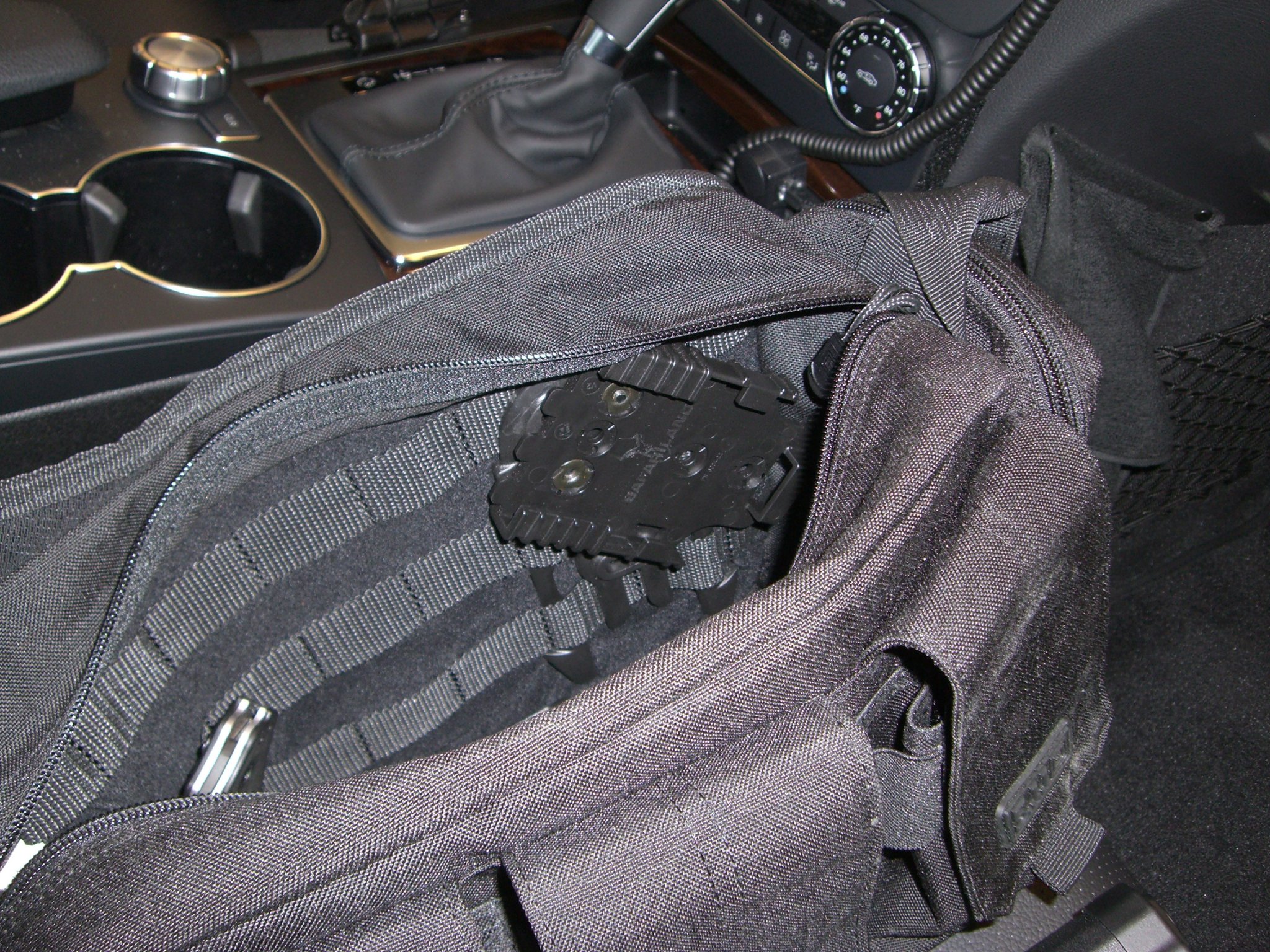

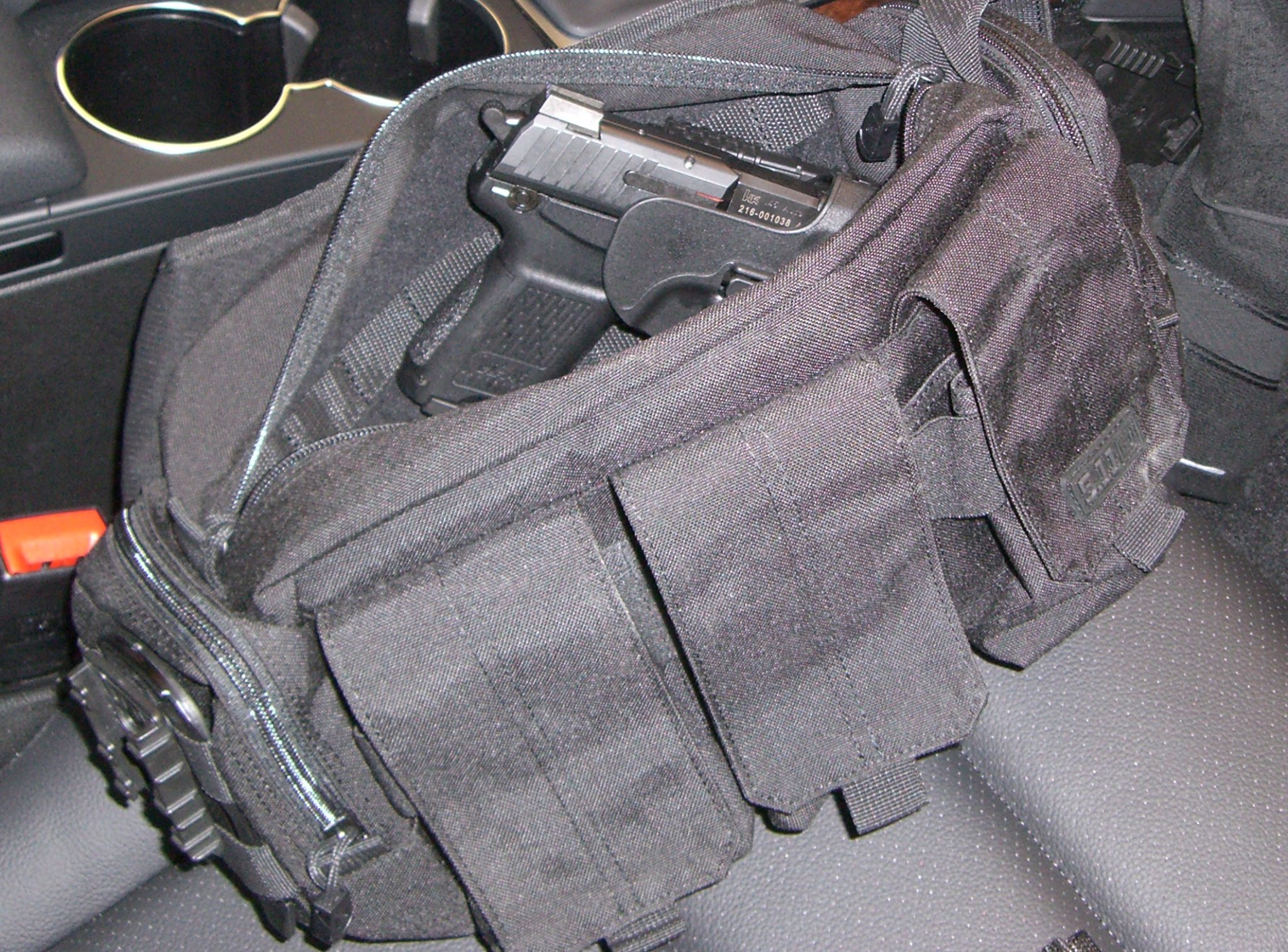

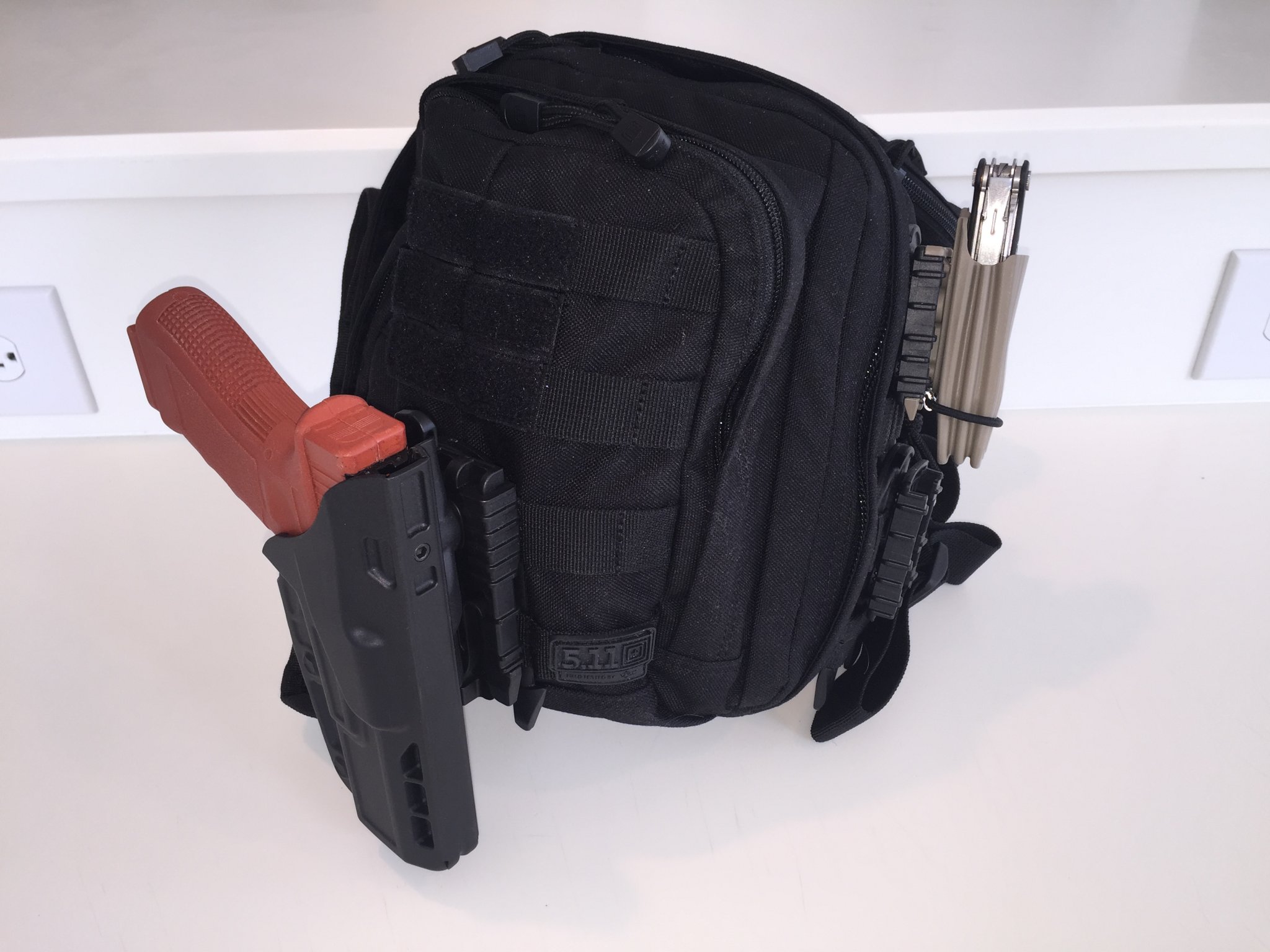

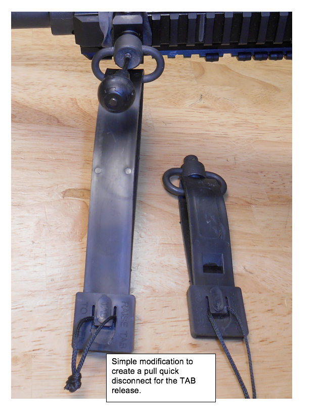

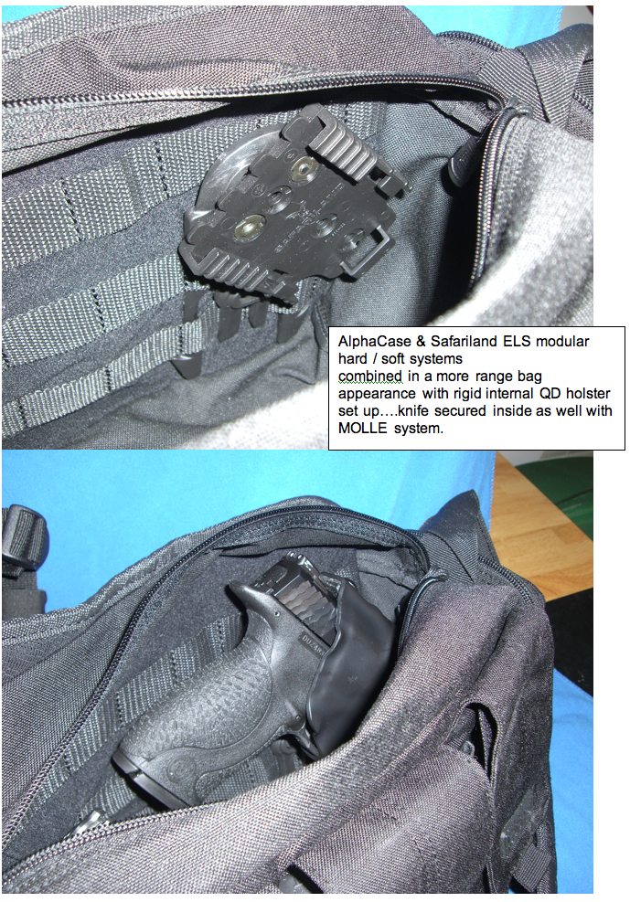

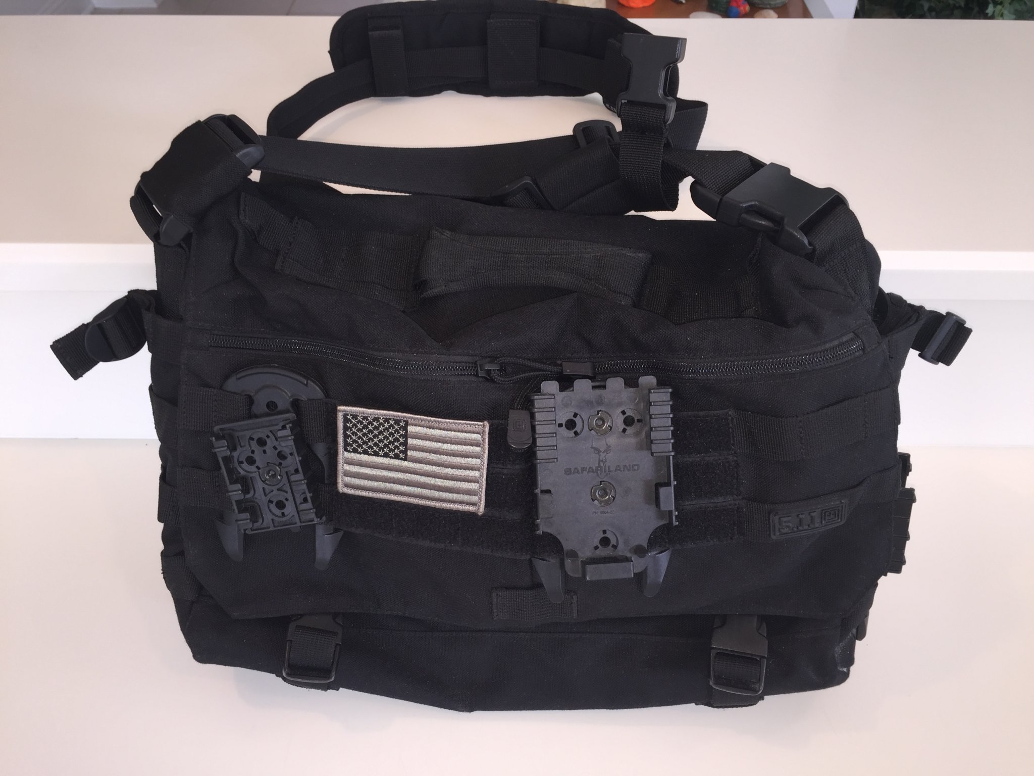

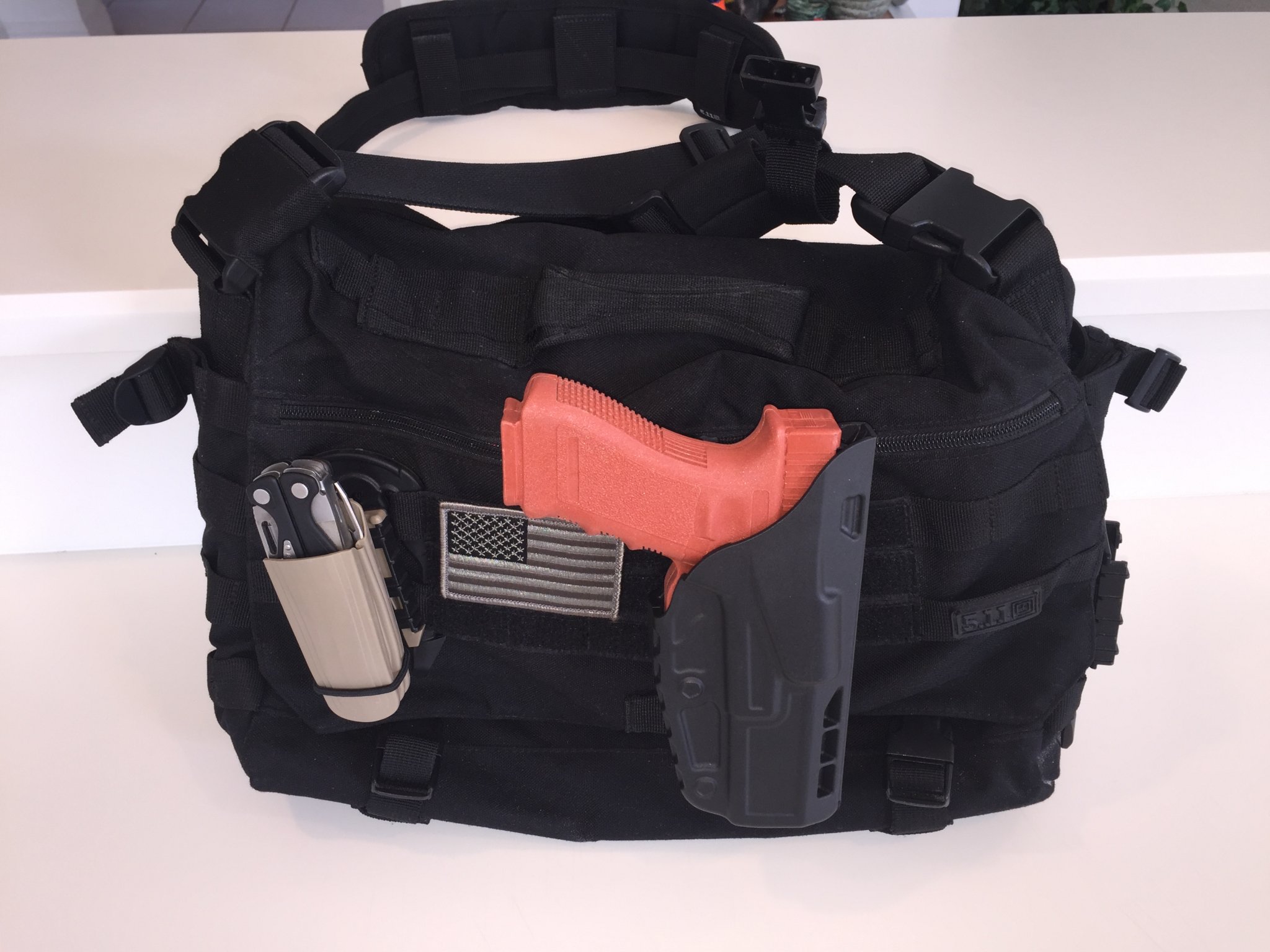

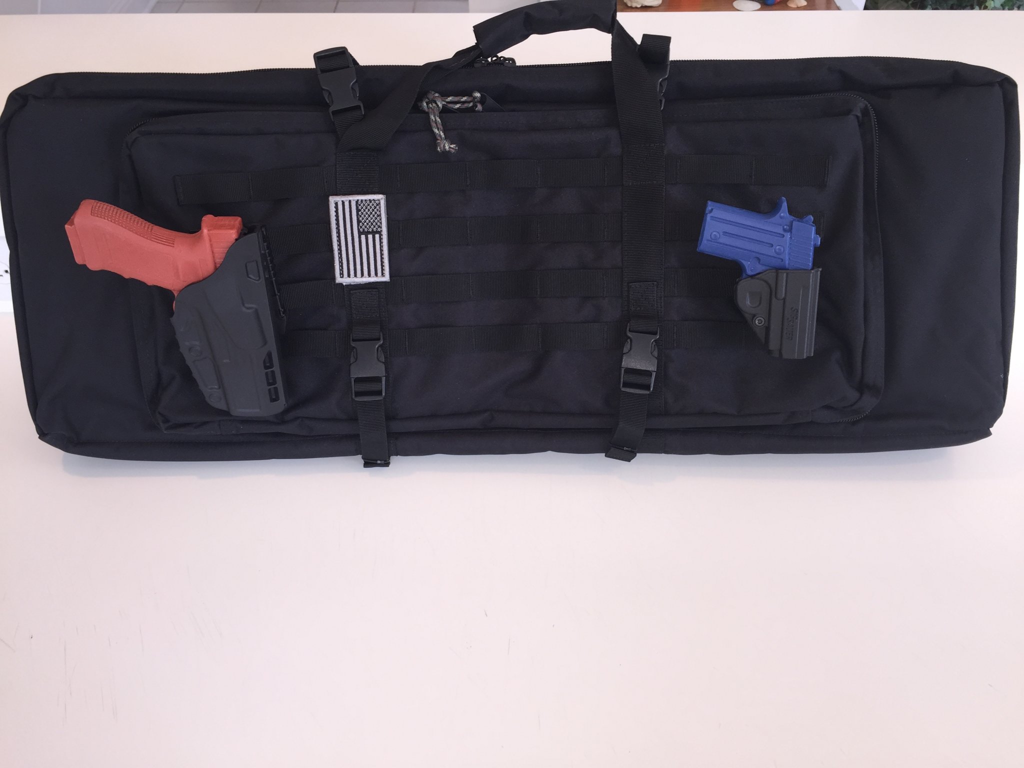

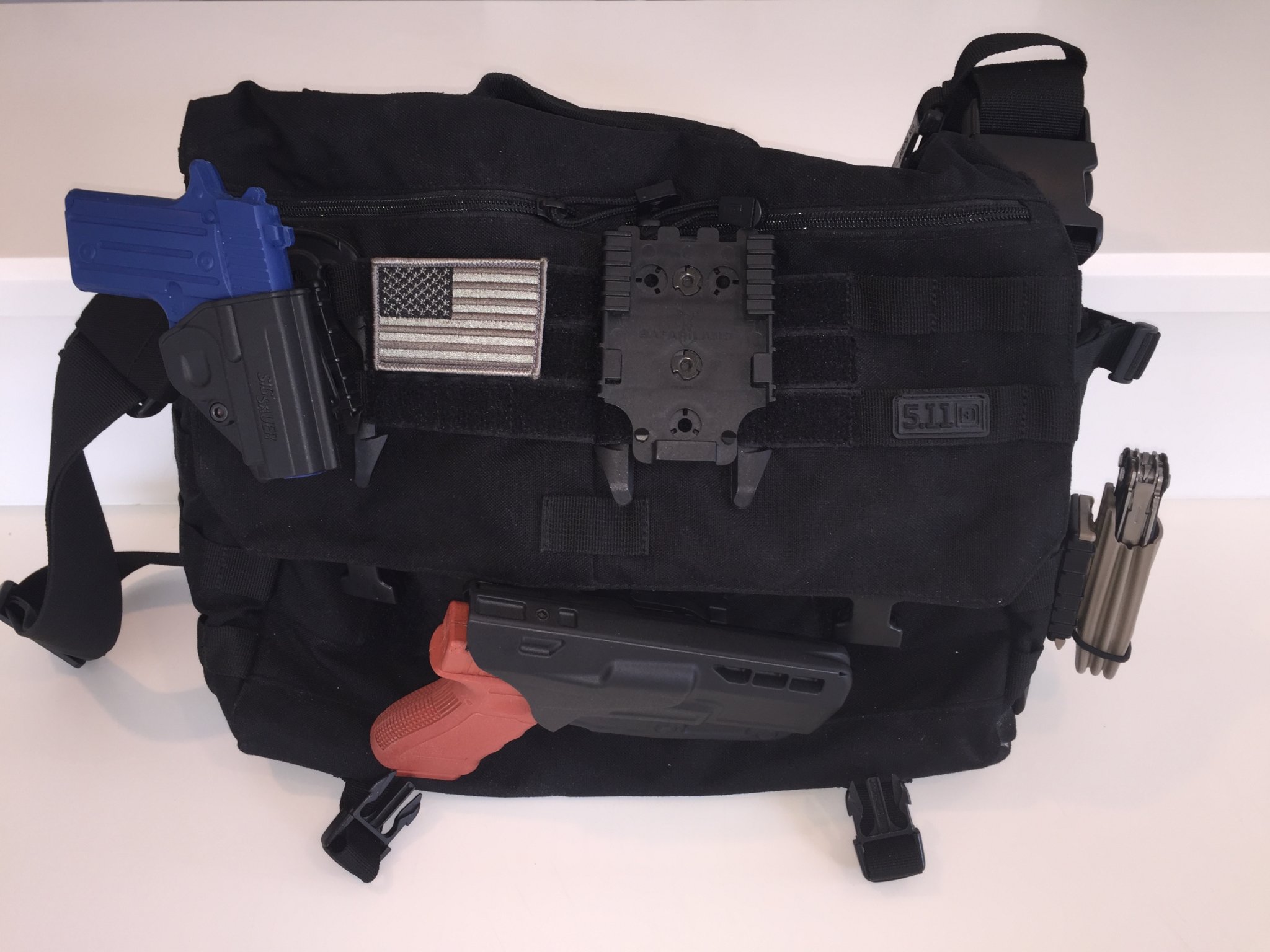

I have used the Safariland QLS / ELS system at least a hundred times, all sorts of configurations. You can use the Safariland molle mounting plate to then secure the QLS or mount the QLS female component directly to the molle system either with Safariland T-nuts or Malice straps that happen to align with the QLS mounting holes exactly.
Here are a few examples.
