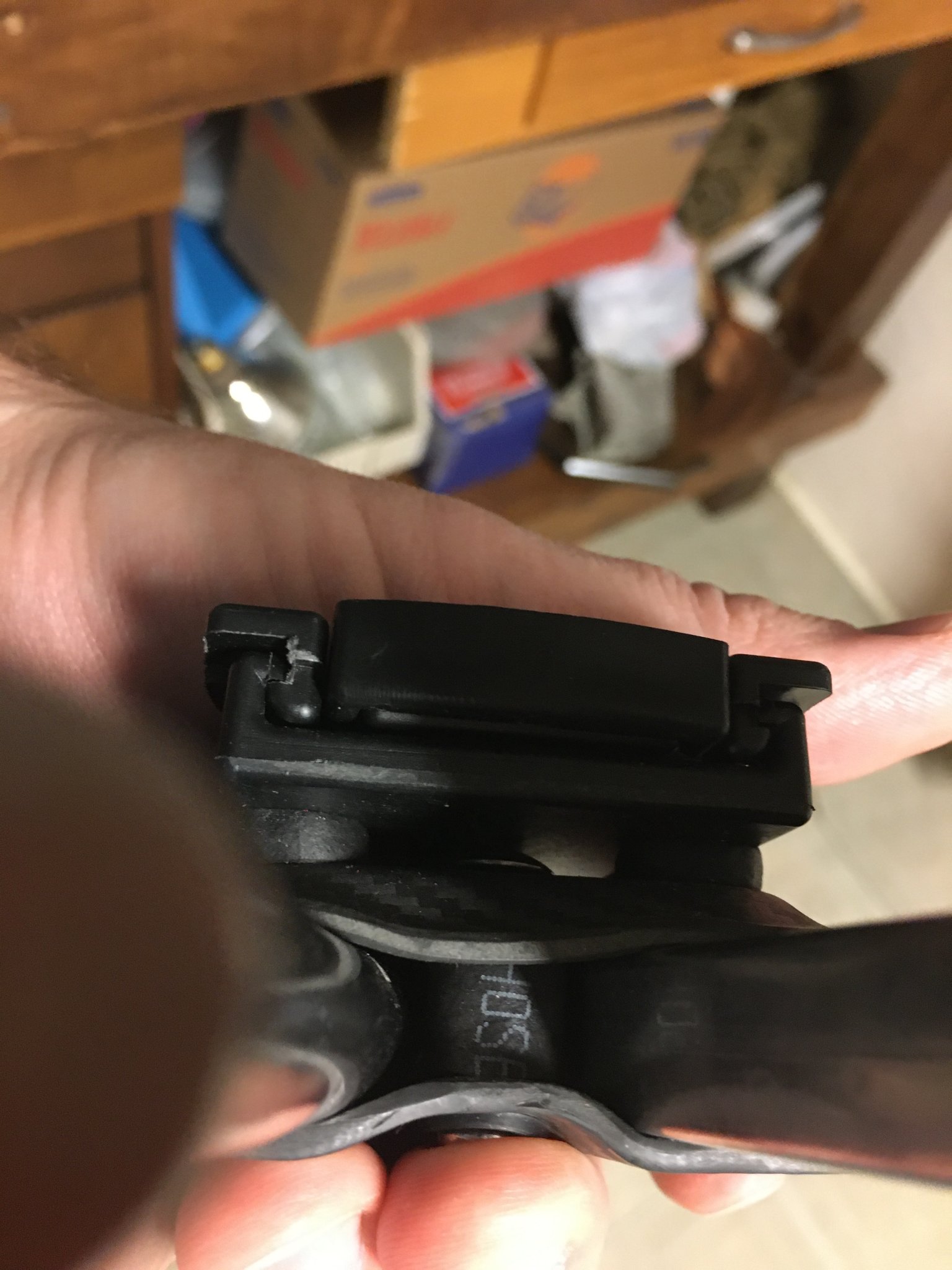

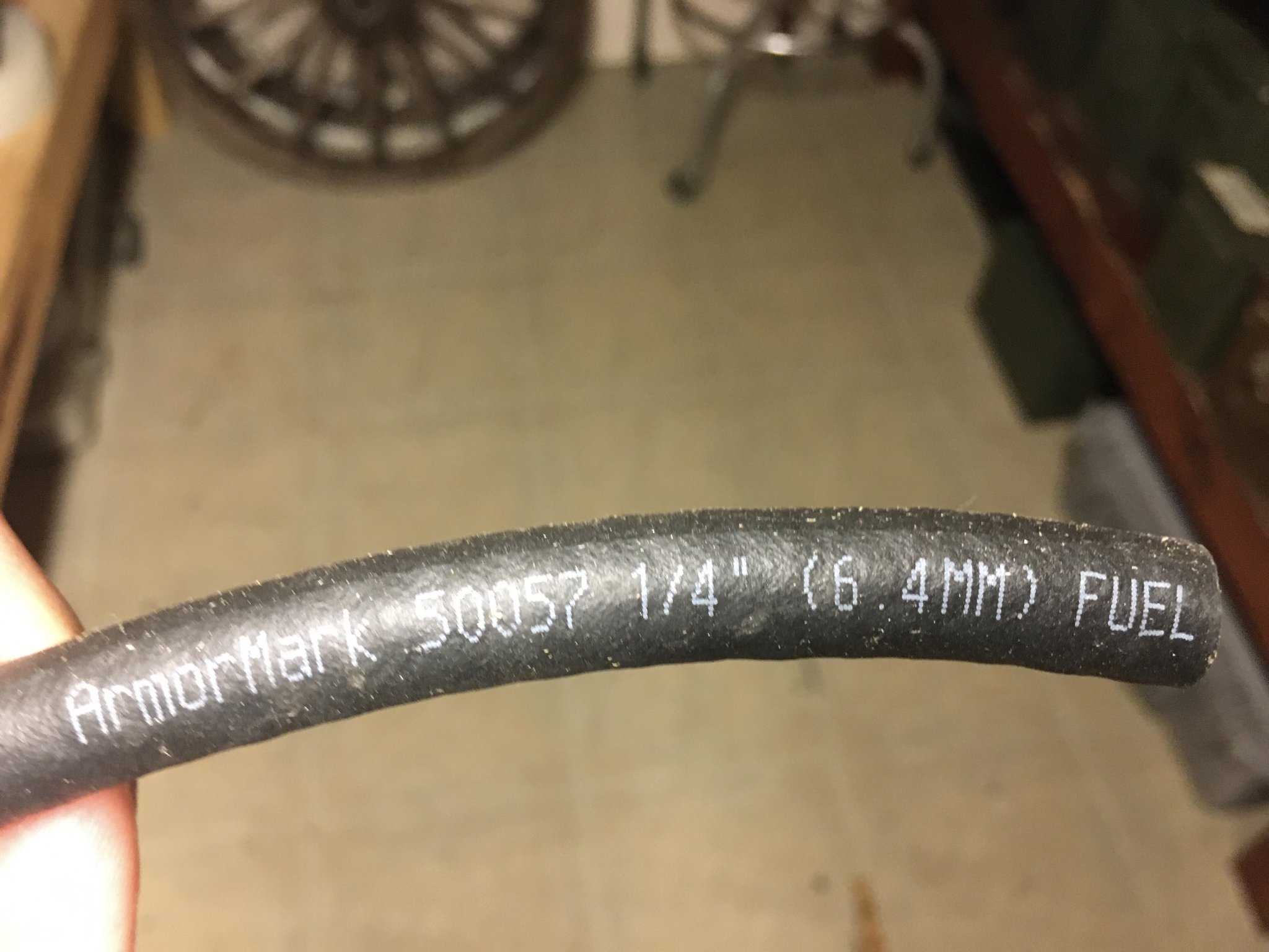

I use a longer screw and same old funny nuts as for everything else from knifekits.com. Cut a piece of rubber hose from autozone to go in between. Cut it up for most spacers.
