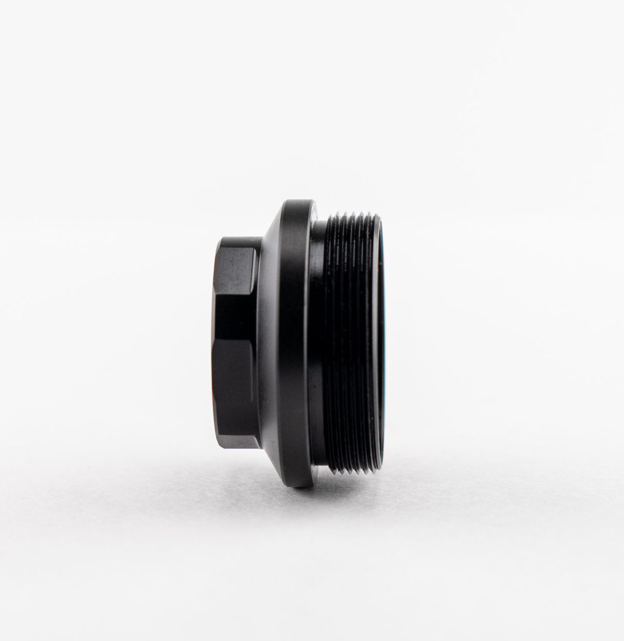

Like has been stated... ANY good quality direct-thread or QD mount should return exactly to zero once removed and reinstalled for shooting. I run the Otter Creek Labs ZR0-DTA 5/8-24 mounts on my hunting rifles and my big L cans. I run KeyMo (QD) on most of my S sized cans, and my Polonium 5.56 can, that way they can all easily and quickly be interchanged, because I have a couple of Sandman-S cans and they are fixed KeyMo mount only, so I like the versatility of being able to swap them around on other guns.
does this OCL system have a taper at all, or is it essentially just a direct thread attachment that's recessed into the can?
either way, its a good idea to save on added length.

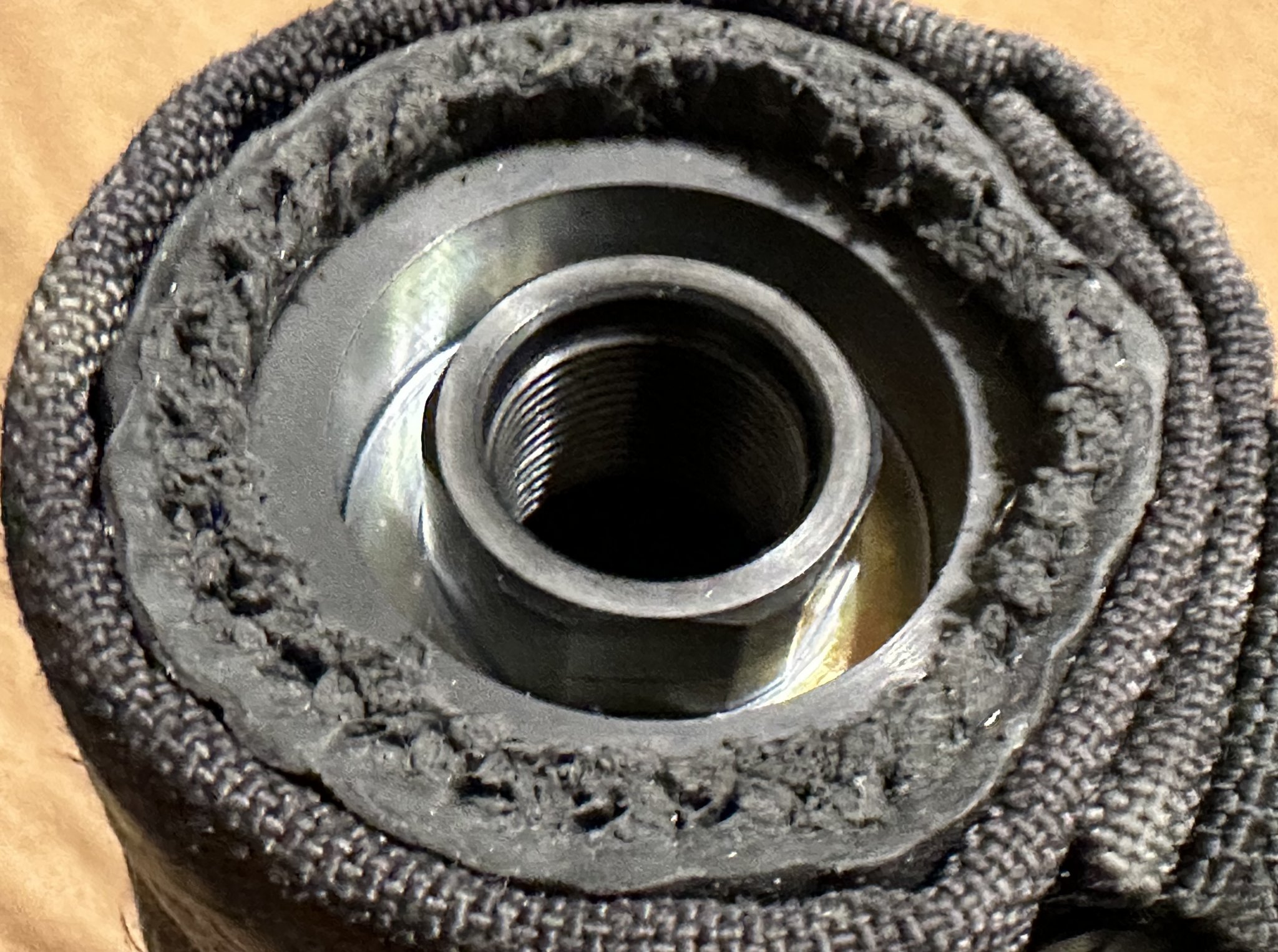

No taper, just a direct-thread mount that recesses the threads into the can to cut down on length. It works great. I’m running them on 3-4 cans right now. Also, it only weighs 1.1 oz, and is solid titanium, so it’s strong and light.

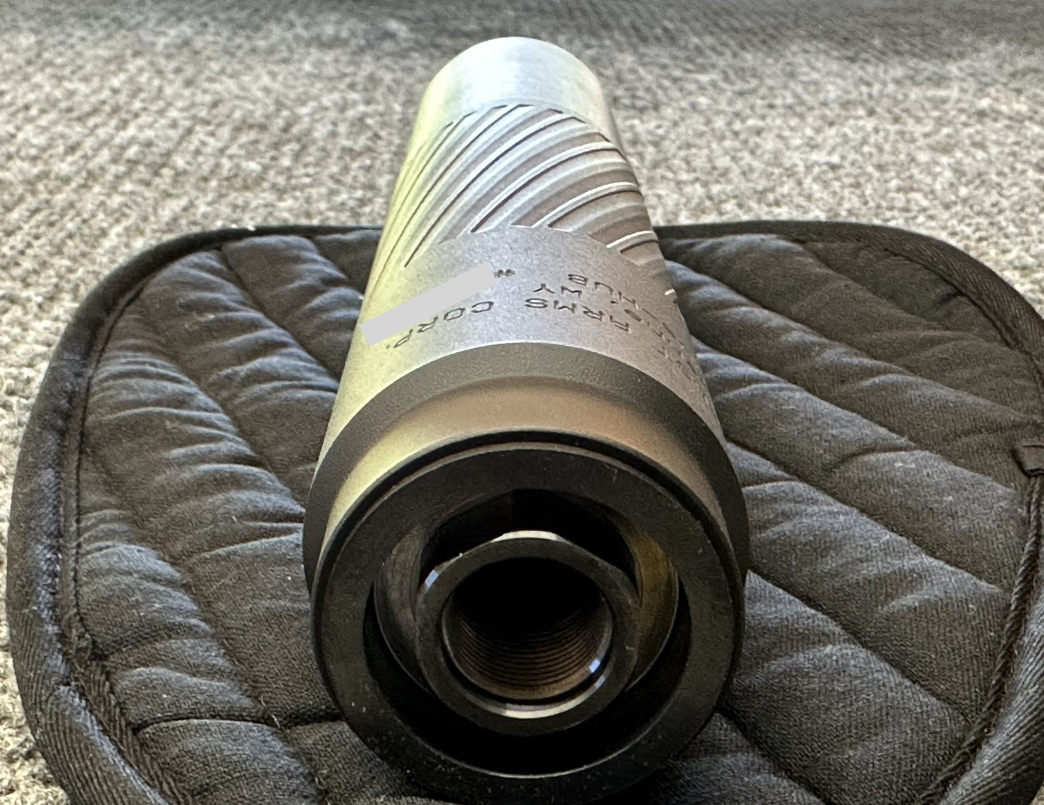

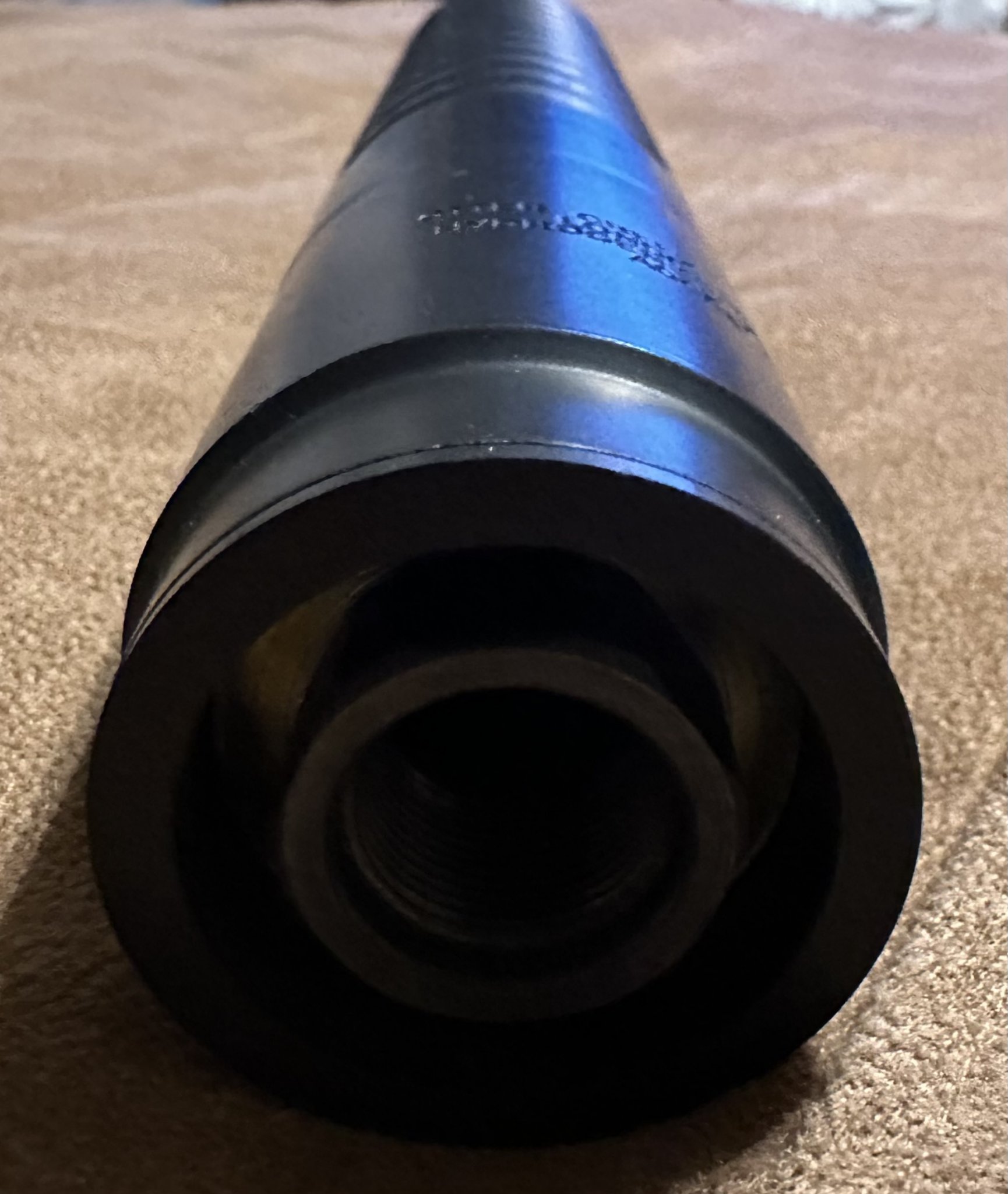

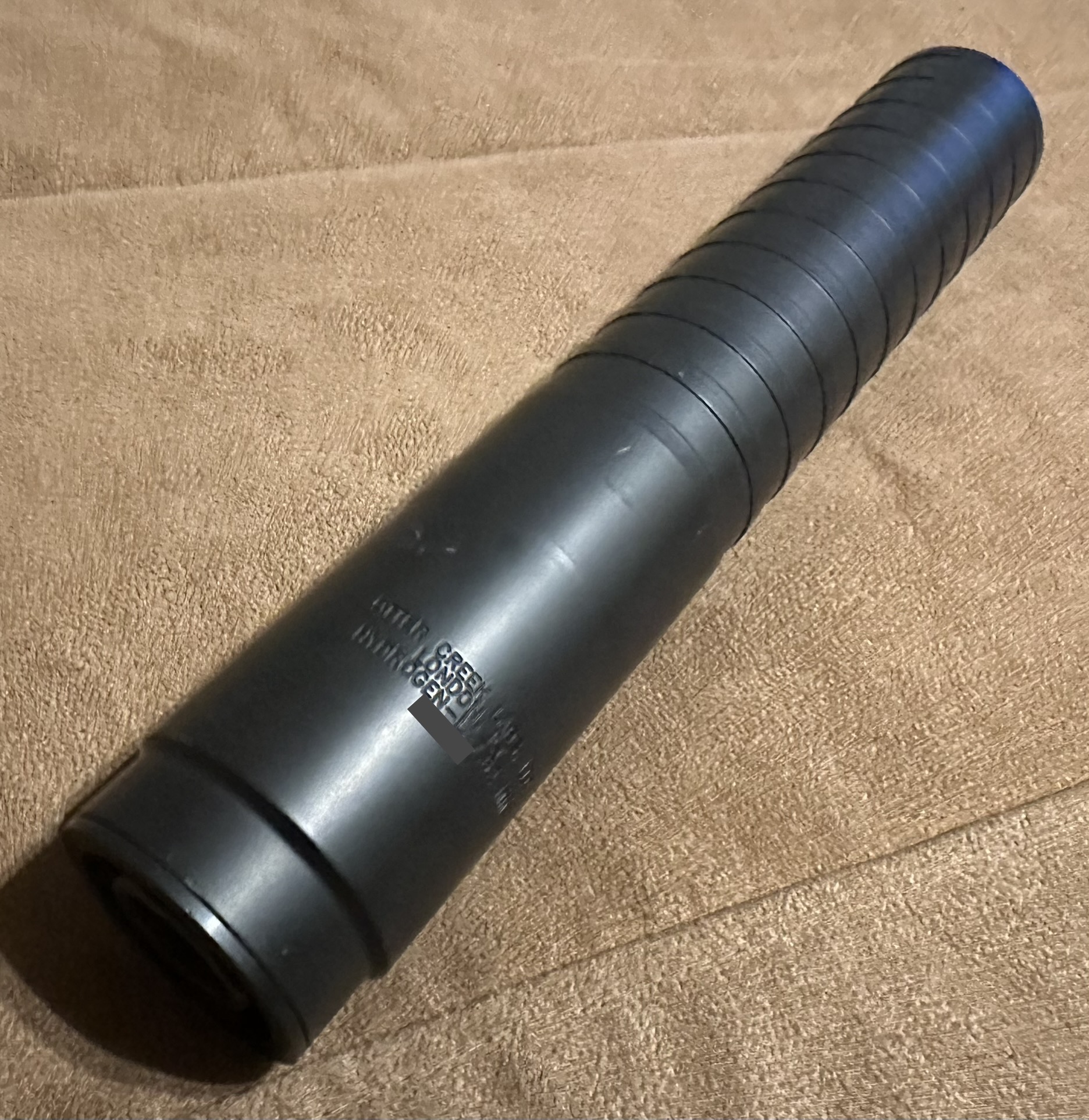

Here’s some pics of some of mine…
Otter Creek Labs Hydrogen-L
TBAC Magnus HUB
Dead Air Nomad-LT

I'd personally run the L ti.
OCL zro for direct thread is awesome as it adds no length.
