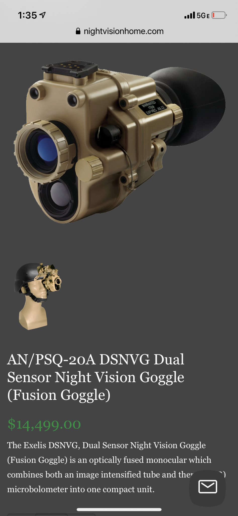

Wake me up when we have fusion readily available
