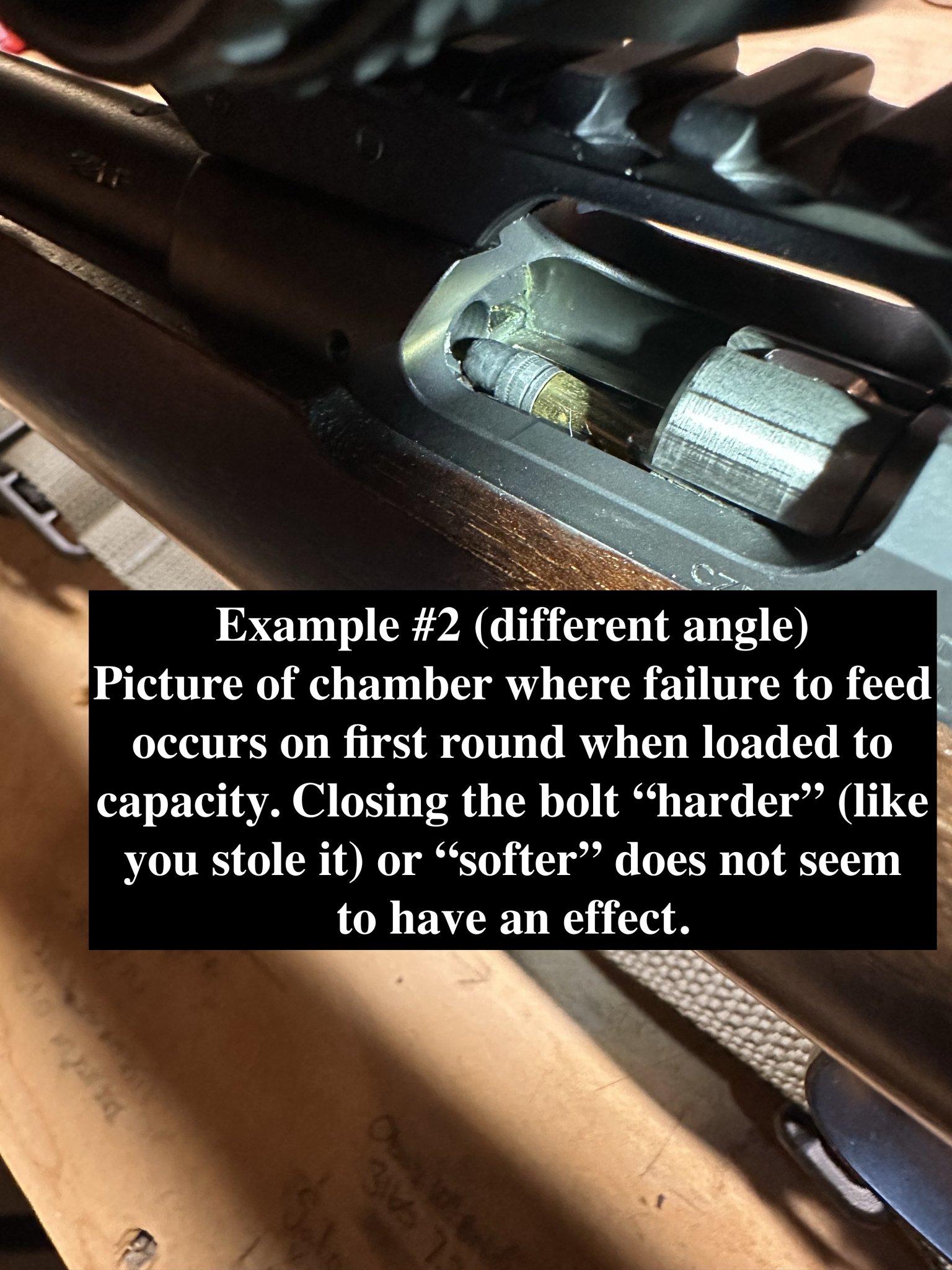

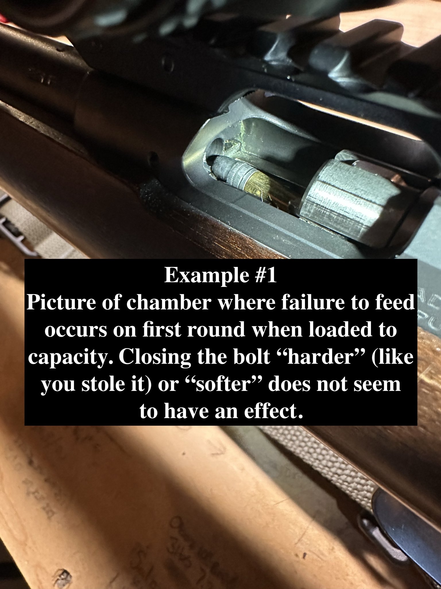

Round doesn't chamber / gets stuck below the chamber. It pops out of the mag and doesn't ride up in to the chamber.
ETA I'll try to get a pic of it next time

I just ran a match with my 2 L3I magazines. For the most part they ran pretty good. I did notice that with them being a longer than factory, I had a magazine pushed up against my support bag and wouldn't feed. Believe I need to get one of the gray ops barricade stop now to make sure this doesn't happen again. Overall I am very happy with the way they fed the rounds.

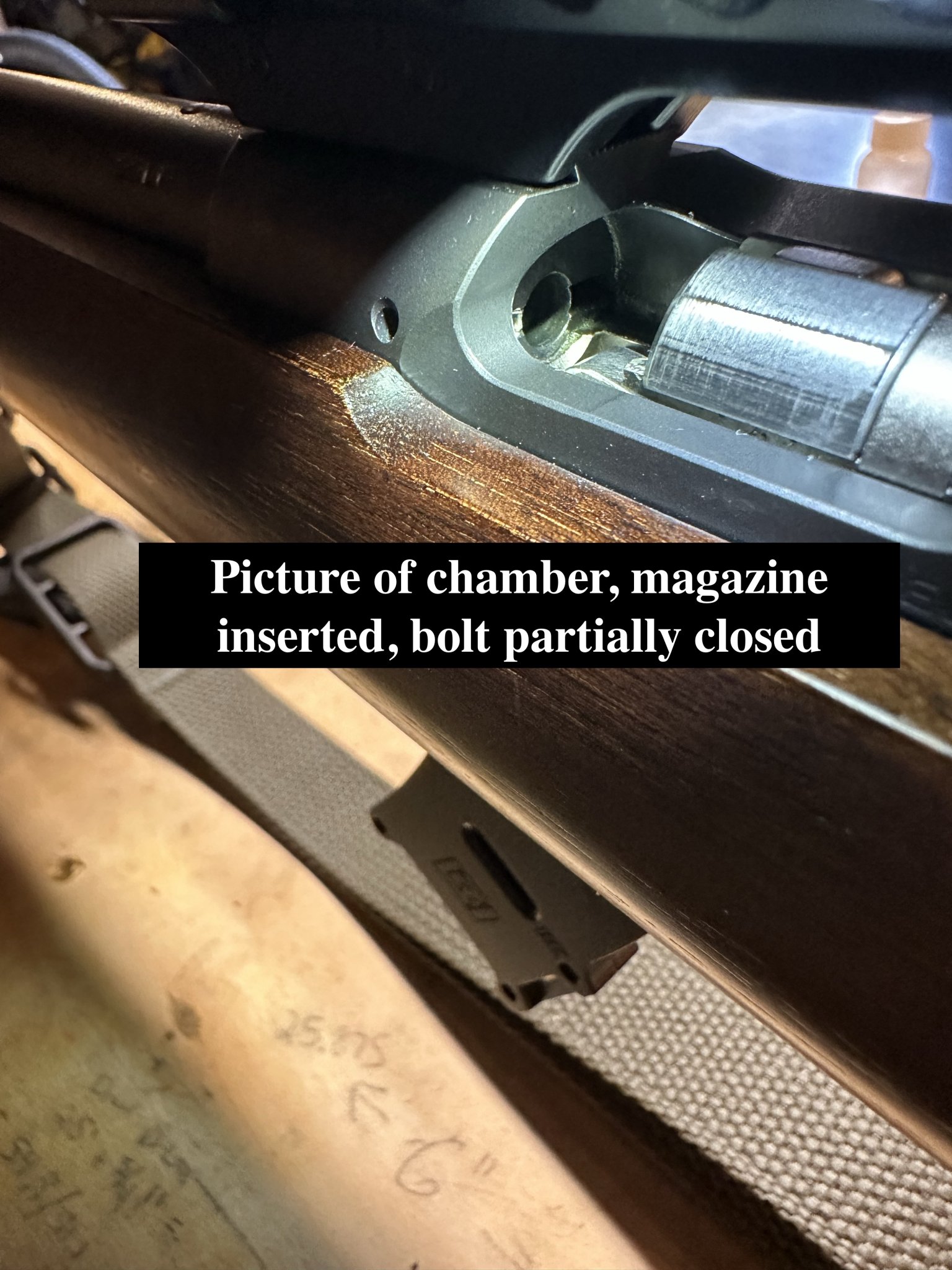

Mag would not load to 13 rounds. Rattling when shook. Similar to CZ mags in the past which have had a faulty spring or follower. Usually this was remedied by inserting a pin when loading the magazine, trapping the spring and releasing it when the magazine was empty so it could "slam" into place.
Magazine issue maybe rounds locked by rims? Failure to feeds.
CCI SV feeding, no issues this magazine?
possibly isolated to one magazine now
“Offending mag” ran with CCI SV
SK Match in “problem mag” runs flawless
SK Match in “offending mag” jams

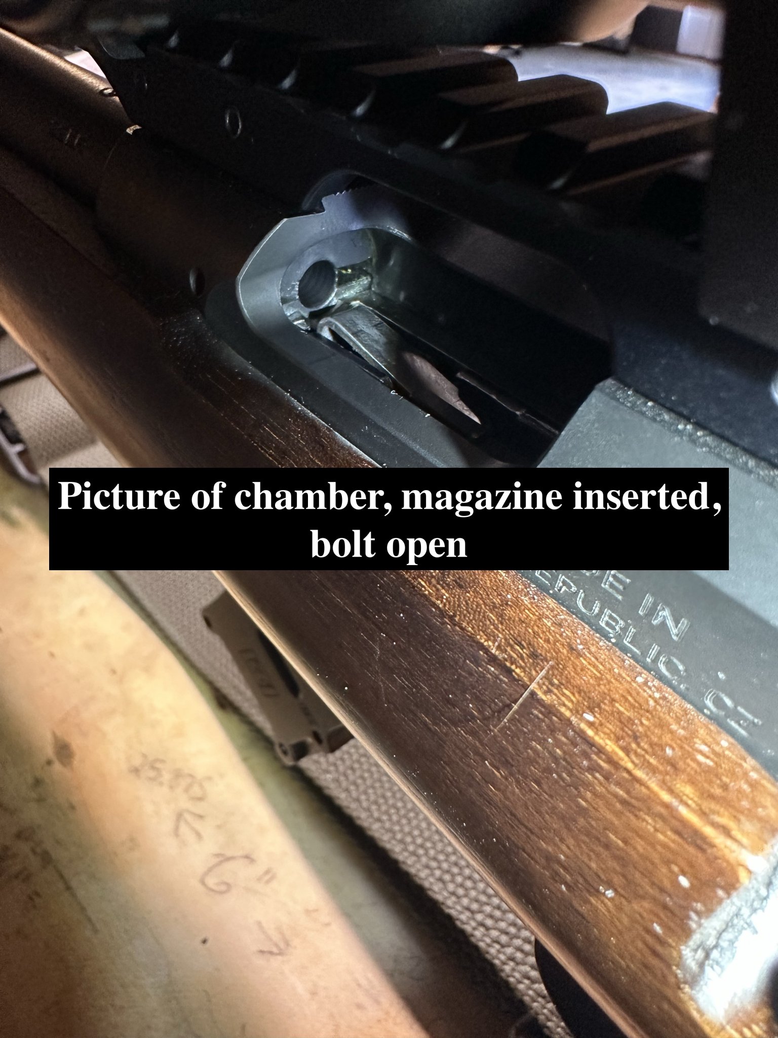

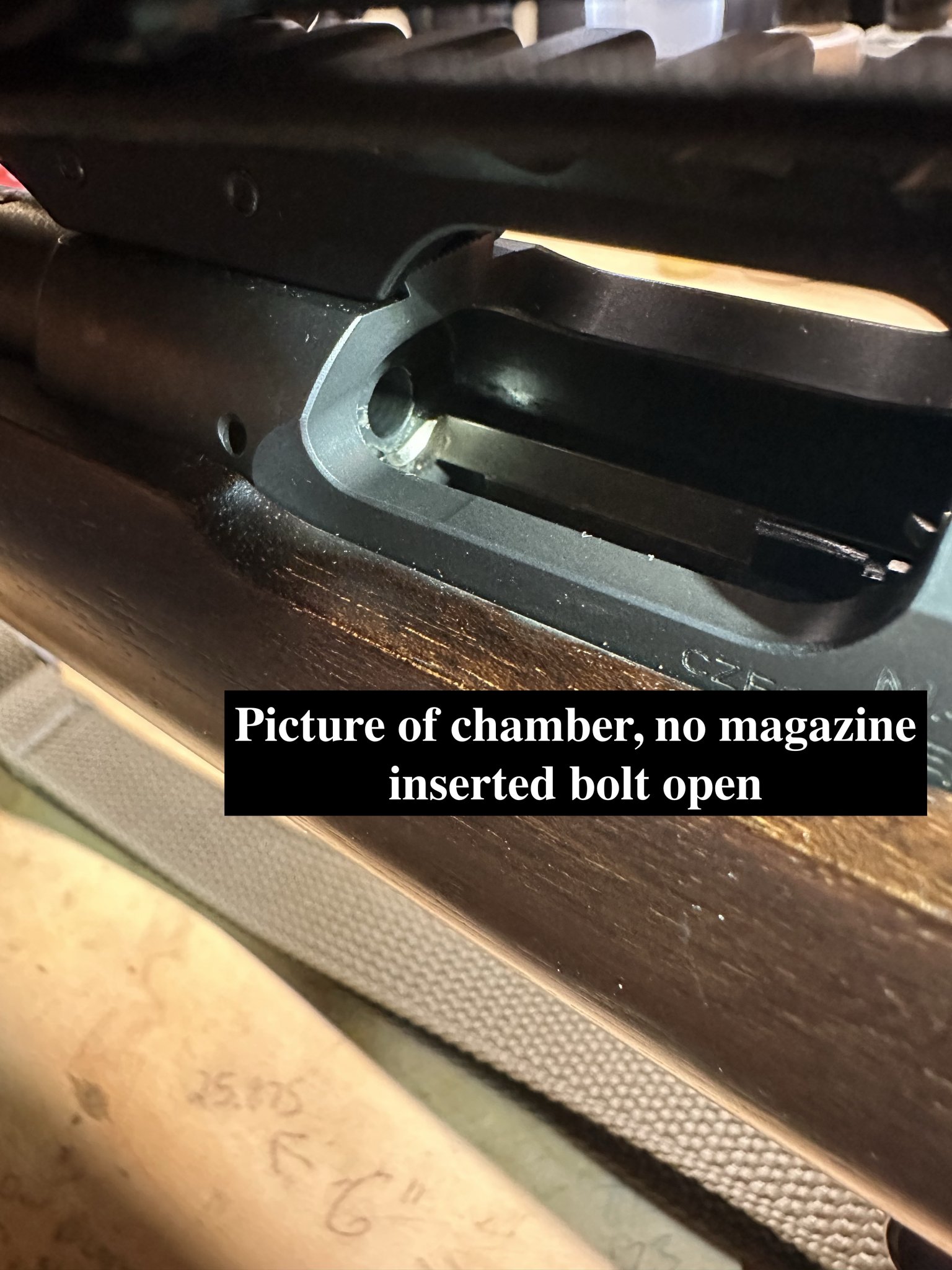

Is your bolt interfering with the mag of the mag/top of the feed lips? Or vise versa.

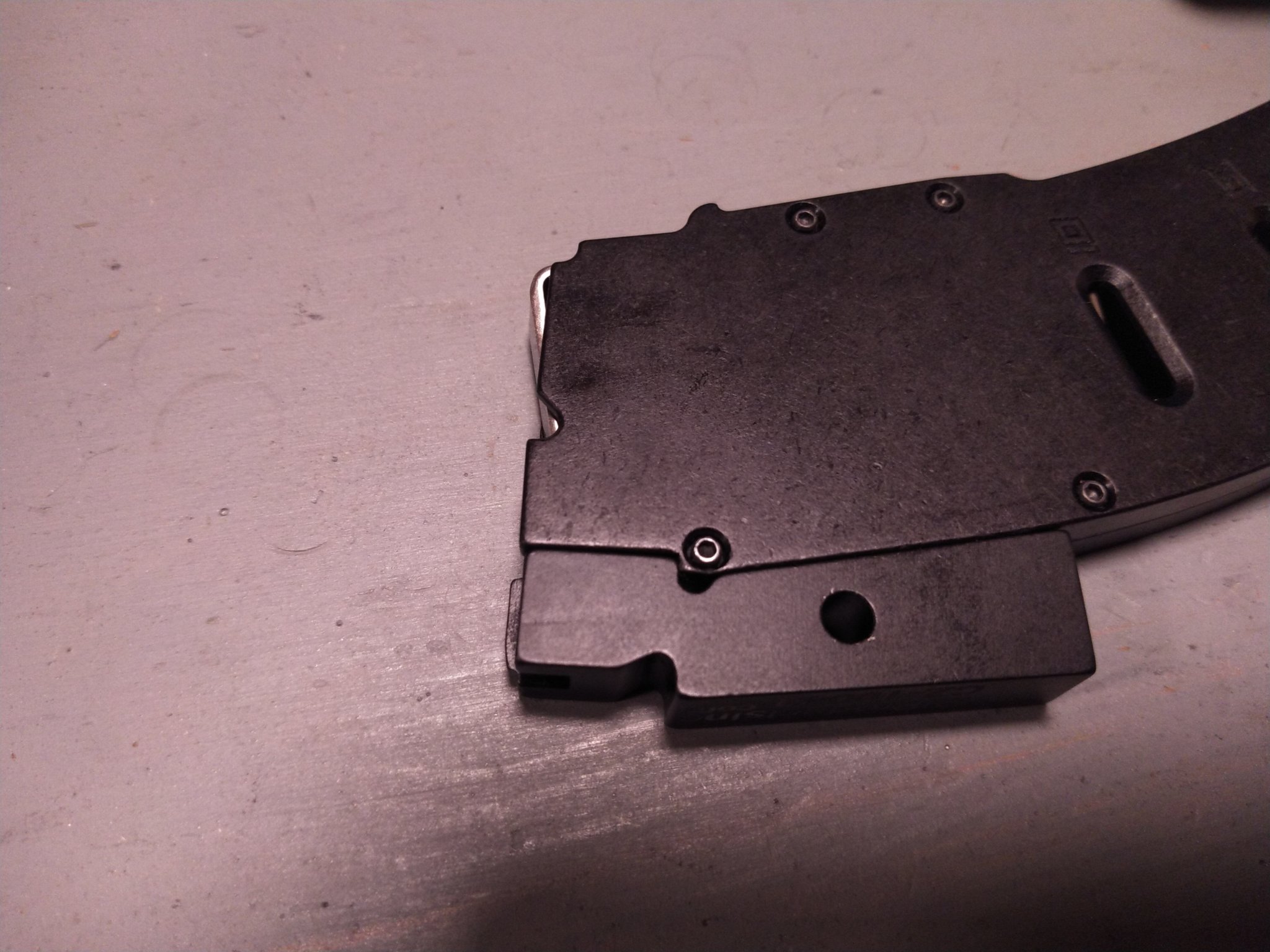

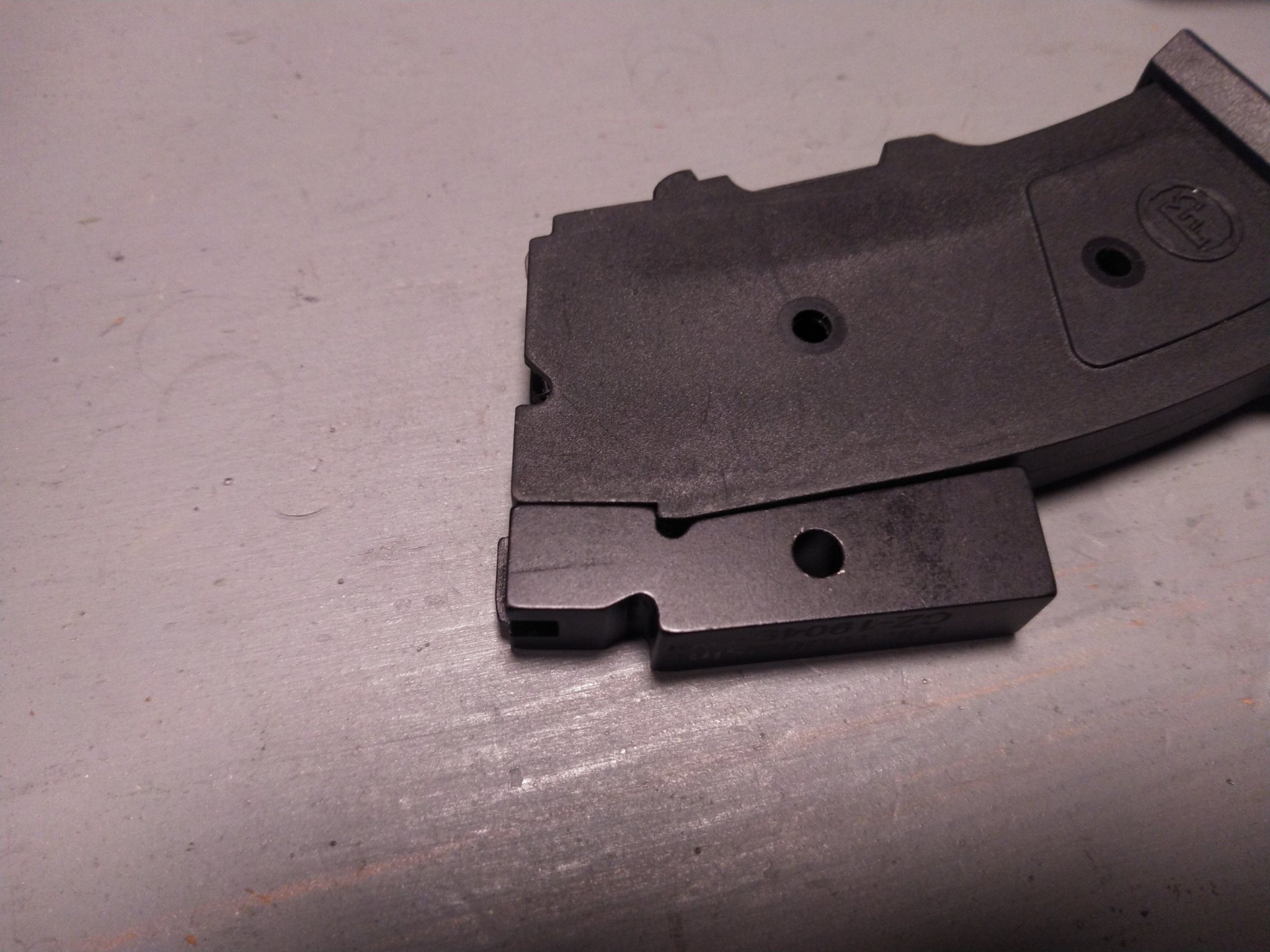

L3I can be inserted deeper than factory. Hasn't caused me any issues though. It might be exaggerated in these pics as when loaded in the rifle they look pretty flush.
L3I
CZ poly
It actually uses a version of the factory follower that we recreated so if you toss in a factory follower and it runs well then that's the answer. You can tweak the follower by bending it slightly but not sure how comfortable you are with that since it's kind of a weird art form of troubleshooting that guys used to have to do with steel magazines lol.
