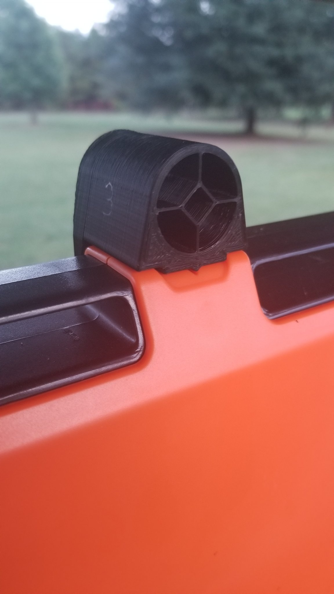

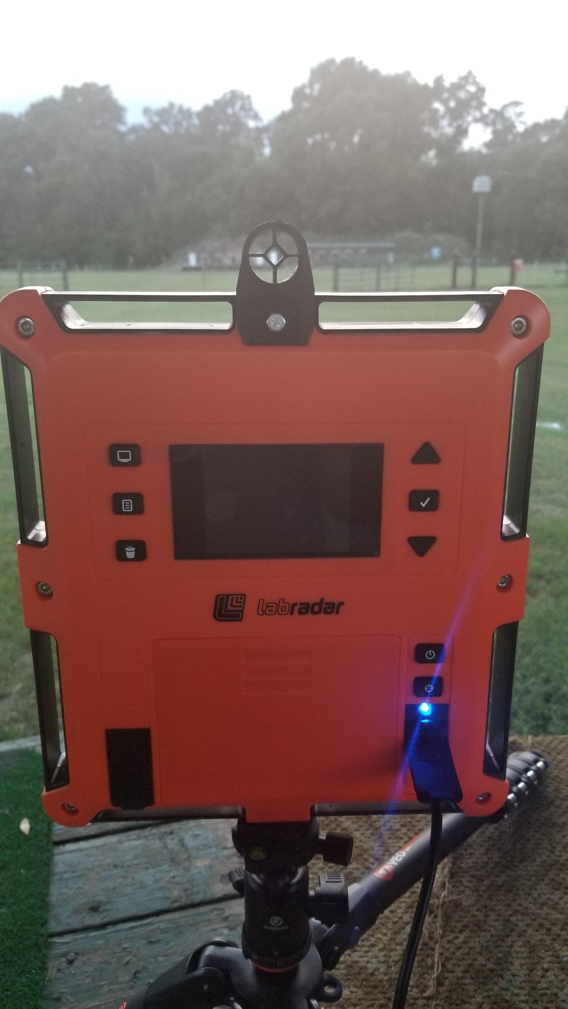

You could 3D print one just like this one.
The 3D file is available link to 3d file here

Printed one from the link I had in my post. Send me a PM with contact info and I'll get it off in the mail. I've cursed my Labradoodle so much about aiming the damn thing, I'm happy to help out.

The v-nut sighting in "accuracy" of the Labradar did really piss me off, that's why i made the (original) crosshair sight as an addon.
Find attached a volumetric model (step file- most CAD programs are able to read step files) of the original design.
It is easier to use a volumetric model than a stl file as a base for modifications.
Feel free to use, modify, print it.
Have fun.

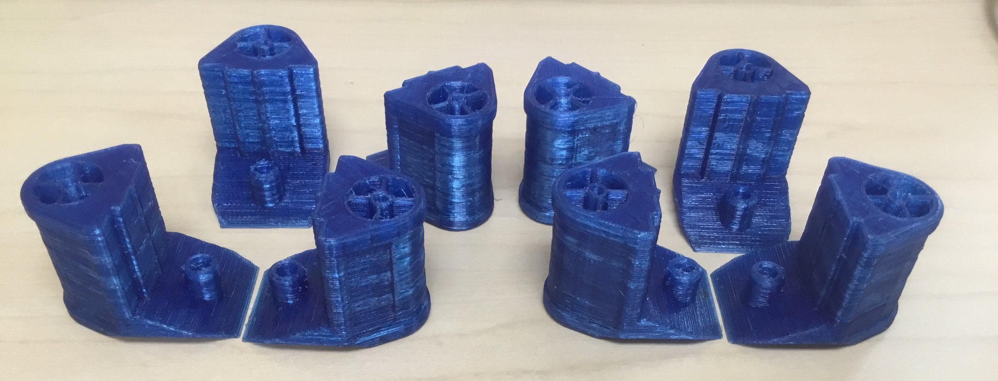

So I got the OK from AIR and the WT808 on Thingiverse to print them and recoup the shipping cost. I have 8 people that requested a copy. One of my printers went down, but the other one churns one out every 2 hours. Three done, one on right now.

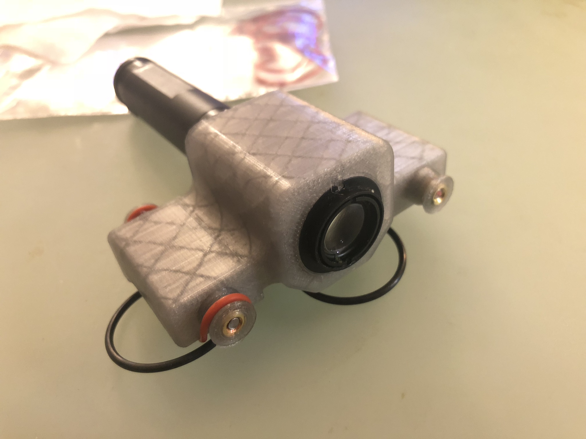

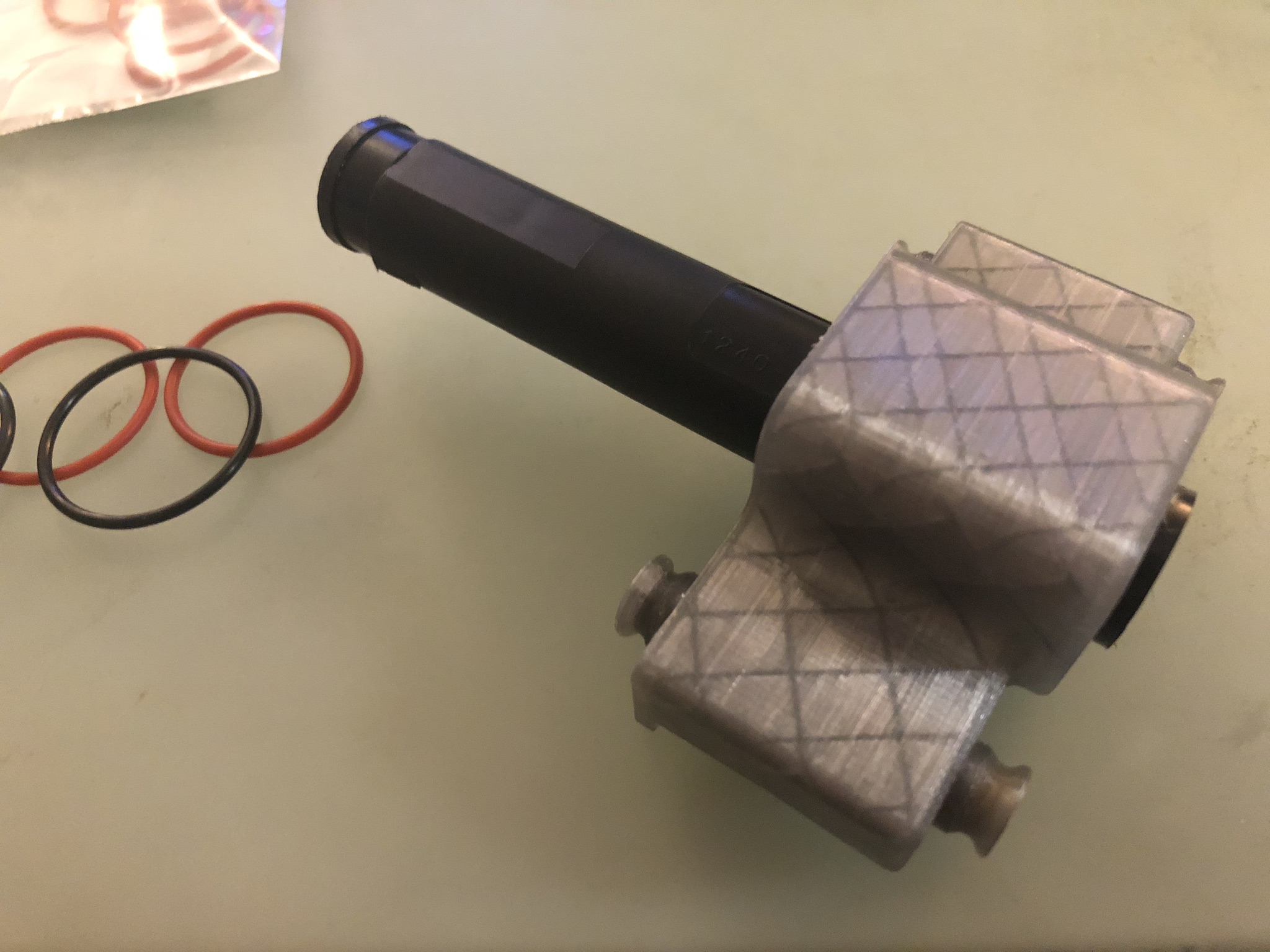

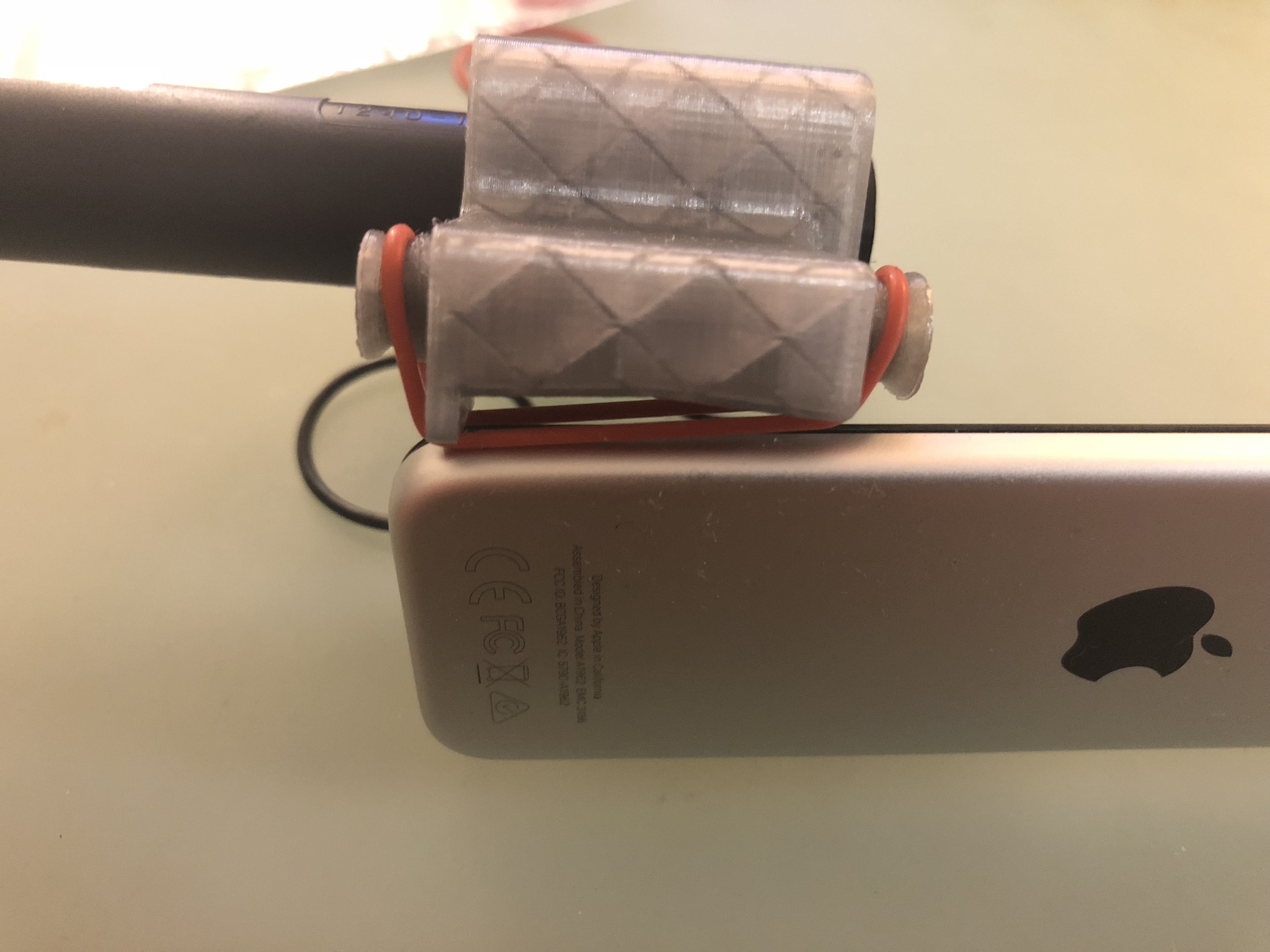

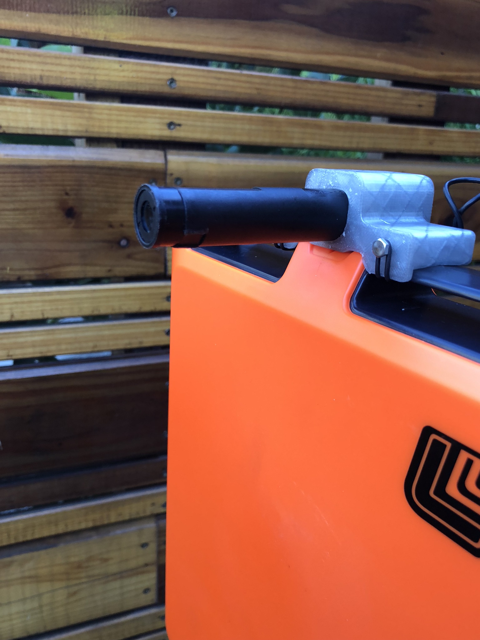

I've had a similar issue, and it was most annoying with a pistol actually. I originally used a G36 optic tube in the notch instead of the straw, then designed and printed a mount. I still have a little bit of work to do to finish up the caps for the tension mounting.

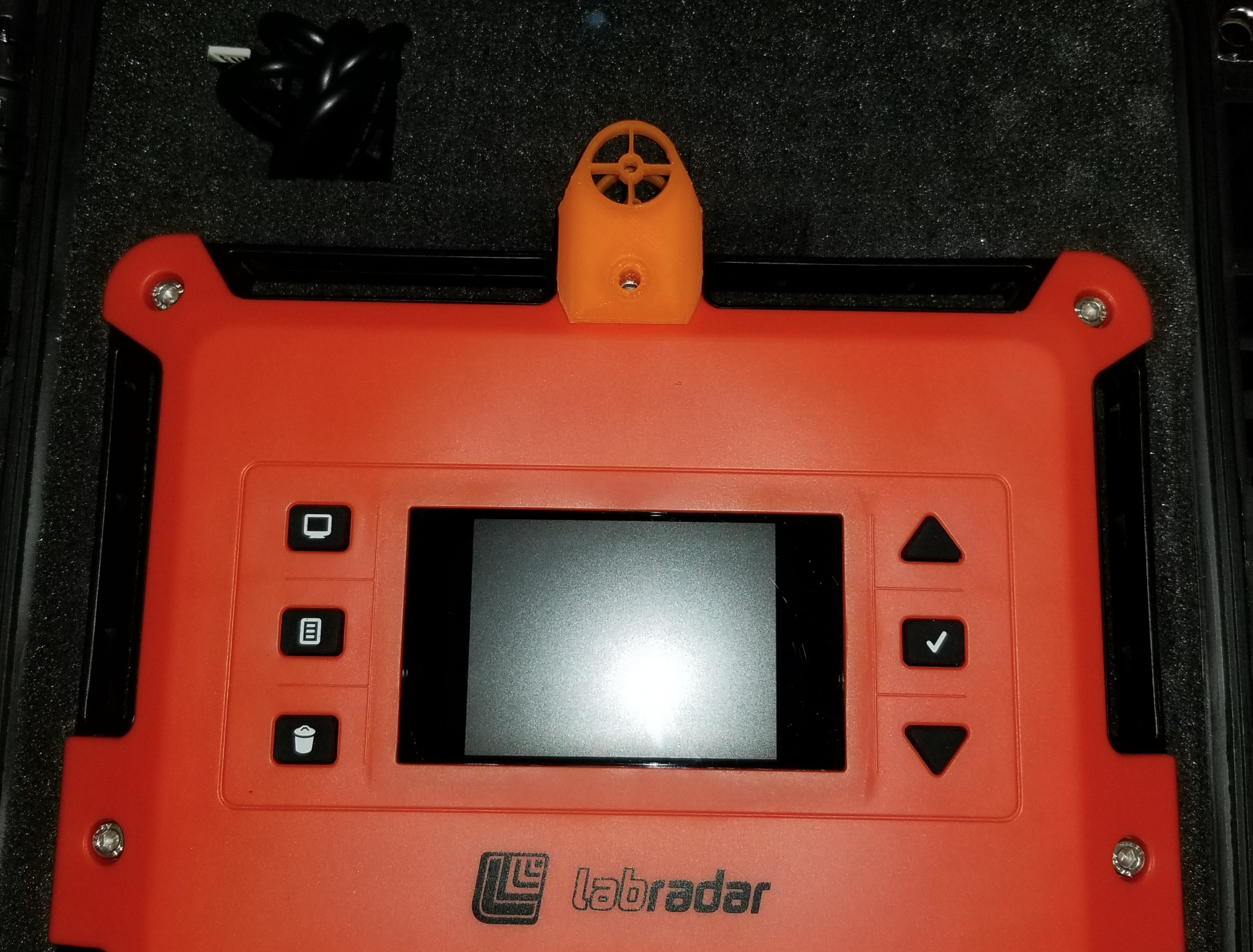

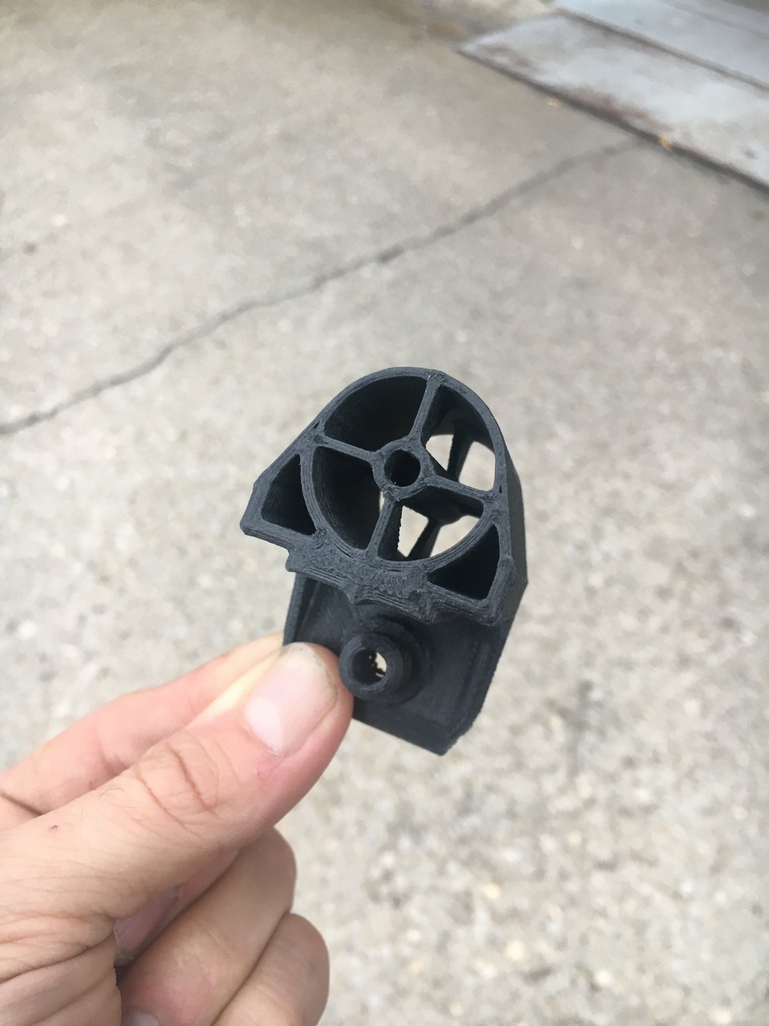

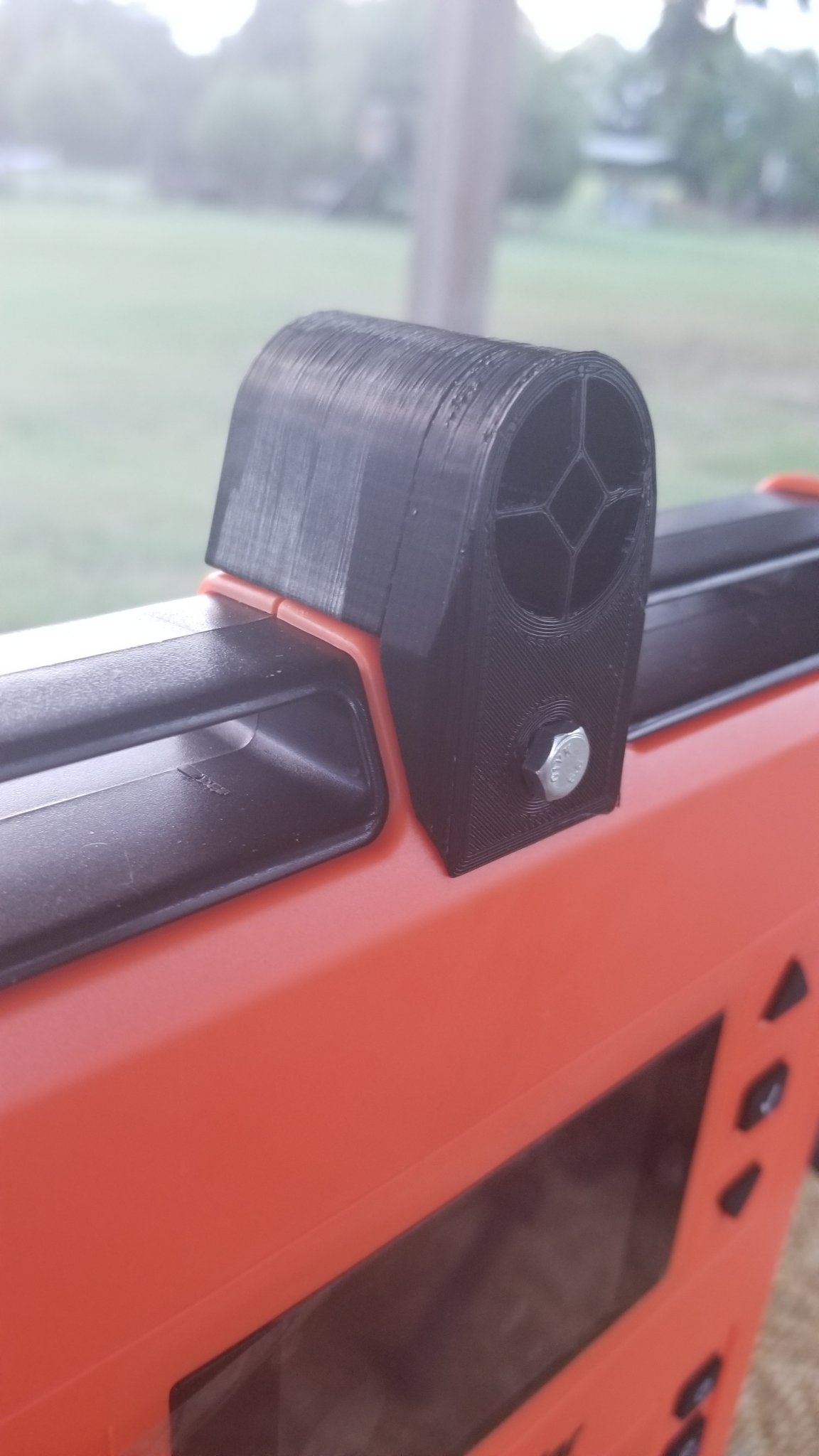

Here's a prototype I tested. He's making some tweaks based on my feedback, but hopefully coming to Amazon soon. It's similar to the Thingiverse one.

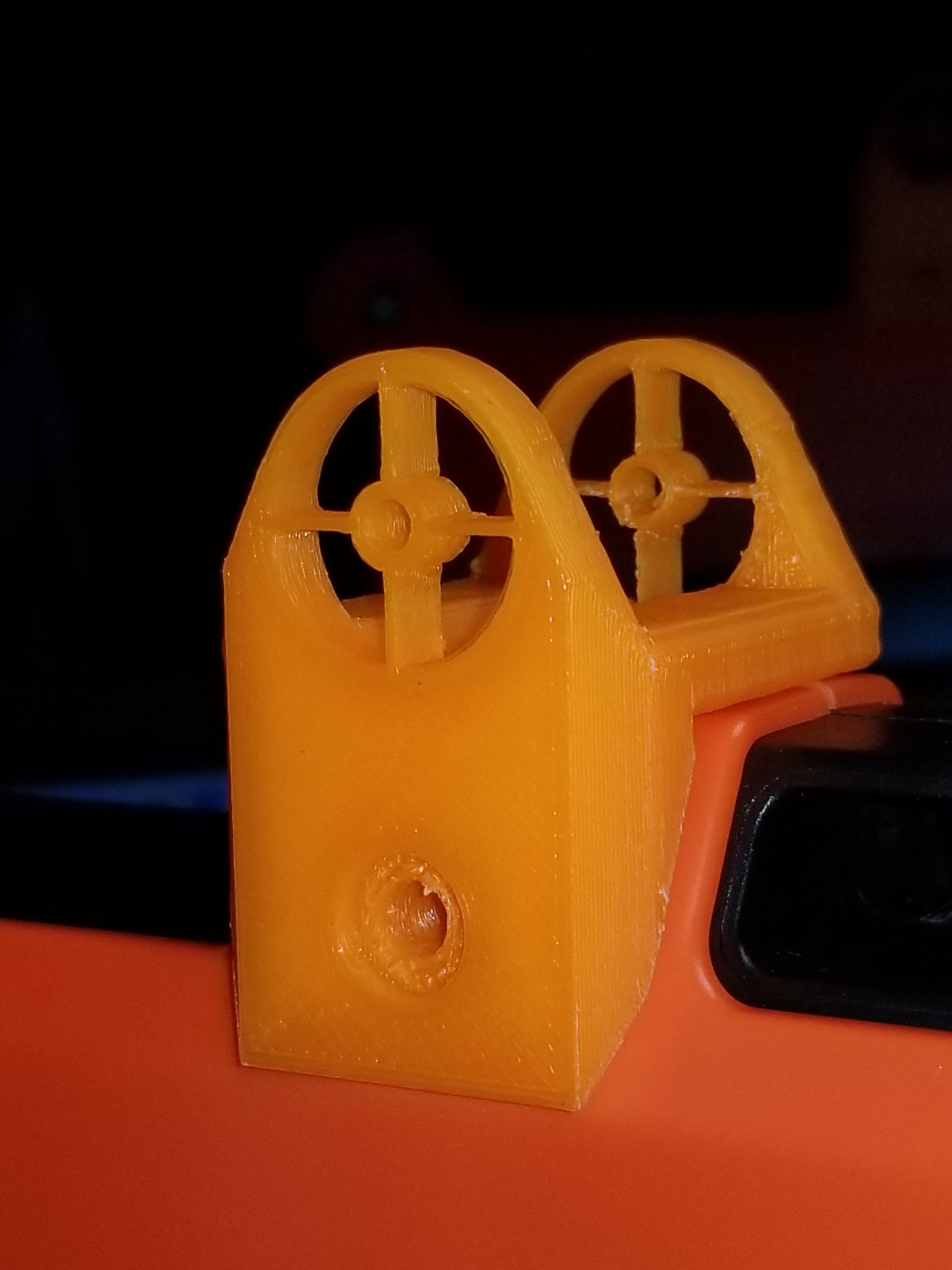

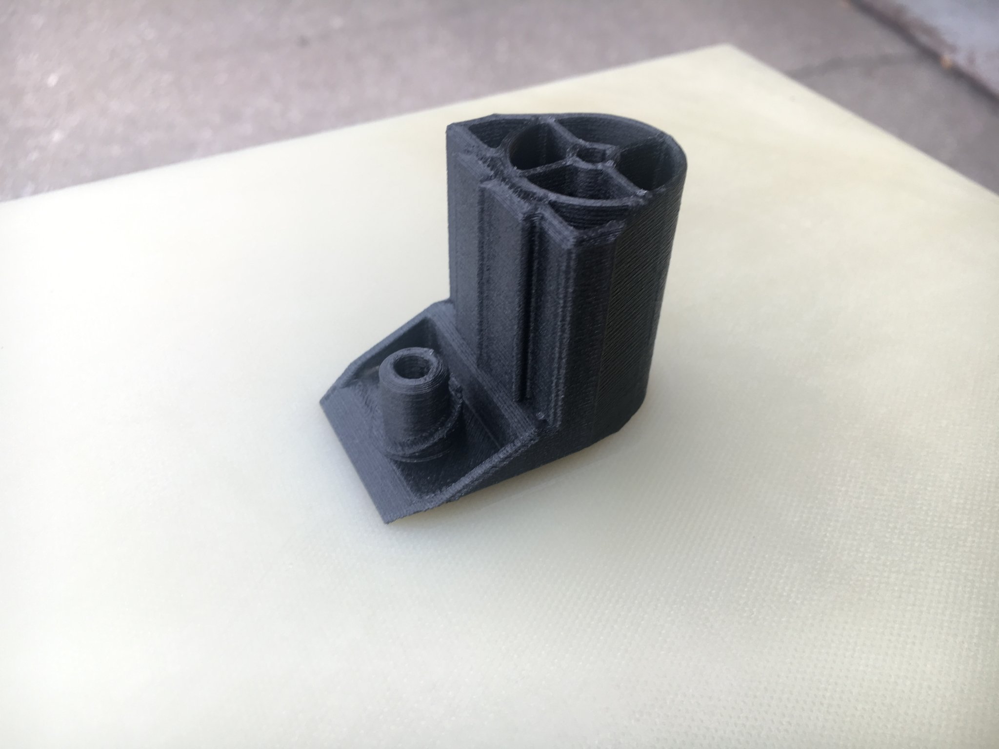

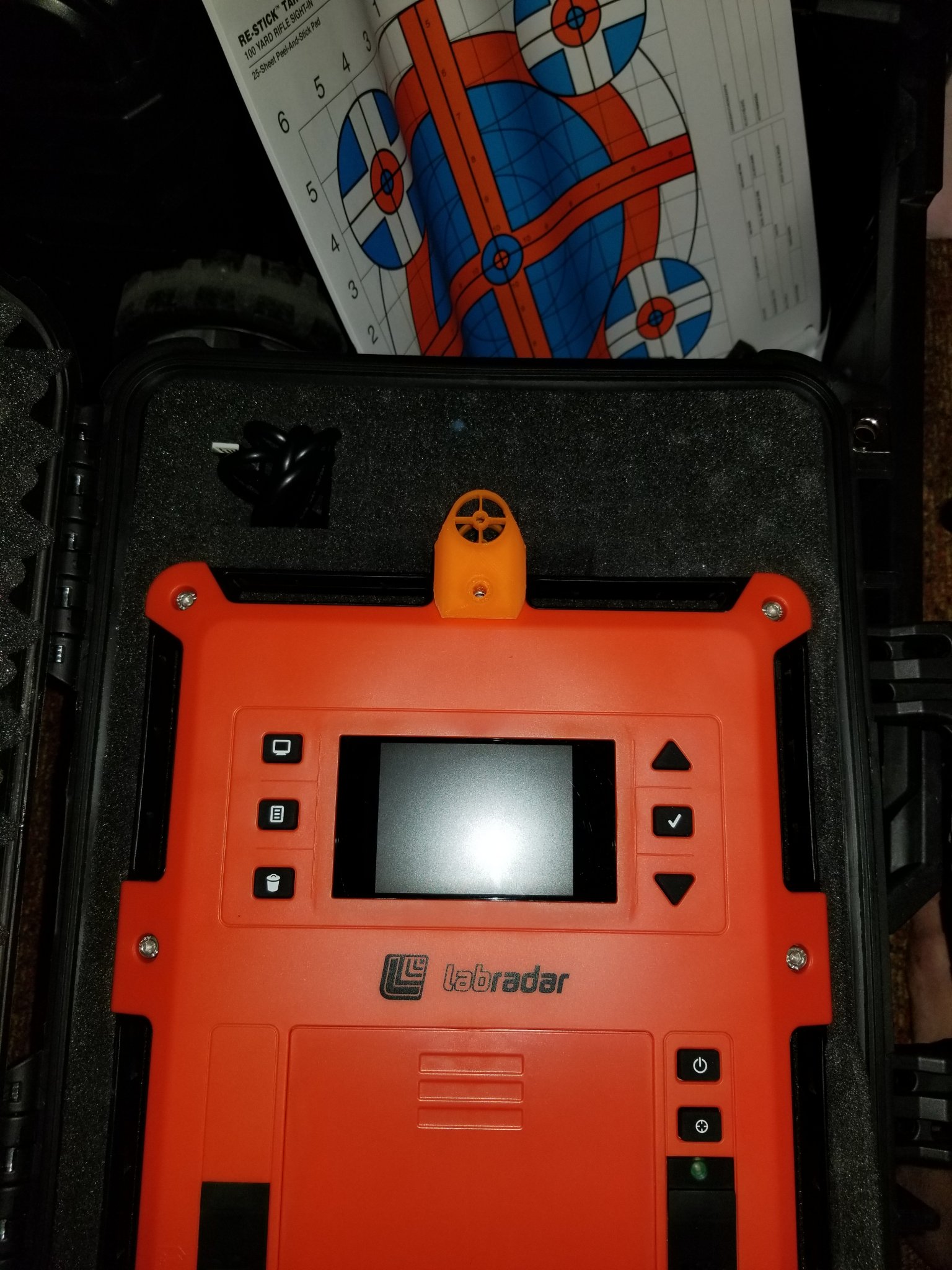

My design is pretty finalized for the first round of testing. I've added some reinforcement for long term durability, including bronze bushings and heat set threaded inserts. I'm playing around with the idea of making a version with a powerful green laser, but I don't think I'll be able to see it at 100yds.
Reactions: Bull Arms
Nicely done, those brass inserts are what I use on my products. I drive them in with a hammer, used to use a soldering iron. What material are you printing from?
Reactions: dfaster
Thanks, yeah these are my favorite inserts to use. They line up great, and they're really strong when you back them up with more than 2 walls. I like using these, and also those expanding inserts with a flange, but I'll use heat to set both of them for some added strength.
This prototype is in an HTPLA for ease of printing and speed, but I do my production parts in XT or PCPlus
Send me a PM if you wanna talk printing! Not a lot of folks making production stuff and I'm interested in talking further.

I didn't do much post-print work in these. I find a 22lr brush helps to get rid the 'string-ers' in the aiming area. Might need a razor to clean up bottom edges.

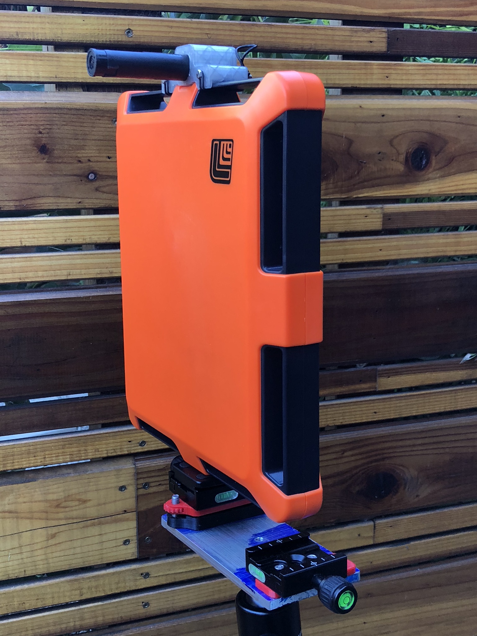

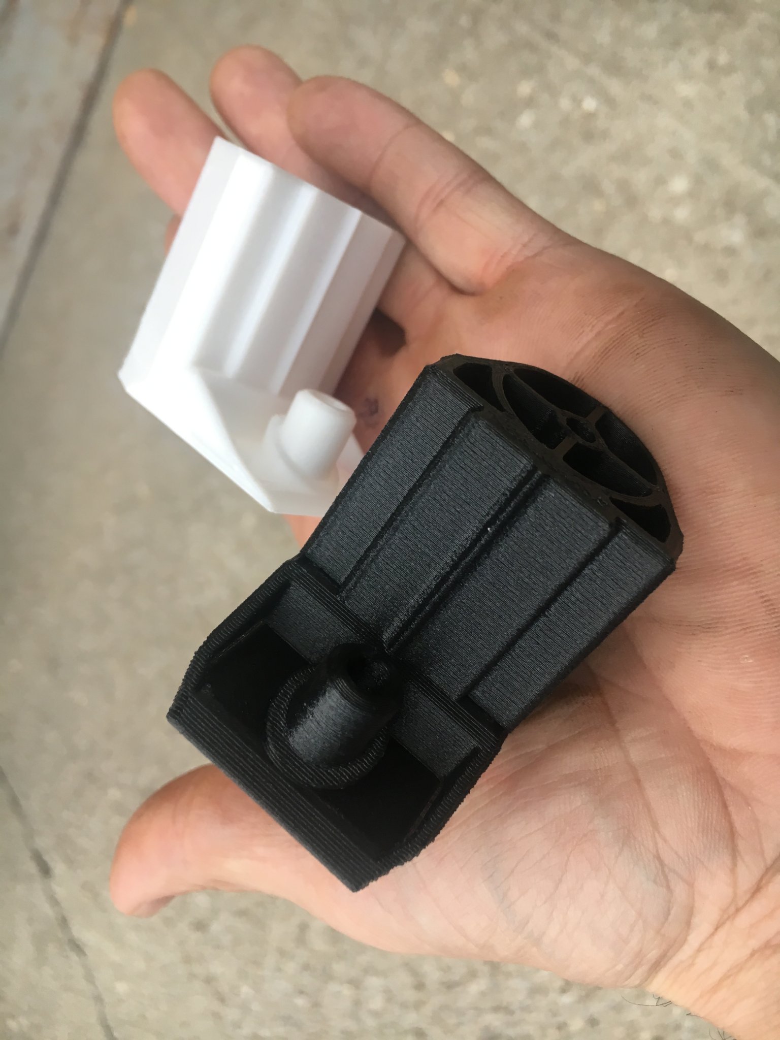

Made some refinements to the design. Here's a few from polycarbonate and a custom carbon fiber/nylon blend I get extruded, they printed nicely, I think they're good to go right off the bed but need to check fitment. Will stand up to about 250f-300f if you end up shooting on Venus or something.
It's a single piece minus the screw.
By the way Tyler, those refined ones look terrific! I like how you reduced filament without compromising strength. I still think the outer sighting ring could be half that size to lower the overall profile. Every inch counts in the storage case. I want an enlarged battery door that will allow me to put my power bank in the battery compartment. Velcro works, but I'd prefer a more permanent solution.

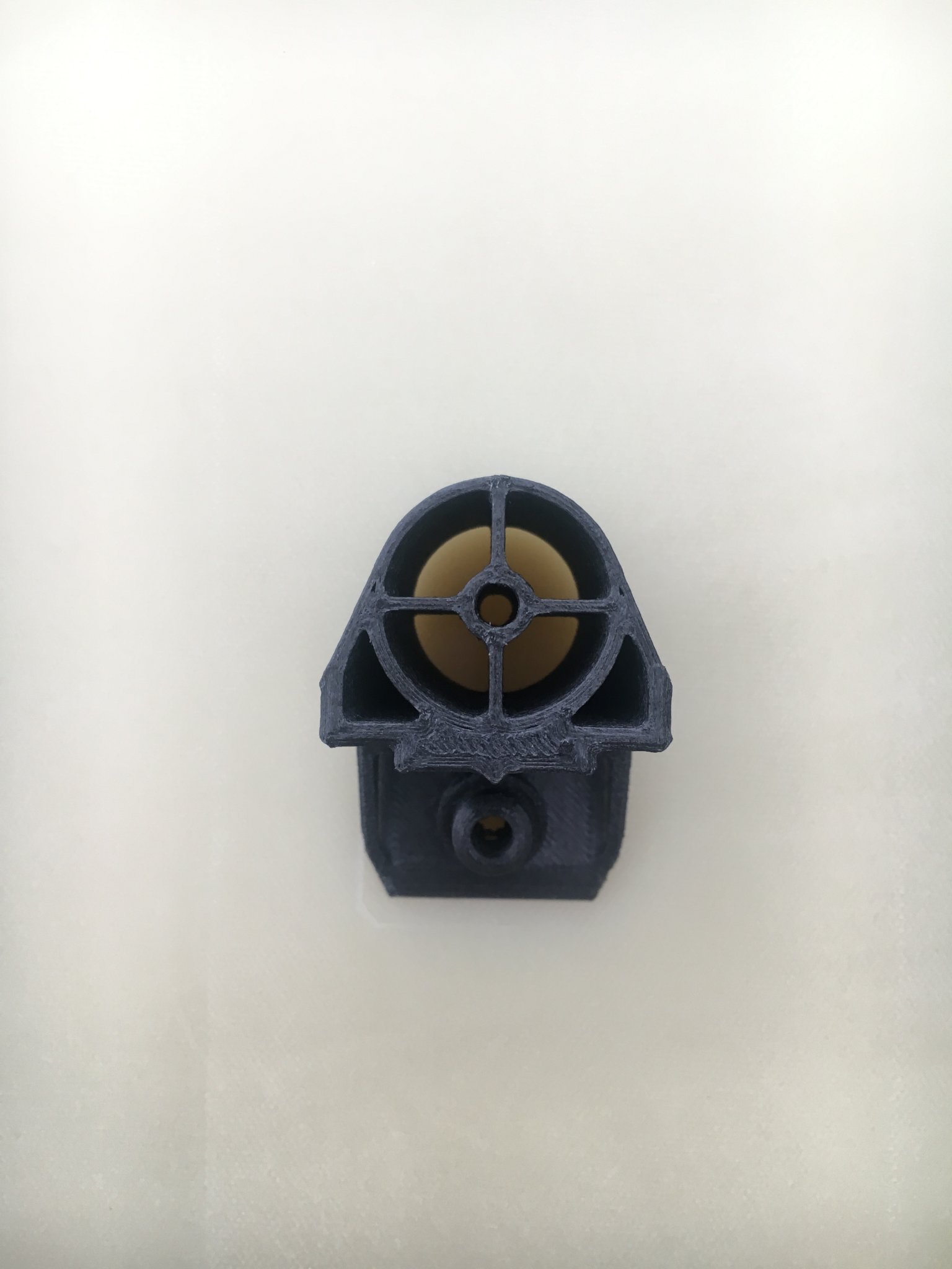

Got mine today. It looks great, thanks for sending it! I hand turned a small drill bit to clean up the "hairs" and it turned out very good.
