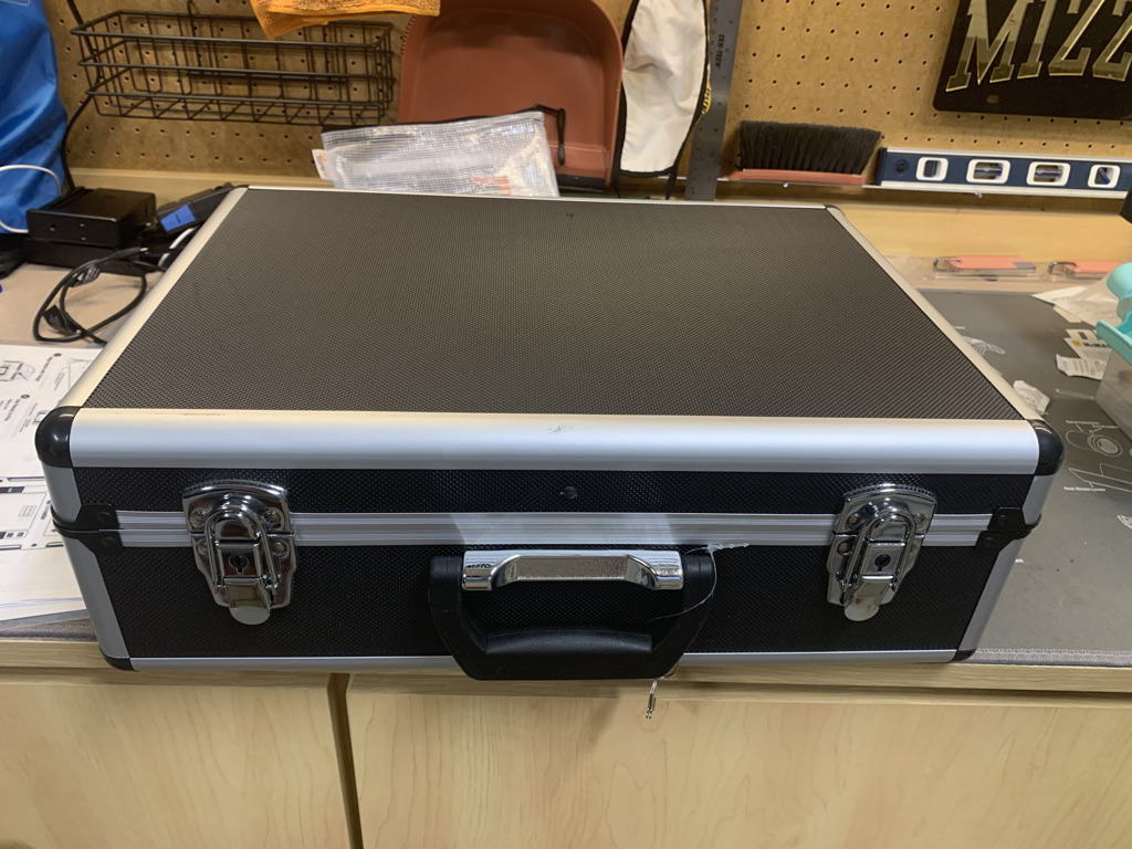

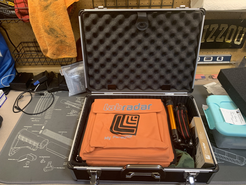

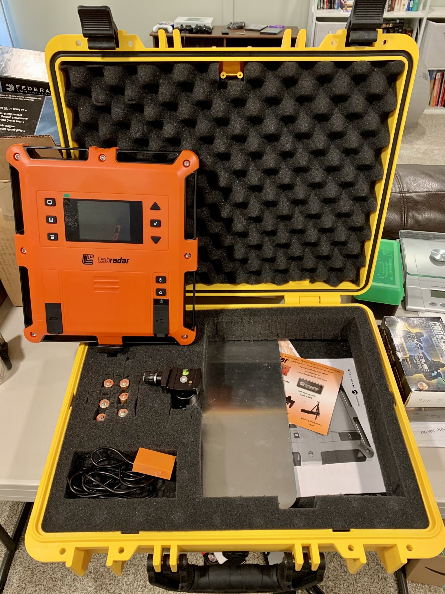

Since we are talking accessories I will show what I use. I bought the soft cover from LabRadar and after reading all the delicate properties of the unit decided I wanted more. I had the padding in the LabRadar bag but nothing to soften a blow or something falling on it in my truck. So I bought a tool briefcase from Harbor Freight. It fits perfectly and will also hold the battery, cord, air gun trigger and tripod. I took all the padding except the top layer and took the tool holder out of the top lid. I don't think it is really an aluminum case it's some kind of fibreboard. But is'a $29.99
https://www.harborfreight.com/18-in-x-6-in-x-13-in-black-aluminum-case-69318.html
I did something along the same lines. I bought the hard plastic case online for around $40 and it came with the foam. The foam was perforated 3 in an inch so I just removed the ones I wanted to. I’m able to fit the stand plate for the Labradar underneath. I’m currently setting it up for the external battery addition. I love Labradar’s.

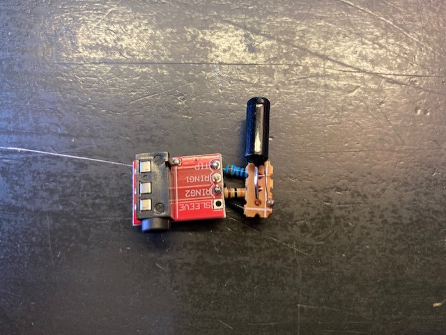

Any sophomore EE student could design that in an afternoon and there are a hundred ways to do it. I used a $0.50 "shake switch" and a couple resistors to make mine. For more $$ you could use an accelerometer or a MEMS if you only wanted it to respond to acceleration in one direction. Or you could add some de-bounce circuitry to make it more reliable on a rimfire application.

My recoil trigger:

My recoil trigger:

My recoil trigger:

What case is that?
I did something along the same lines. I bought the hard plastic case online for around $40 and it came with the foam. The foam was perforated 3 in an inch so I just removed the ones I wanted to. I’m able to fit the stand plate for the Labradar underneath. I’m currently setting it up for the external battery addition. I love Labradar’s.View attachment 7587570View attachment 7587571
I've been looking for a case , but not quite sure what size I need yet. Wanted to store my battery pack, trigger, LabRadar, and LR tripod. I guess I could just lay it all on out and measure. Not sure if the Apache 3800 or 4800 would be better.

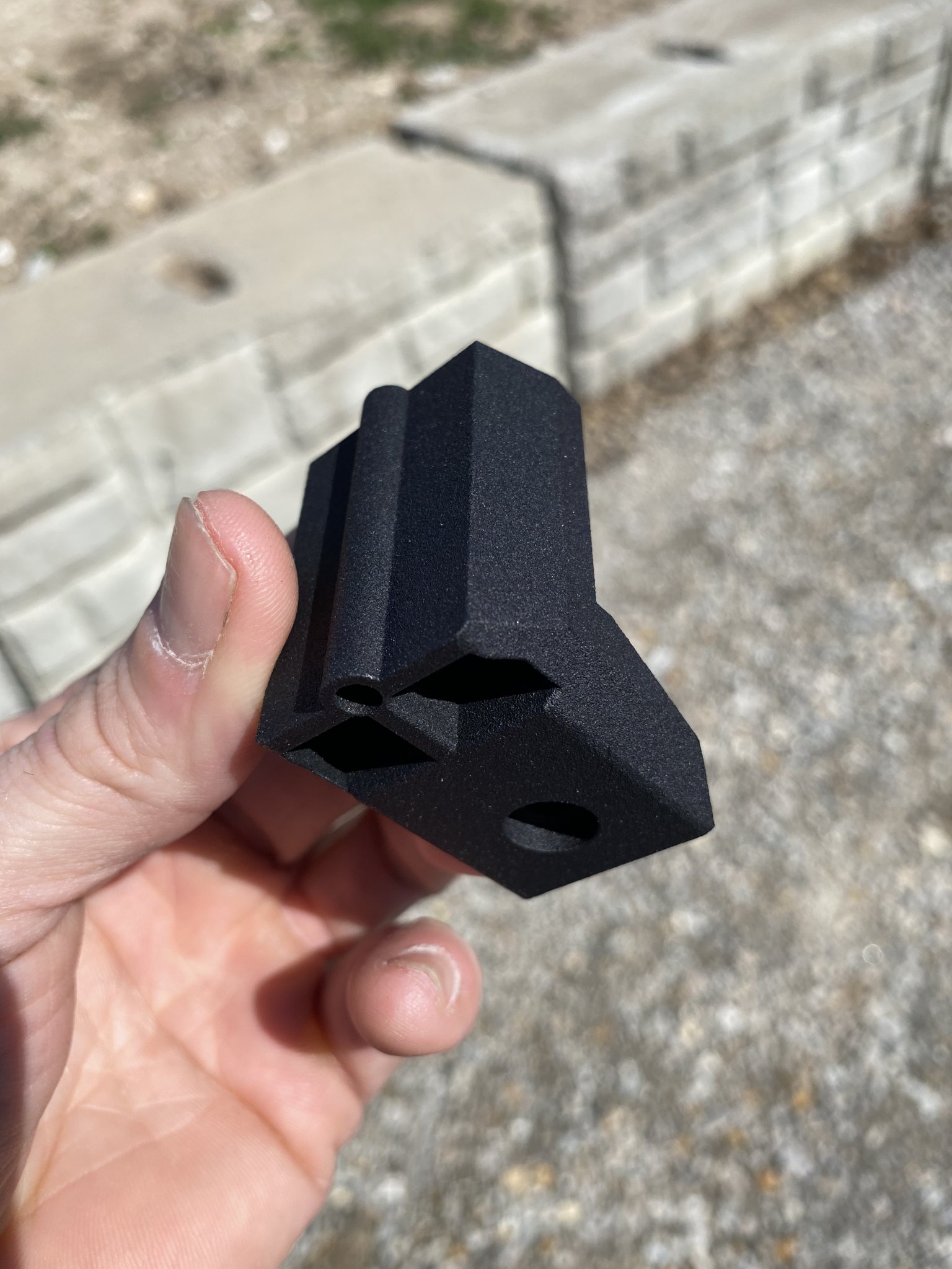

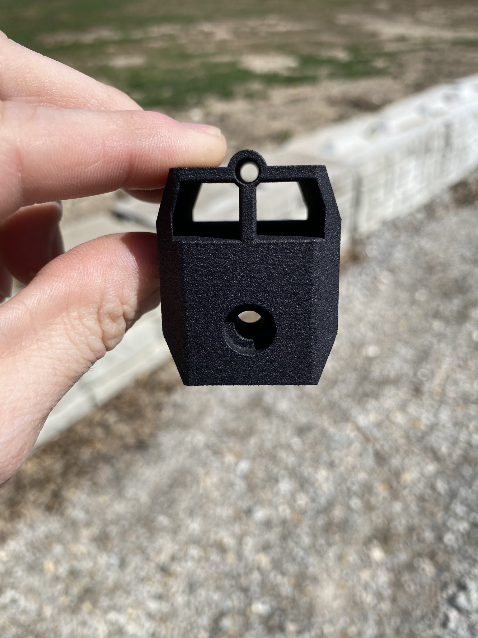

You will especially like my sight now. Just revised the design and started making it on my MJF! Very very nice and you would never guess it was printed.
tfw you buy your LR from MKMachining and they upgrade it shortly after you order, but before you even get to use it, haha.
What case is that?
I have mine in a 4800. LR, tripod, battery pack, trigger cables etc. Swapped out the factory foam for better stuff off amazon.

Hi Tyler - I have your OG site and what are the improvements w the new one?
seem very similar w the only diff I can see being the config of the supporting structure for the peep hole.
thanks
bit less obstructed area around the center hole, and made on the new machine so it's just...nicer i suppose? functionally, not much different.

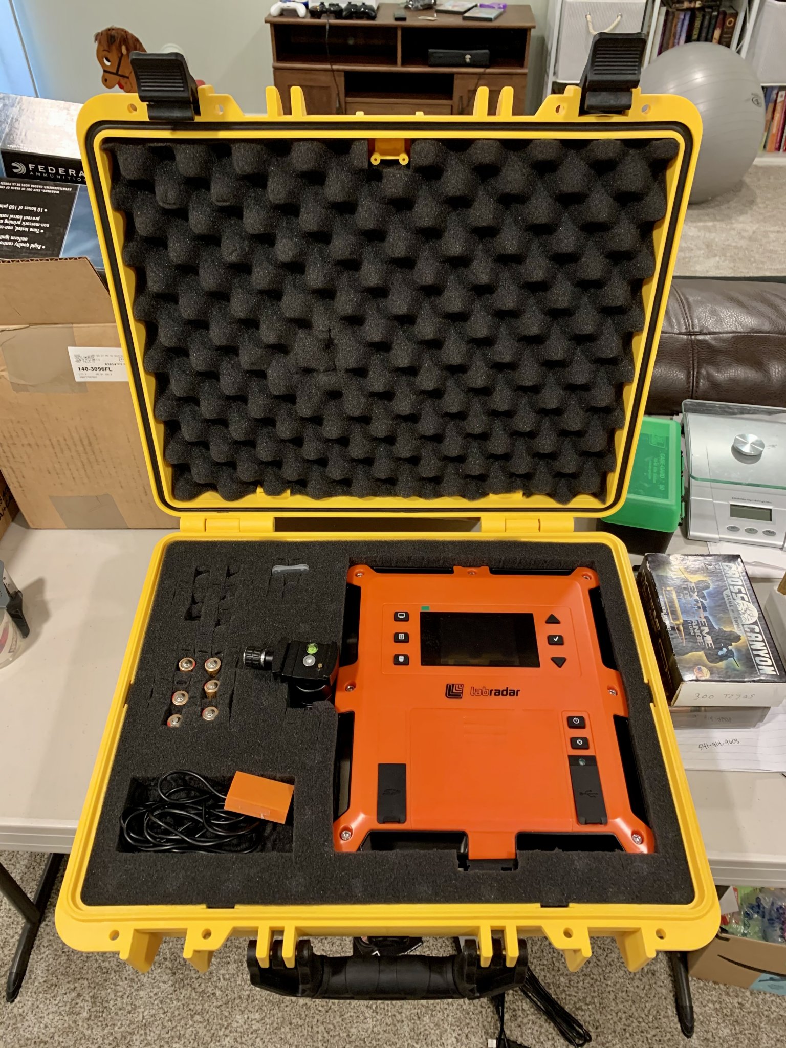

What case is that?
It’s made by PureOutdoor and I bought it from Monoprice for about $40. I think it was on clearance..?
Just want to give credit to @Tyler Kemp on his new Gen LabRadar sight. Whatever magic he has going on with his 3D printer is pure vudoo. They absolutely do not look like any 3D printed plastic product I’ve ever seen, even the ones you wash or cure with chemicals. I can appreciate good work and want to send an unsolicited public compliment on a well-done job.
you can make a 12"x12" base for benchtop use super easy. use 3/4" plywood or melamine board. drill a 1/4" hole, countersink a hole to fit the head of a 1/4x20 thread pitch bolt, epoxy that in. wide and heavy enough the labradar won't accidentally blow or get knocked over, and can make with scrap wood in your garage/shop.
Thanks man!
We have all methods of 3d printing in house, and MJF is smoking good for replacing injection molded parts. Looks just as good, without the seam and infinite geometries available.
