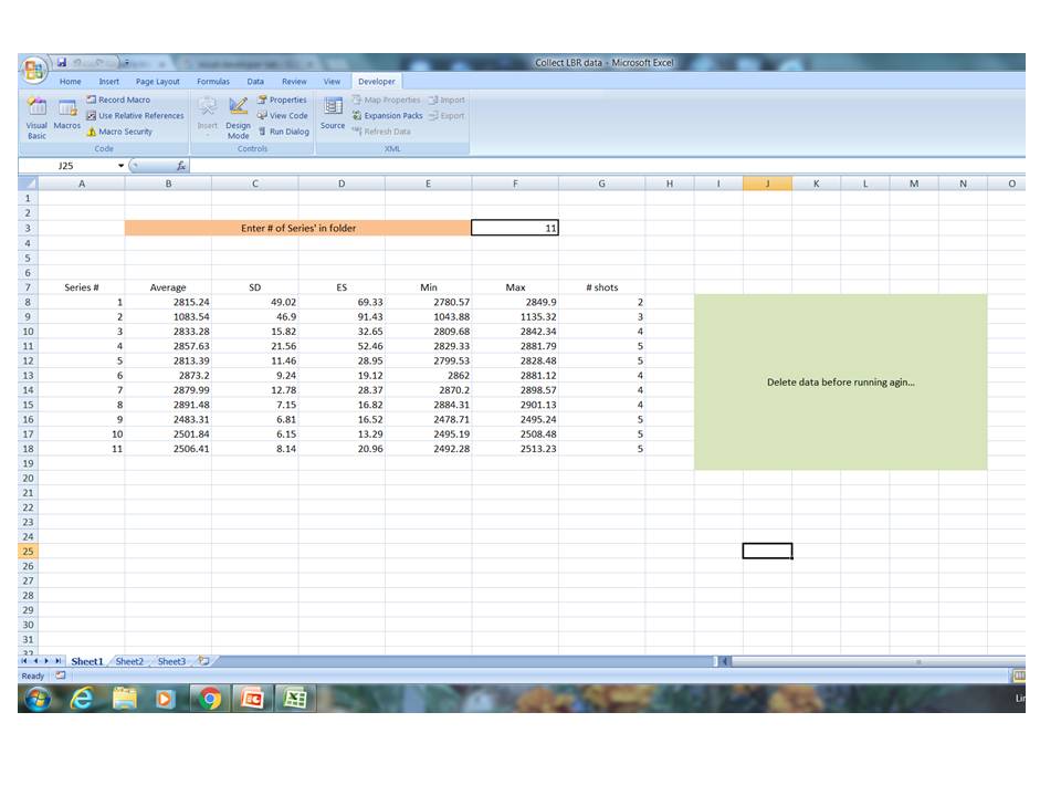

I got tired of having to open 10+ files to get the data when doing load development, so wrote this macro.. Puts Avg, SD, ES, etc from all folders onto one page.
Edit: See post #4 below first, got the file to save as a zip file.
Of course it won't let me upload an Excel spreadsheet.. so if you want to use it you'll have to figure it out.
- Google 'excel developer tab' and get the tab to appear in your tabs.. (up there with 'Home', 'Insert', etc)
- click on the developer tab
- click on 'visual basic'
- click 'insert' (up by file, edit, etc), and click 'module'
- copy/paste the whole module below from 'Sub.." to "End Sub"
- save as Macro enabled spreadsheet
- you can close the visual basic editor, hit the x..
- see the template file attached on what data will go where on Sheet 1.. make yours the same.. save it..
- when you open it in the future you will have to enable macros.
- copy the whole LBR folder from your sd card onto the root C drive... so it will be C:\LBR\...
- in Cell F3, put the number of series' that are in the folder
- back on the developer tab, hit 'Macros', and then 'Run'
- Delete old data before running again.. or save as something else.
- good luck.. hope you enjoy..
- Macro starts below..

Here's the macro spreadsheet in a zip file. Looks like it loaded ok, so to use it:
- extract the file..
- when you open the spreadsheet there should be a security warning. Click 'Option', and 'Enable this content'
- If there is no developer tab you'll still need to load it as above; load the developer tab, and go to it..
- save the LBR folder to c-drive as above
- put the number of series' in the c:\LBR\ folder into the space as above
- click on 'Macros', and Run
