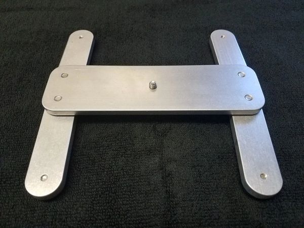

If you shoot with a brake and for better aiming in general I prefer this base:
The disadvantage is it won't fit in the soft case like the arcko one.

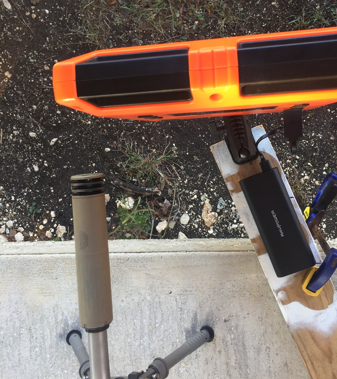

I have an external power pack just because after a time its cheaper than aa batteries.
I got a little camera clamp from amazon that I use to attach it to a 2x4. I have a couple little quick clamps and I can attach the 2x4 to any thing. I clamp it to my bench but Ive also clamped it onto tripod legs where a table isnt present.

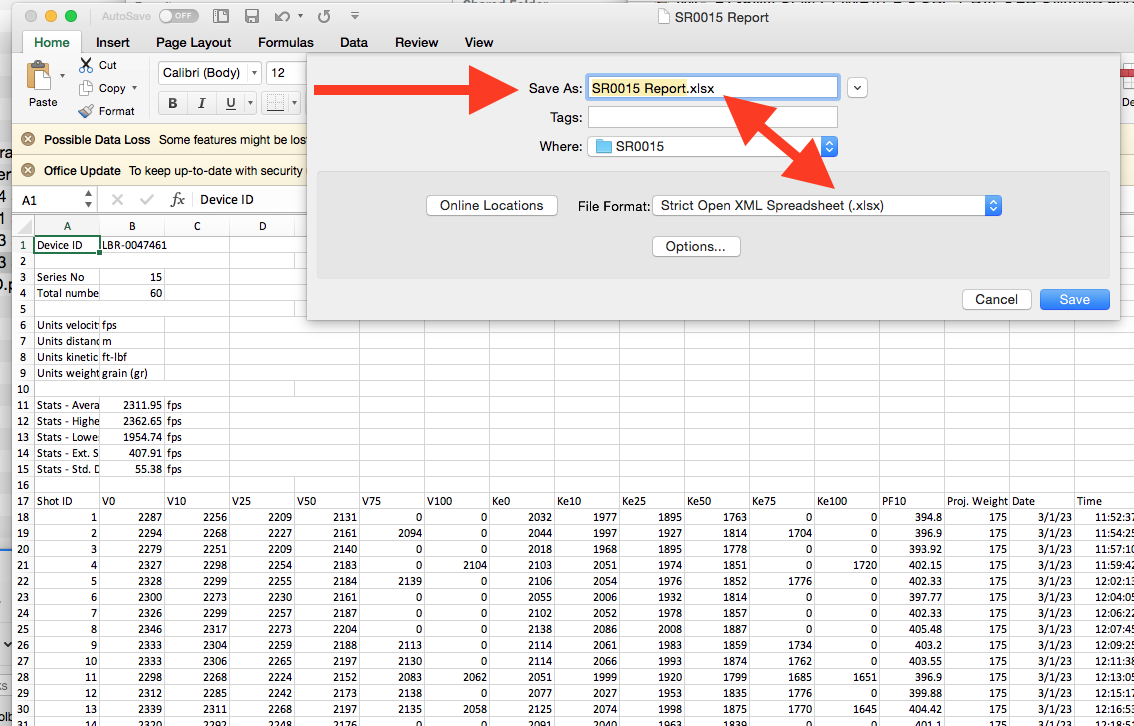

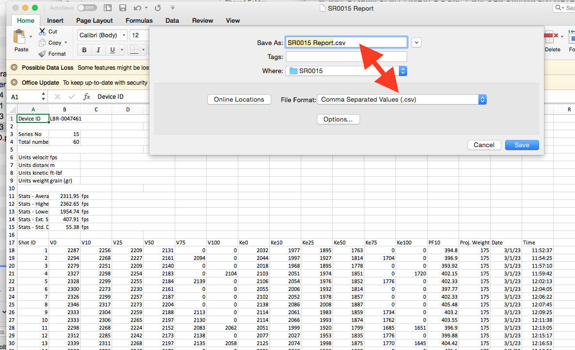

  • I record the action on the SD card and do all the manipulation and deletion of odd shots back at home on the computer, it's easier.

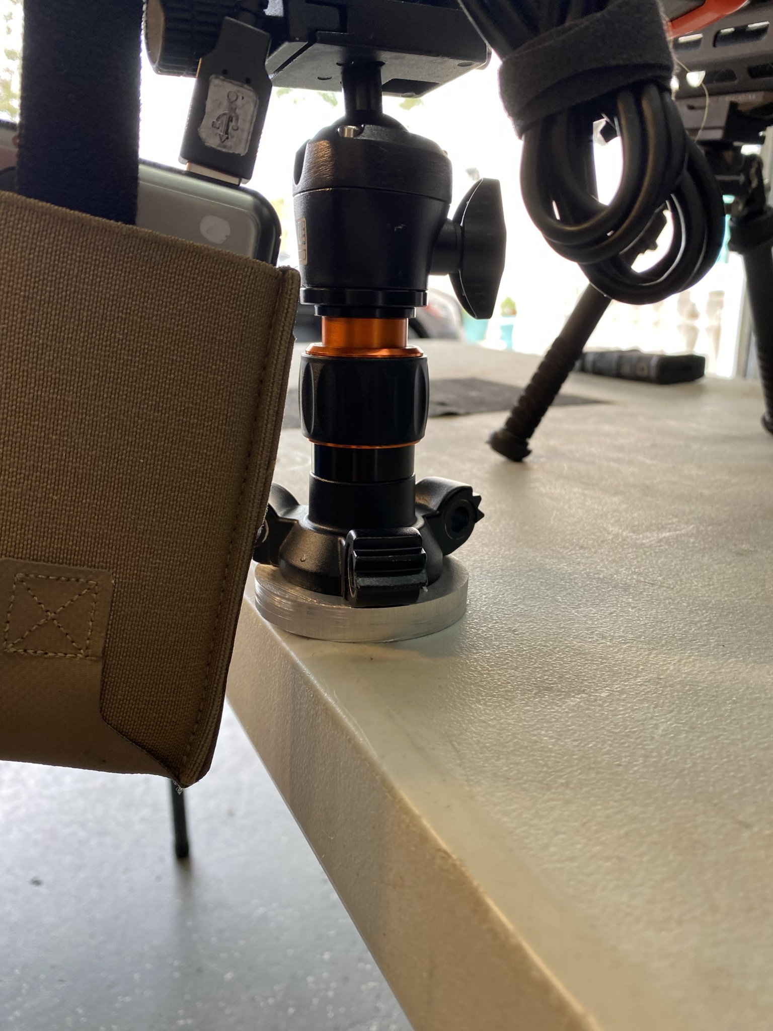

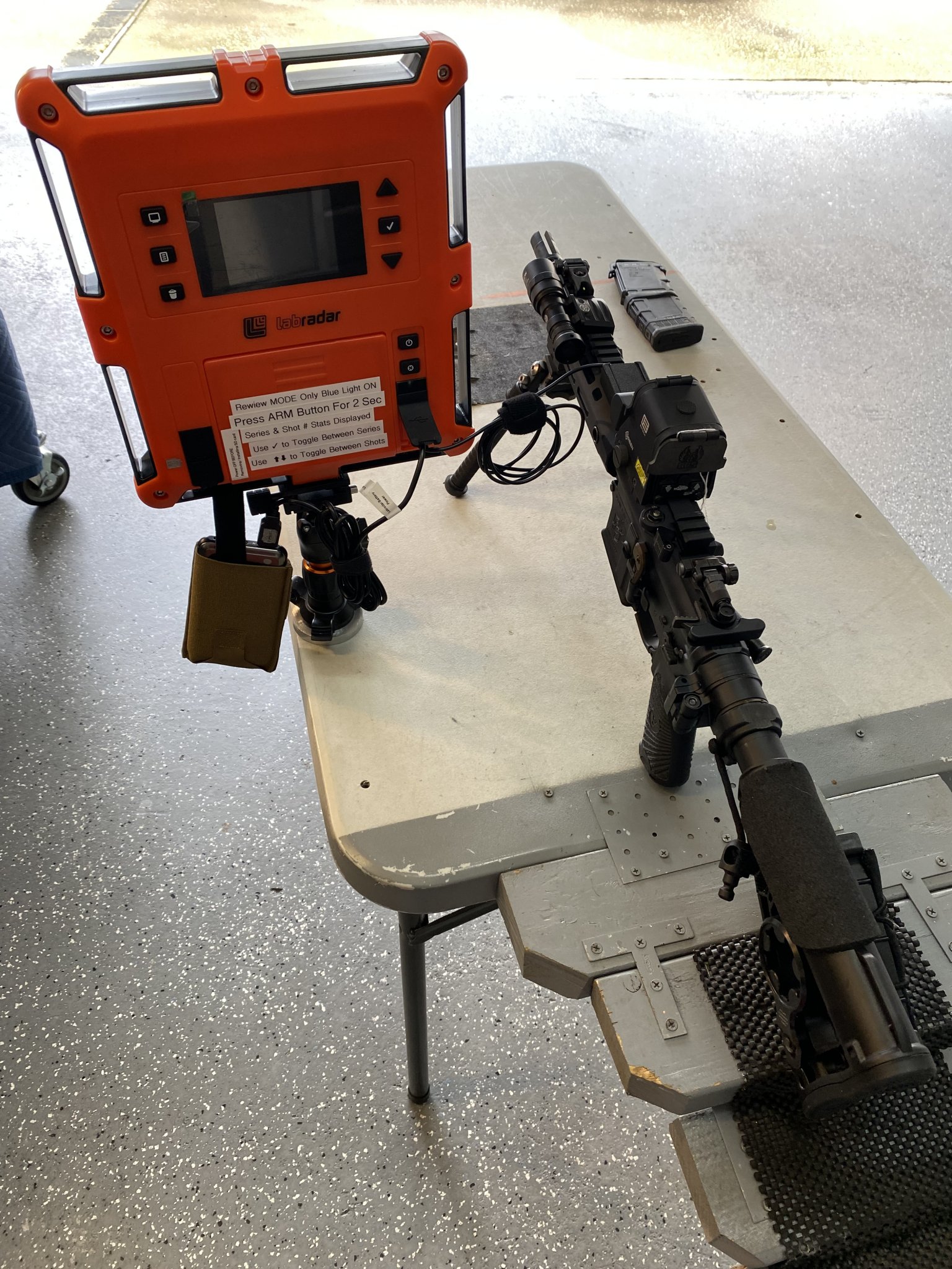

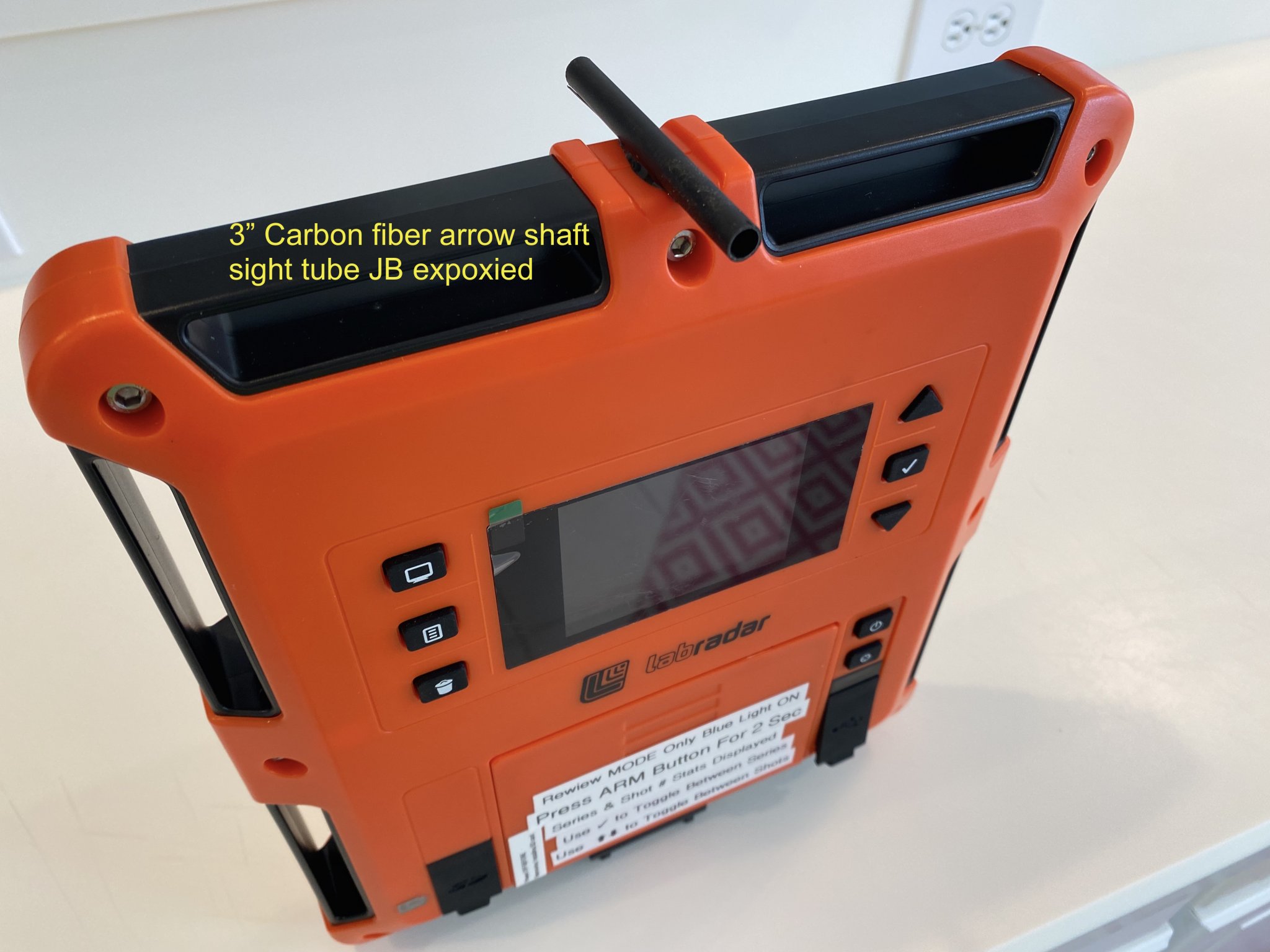

Just for fun expoxied a 3" carbon fiber arrow shaft for simple sighting device. Measured length to easily fit in original case.

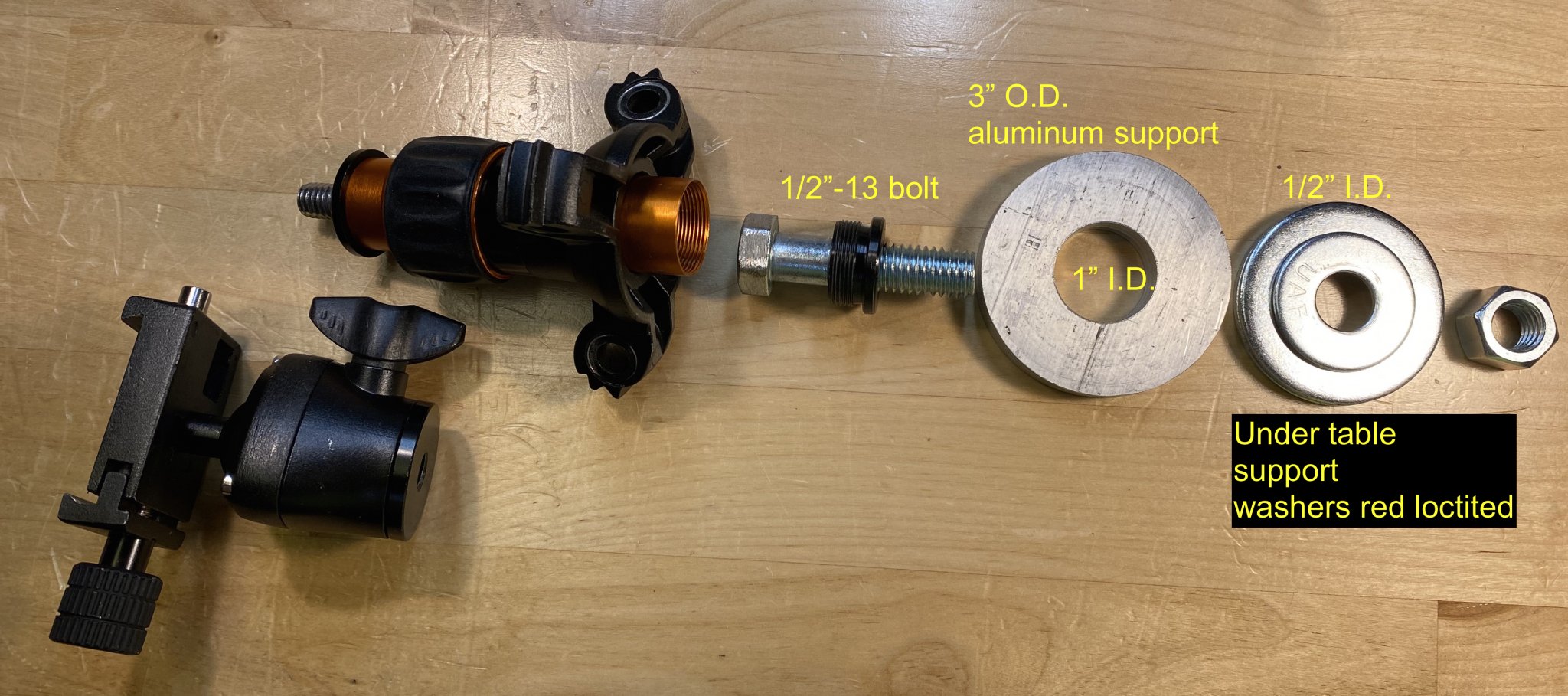

Use external power pack, ditched the factory tripod mount to use stable thru-table mounting and JKL Precision trigger.
IMG_5802LABRADAR TRIPOD MODIFICATION FOR  THRU-BOLT TABLE TOP 01.27.23 copy.jpg
IMG_5803LABRADAR TRIPOD MODIFICATION FOR  THRU-BOLT TABLE TOP 01.27.23 copy.jpg
IMG_5798LABRADAR TRIPOD MODIFICATION FOR  THRU-BOLT TABLE TOP 01.27.23A ANNOTATED copy.jpg

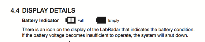

Must the 6X AA batteries be removed for the external battery pack to be used?
Thanks.

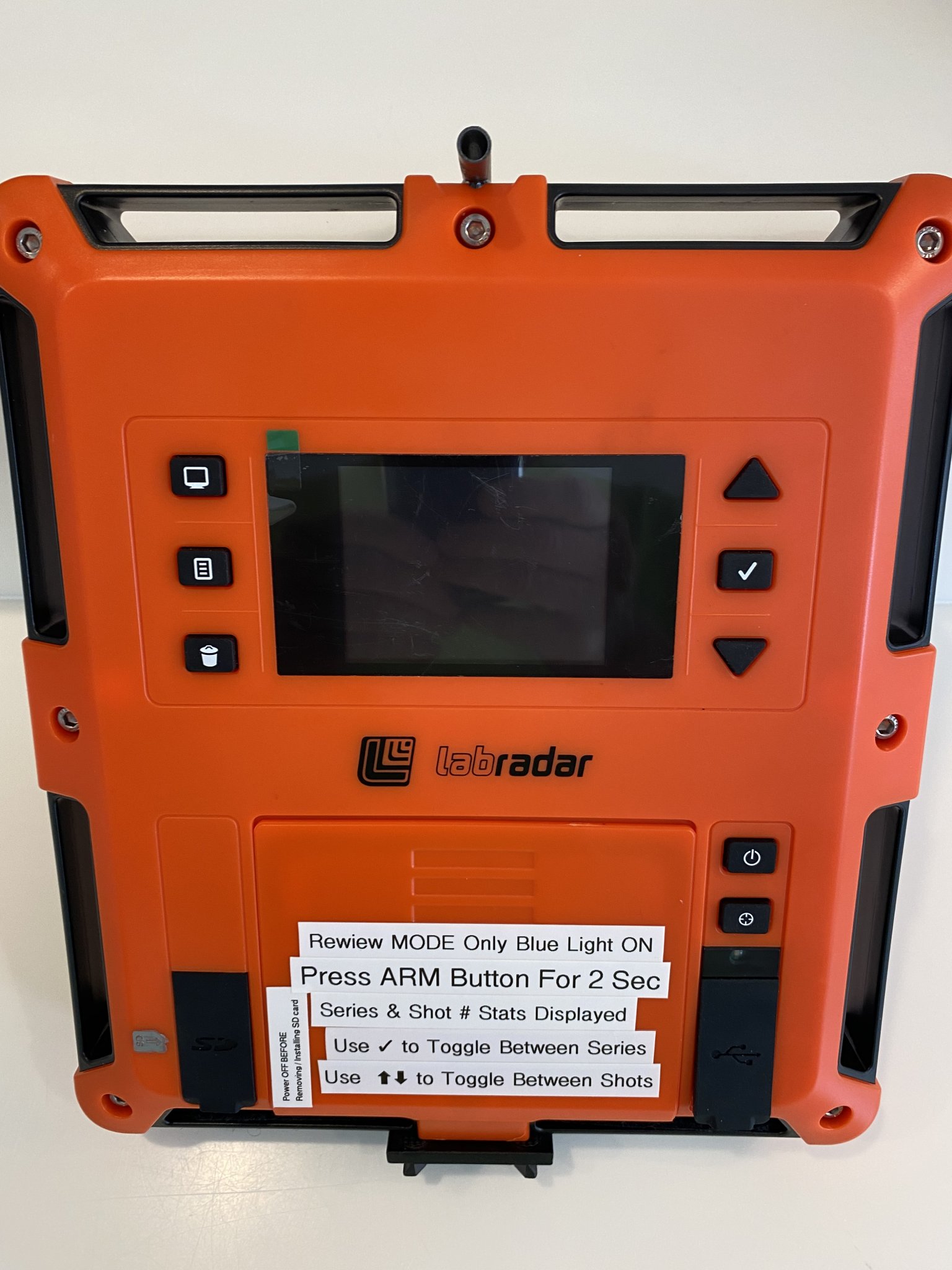

Apparently not. The AA battery icon appears when they are the power source. When external power pack is used, a different icon is displayed. When the batteries are installed AND external power pack is connected the icon for external power is displayed, presuming it trumps the AA batteries when both are present. I have only used an the LabRadar external power pack and it has been flawless. IF I were to use AA's I would only use lithium batteries not risking the device vitality to unpredictable alkaline vomiting. The Manual does not offer any information to answer this specific question.
Reactions: Baron23

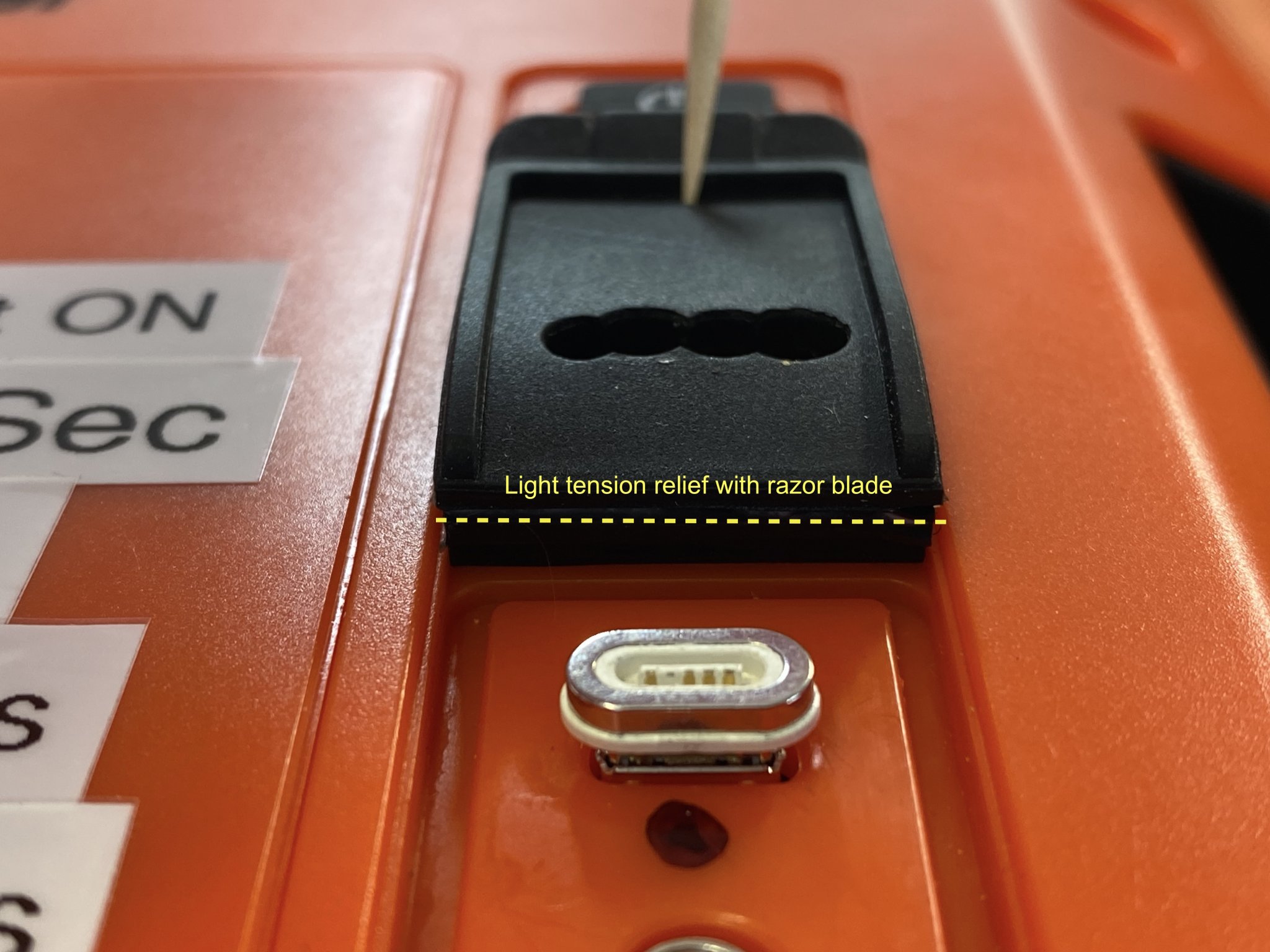

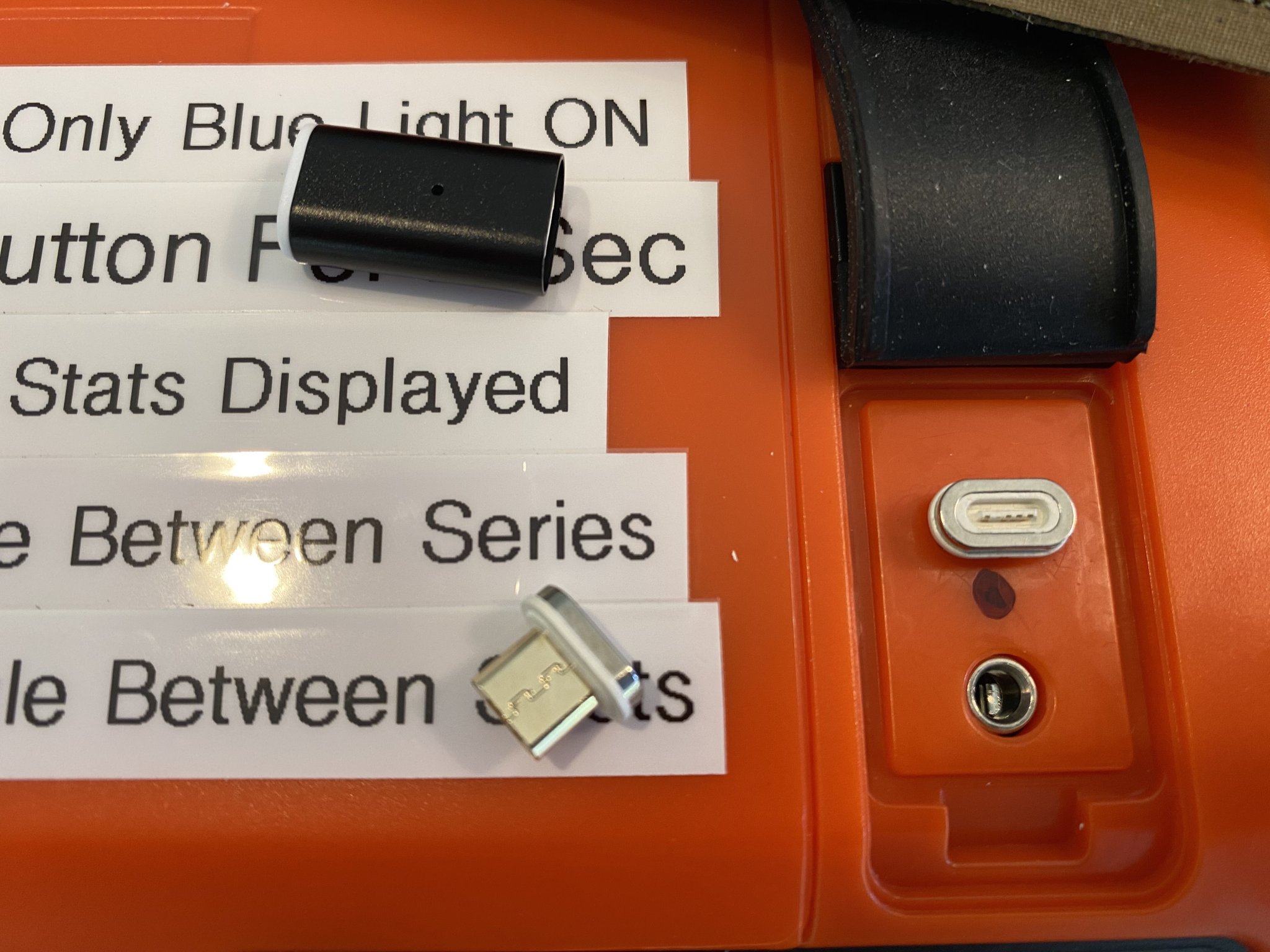

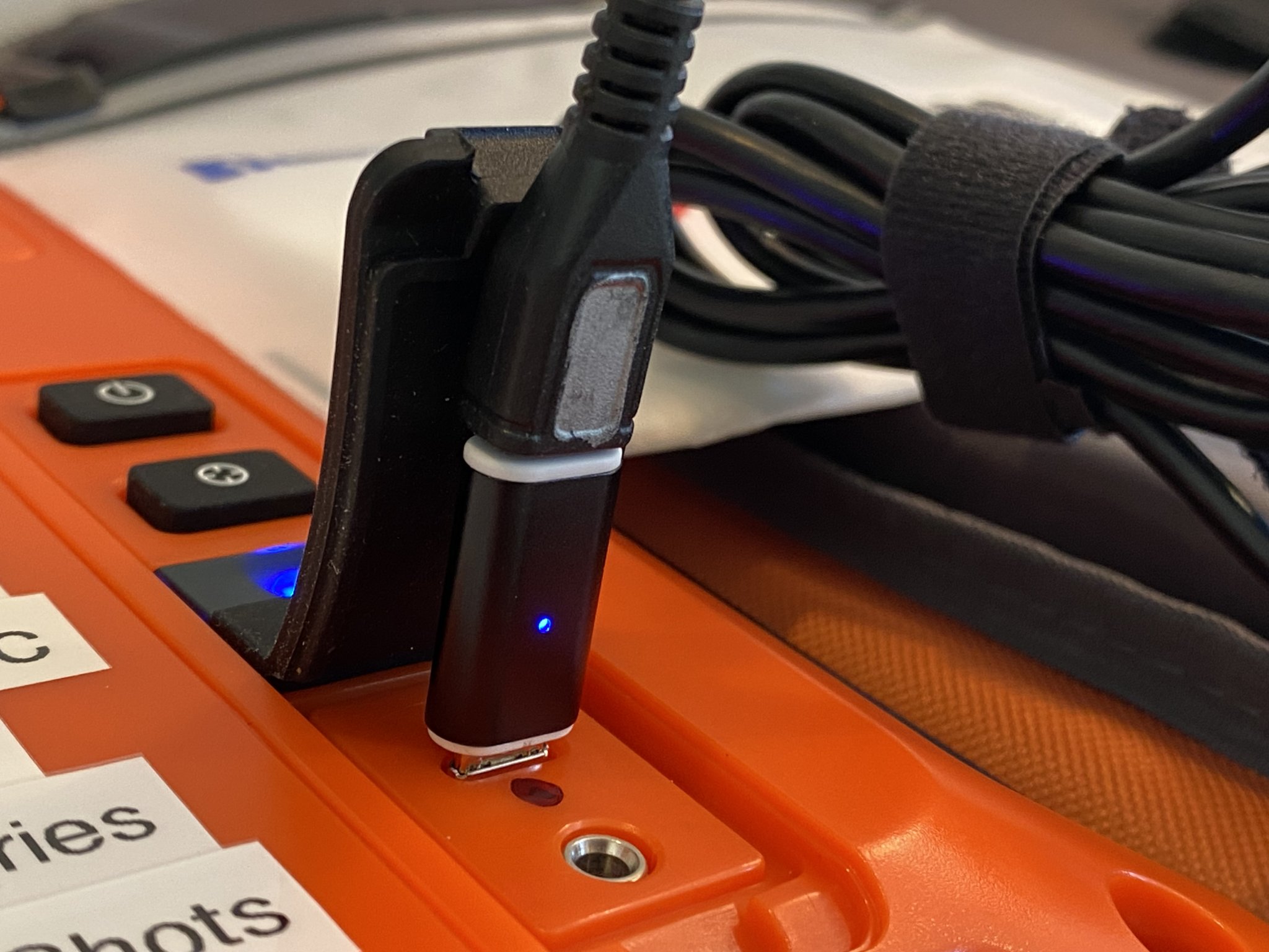

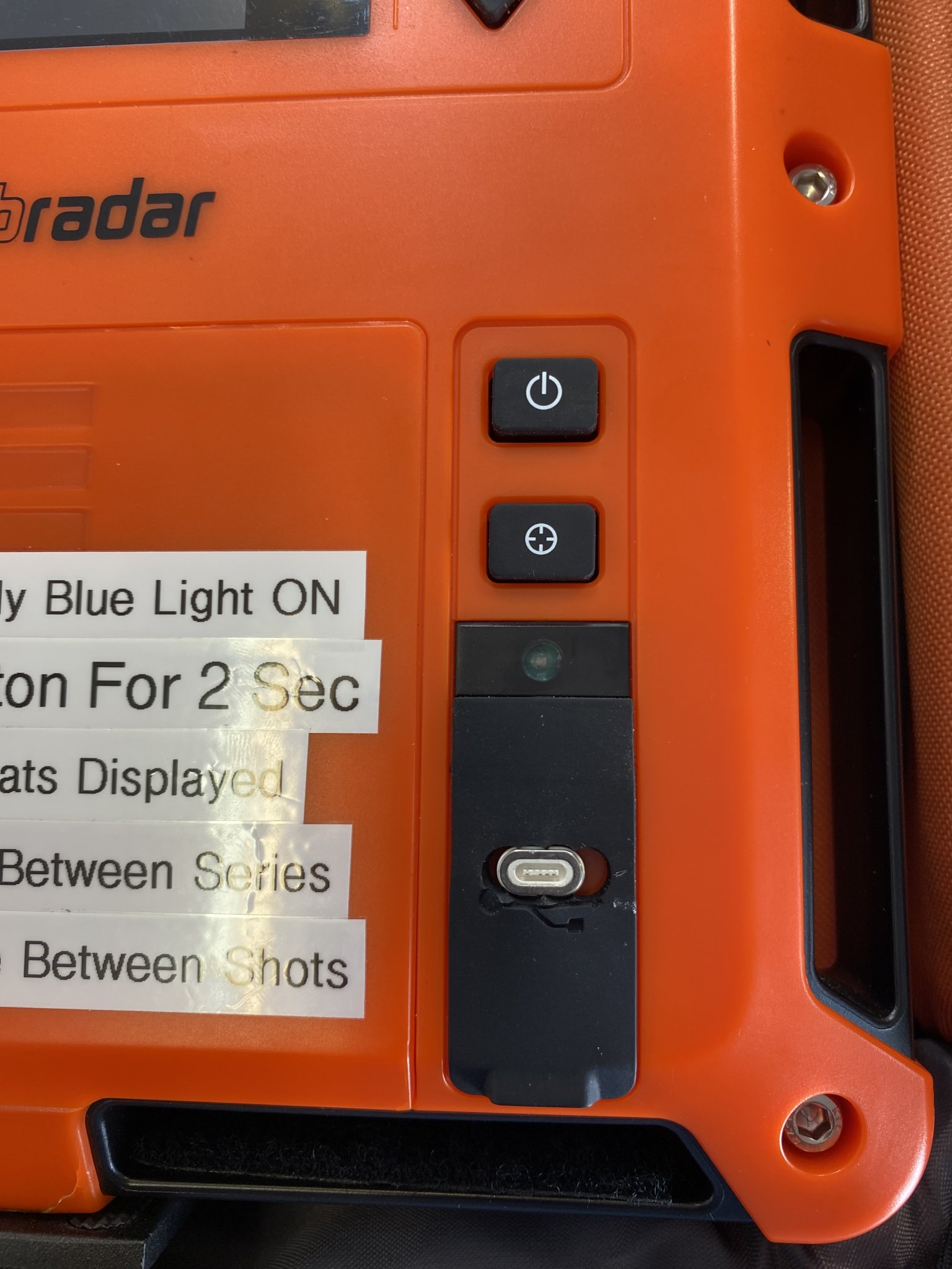

I like the Arkco quad base (but any mini tripod or similar will work), a cheap/Amazon external battery pack, a recoil trigger (I prefer the JKL but also have the Piet), and a sight. I think those are the must-haves.

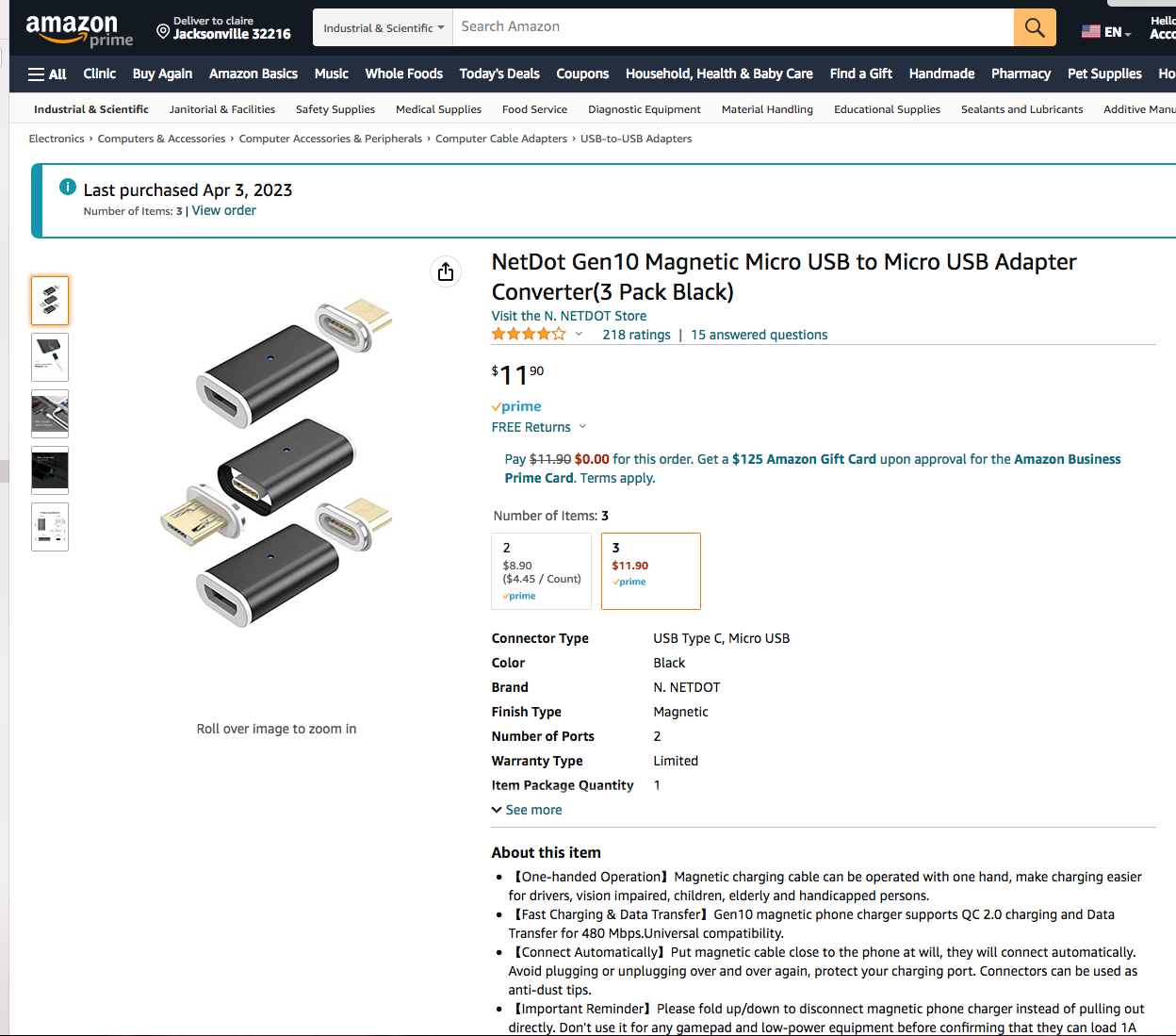

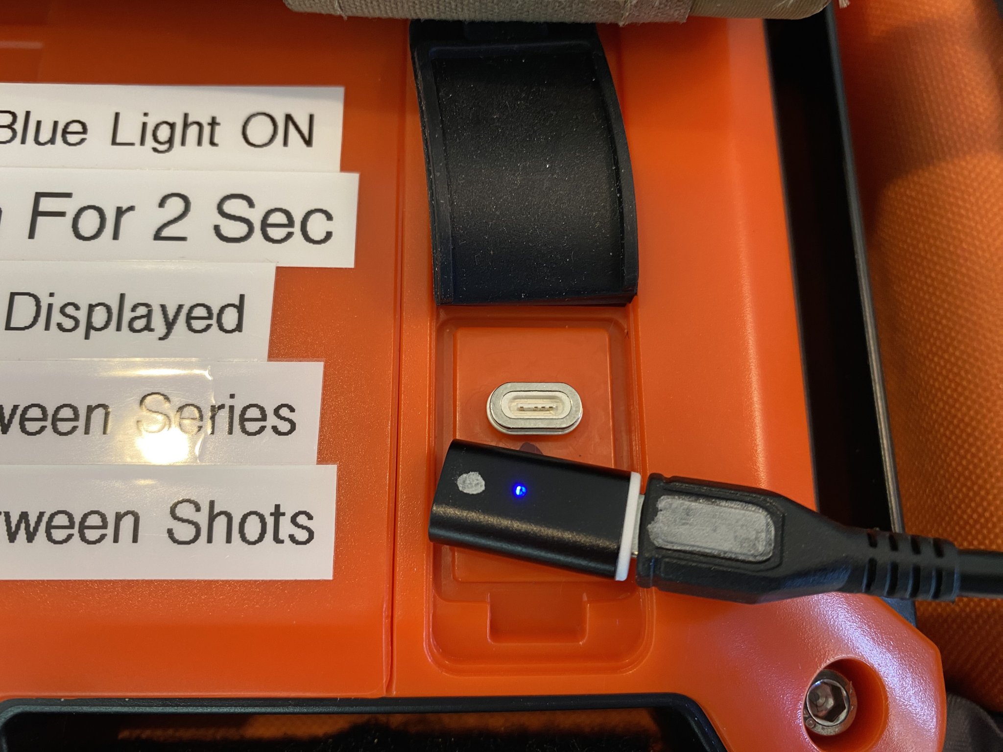

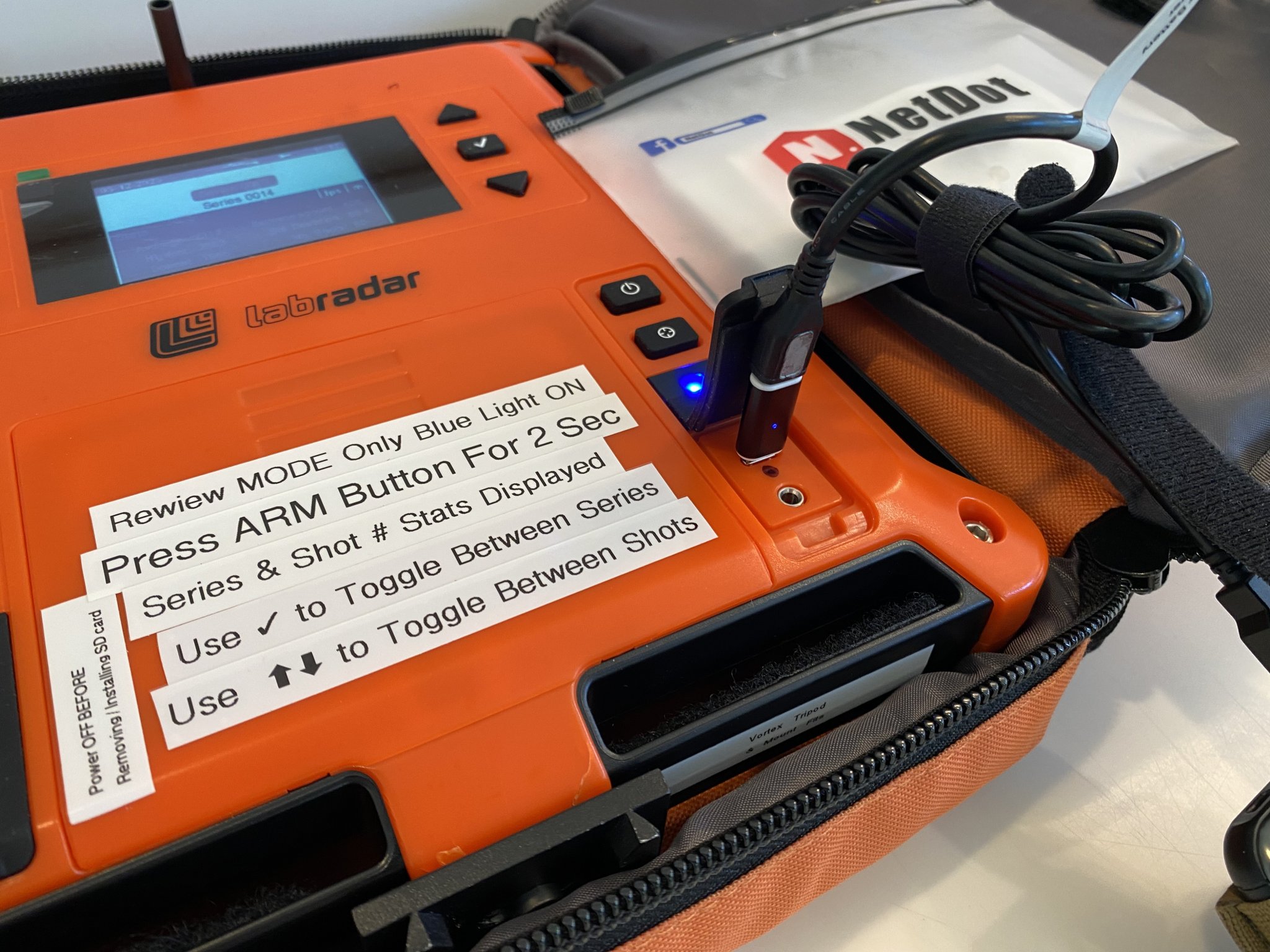

The only thing I would also add are those little magnetic charging cords/adapters… the ports on the LabRadar can be a little finicky when they are used a lot, and the magnetic adapters completely remove that possibility.
Otherwise, I’ve had no issues with mine. It’s a great system when used correctly/as directed above.

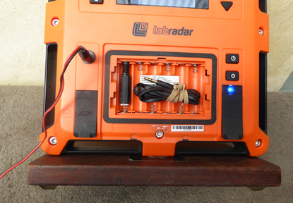

Be careful, the Micro USB socket gets loose over time - mine did, and other shooters have posted the same. You have to be gentle with the USB socket unless you want issues down the track.
To fix this, open the Radar and install a proper external power socket above the SD card slot (plenty of room inside). Slave the socket leads to the battery compartment leads. The battery compartment still works if you need it.

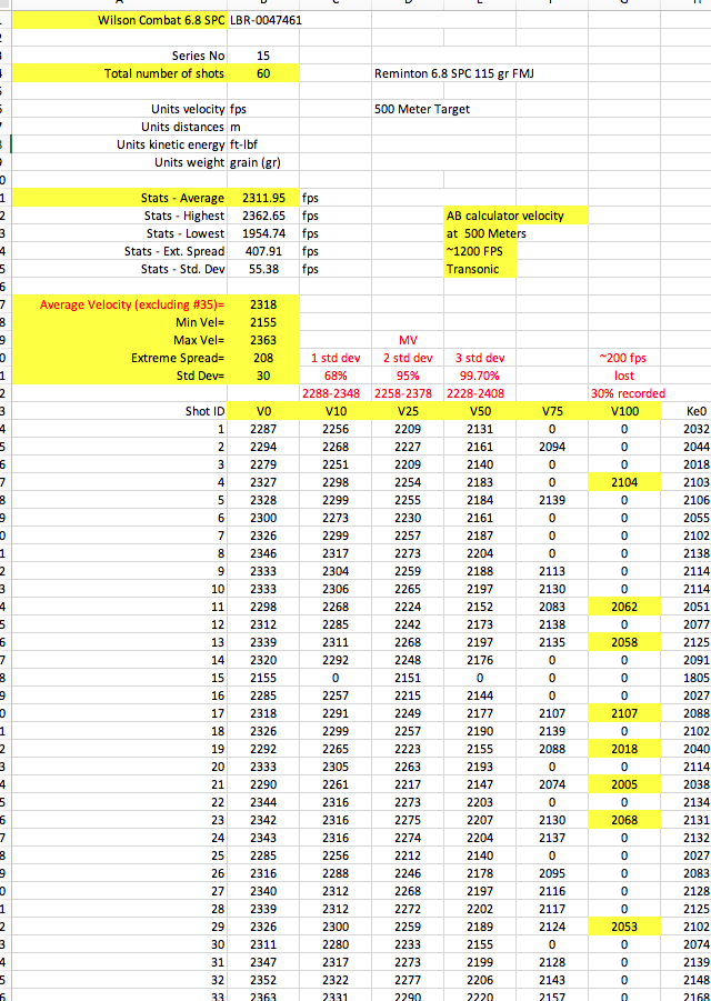

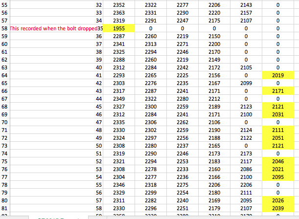

A few more LR usage comments.
Since I have been using the tube to aim at the target the Labradar has been picking up ~30% of my shots @ 100 meters, much higher than
without using the sight. When using the trigger, dropping the bolt for new magazine load will occasionally trigger the system and give a anomalous velocity which I delete and use Excel to re-calculate the statistics. The labradar data is written to the card as a ".csv file" (comma separating values). The first thing I do is "Save As" the .csv file to a .xlxs file, so the spread sheet data can be formatted, manipulated.
Reactions: klemheist

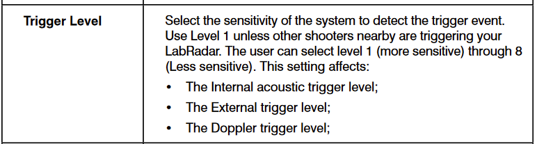

If you are triggering the unit with bolt closure, reduce the sensitivity setting.
Cheers
Vibration triggers are either On or OFF so no adjusting for sensitivity. Sensitivity is fixed at the factory, and also how you orient it on the gun. Labradar's sensitivity adjustment is for the microphones.
Adjusting vibration switch sensitivity is all about orientating the switch to the way the gun jumps in the recoil. Front or back of the gun; inline with the barrel or at right angles. If you make your own trigger then choosing a more or less sensitive switch is also an option (I use the most sensitive of the three in the SW-180 series, the SW-18010P, they sell for $1 for 10 on EBay).
As for false triggers when racking the gun or knocking it, it's just the trigger doing its thing. I ignore the occasional false trigger and the screen message that goes with it. Firing the next round automatically resets the radar, so that message where it tells you to push a button to reset is irrelevant.
And you are absolutely sure of this?
Look in the manual and you will see that trigger sensitivity applies to internal acoustic trigger, external trigger, and Doppler mode.
Yes, both the Labradar airgun and archery adapters are microphones. You can see this in their photos, and they use the word 'microphone' in both product descriptions. These are adjustable for sensitivity on the radar.
Labradar does not sell vibration triggers like the after-market JKL and Piet. Vibration triggers sell for $0.10 each to up to $1K for commercial applications. You can build an accelerometer type switch or adapt an Arduino switch, but you have to ask yourself - why? When a switch costing 10 cents does the same thing.

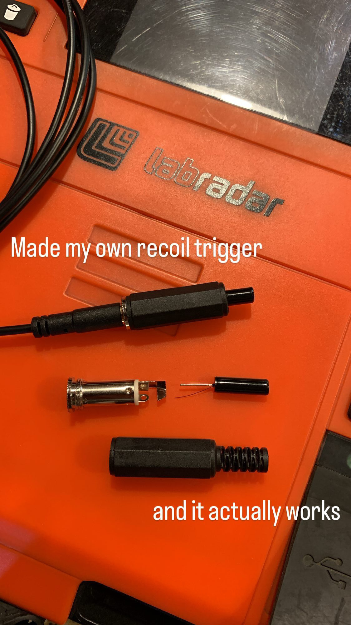

Here's an earlier post on another thread where you can build your own vibration switch for less than $5. There's a cut-a-way photo showing the insides of an SW-180 series switch showing how it works - Either ON or OFF electrical contacts, and nothing in between, so it cannot be adjusted for sensitivity electrically. But, you can adjust for sensitivity in its orientation on the gun, or by buying more or less sensitive switches (the coils being more or less stiff when they wobble).
Vibration switch

Klem is correct - adjust trigger sensitivity via placement on the gun.
I think JKL recommends as forward as possible as that’s where the impulse is most significant. Not sure about others, but this method has worked extremely well for me.
Vibration switch
There is only one input for an external trigger whether it’s an external microphone or a movement trigger sending a signal and…clearly stated in the manual…the sensitivity setting adjusts (again) internal acoustic trigger, external trigger (only one input), and Doppler.
Reactions: 6.5SH
There may be a setting for it within the LabRadar but Klem’s point is that the JKL/Piet/cheap external vibration triggers can’t physically be adjusted regardless of what the LabRadar is set to. They’re just on or off, otherwise incapable of adjusting sensitivity.
The only “tuning” you can do with them is moving them around to different locations on the gun.
Reactions: spife7980
Baron,
Labradar endorses their products while shunning any other non Labradar device; partly to discourage ignorant shooters from wrecking their radars, but partly to maximise sales from their over-priced accessories.
The advice you keep quoting relates to their products only. How 'clear' they state it does not make it any more relevant to our discussion. They don't sell vibration/kinetic triggers and that advice does not apply.
Yes, kinetic triggers use the same input jack as their microphones, but you still cannot adjust the sensitivity of what is a simple make/break electrical circuit by a sensitivity circuit designed for microphones (which are not simple make/break circuits, and are adjustable).
Well I'm pretty sure Piet who originated the idea of the recoil trigger will disagree with you. This is easy to test yourself, simply set a Trigger level of 8 (max insensitivity), arm the unit and wiggle the sensor. Reset it to Trigger level 1 and repeat, it takes less movement to trigger a reading.
The sensitivity setting merely says "yep I had enough millivolts pass through for long enough to count as a shot", there is no sophisticated audio processing going on here. The recoil triggers will have a variable amount of surface contact between the spring and post and more importantly contact TIME, much like the resultant electrical signal a microphone produces.

You are correct in that the Trigger level works on a sliding scale of voltage acceptance from the microphones. The higher numbers up to 8 need more voltage to be accepted as a shot. Microphones translate air pressure into voltage; more pressure, more voltage. The Trigger level scale of 1-8 requires different voltages for each level to be accepted as a shot. I think we agree here.
With a kinetic trigger, the way it interacts with the radar's Trigger level is to be accepted as a shot from level 1-5, and then at levels 6, 7, 8 it is not accepted at all - this is regardless of how hard you smack it at any level. From level's 1-5 it has the same sensitivity, so in other words does not need heavier smacks towards 5 and lighter towards 1 to pass as a shot. Bottom line, you cannot adjust their sensitivity by the radar's Trigger Level, other than to have it working from 1-5, or not working from 6-8.
As for Piet disagreeing with me... Invoking the possibility someone else might disagree as leverage for an argument is specious at best, and a waste of words at worst. Regardless of what Piet might think, no one has a monopoly of knowledge in the area, including me.
Perhaps with the particular sensor you are using, these are not exactly a high precision part.
I can trigger the current production Piet I have as well as 1810 and 1820 based switches I built myself on Trigger level 8, a 1830 I can't shake hard enough but need to impact it to trigger. It takes more effort on 8 than 1 and this is easily testable for anyone who wishes to try for themselves. If anyone has an 1810 they can't set off on Level 8 it's possibly mislabeled, I'm not a gorilla and can do it on multiple examples I've assembled.
The TLDR is YES the Trigger level setting does effect how much movement is needed to trigger a reading. Where you place the sensor will also affect how much movement the trigger is exposed to. There will be variances among sensors and firearms, blanket statements that it can't be adjusted for sensitivity are provably false.

Baron,
Old saying..."You're fighting it."
Lots of manipulations have unintended consequences. Subsequent to using the magnetic USB port, I realized the stiff rubber cover of the power-trigger port site was such that its inherent tension would displace the magnetic connection after several rounds. Today, I used a razor blade to release the tension of the rubber cover as well as used a paper hole punch to allow the magnetic adapter to be exposed, thus allowing the cover to fit flush to cover the trigger port. Problem solved.
