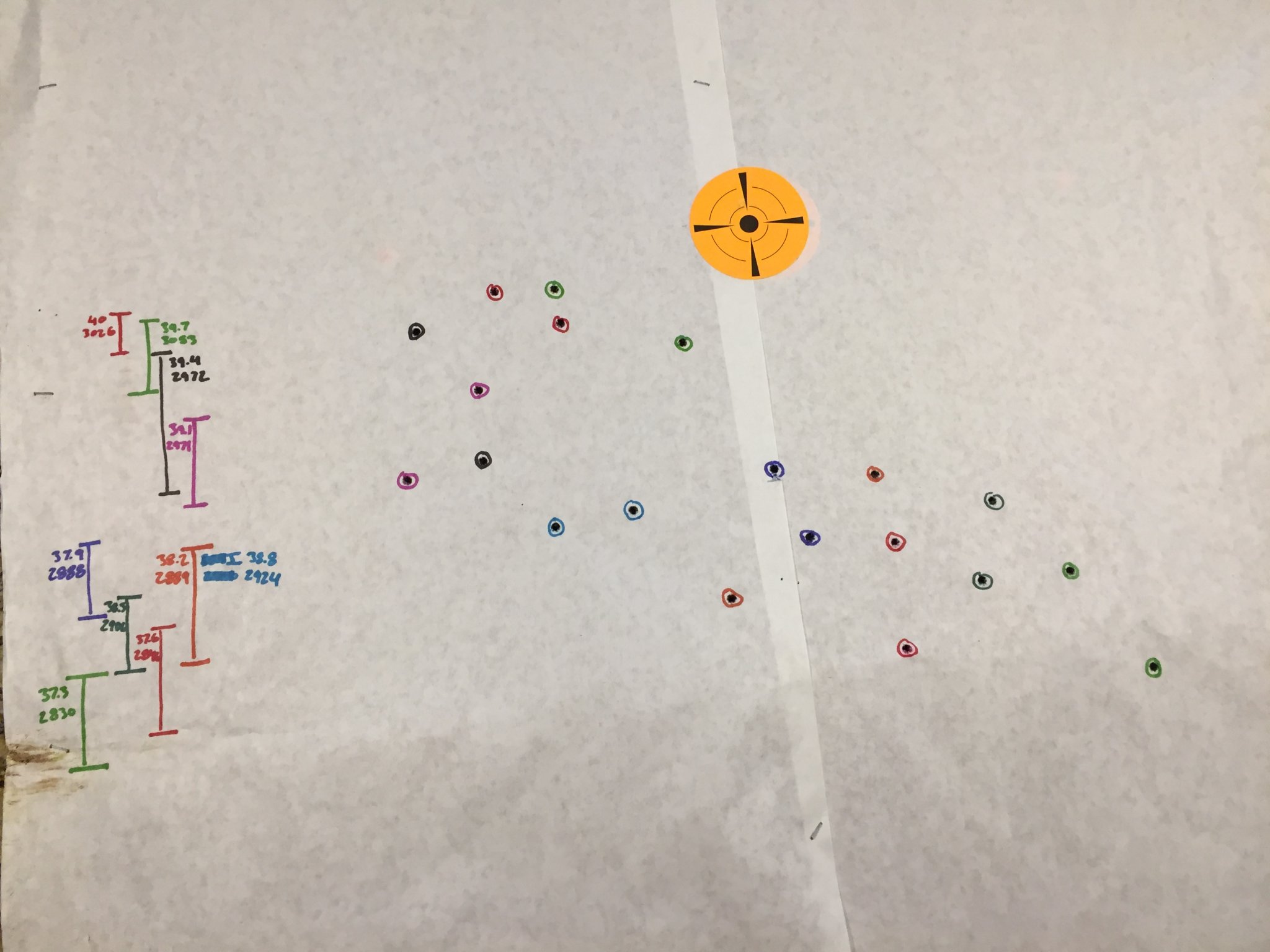

So I already have a load developed for this barrel for awhile now... I know what shoots good out of my barrel.
But I wanted to see what the hide would do and see how and then hopefully I can load it up and provide the results.
So its a 6xc criterion using 105 rdfs at 2.120 ogive via hornady comp which is .020 off the lands via wheeler method and H4350 weighed to +/- .02gr via autothrow, shot it at 500 yards. Started at 70 degrees at 11am and finished at 85 degrees at 1pm. Wind gradually picked up through out the test as is evidenced by the target. Speed gathered via labradar, first shot I forgot to arm it so... thats on me.
7039851
7039841
7039845
So yall tell me what to test for this next week and how (and why you think so) : OCW vs ladder, 100 vs 500, powder vs depth and so on.
Disclaimer, this batch of brass I am using to test only consists of 24 pieces, my over flow from my regularly used pieces so I am limited by just how much I can do at once. (8) 3 shot groups, (6) 4 shot groups (2) 12 shot ladders etc.
Ill be processing the brass tomorrow but Ill drag my heels so that we have time for input before I

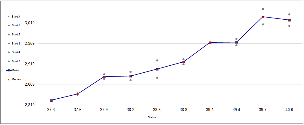

I’d certainly look a something in the 39.1 to 39.4 area.
I recently did a similar test and my graph looked very similar to yours. I shot some groups in the middle of the flat spot today.
ES and SD were quite good, accuracy was ok but at a speed I like.
I’m going to play with seating depths a bit more.
It’s consistently less than MOA but I’d it like a bit better.

In all seriousness, it looks to me like 37.9, 38.2, 38.5, 38.8 have a very narrow vertical dispersion when compared to the upper end velocity groups.
Id be looking at these areas 39.1 - 39.4 and 39.7 - 40.0. However 2 rounds really isnt a good sample size. I'd run 39.0 through 40.0 in .2 increments. Do it with 3 round groups each to see if the two nodes are still there. If you still have two node flat spots than load up 10 in the middle of each and pick the one with the best sd.
You can then fine tune with seating depth assuming you know your headspace.
Also are these ELD-X OR ELD-M?

I really don't like this test. I know alot of people believe in it.
Like everyone else, according to the chart, you have a "flat" spot
at 39.1-39.4 I like to let the target talk to me. You have less
vertical with the 40.0 I would shoot those two with 3-4 rounds
and not let the temp change much. It went up 15 deg. but more important,
how long were the first round to the last rounds in the sun or heat.
Try to control the little variables.
Try 39.0, 39.2 and 39.4 then 39.8, 40.0 and 40.2
Thats what I would do. My 2 cents
I do this same kind of load development. I would load 5 at 39.3, if you are getting a really good SD and ES, then I would stick with that and just adjust seating depth until I find what the barrel likes the best.
I would use 39.1 based on target and graph. I would load 5 identical to ladder load, then adjust seating depth a bit so 5 more for each adjustment but the horizontal looks very good as is for 500 yards IMO. You could spend time in the 39.1 to .4 range, in the past I would have looking for the load, but life's time limits and experience have driven me to KISS load development. 20 shots known and 40 shots unknown cartridge. Latest project 300WM 175 Edge TLR.

I have a few questions.
  1. You must have expected a certain outcome, did it go as planned? I want to say no
  2. Why .020" off? Is this your normal seat depth? If starting from scratch, not knowing seat depth, wouldn't a 5 thou jam be better, or at least get seat depth close before firing at 500?
At around 39.7 gr, your maxed out on any efficiency of the platform with velocity loss 40gr, your next velocity rise with more powder and you will be into pressure, if not already. Even though those 2 charges look good vertical wise, I'm not sure I would pursue.
Well, I'll take a shot.
You hit pressure at 40 grains. At those temps, a 1% reduction in charge weight will keep you out of pressure trouble at 100 degrees. So I would use 39.6 as my maximum acceptable charge. I usually find that loads are pretty easy to get good SD's with and are pretty tunable and easy on brass at 2% off max. That puts you at 39.2 grains.
39.2 is right at the bottom of your upper cluster of holes, and with a bit of seating depth fine tuning, will probably tighten up. it also happens to be in the middle of your velocity "flat spot".
I say try 39.2 with a .005" tweak fore and aft to see which is better. it will be interesting to see what the OCW says.

1) Im not sure I expected a certain outcome from this but I have done it before; only without a labradar so the results on target were always a one independent data set and a second data set via magneatospeed so I didnt have both sets of data for the same shot before.
I will say that this data didnt necessarily refute the data I had collected previously. Im torn on saying what my previously existing load was or not because I dont want it to influence the suggestions I receive.
2) I chose this depth off the lands because its what I had found shot best in my prior testing. I didnt have any great luck starting jammed in my previous tests, they shot alright but never best. My length has grown from when the barrel was new but I keep coming back to .020 off chasing the lands. I use these 24 cases to do a seating depth test in between each loading of my big boxes to avoid loading lots of ammo that gets too far from the lands and to keep it in tune. So Ive been finding that keeping them .020 from first touch is the nicest spot for me.
Maybe if this series of testing leads to a different powder weight then maybe it will like a new different depth as well. I would enjoy finding that out

I'd ignore the velocities and look at the target IMO. Velocities are there to give insight into the target, not the other way around.
If you were throwing charges with low degree of powder accuracy the range of 37.9-38.5 is a pretty fat area where the elevation POI on target is pretty consistent, as is the speed. Vertical is not great for any one charge weight though (looking at just two bullet impacts).
I don't like the range around 38.8 to 39.4. Across those three charge weights the vertical moves pretty rapidly up the target.
The charge at 40.0 has some of the least vertical, and also overlaps 39.7 (which itself has not much vertical). The velocity ladder also confirms a bit of a flat spot there. Don't know what's happening above those charge weights.
I personally would do another confirming ladder between 39.5 to 40.5 grains in as favorable conditions as possible. I think right around 40 grains has a lot of promise. Not sure what I think about the SD/ES of those loads, but I'd be curious what the target says if you shot again. Who cares what the velocity variation is if the target shows the least amount of vertical?
Side note, 3050 ish with a 105 is a pretty common load for 6XC. If you wanted to shoot at 2960-70 then just shoot a Dasher. :)

38.8 grains happens to be "3% less/ or 1.2 grains less" than 40 grains, which Newberry suggests is where the next node down is from 40, and I'd count those two charge weights as having the least vertical, as well as being nodes by looking at the vertical dispersion.
Even though 39.1 to 39.4 have lower ES they appear to be in the scatter node. Well that's why I gave up using a chrono during a ladder test. I just look at the vertical on paper.
Since you are doing .3 grain increments and the tightest node could be in between somewhere, I'd shoot 3 shot groups at 500Y of .1 grain increments, low from 38.6-38.8 and high from 39.8-40. Actually if the pressure isn't hot at 40 I'd personally choose this high node area and concentrate on it from a load density and a higher velocity perspective. Come hot temps if there is a pressure problem you know where the low node is. Or reduce the high node charge a tenth or two to duplicate the velocity you come up with.
I'd still like to see how an OCW at 100Y correlates.

OK, well Im going to bust myself early, even though I said I wouldnt, since Milo thinks Im asking leading questions towards the flat spot but my prior load was 39.4gr summer, 39.5 winter via ocw at 100 yards, averaging ~2980 +/- 10 fps.
I was originally going to try and demonstrate that the flat spot was a fluke but Ill be damned if the saterlee part of this test didnt support my load. So thats the numbers. Wasnt trying to lean towards the saterlee method, just the opposite actually but I cant deny what Ive laid out here (small sample sizes aside).
Now... the target shows exactly the opposite, 39.4 had the largest vertical of any of the tests with the test loads directly above and below it rising to the higher and lower side of it instead of clumping aroudn themiddle, not at all what I was expecting/hoping. I was expecting the target to support the prior load and the numbers to be way off, so my paradigm has been shifted.
So if it seems Im leaning one way or another, its really just me squirming in the middle LOL
I like that target with them spread out on the football stitches, I have done something similar for OCW when I have a new rifle that needs to be zeroed still and I have no idea where its hitting or how well it will group. Ill shoot it in the middle of the big board so its there to catch the shot whereever and then Ill adjust my sights and then start my ocw on the same row without having to go down range at all to swap targets out and so on.

Thats what I was intending to set out to do, to show that the chrono was fools gold and the target was what mattered most liked I described in response to Milo. But this particular target flies in the face of what I had tested before and the chrono backed up my prior hypothesis.
So the opposite of what I was expecting!
What I find interesting is that you and clcustom1911 suggest looking into 37.9-38.5, the others all say to look at the area of 39.1-39.4 which is where you say you would avoid. And going off this one particular targets its the area that I would be inclined to avoid as well.
And I dont see how people are running 3050 with H4350, thats scary fast but Ive heard people reference it as well.
With RL16 I was getting accuracy at 39.8 gr for 3070 but 40gr with that powder was putting ejector imprints on the cases in not super extreme temps. Extreme temps in texas get hot and only being .2 away from pressure in the enjoyable 85 degree weather with a powder that gave me the only bad carbon ring Ive had was enough to push me back to H4350.
That's good you already had the seating depth down from previous load work, your rifle shoots pretty good, especially considering the bullet you use!
Some of my above comments for reasoning apply here as well about the numbers vs the paper. The limit of 40 is kind of a soft cap, its a bit tight on extraction but nothing that a good oopmh cant take care of, that said 40.5 is leaving ejector imprints and is clearly over the top and that was found on a day in november when it was 70-85 as well. In summer when its 100 that 40gr gets an appreciable bit tighter which is why Ive never really ventured that far up too in depth.

Spife, sorry if my big mouth screwed shit up for you, lol. I wanted to ask the one question right away, I thought the results got away from you.
It is my experience that any charge can be tuned for size and shape to a great degree with seating depth, but low SD's are a function of burn rate, bullet weight, and load density. Which is why I hesitate to go much below 2% off max.
I do believe in positive compensation, and want to be on the up side of the curve rather than the back side, but I don't believe there is a lot you can do about it in any given combination without messing with additional barrel weights and tuners. For most of us, it just is what it is. That's my personal opinion. I could be wrong.

I would use 38.8 and be done.
I was going to quit, but honestly I do not feel that would be wise. First, now you have charge specific load. Look at the charge below, and the charge above and the vertical spread between the 3 charges. He would have to verify with .1gr on either side, the load may hold. There is not enough data gathered to support it will work, my opinion. Plus the charge is low on what the case is capable of, which is ok, but he has way better looking things going on with higher charges.
Spife7980
The results should be repeatable unless you have a equipment problem or your shooting too far for the conditions.
Bob Hoppe finds his load at 100 yards and never changes it all year.
He shot the smallest NBRSA 600 yard group ever fired while I was two benches away and while my father was pulling his target.
My father asked him which of his 3 groups was the smallest and he guessed wrong.
Pick the least amount of vertical spread before you change anything.
Reactions: Subwrx300
A lot of theories suggest using "flat spots" or vertical impact as a go/no-go indicator for load development. I'm not a fan of those methods per se unless you shoot 4-5 shots at very tight intervals (.2 gr or .1 gr). Primarily because most scales are only capable of +-.1 grain, by testing at .1 grain you are seeing the actual potential for future results if your scale varies a bit from day to day or session to sesson.
I try to find the nodes based on change in SD (not the relative velocity from charge to charge but graphing SD by charge.). This is very different from a flat spot in velocity where you could have high ES but an average that stays the same. Not good in my book.
You don't have enough shots to say much about SDs but you can see the ES (albeit 2 shots only) gets tighter in two distinct nodes: 37.3-37.6 and 38.8-39.1. I would load +- .1 grains around 38.9 (38.7, 38.8, 38.9, 39, 39.1) with 5 rounds each checking mainly for SD. If it remains good, you could either: tune best SD node for seating depth to tighten groups OR be done.
I have started simply moving my reloading to more change in SD based initial testing and tuning precision with Seating depth as needed.
My best guess using data provided is that 38.8 or 38.9 will be virtually identical and have good SD. The POI vertically is very similar between 38.8 and 39.1 so its a good chance the barrel is fairly "calm" as bullets exit for that node.

Now that you've got a cross section of opinions, how do you plan to test for what the "correct" load is? Are you going to test at 100 yards or at distance? Are you going to test above/below to see what adjacent charge weights do? How are you going to define success at the end of it all? Based off numbers or off results on target?
What "terrible Intel" are you referring to @Lynn Jr ?
I'm curious how that video provides anything of further substance regarding reloading for precision in this context.
So he tests lots of bullets over multiple groups on multiple days looking for the most consistent aggregate....right? He really doesn't give any details about process nor does he discuss any "secret sauce" other than shooting a ton of benchrest aggs.
Is the point " shoot more groups over more days"?
If so, pretty sure thats what we are all doing (more data is good right?), but looking for a way to narrow in on right load more quickly. @spife7980 has already done the initial work, is planning to do more but wants to see how we would proceed.
I should add that this I am seriously asking this question not to flame but to understand what we should take away from that video. It seemed very thin on it's face....
Now you did it.
IDK, Im wanting yall to tell me what I should do for developing and Ill do it (Ive pretty much done it all before already on this barrel, just didnt document it as well as I would have liked for sharing after the fact, I deleted all the stuff that didnt have the exact load I wanted portrayed in it so lots of data missing for the other areas). But on target at distance is the final judge for me.
I wish they had a way to run several polls on a thread so I could do a new poll each week in this same space.
So far I have a 4 people wanting seating depth for 39.2 gr, thats the highest frequency of one suggestion so thats probably what Ill do since we dont have too many new participants making more suggestions.
So if Im going to do seating depth...
How many samples of each? 24 rounds gives us 8 3 round groups, 6 4 round groups or 5.8 5 round groups.
Yall wanting to see it at 100 or 500?
How big of an interval in between lengths? .005 or .010 or .015 or .020?
If we’re taking opinions on this too.
Here’s my .02:)
3 shot groups
If it ain’t going to do it in 3 why waste the others....
Lands or jam.005
.01
.02
.03
.04
And so on
