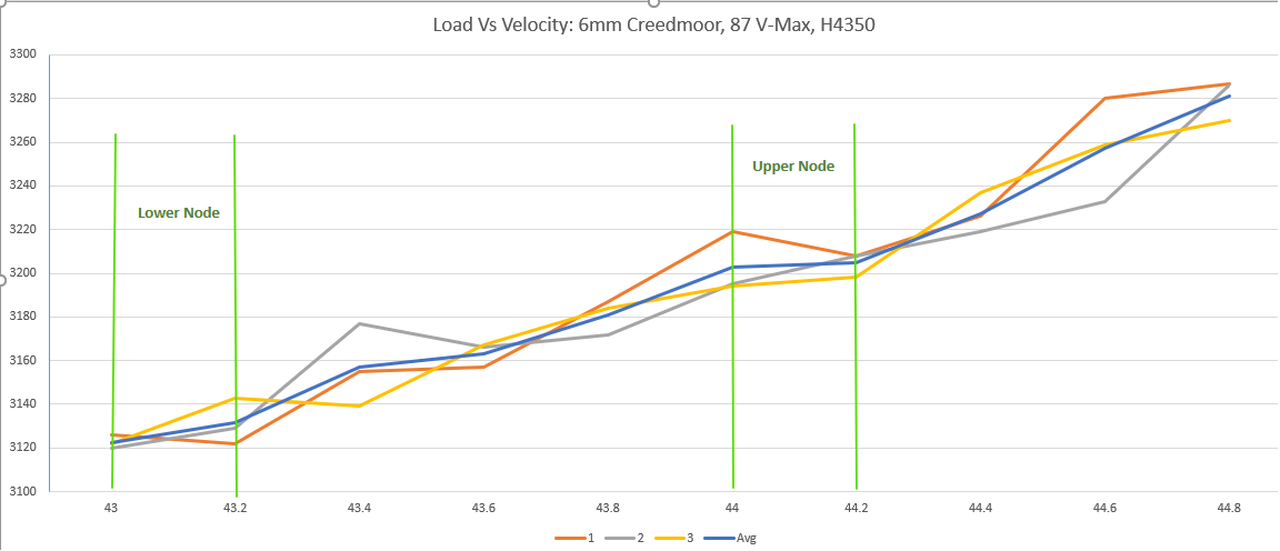

This was some initial testing on a new barrel. I chose the lower node around 3130 FPS. Since then the barrel has sped up quite a bit. It now only takes 42.5 gr of H4350 to get there, but I've run more ladder tests and there's still a flat-ish spot around 3130 that also happens to group well. Coincidence? possibly....

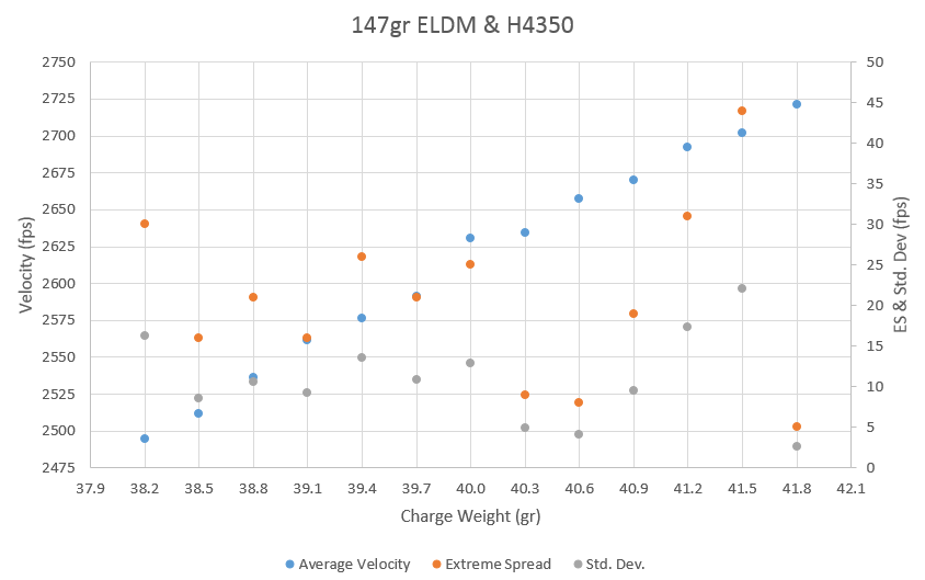

I did a simple ladder test with 3 shots at each grain increment and increasing them 0.3 grn per step. I started in the middle of recommended load for 6.5 creed and went up to book max. Left Y axis is average velocity and right Y axis is Std dev and ES.
This was enough for me to be happy with the “nodes” of low ES at 40.3-40.6 and 41.8. I still need to follow up on this, next was to play with OAL and distance from lands at 40.5 grn increment and see how it groups. For my shooting I’ll be happy with that load f it’s around 0.6 MOA or less. All groups on above graph were between 1MOA to 0.28 if I recall correctly. I want to say the “nodes” above weren’t necessarily the best group, but they will be the most predictable for DOPE.
More data points are always better, but there is a point where you just need to get out and shoot the damn thing vs. wasting ammo and barrel life chasing some “optimum” load for your barrel. I plan on stopping when I achieve something repeatable and predictable to start practicing with.
I will also add I am an amateur and just working on handloading and precision shooting. Take all this with a grain of salt, just more data out there in the cloud.
In the graph I am trying to visualize the orange and grey points of ES and Std. Dev. You can see how they flow down, up, and down, through the charge weights.

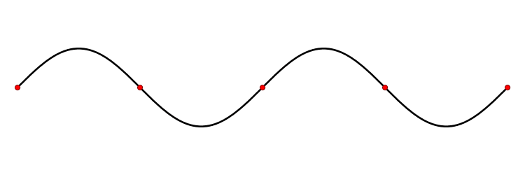

Witchcraft. Even the word node is used inappropriately.
NODE, definition - a point at which lines or pathways intersect or branch; a central or connecting point.
My interpretation, whether anybody agrees or not, is if when three consecutive shots in .1 increments land into not much more than the size of the bullet at 400Y, "at a central connecting point", that's what I call a node. Or vs what isn't a node, non convergence, the other shots in the ladder test which went 3" vertical.
Call it what you will, a node, barrel timing, bullet exit timing, etc, the phenomenon exists.

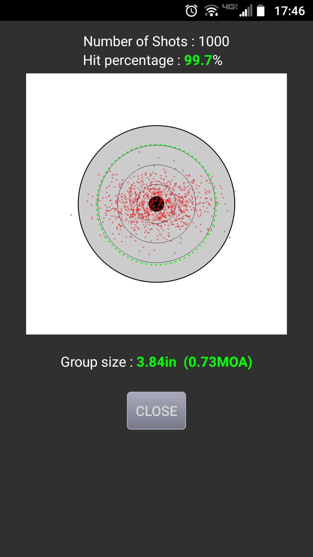

Statistical hit % .3 MOA rifle vs .5 MOA under the same conditions and variables. 500 yards, 5" Target. .7% is rather insignificant considering the shooter behind the rifle is the absent variable. Like I stated, immaterial in the real world.

Most people are referring to a so-called sweet spot of the barrel not bothering to look up the definition of node. A node is not a phenomenon. There needs to be an intersection. What is your "central connecting point" you are referring to? Where do the bullet lines going down range intersect if your POA is identical for each shot?
Okay what would be the scientifically correct word to use rather than node, rather than sweet spot?
I see your point, do you see mine? The node is the intersection, each shot in a node has a "velocity spread, right??!!", yet even at different velocities, land in the same place. Though the POA may be the same, not all shots in a ladder converge, some are "out" of a node/not hitting in a central connecting point. In the same ladder tests where 3 shots went into tight vertical, I've seen 3 consecutive shots with unacceptable vertical in comparison.
Looking at it the other way, what word would you use for the rest of shots that did not intersect. I've seen the words "scatter node' used. Maybe that's not correct either.
Phenomenon, definition - ""a fact or situation that is observed to exist or happen, especially one whose cause or explanation is in question"". Now isn't that the perfect way to describe what we're discussing here?!
I've done too many ladder tests with such great results to question otherwise, and if it ain't broke, it don't need fixing.
The impacts you describe are not a connection point. They are individual shots that have near parallel paths. But their paths don't cross/intersect. Node is a a word that has several meanings in the shooting world for some odd reason.

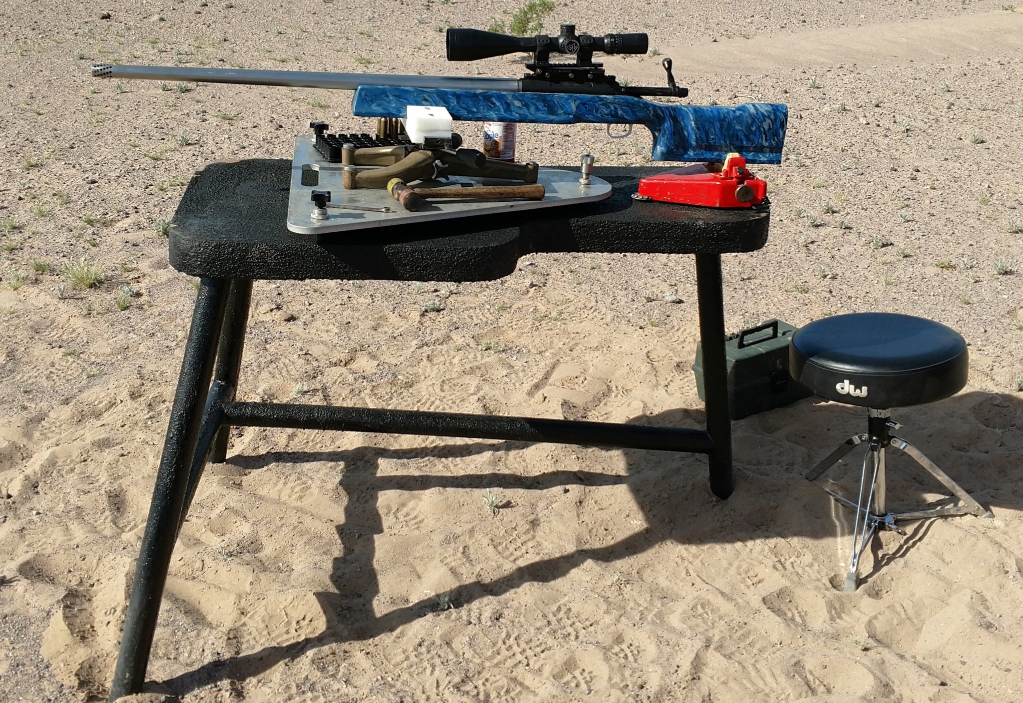

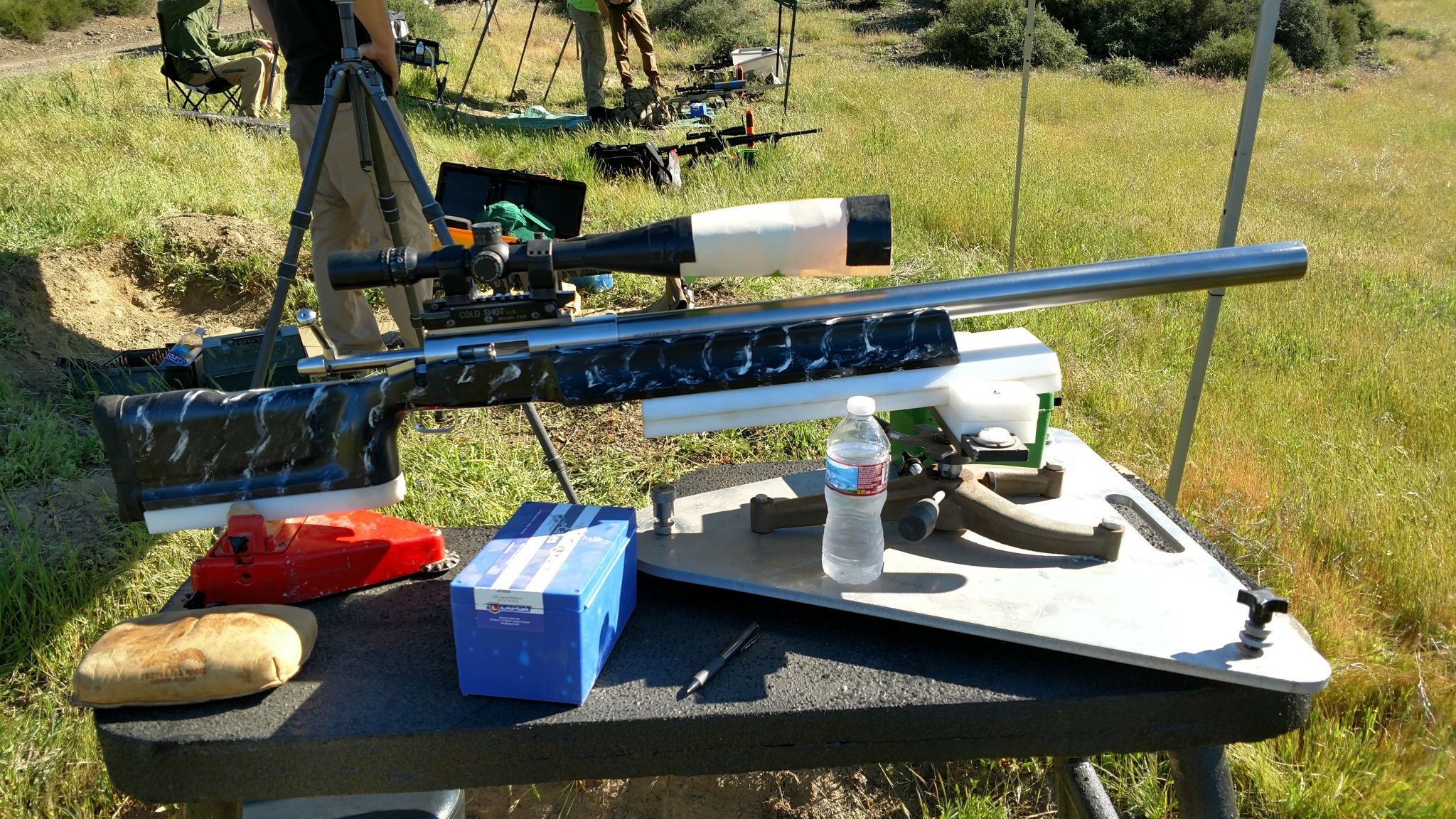

A ladder or Audette method is extremely fast and easy obsoleting the ocw method by Dan Newberry.
You need a gun and a shooter that can hit the target is the biggest issue I see.
You work in 1% increments.
You are only looking for vertical spread and horizontal spread and muzzle velocity don't matter yet.
With a good gun 100 yards will put most of the shots into a small oblong hole.
300 yards is better.
The muzzle has to be rising or the gun won't group.
Slower shots take longer to exit the barrel so the muzzle is pointed higher.
Faster shots exit sooner so the muzzle is lower.
You want the point where the faster and slower shots converge at the target.
If you can do this with a bench type gun which removes most shooter error the results are fast and easy.
You seat all of your bullets to there longest length which could be deep into the lands or maximum magazine length until you find the powder charge then you play with seating depth in only one direction which is shorter.
If your platform isn't rock solid stay home.

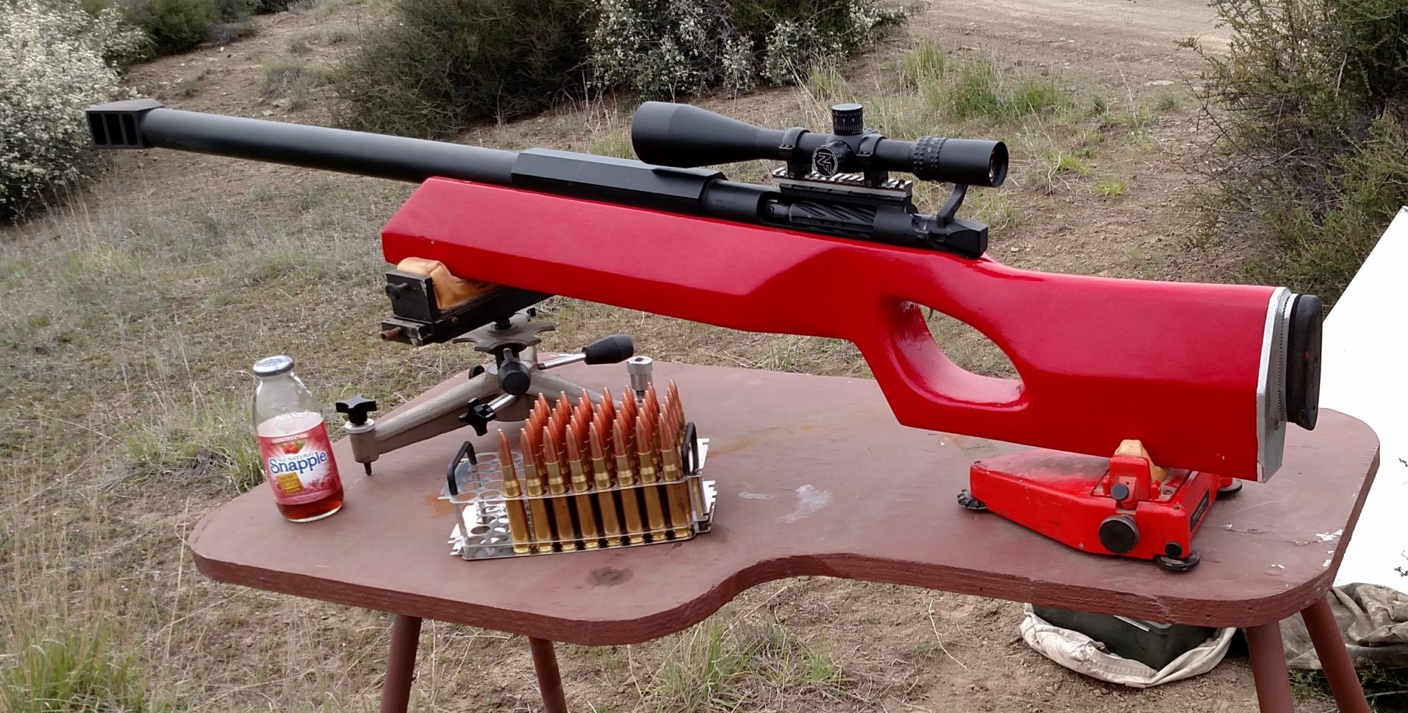

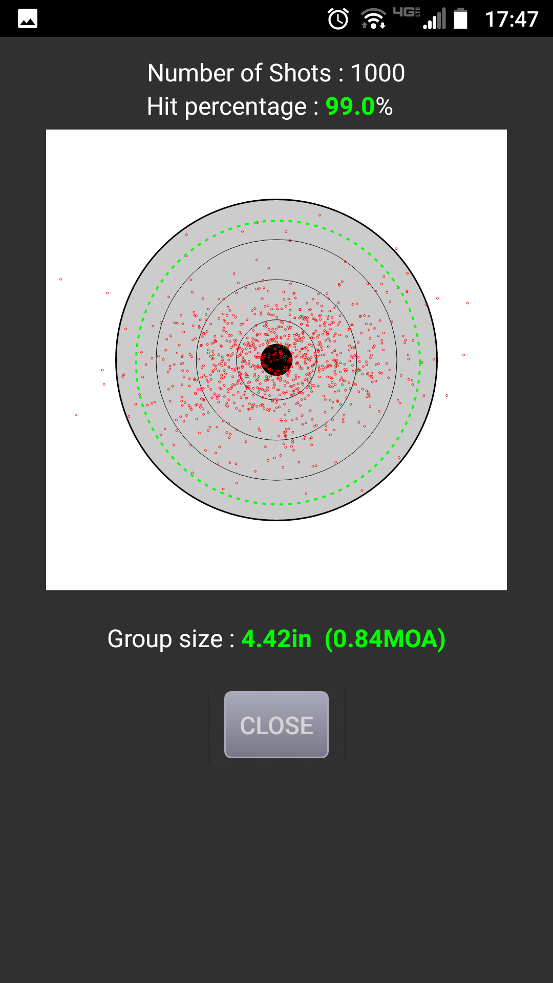

View attachment 7031916View attachment 7031918
That's a little more than a 10th of an moa difference between the two illustrations, do two tenths.
In our world it may be lost in the noise but tell the record holding benchrest shooters that a tenth is immaterial. Like rifles and loads capable of .282" at 600Y, and 1.04" at 1000Y for the long range events, which seems impossible to do. Not to mention aggs in the high .1's in short range BR where the winner is decided by .001's.
I'm not saying having ultimate accuracy is all there is, I'm not saying lowest ES is either, I'm not saying a rifle that does 1/4 moa all day long is the answer, I'm not saying all who have rifles and loads with those three attributes combined will stand the best chance of winning, I'm saying it can't hurt and sometimes it can help.
