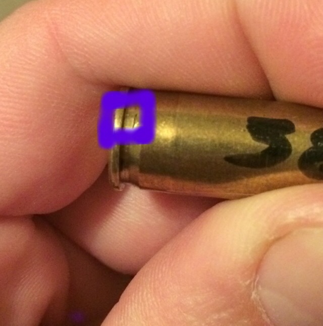

    I'm trying to get a good pic of what I believe is a extractor mark on the case rim (pressure sign?) but the next three hotter loads don't show same mark. Until I can get that pic up does any experienced loaders have any suggestions to this point?

    In any case, if your best results are coming from loads over book max, do not fret. As long as you have no clear tangible evidence that you are approaching high pressures, then you are good. A good lead sign of pressure is your velocity. Do you have a chronograph of any sort? I do not know 220 swift velocities off the top of my head, but for example, if your load is approaching say 3800, you know that you might be somewhat close to high pressure.
    When I do a ladder teat I always try to from low to high and have enough range in my loads to find my upper limit---I want to hit ejector marks so I know where're pressure is as where I can go no hotter.
