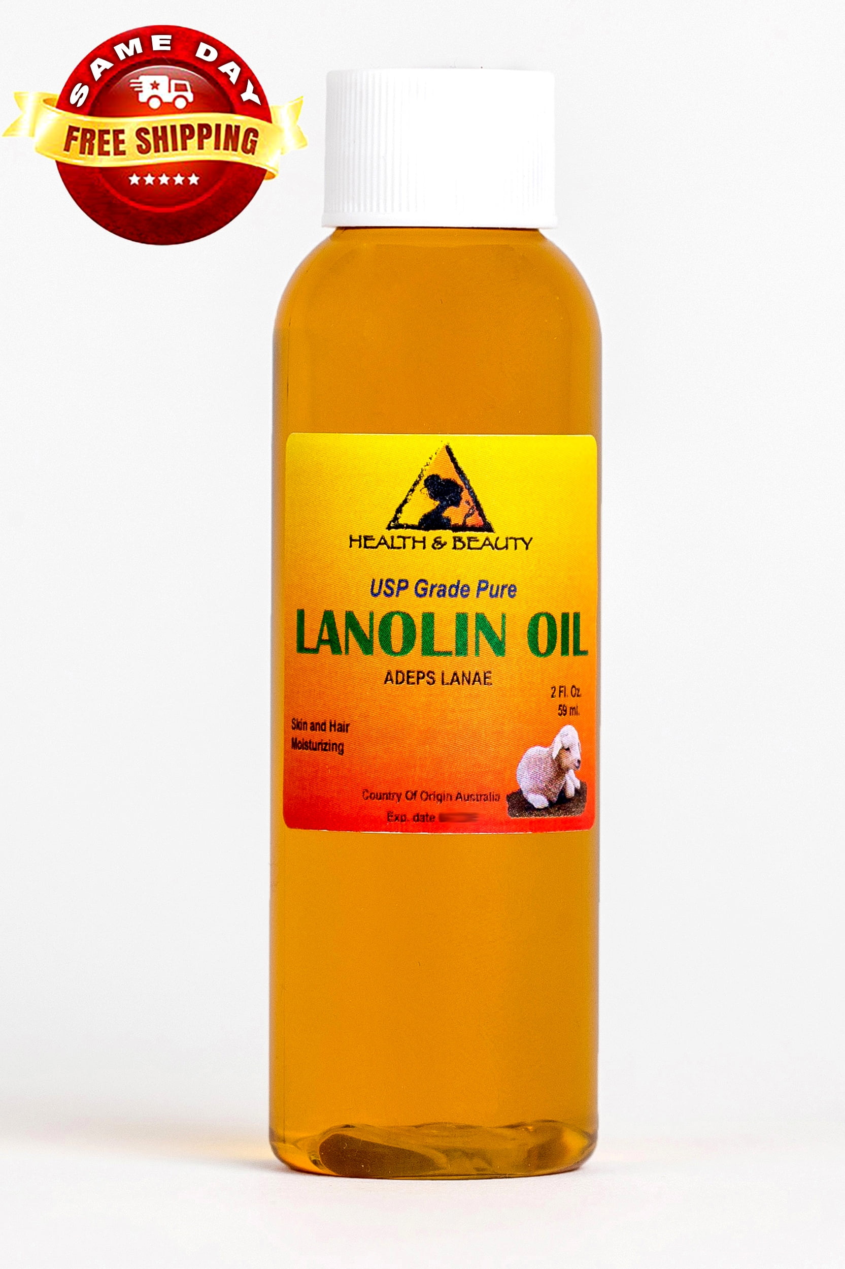

    Here is another option.

    I think I have a bottle from the same outfit. No additives. Anyhow, a little goes a long ways and I'd be happy to package up a couple ounces to tide you over. If that quantity works for you, PM me your address and I'll ship it asap.

    I bought from these guys a week back. We had some leftover 99% alcohol at work from when we did DIY hand sanitizer earlier in the year.
    Haven't sized any cases but it mixed up well and appears to be the right stuff. They shipped the next day.
