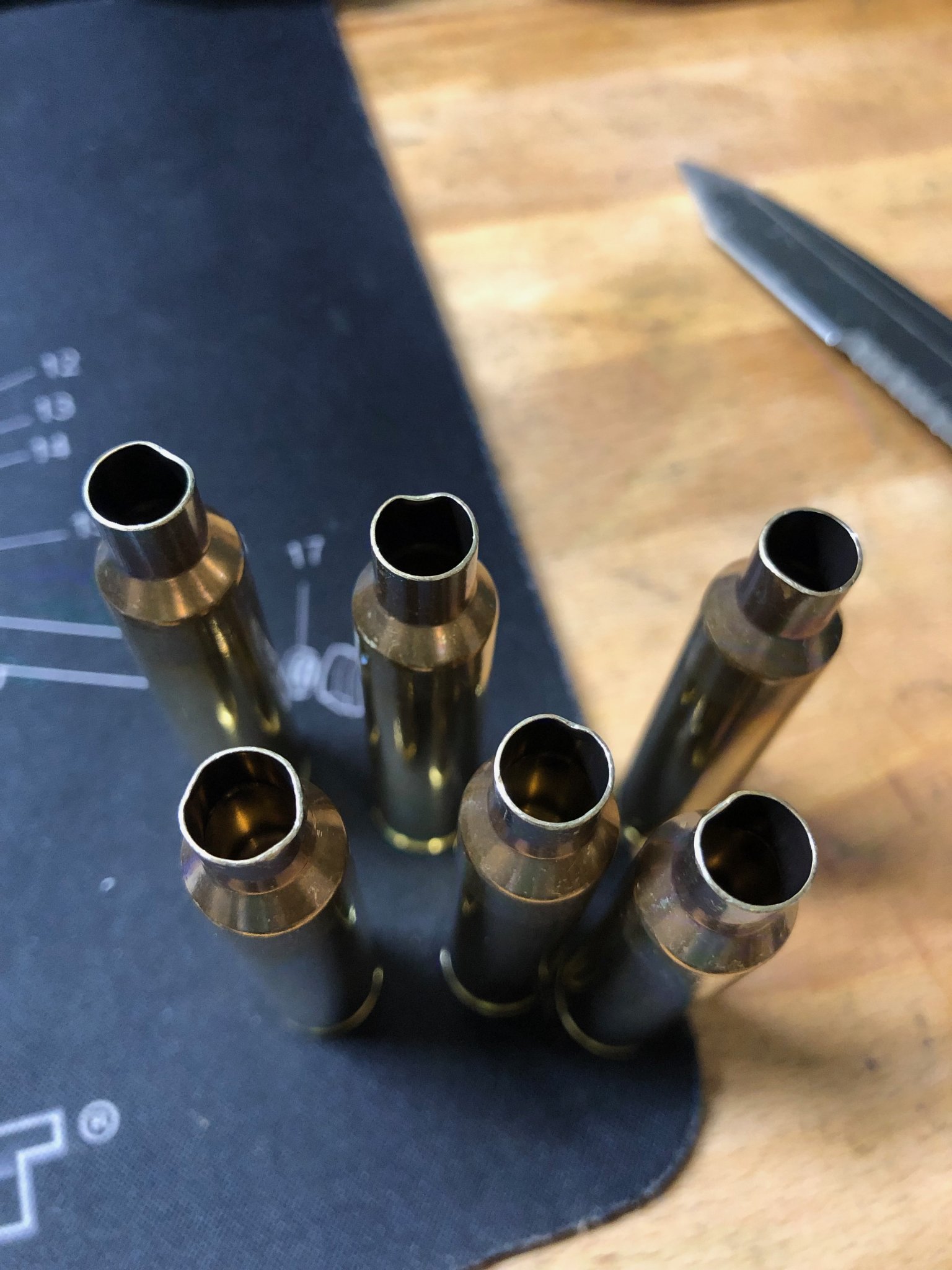

I recently purchased 200 pieces of Lapua 300 PRC brass and about 20% of them have beat up necks. I have never seen this before with Lapua 6/6.5 Creedmoor. Should I complain? I bought these from Milehigh.
The bigger necks of magnums can have a few necks dinged like that, I’ve noticed. Easy to straighten with a neck sizing mandrel.

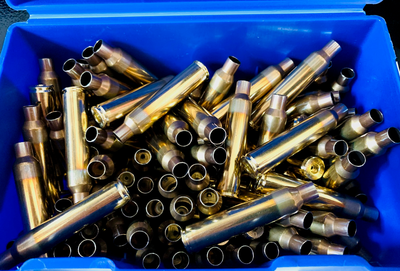

I do wish that Lapua would toss a cheap piece of foam in their boxes to keep them from banging around during shipping. If nothing else, it looks nicer when you have less of this showing upon opening the box. My 300 PRC Lapua brass did not have that level of dents though.

I would always use a mandrel in new brass, especially Lapua (because of their very tight necks). I wouldn't worry about it, wouldn't complain to anyone, it doesn't matter at all. I suppose you could always use ADG or Alpha brass if you want, since it will be packed in individual cells in a case box.

I do plan to use a mandrel. I just never seen anything close to this in Lapua Brass. I am going to load and shoot.
Reactions: brianf
The necks are fine. You should run virgin necks through a mandrel die before loading anyway. This will remove these dents.
Reactions: jmornoinf
Just got my box of 100 cases of 300-PRC Lapua brass from Creedmoor Sports ... it looks awesome. No crunched case mouths or necks that I can find on first inspection. You either got a bad batch, or something happened to them in shipping. Was the blue Lapua box "sealed" with the side-stickers when it arrived? Did the box from Lapua look like it had been opened? Just curious ...
I received two boxes in one larger shipping box. One with 20% dinged necks(some really bad) and the other no issues. Lapua believes the damage occurred in shipping...not sure?? I am going to load and deal with it. Just not the Lapua quality I am accustomed to.
There’s a good chance it’s exactly the Lapua quality your used to. Your just not used to shipping issues. I can think of several items I’ve ordered where the cardboard box looked like it was used as a piñata. Up to the point the blue box Lapua ships the brass in would be cracked
