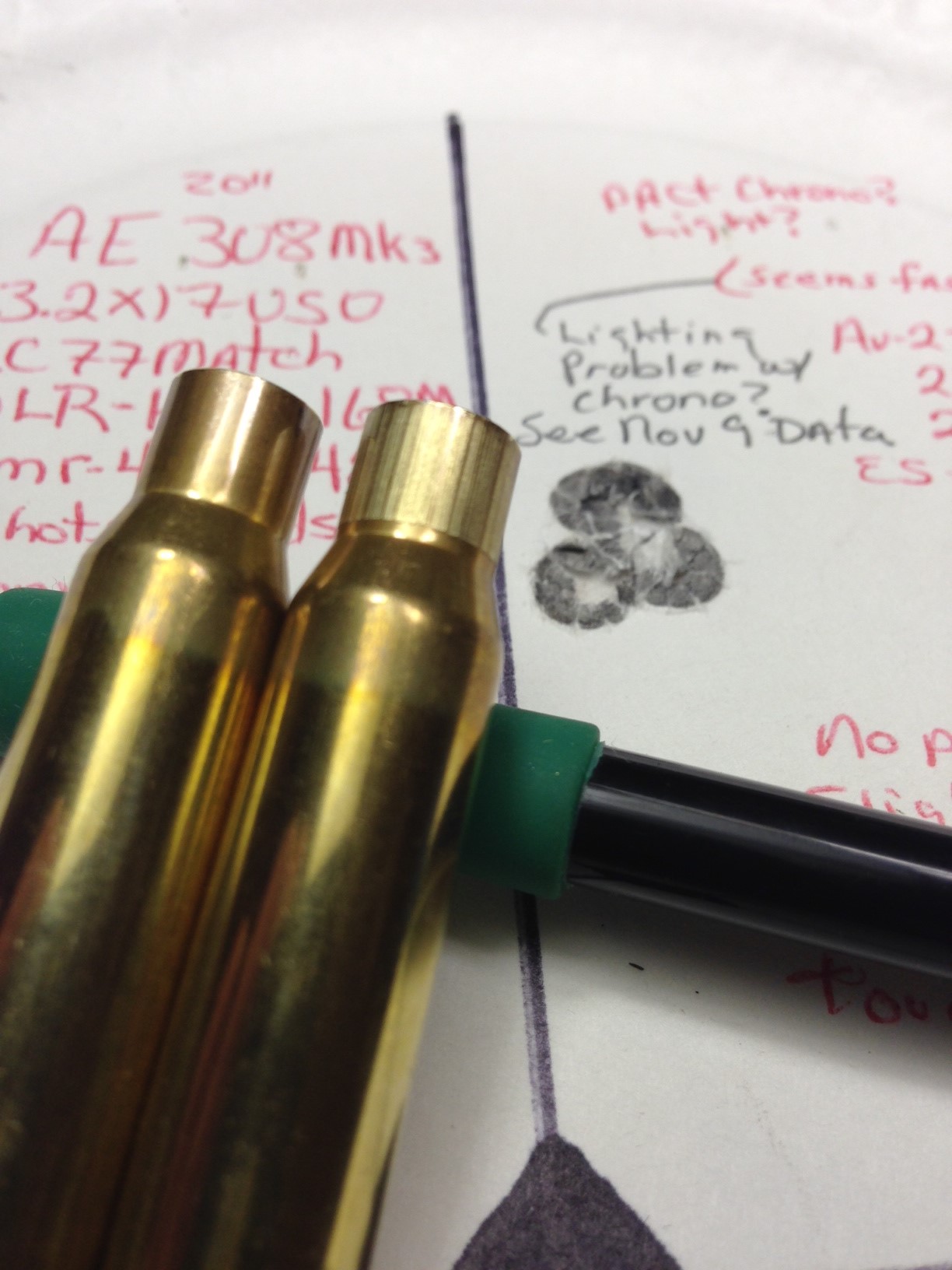

Neck sized my first Lapua 308 virgin brass last night.
Used Redding neck die with carbide expander ball.
Very lightly lubed necks (graphite inside, rcbs outside) and experienced galling that fouled the die and the expander ball.
I usually use LC Match brass and have a pretty established technique.
I have never experienced this problem before.
I buffed off the expander ball and cleaned the inside of the die (dowel with JB'ed patch) then went heavier with the lube.
Pictured is the scored brass with the heavier lubed case next to it.
I know now that the Lapua brass is persnickety when compared to virgin LC 77 brass (I have a good supply of old-new stock).
I am disappointed by this brass so far; all the press about it gave me high expectations.
So....Is this unusual? Is the Lapua brass worth it?

ElNino,
As has already been mentioned, the problem is most likely in the die itself, or rather, the bushing. I've seen this myself many times, with a wider variety of makes of cases. The problem always comes back to the dies or bushings. Do as Shoot4fun suggested, and touch them up with some Flitz or other mild abrasive cleaner like J-B and the problem should go away promptly. Part of the issue here is that once such galling gets started, the brass tends to build upon itself rather quickly. What appears as a mild gall mark. will escalate to a serious galling within 20-30 cases if it's not corrected. Polish them out, and make sure you've got plenty of a good lube from that point on and the issue should disappear.
You are correct that the brass buildup is cumulative and fast. I noticed this immediately.
I'm not prepared, however, to fault the die. It has never galled cases on me before.
The die and button started last night's session clean and I proceeded with the lube regimen I normally use.
Galling began immediately and brass built up quickly.
I stopped, removed the die and stem, and inspected the die body and expander button; buildup was as you indicated.
I cleaned all the brass out of the die and off the expander button then resumed sizing, but with significantly more lube (RCBS on fingers, graphite in neck with 30 cal mop).
The result is the ungalled case as pictured in my original post.
My experience indicates simply that new Lapua brass requires more lube than the LC 77 Match brass I normally use.
I base this on the fact that I neck sized a batch of virgin (old stock) LC77 Match last week and had no galling issues.
Thanks, Kevin, for taking the time to read this.

ElNino,
Couple of things here that may explain this a bit further. That LC Match brass is (at least) once fired, and this makes a huge difference. Powder has graphite in it, and this residue actually acts as a bit of a dry lubricant when we reload fired cases. Even if they've been thoroughly tumbled, there's enough residual graphite left to provide some lubrication. Enough to eliminate the galling, especially if you've used a secondary lube as well. On new brass (not just ours, but anyone's) you're dealing with cases that are usually completely devoid of lube, and are chemically clean. The final annealing process tends to remove any trace of oils that may still be on the case, leaving them prime candidates for galling. And as we mentioned, once it starts, it tends to snowball pretty quickly.
The best way to avoid this is to ensure that the cases are well lubed on that first processing, and even more importantly, to make sure that the expander ball and bushings or necks are given some degree of polishing to clean them up. With those cases that already show some gall marks, you might try cleaning them up a bit with some 0000 steel wool, so they don't give the problem a place to get stated again. Just a thought, but worth a try. Lube them well on the next go-round, and you should be back in the middle.
Remington brass is way bad for this also. The best way to cure this is to trim your new brass with a 3way cutter if you can, even if it means trimming below recommended trim length. There's a buildup of material on the case mouths, the expander ball pulls it out, and before you know it, you've got BIG mess. If you don't have a 3way, a heavy chamfer and deburring will work also.
Once that shit is in your die, flitz works about the best to get it polished back up, after you get it out with some solvent. You're lucky you caught it, when it gets in the die body, cases look real ugly!
All the lube in the world wont cure your problem, if you're using a bushing die, loose the expander, help some.
