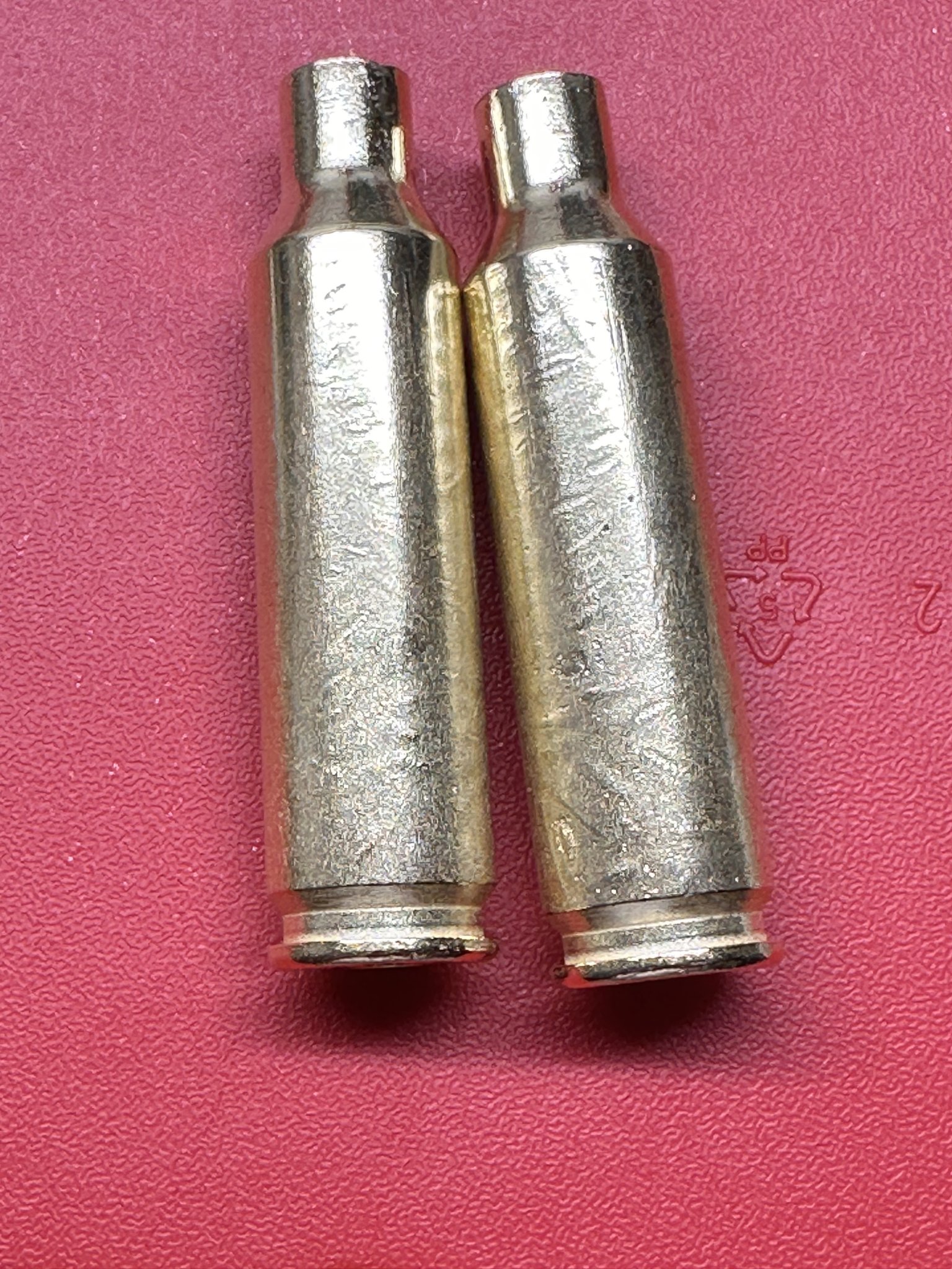

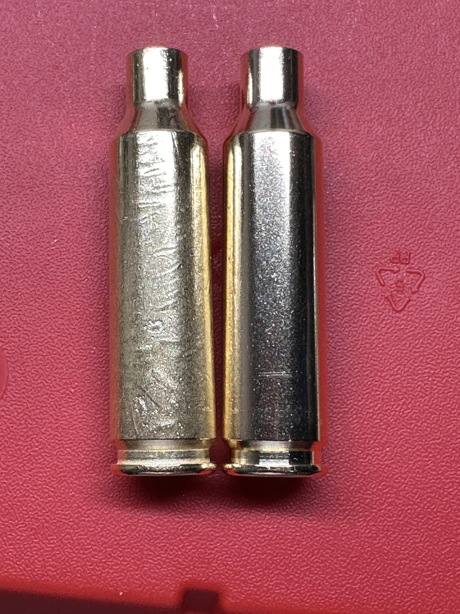

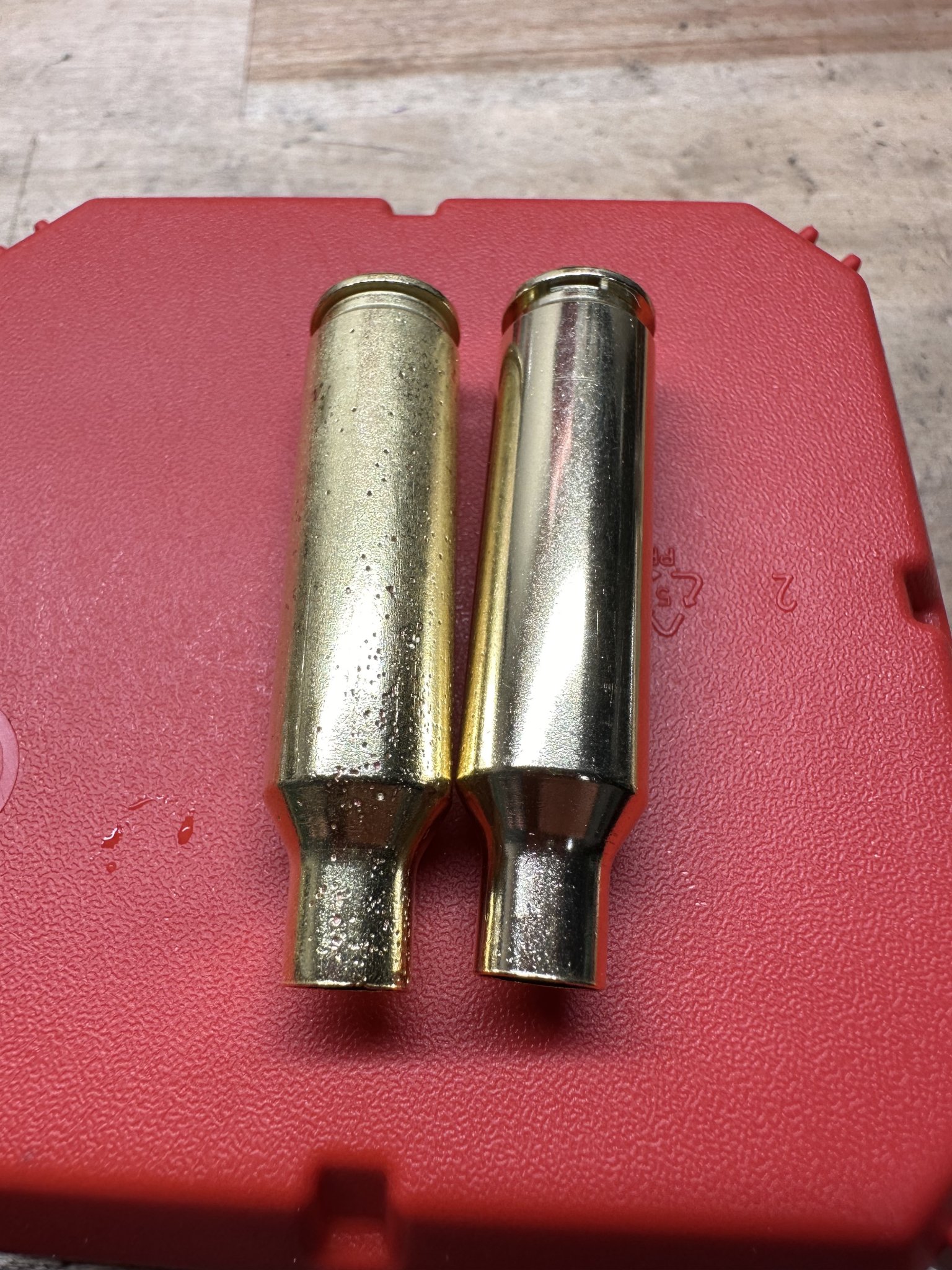

Ran 50 cases of once fired Lapua 6.5 Creedmoor SRP brass through my tumbler this evening. I used SS pin media with water and a cap full of Hornady one shot brass cleaner. Afterwards I was inspecting them and found two cases were majorly pitted and seemed to have eroded throughout. I weighed them and found they were nearly 10 grains lighter than the other cases. All are from the same lot and all are once fired.
This isn’t a “Lapua brass is going downhill” post. It’s simply something I’ve never seen and was curious on what explanation would fit the cause. Best guess I have is improper metal content.
Last two photos are next to a case that these were with in the tumbler. Same lot.

I've been cleaning with pins, dawn, and lemishine for years. Processed thousands of pieces of brass. Never seen this and never had an issue with it coming out clean. That being said, stick a piece of brass from that lot in a cup of that solution, and a piece of brass from another lot in another and compare. Let them sit for a week.
If one degrades and the other doesn't, it's a brass problem. If both look like shit, it's that solution you’re using.

That looks more like chemical erosion than excessive abrasive wear to me because of the pitting in the cases. It's almost as if there was an out of the ordinary material inclusion in those 2 cases that was etched away by your cleaning solution.
I've seen something similar happen when I accidentally left a piece of brass in Birchwood Casey case cleaner for 2 weeks instead of just a few minutes like the directions said... the solution significantly etched away over 25% of the case by weight and left it rough and pitted similar to your pictures, but in my case the pitting and etching was very uniform.
For those 2 cases to end up looking like that after a single tumbling cycle something reacted very strongly with your cleaning solution.
A look at the MSDS from Hornady shows the main active ingredient in one shot case cleaner to be citric acid, so basically the same active ingredient as lemishine.
Might want to contact Lapua with the lot number of that brass. Based on the other marks on the 2 problem cases it appears whatever inclusions were in the brass also effected the hardness and how it reacted to the heat treating. Be interesting to see what an XRF test returns for material composition on those 2 cases compared to other normal looking cases in the same lot.

On the one hand, it seems the odds that the 100 pieces of brass in your box being made from dis-similar metals is I think approaching NIL. Ont he other hand, that hornady stuff is highly concentrated, highly corrosive acid. The odds are that those cases were chemically etched by the acid solution. Figuring out how that happened will probably cost you more than $2 of the lost brass...

It's highly concentrated for sure. I add a capful to a full tumbler of water and media, stir, then add the brass.
I agree they were etched. Sorting it out is more of a curiosity than anything else. That's why I left it up to this lot to speculate. ;)

That, to me, seems like a long time for tumbling with a solution designed for sonic cleaning . . . ??? 🤷‍♂️ I have a feeling the result is from the combination of things; like there being some difference in the brass alloy AND an acidic solution with the aggressive agitation of the tumbling.
Might be worth picking up a ph meter or some ph test strips and seeing what the difference in ph is between 1/4 tsp lemishine in a tumbler full of water (standard mix for stainless tumbling) vs 1 capful of one shot concentrate in a tumbler of water.
That being said, if one capful of one shot in the tumbler was too acidic every case would have come out looking nasty and pitted.
