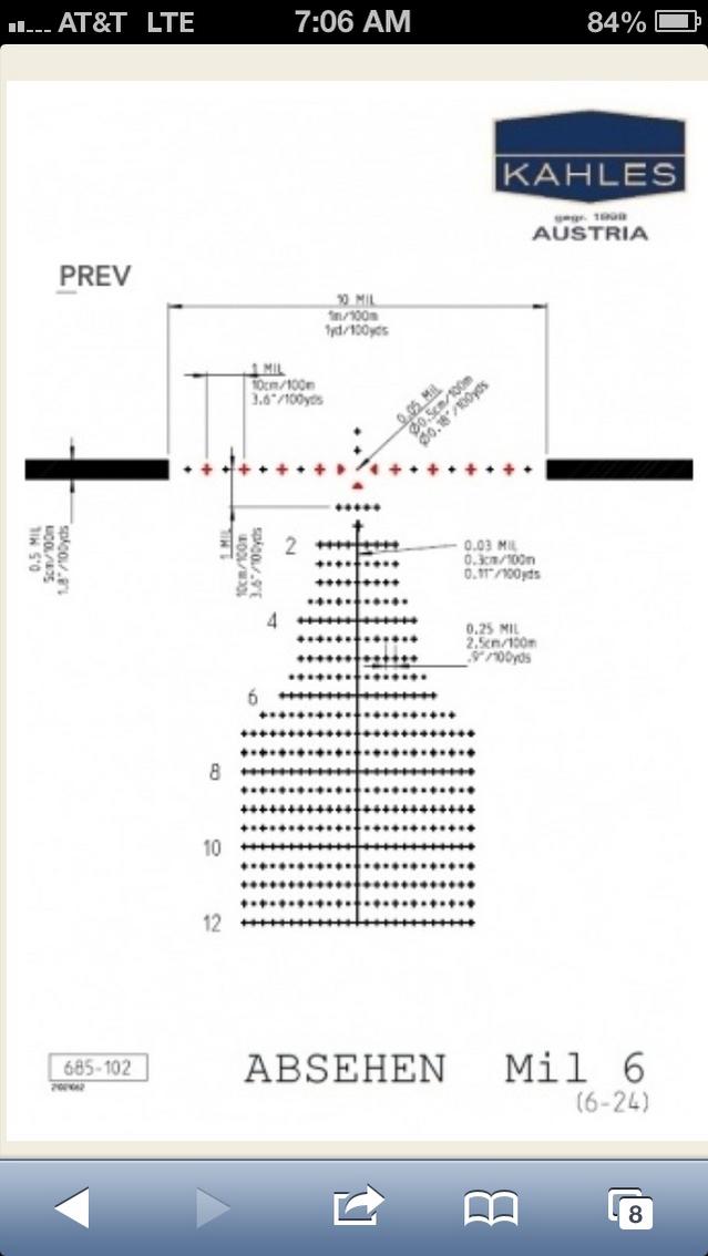

I have a DTA SRS. I put a Kahles 6-24i on it in a spuhr 44MOA
mount. With a 450yard zero for the .338 Lapua I am .4 mils from the very bottom giving me roughly 90moa or 26 mils to dial in. I also use a .308 conversion for this platform and the mil 6 reticle has hold under for .5 and 1 mil. With the 1mil hold under crosshair it is a perfect 100 yard zero for the .308. I got pretty lucky. The objective is about 2mm from the rail. Below is an image of the mil 6 reticle.
