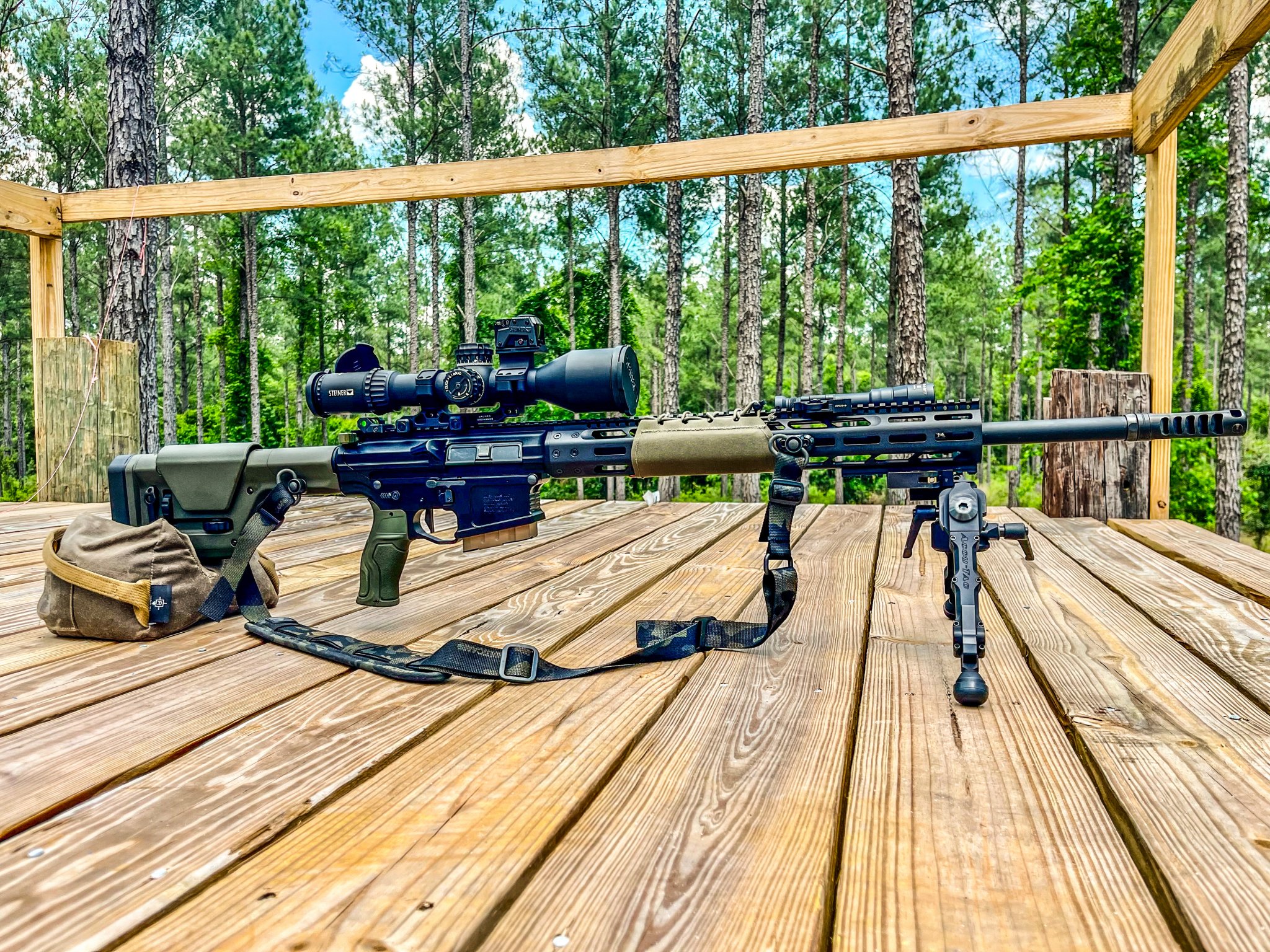

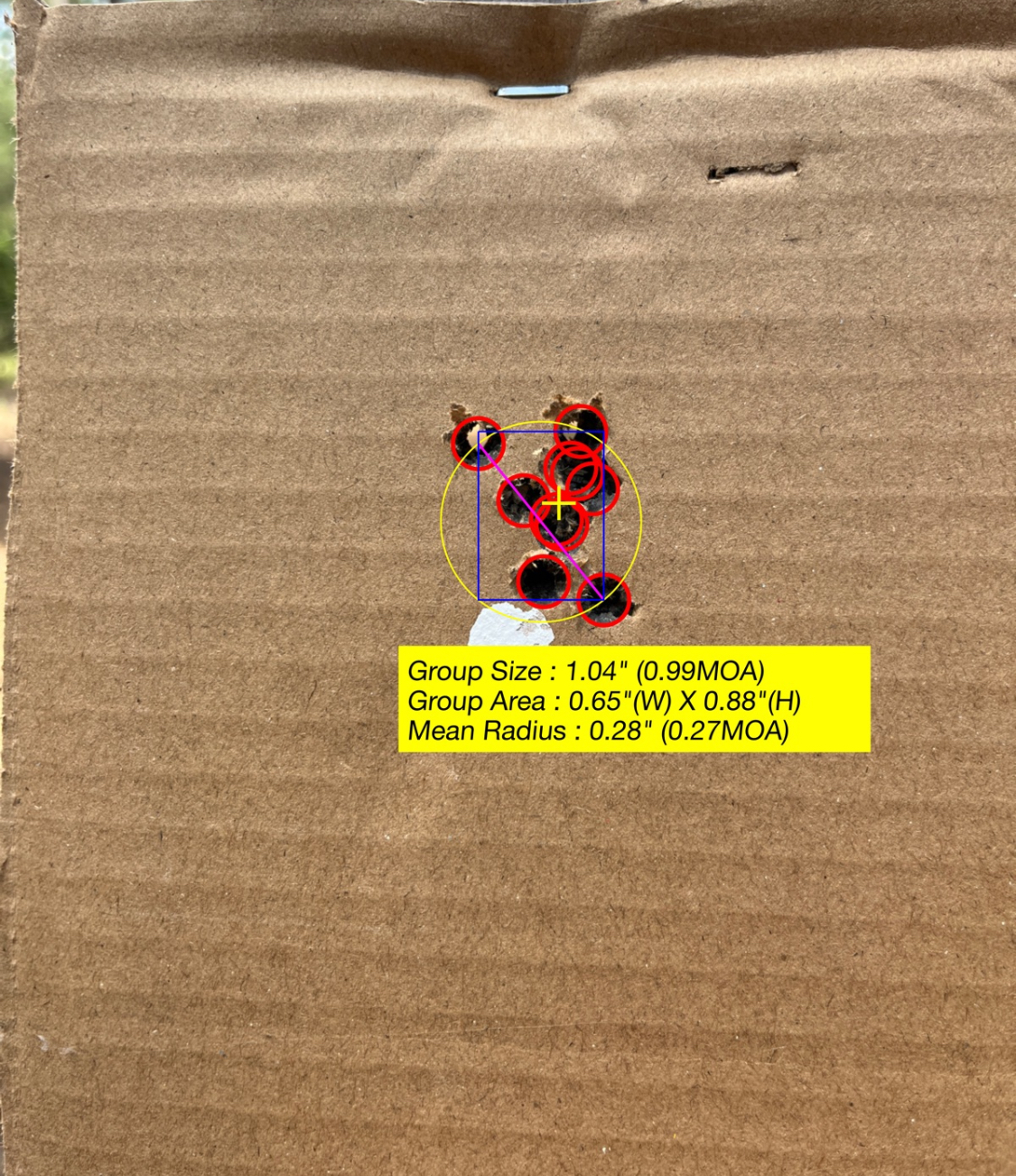

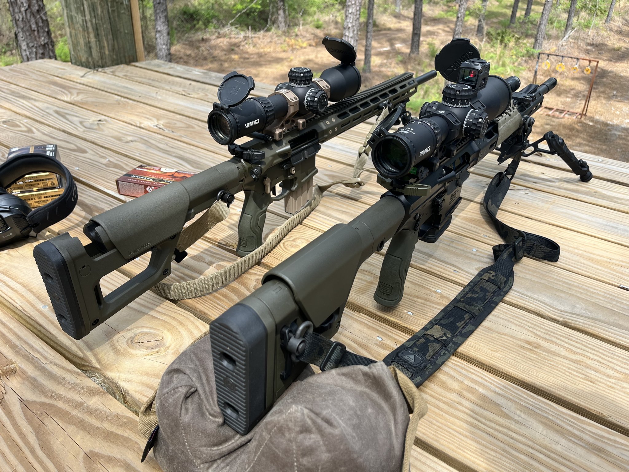

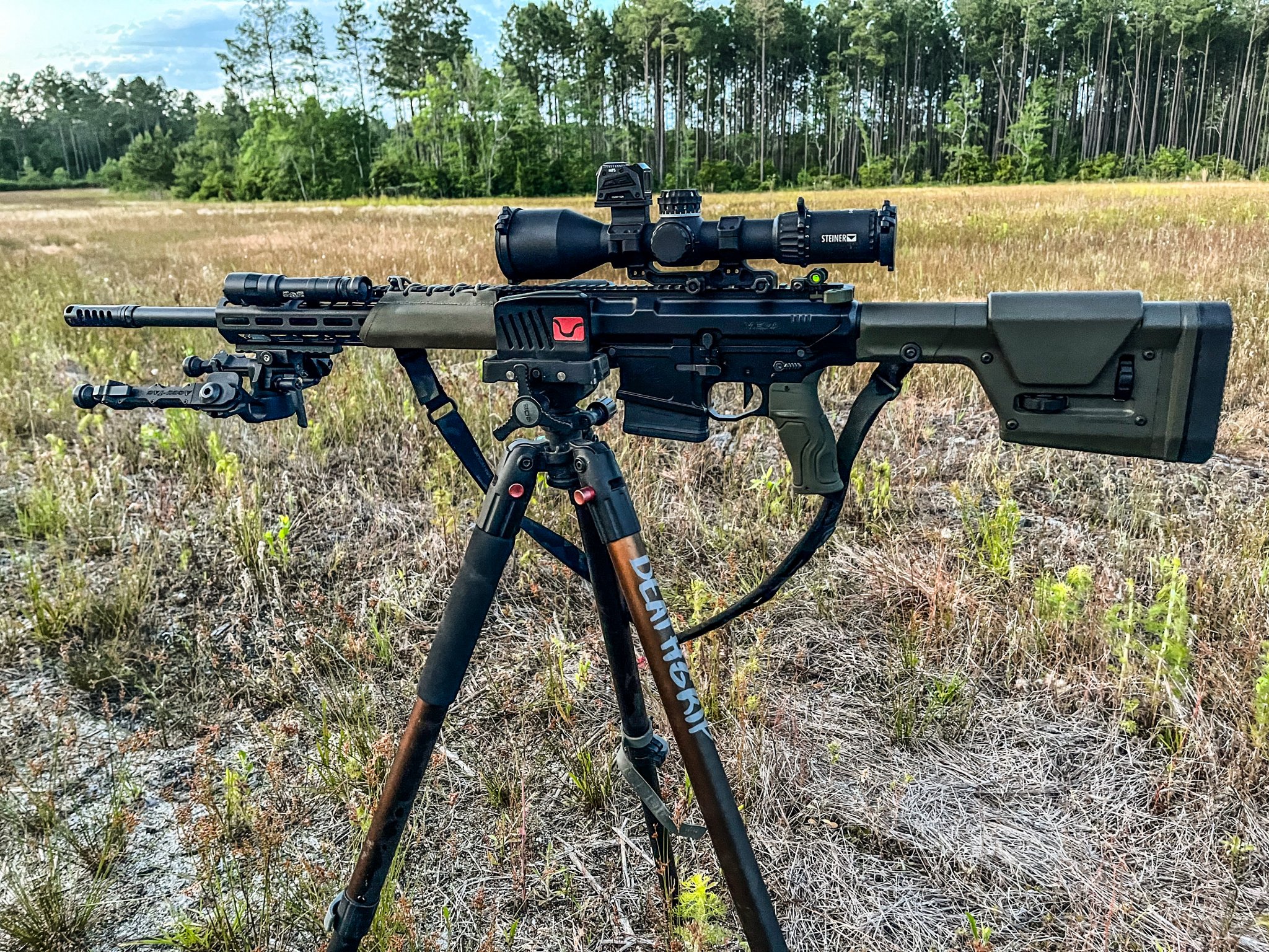

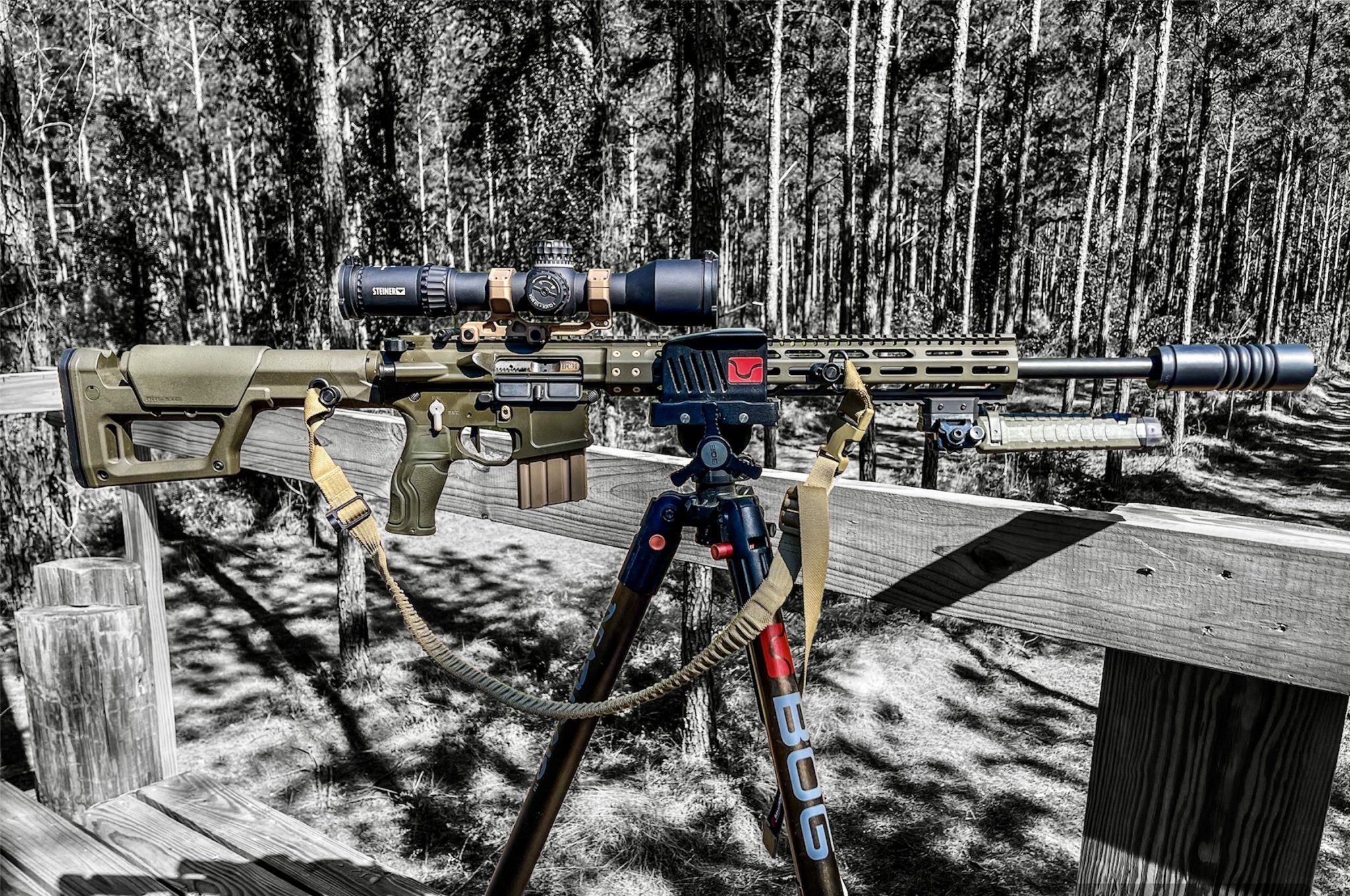

This started last May planning this build out. Ordered a Mega large frame MML set last June and just got it last month to finish this out, it’s been a wait. Used @bigjake83 ‘s spec’s with CLE for a 22” Bartlein m110 blank, appreciate it friend. This build goes very nicely with my small frame Mega build, both equally getting me into bolt gun precision territory I was after with gassers. I’ve only shot one load in this gun so far since my wife’s precision ar (and only 6.5 creed we owned until now) favored 130 FGMM I stocked up with 700 rds of it awhile back so I have just used it so far breaking this one in. Only had it out on two range trips so far, one to break in the barrel and one to test it some. So far it hasn’t shot a group over 1 moa hovering several in the .6-.8 range and one 10 shot group .99 moa. I’ll be reusing the brass shortly to start a dedicated hand load for it. Rifle is a complete pleasure to shoot and runs so smooth with how it’s set up.
I’ll update the post again when I work up a load for it and what I can really get out of this rifle.

Looks nice, B Man. Your 223 has a big brother to look up to now.
I'm a bit behind you, but I'm working on something similar. I just got my Maten upper/rail from Zev a couple weeks ago (backordered it last Sept) and a 20" CLE barrel before they stopped back in Feb or so.
What'd you end up going with for recoil system and BCG? I'm leaning toward H2 JP scs and full-weight BCG - either RCA or JP.

RCA bcg (became my go to large frame bcg), 9 oz kak rifle buffer, JP polished buffer spring.
Between the weight, recoil setup, and brake the recoil impulse is ridiculously smooth. My wife’s 6.5 creed has same set up and brake but a standard rifle buffer and spring and definitely tell a difference shooting them side by side. I would swap her stuff around but I hate to touch it now.
