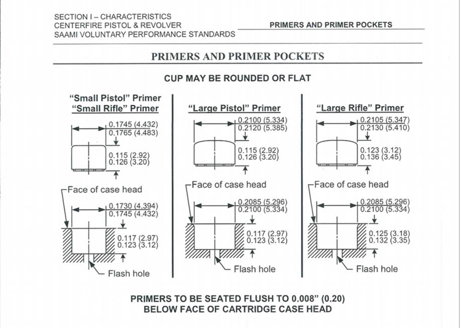

There can be or are some significant differences (variations between manufacturers) between Large Pistol Primers and Larger Rifle Primers (see pic below). Depending on the dimensions of the primer pockets your brass has, it's possible the pistol primers can work in those rifle cases. But, you'd better check and know your dimensions. Also, note that the thickness of the material that's used in pistol primers are thinner than those in rifle primers, which can cause piercing of the pistole primers due to much stronger strikes rifles tend to produce.

Thanks for the info and print. I was thinking the same. I will definitely load just primers an some empty cases and just see what the firing pin does for starter . Yep and call to see what the mfg says.
