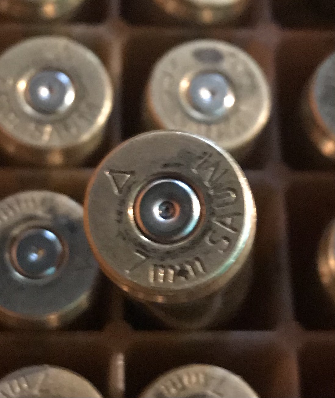

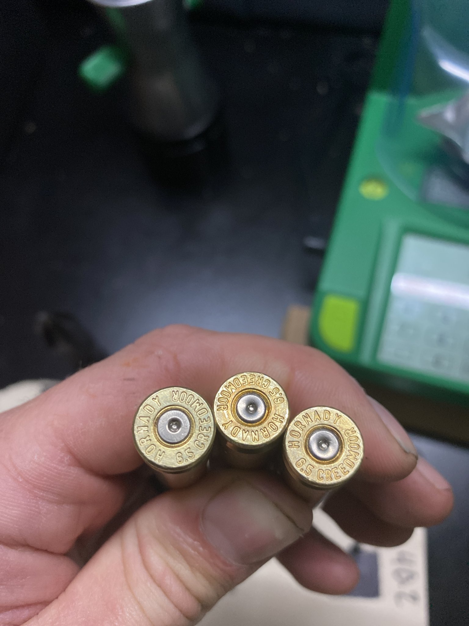

This is my first time reloading Large Rifle Primers. Using Federals. Shot during powder charge tests. First round fired, next two didn’t! I then moved on to heavier powder charge and same damn thing. 2/6 cartridges fired. The ones that didn’t fire are severely caved in and obviously have a strike. Help!!
It’s either your cases are under size so they rattle around the chamber when struck instead of setting off or your primer isn’t seated all the way in the case so the firing pin energy goes into seating it instead of crushing it. Or you have a weak spring or some sort of dirt or interference. Or you don’t have powder in them.
It looks that way to me. And many priming tools don’t seat the primer all the way down, especially when there’s a lot of resistance.
The one on the left is a sign of high pressure... other two look like loose pocket issue or not seating them far enough in.
Get your self a collet built puller and pull the ones that did not fire apart and see if they have a charge of powder. But from the looks of it, I think the primers are lose in the cases, so they are floating. Do you have another manufacture of brass you can try?
Also, what is the information on the load you are trying to use?
Debris in flash hole
No powder
Primer not fully seated.
Fired primer / case, that looks fine, plenty of radius left on primer.
Getting an optical illusion from reflection of brass that makes primer look flatter than it is.
I've had one empty round leave the bullet intact after the primer was struck.
Look for something wrong that happens 4 out of 6 times.
(like mostly wrong all the time).
Powder? Hope not.
Seating or loose primer? Maybe.
Headspace/bump? likely

Regardless of any headspace or primer seating issues, those don't look like light primer strikes. Pull the bullets and see if there is powder.
Reactions: Gunnn
Had it happen a few times to me over the years. Missing the charge. As other have said, pull the bullets. If you want to know right away, shake them. If its a compressed load and you cannot hear it, weigh them. If they’re missing the charge it will be off by 40+ grains.

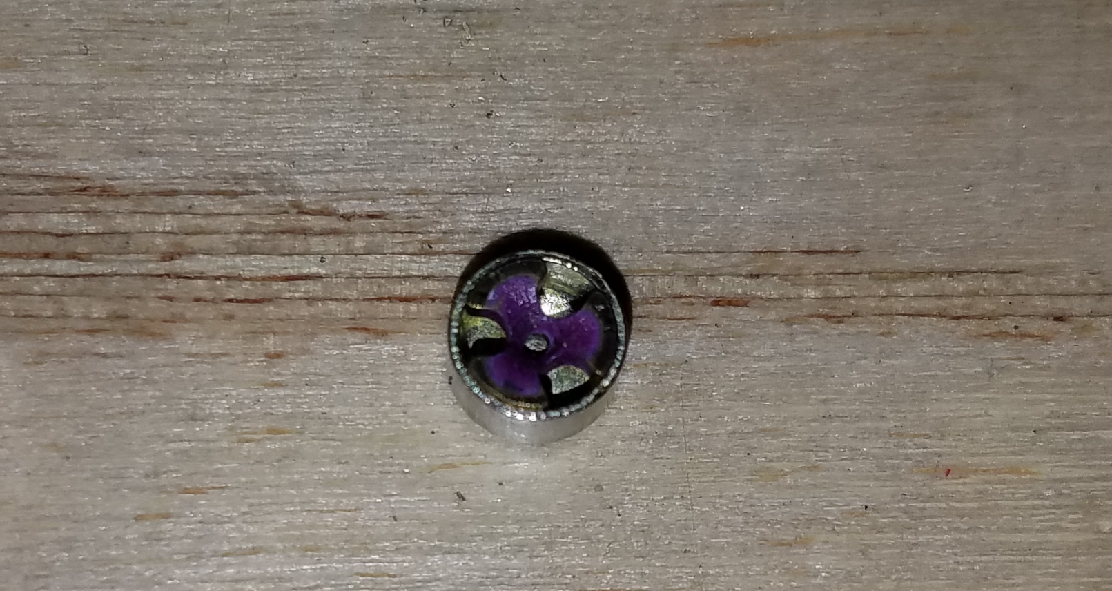

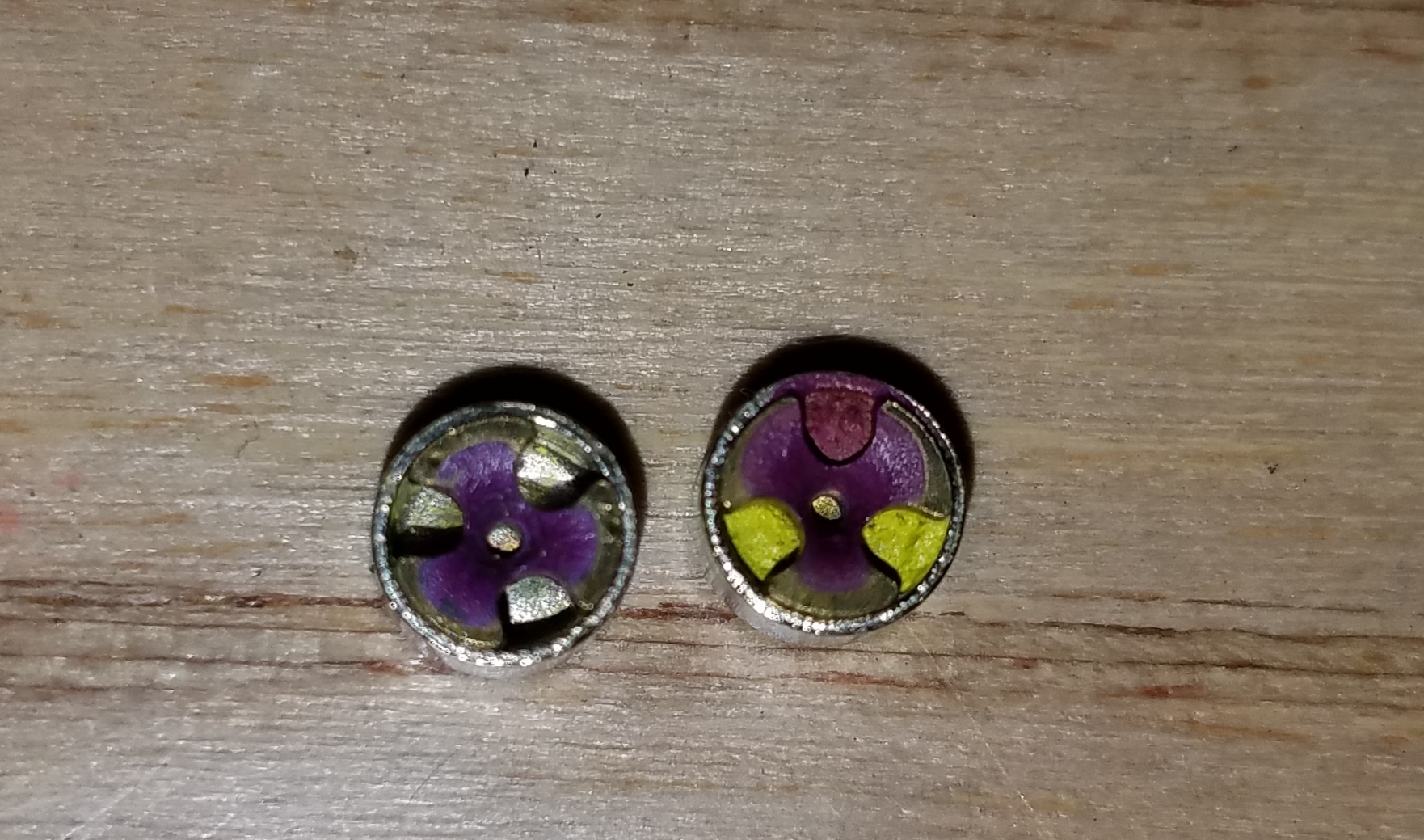

This is my first time reloading Large Rifle Primers. Using Federals. Shot during powder charge tests. First round fired, next two didn’t! I then moved on to heavier powder charge and same damn thing. 2/6 cartridges fired. The ones that didn’t fire are severely caved in and obviously have a strike. /QUOTE]
I had this happen a couple of weeks ago. No primer compound.

Had the same thing happen with an older Federal 210M primer 2 years ago - Missing Priming compound....check every primer now.
