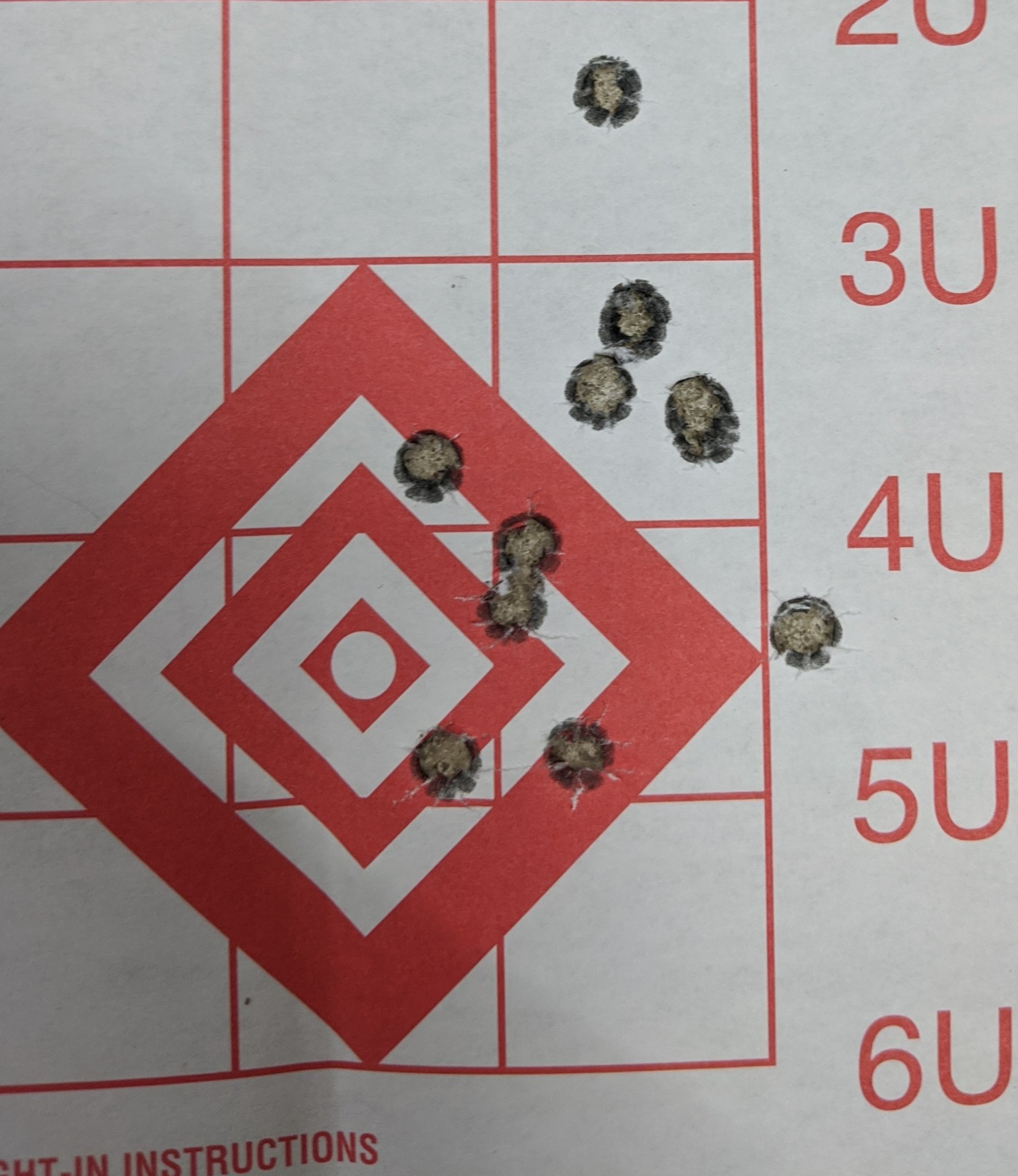

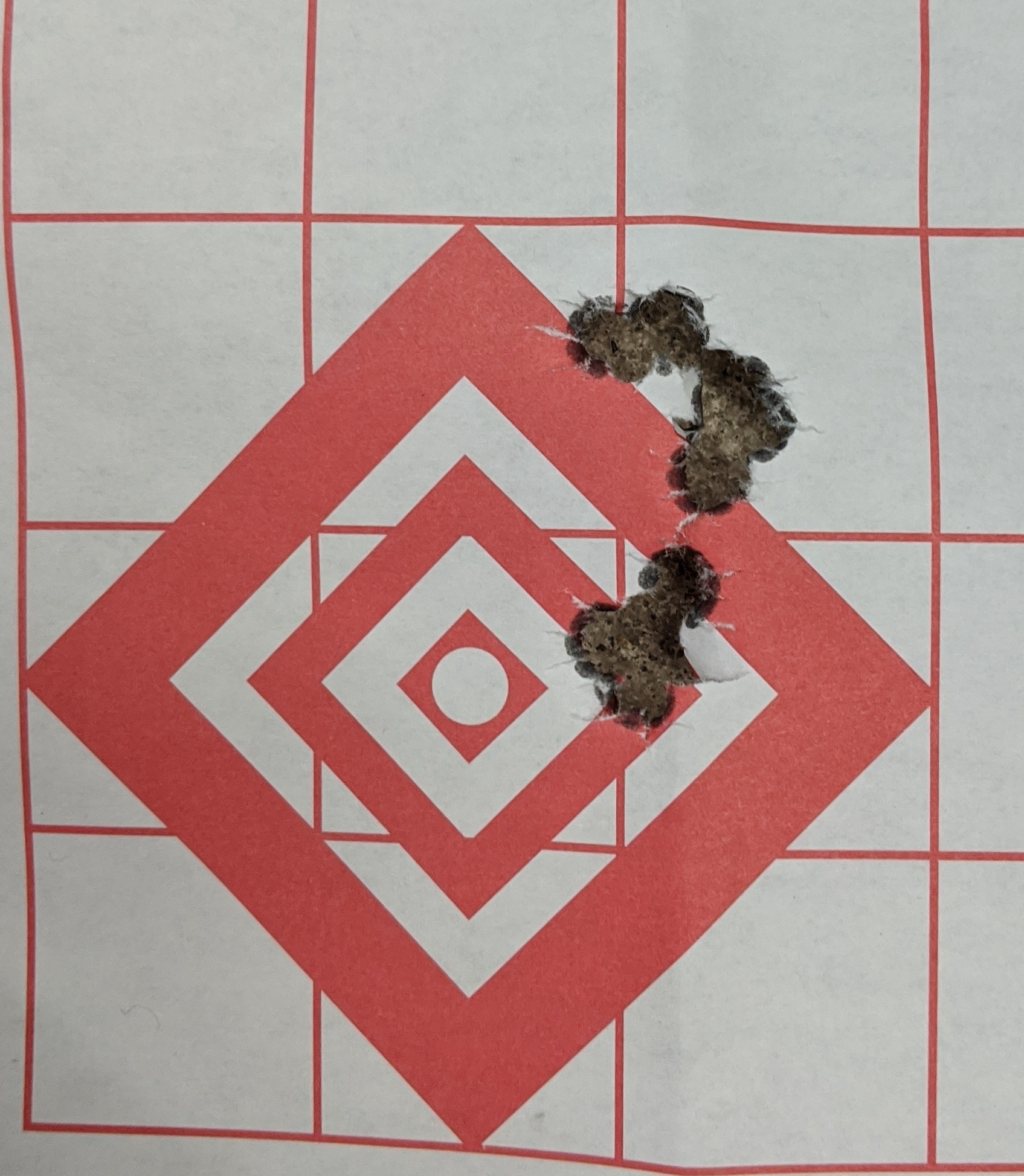

Below photos were shot running a pressure test . Big group is fed 215m, small gryis fed 210m

I tried the same using 210M v's 215M. I couldn't get a stable group over different days using the 215M's. Not like I could with 210M's. I just used the 215M's for my plinking 308 stuff out of the M1A and looked harder for 210M's.

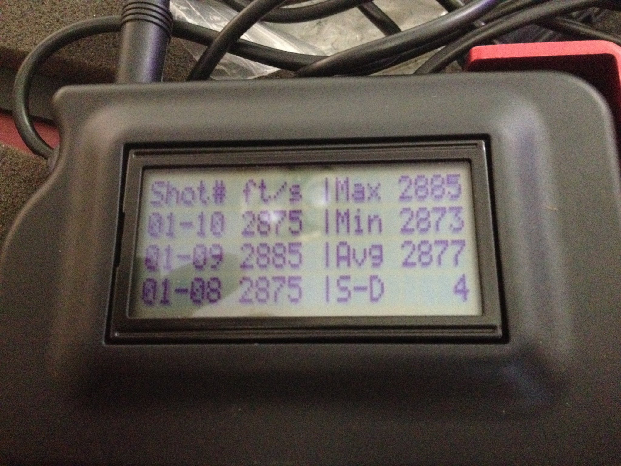

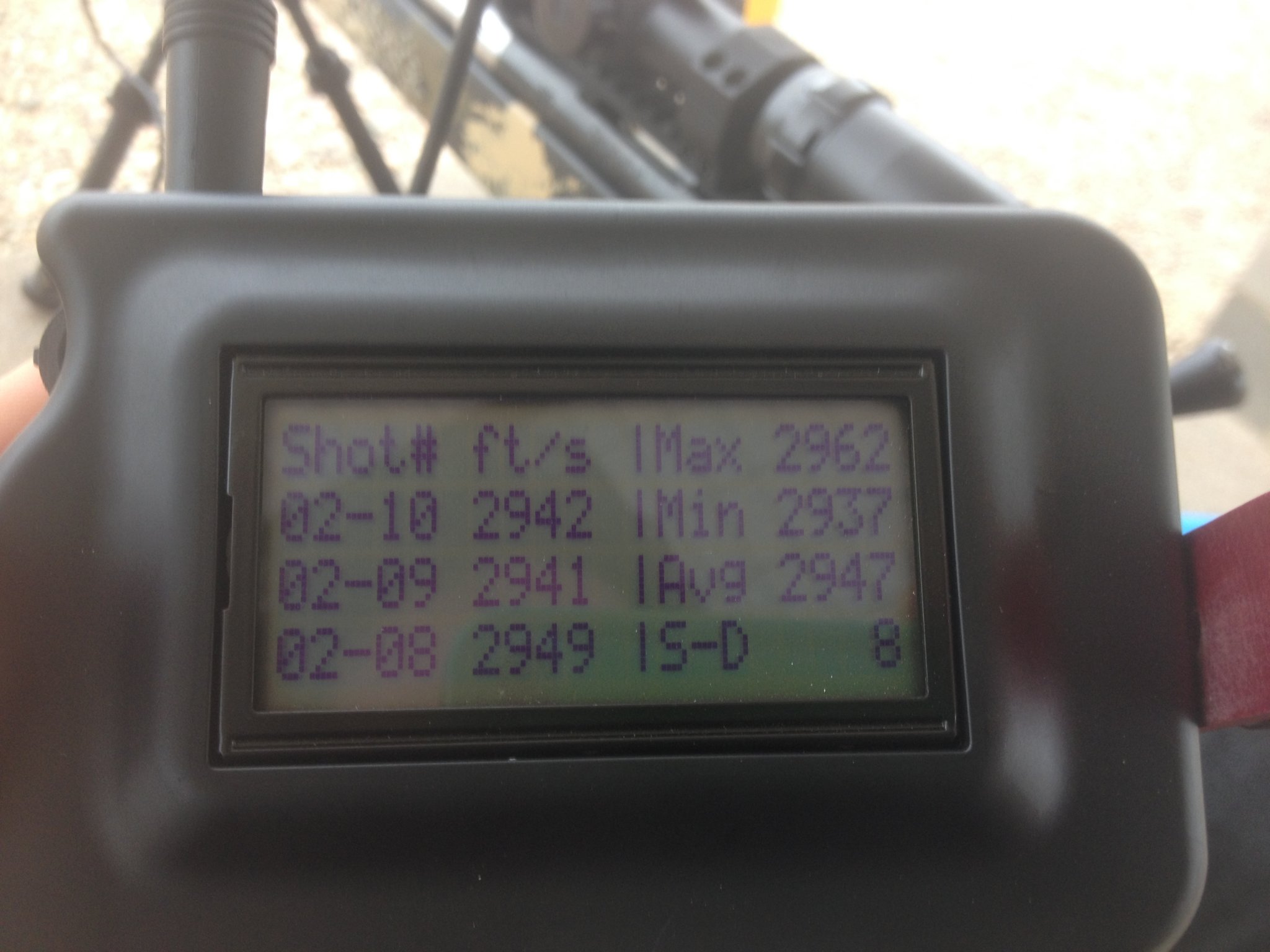

CCI450s
Virgin brass and once fired, same load. 6 Creed Starline brass 105 Hornady HPBT h4350, 21" barrel. The slower one was the virgin and also a new barrel.

CCI450s
What was accuracy like? That's what really matters
