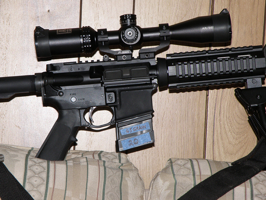

You need to figure out what height will give you the correct cheek weld for you. My Bushnell AR/223 4.5-18x40mm scope with Nikon P-SERIES split mounts measures 1.375" from the top of the rail to the center of the scope tube. This is to low for a comfortable cheek position to look through the center of the scope lens. I will change it to a height of 1.5" which is perfect for me. 1/8 th. inch makes a big difference for me. Some guys like 1.25" which makes the scope veeeery low. With the Nikon two piece mount had to be turned around so the zoom adjustment ring would not bind on the mount. Here are some pictures which show the difference.
The first picture has a riser + low rings which 1.5" and I could leave the rear sight on. I like this height.
The second picture they measure 1+3/8" and I had to remove the rear sight and turn the back mount around backwards to work, but is to low for me.
