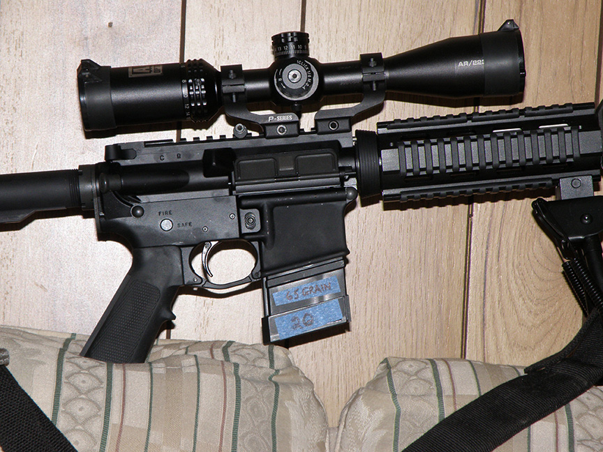

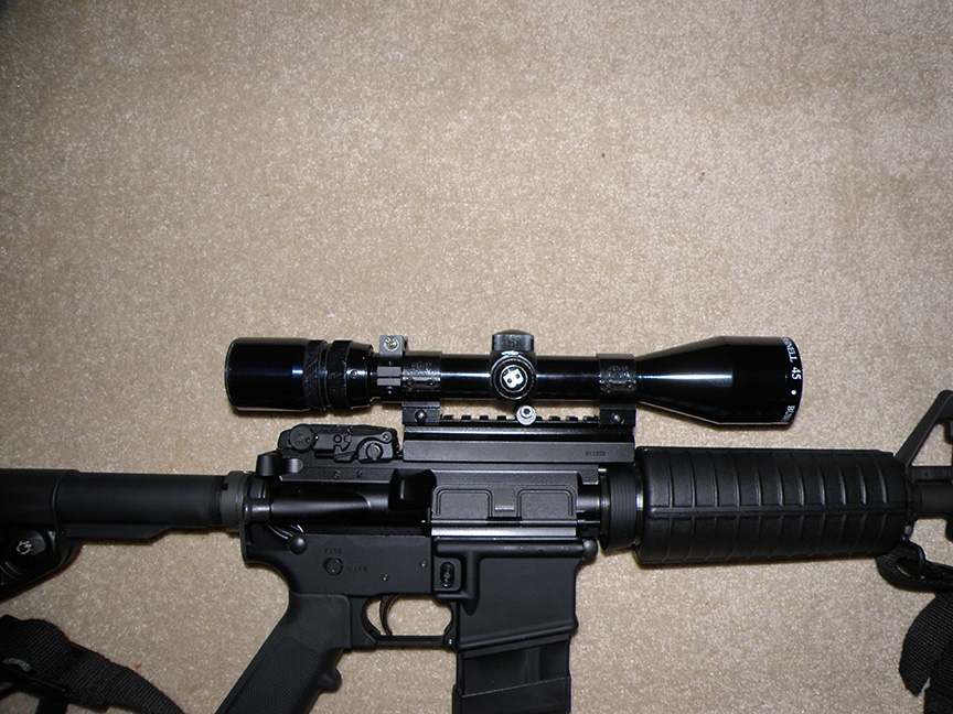

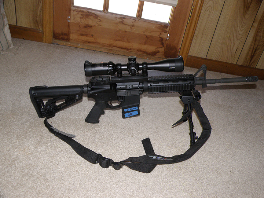

This is how I had my Bushnell 3.5-10x45mm scope mounted. I really like how my cheek weld was with this mounting. I then took some advice to change the mounts to this Nikon P-series rings. With the new rings it lowers the scope a little and looks better then the old setup. These rings force me to push my cheek down to allow me to see through the scope. I am not real comfortable with this cheek weld. With the old mounts my cheek weld is very natural and is very fast compared to the new one. A lot of the Nikon-series are used so they may be good for you. I'm going to try and see if I can get used to the new setup before I change it back.
PS: I had to turn the rear mount around because the new scope eye piece would touch it. The new scope is a Bushnell AR/223 zoom with 4.5-18x40mm power. I like to have high power for long range and target shooting.
