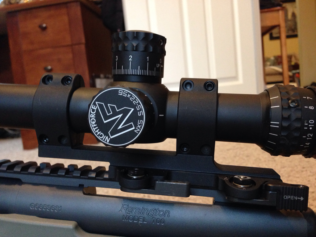

I used the LT104 on my 700 with a NF scope and AICS. Although it was pretty high, the adjustable cheek piece made it workable. The think that KILLED me was the eye relief. Because the 104 moves the scope forward some, I had trouble having adequate LOP and getting a good sight picture at the same time. I switched it out for the lt120, with no cantilever, and it sits lower too.
Sent from my iPhone using Tapatalk
ImageUploadedByTapatalk1391604491.661359.jpghere is the 104
