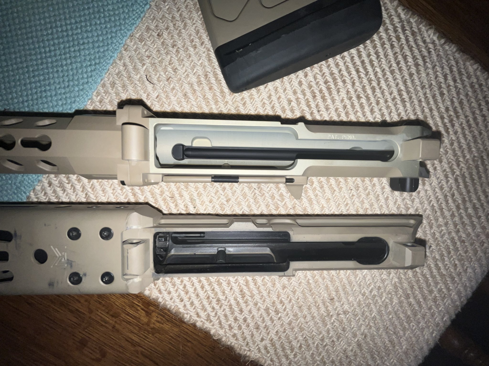

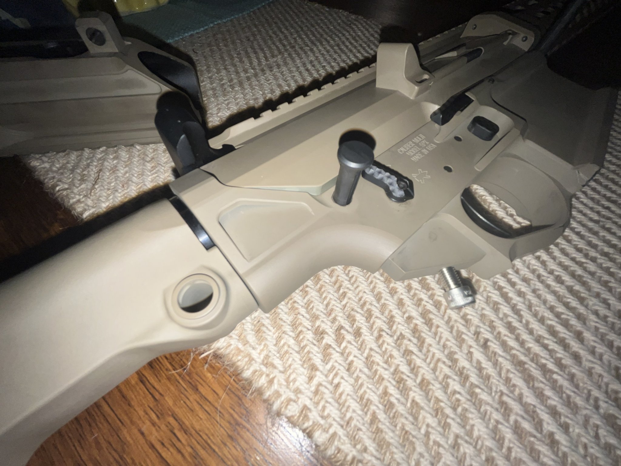

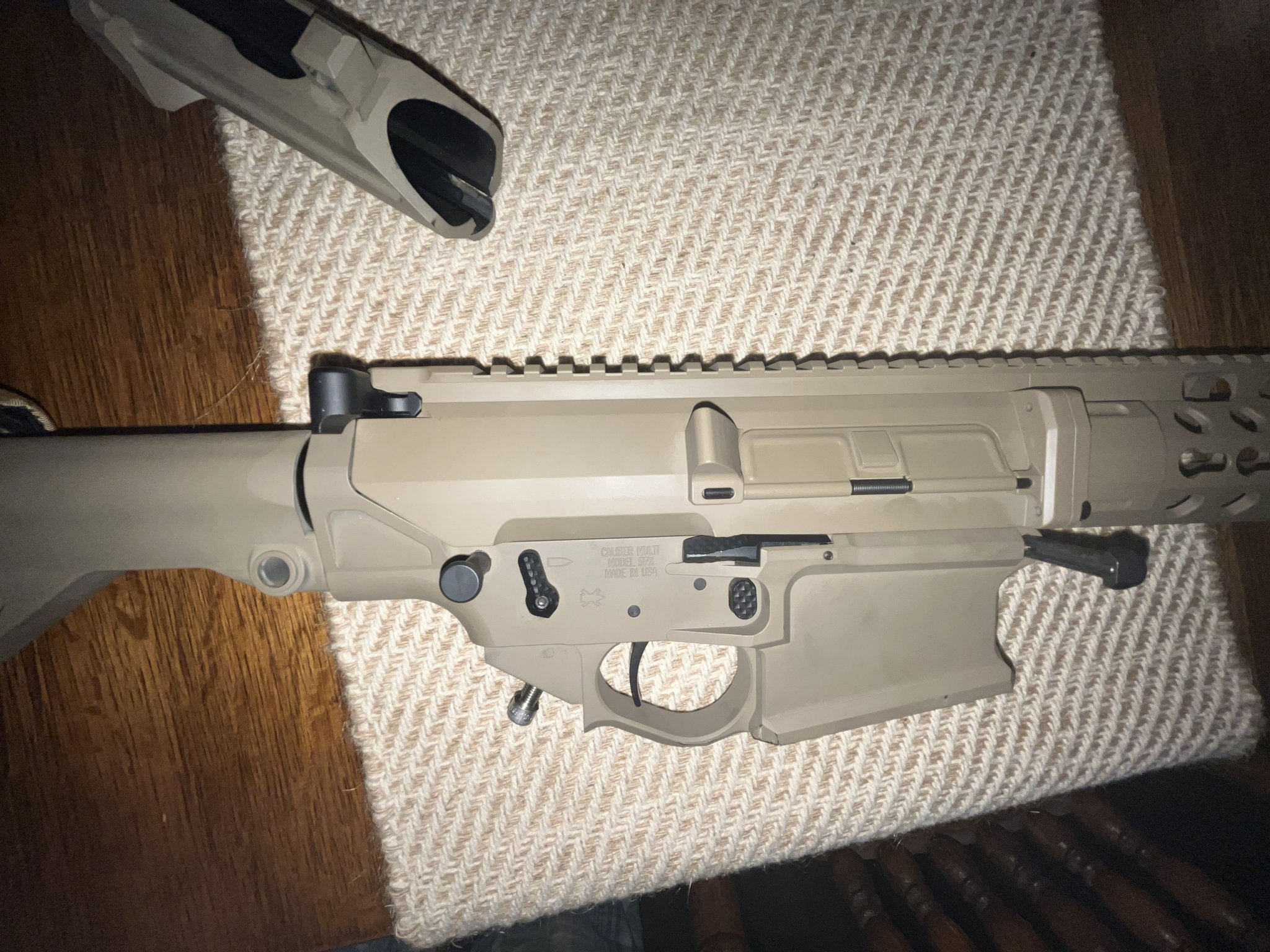

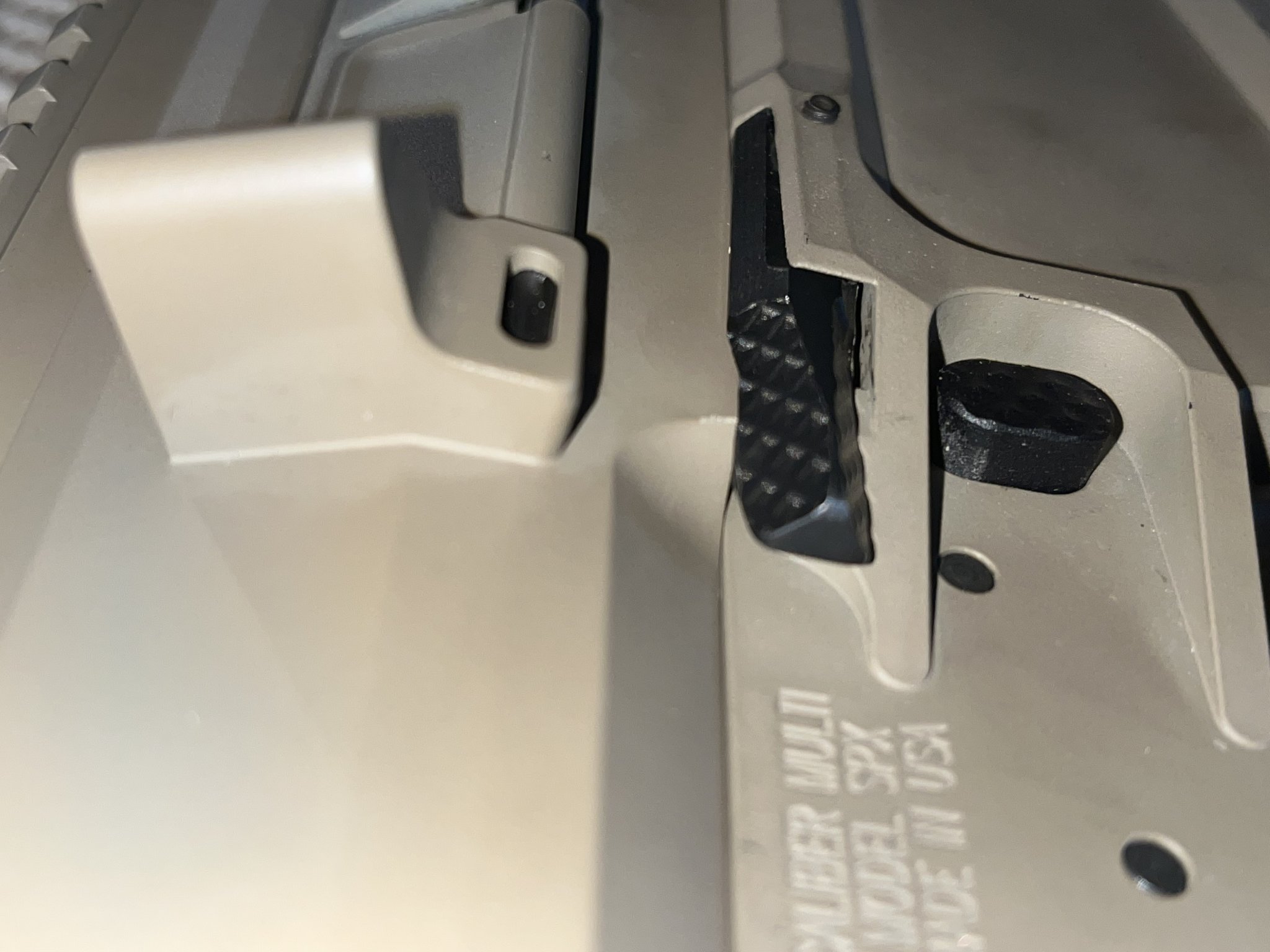

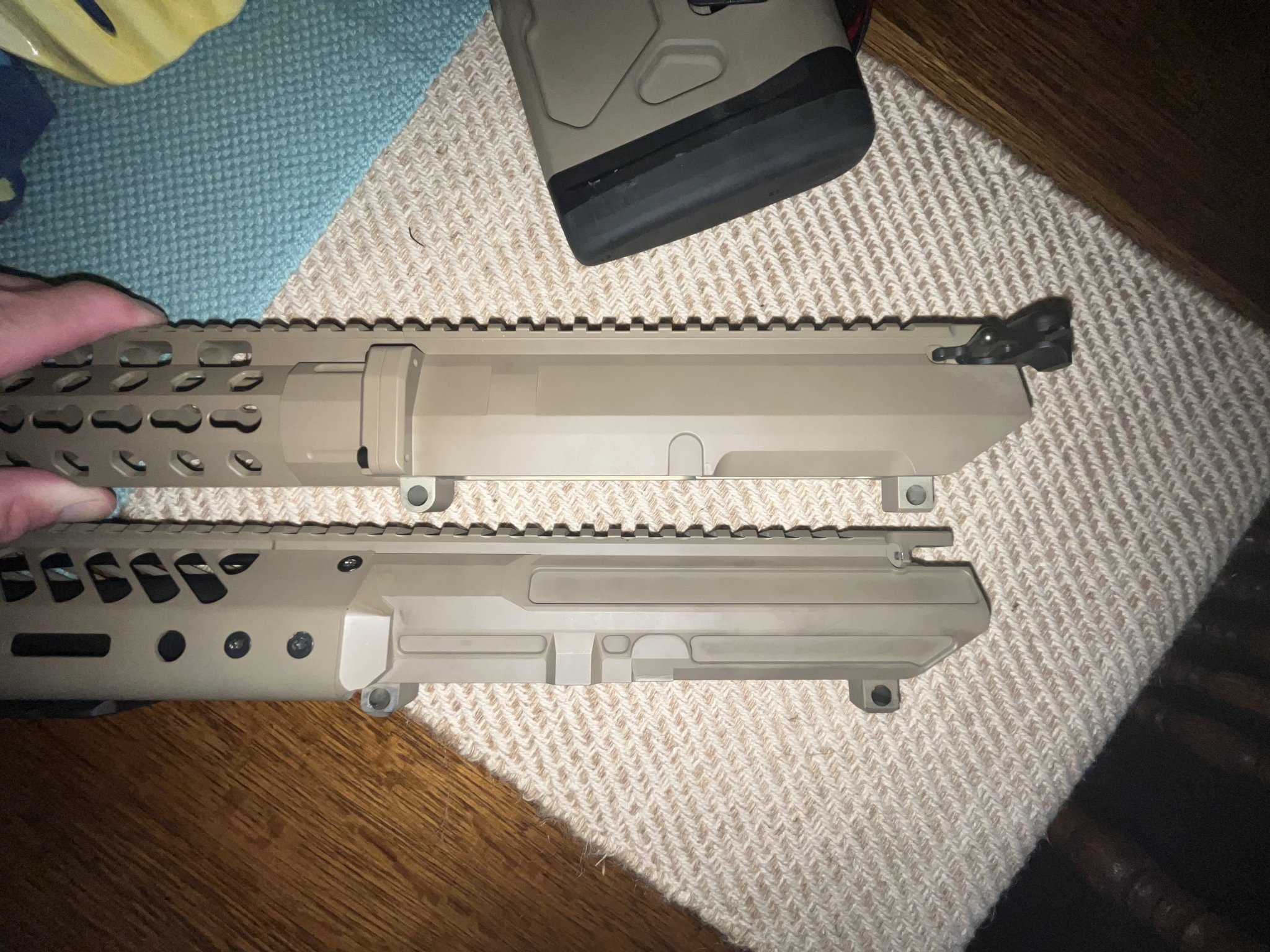

Can you post a pic of where the SP10 make contact.

Pictures like that are great they give you an good idea of what you are getting into.
Thank you
Thank you
The pins were super tight. I didn't try and force them in. I'm concerned the LMT MARS H right side bolt catch / release might have clearance issues.
