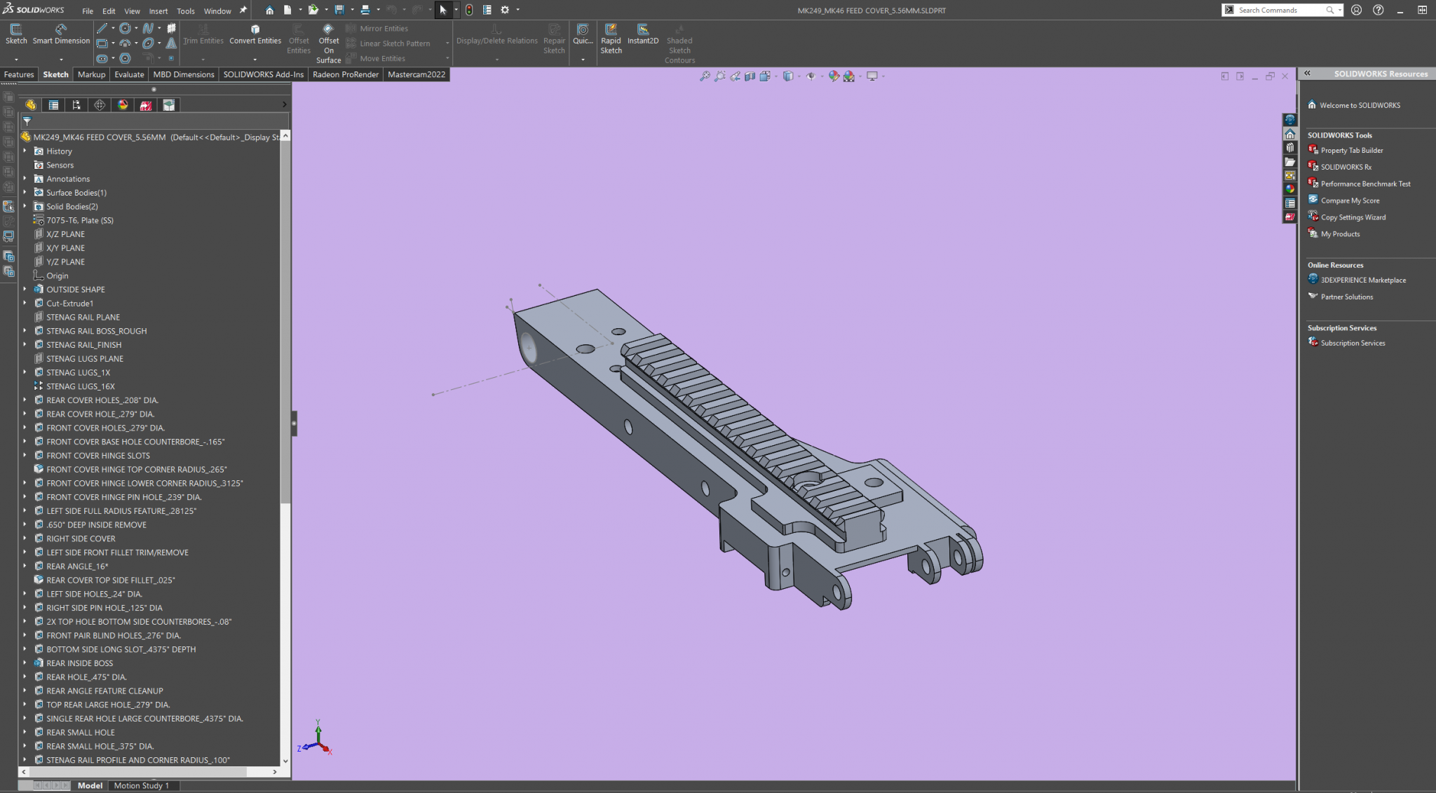

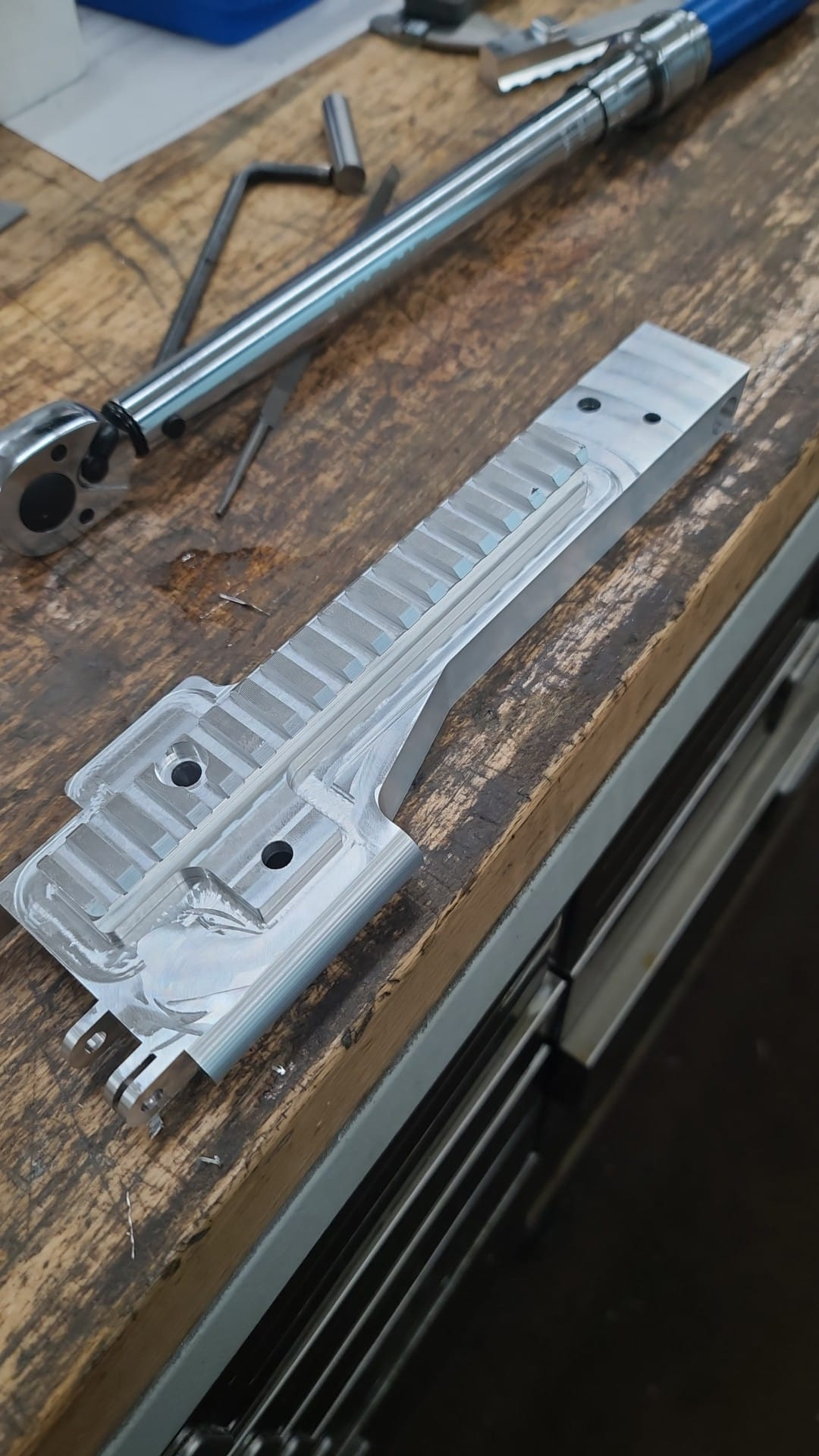

    I don't get prints or models on this stuff. I get handed an artifact part and the party starts from there. Late yesterday afternoon the tree started to bear fruit.
    M249 SAW feed cover trays in process. Bar stock 7075 AL.

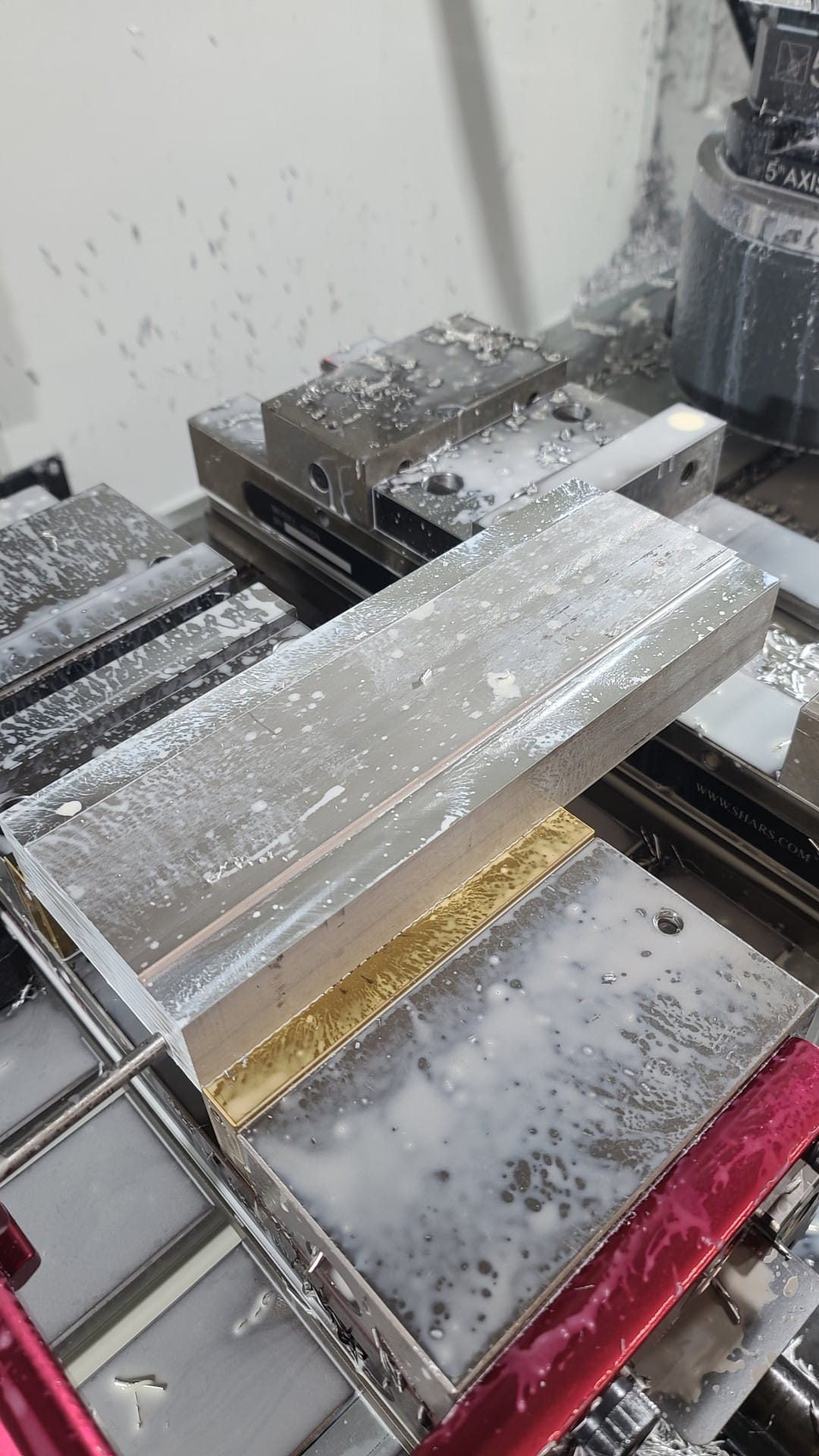

    Op1_Stock prep. Ripping a pair of dovetails into a 6lb block of material.

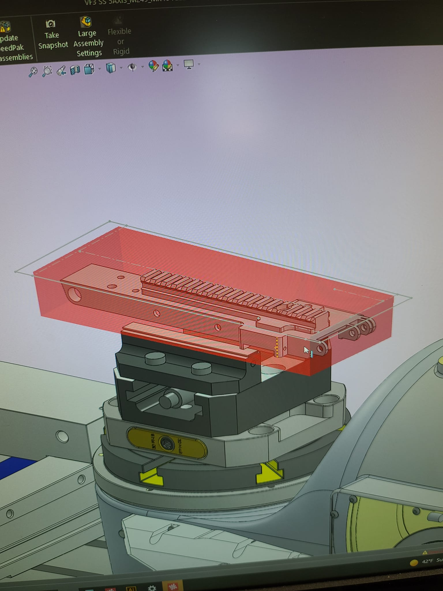

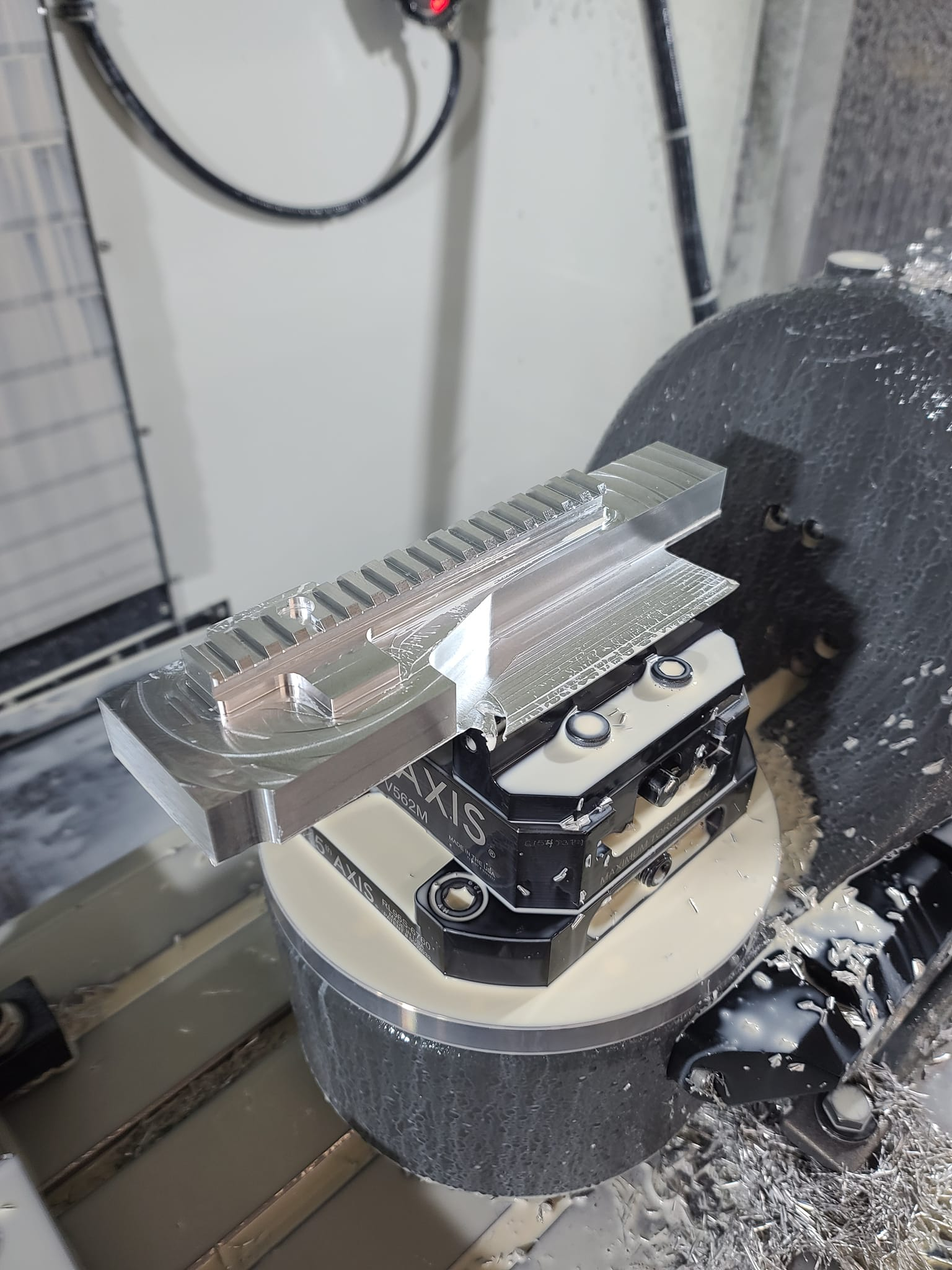

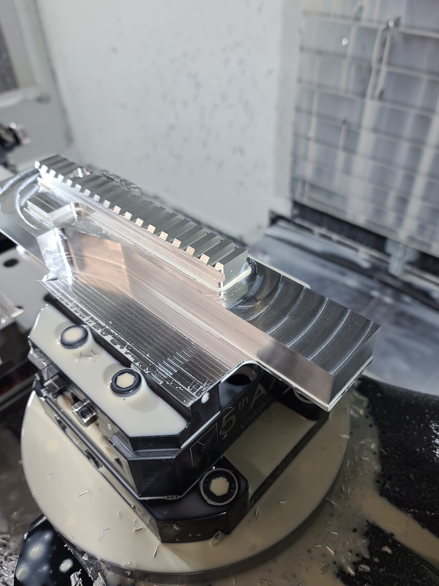

    Op2 in the puter. I ended up flipping the part 180* as it offered better access to certain features.

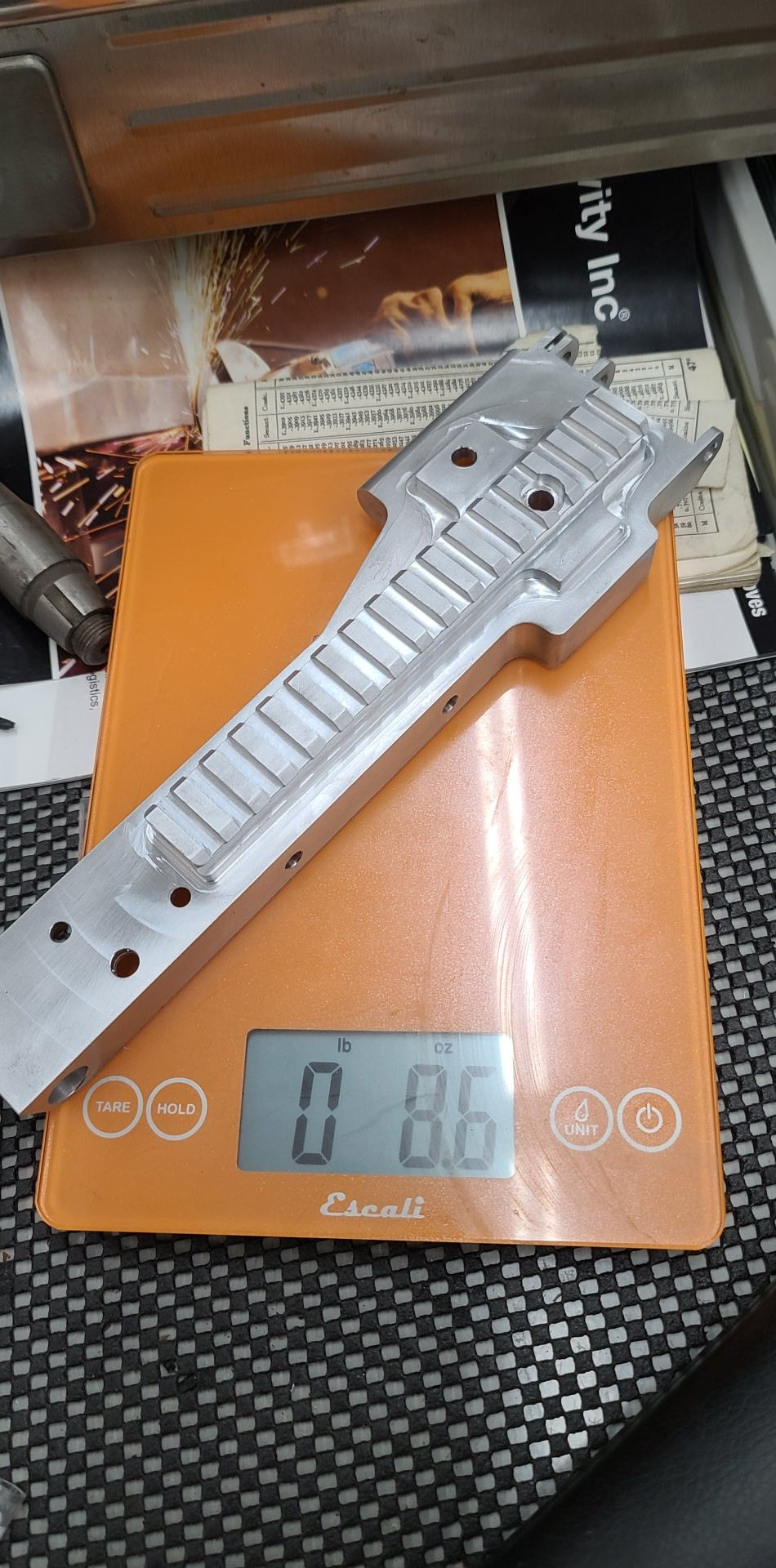

    35 minutes later: 6lbs whittled down to 8oz and change.

    They've always been AL near as I can tell. Most have so much rattle can paint stuck to them that it's hard to tell.
    As for how they run... (bolts, carriers, extractors...)
    The learning curve has been interesting to say the least. As I have mentioned, I don't get prints or models with this stuff. A part shows up, and the party starts from there. Once I have the first article and send it off to the client, the phone begins to ring.
    "Hey, it's missing this chamfer. . ." - "The part you sent me doesn't have it."
    From there, we take a forensic look at the entire inventory and realize they are all basically "cousins." -probably the kissing kind. Lol. -just different enough to make things interesting. It largely boils down to who was making what at a given time.
    A lot of contract stuff works like this, unfortunately. Things evolve, and when they migrate to the next low bidder, the tribal knowledge and natural evolution get stopped dead in its tracks. What it's done is start to provide me with a comprehensive view of this system's natural migration/evolution. We're now attempting to take the best features from the legacy items and consolidate them. It's a big job but very rewarding as it forces me to nitpick at the documentation on my end. Tool selection, material conditions, and ensuring that what I'm making actually follows the original intent and doesn't end up as something with my "spin" on it.
