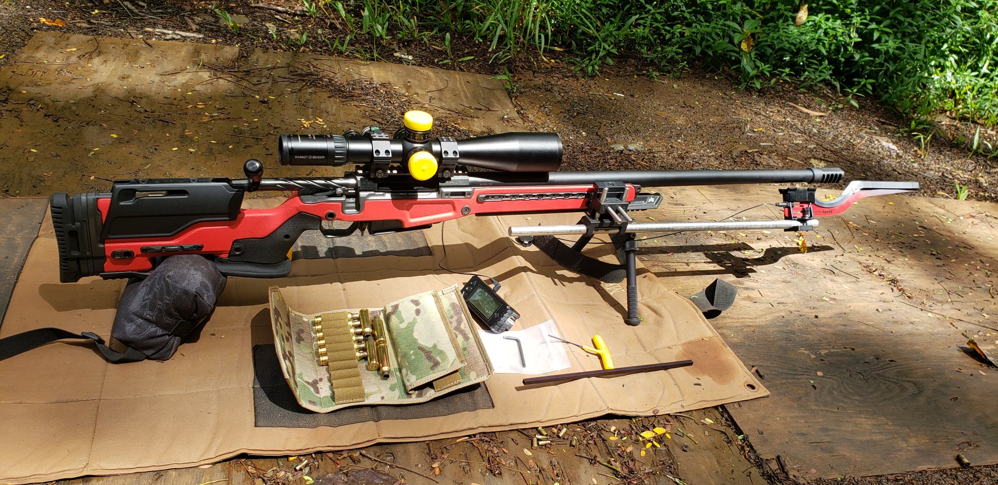

Hi everyone,
We have our first batch of these almost entirely shipped to customers, just a few left to go. Wanted to post a few pics all mounted up to show the versatility.
Will mount to a picatinny or arca rail, can be ordered with no rod, or 12", 24" lengths. Uses standard 5/8" rod, although our stainless we ship with are probably prettier than what you'll find most places.
It's totally rigid enough to be used with barrels well over 30", suppressors, etc.
Why would you ever want this over a Labradar? For my personal use, I've got a range to 1200 yards but the targets are scattered around the edges of a field. I can track every single shot without having to reaim a chronograph, no point of impact shift, etc. Very handy to know if your ammo was why you just dropped a shot low or sent it high.

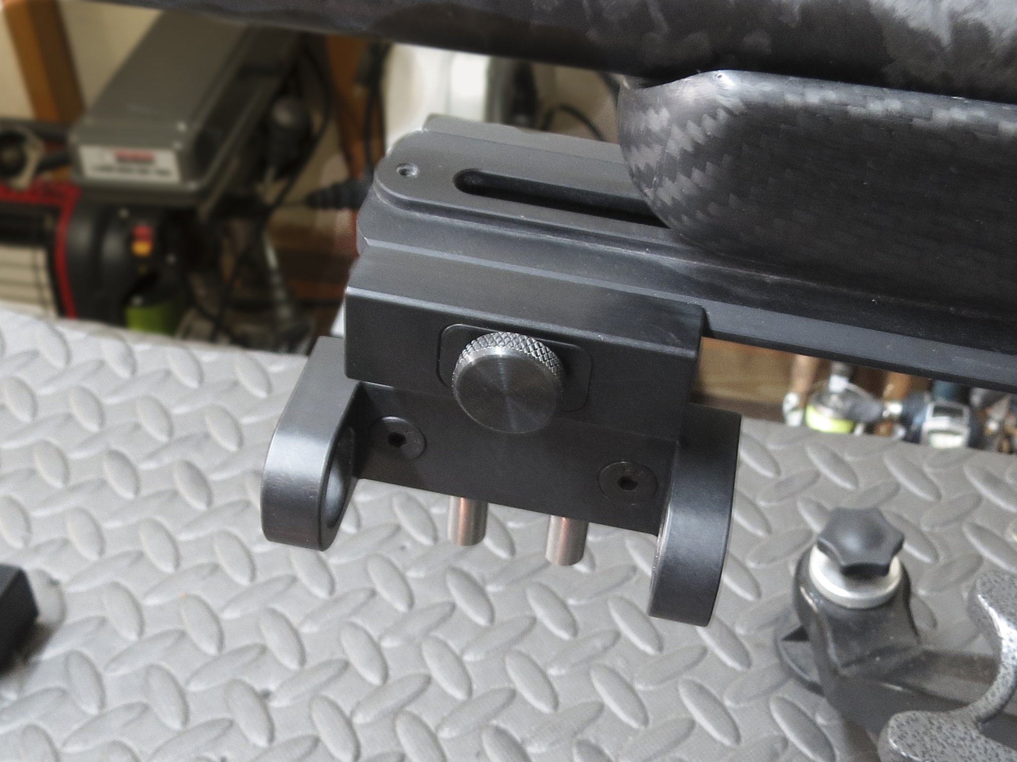

Any suggestions or plans for a thumb wheel for the pic/arca clamp?
That’s the only little nit pick I could find. Needing an Allen key to clamp it on rifle.
Not a big deal. Just a small luxury that would be nice
Maybe as an additional add-on. I've worked super hard to get this to a sell cost in the $150 region, and margins aren't very high. Adding a nice tool-free knob would cost much more than a $.20 bolt.

What is the thread pattern and the bore diam for the head of the hex screw?

Doesn't have a hub but might work to just clamp on the part that moves. It might need a bushing to fit into the head diameter recess. Something like the link below but it could be made custom. It would work well as it should also work kind of like a bushing to help reduce the torque to tighten or loosen.
Damn multi-dollar screws are why it is expensive to put them on there. Especially if we offered them on all the hardware.
Wouldn't be hard to just turn one in house...
See attached. You wouldn't have to make them press fit if you just put some loctite retaining compound on it also.
Just use a .5" longer socket head cap screw which is negligibly more expensive.

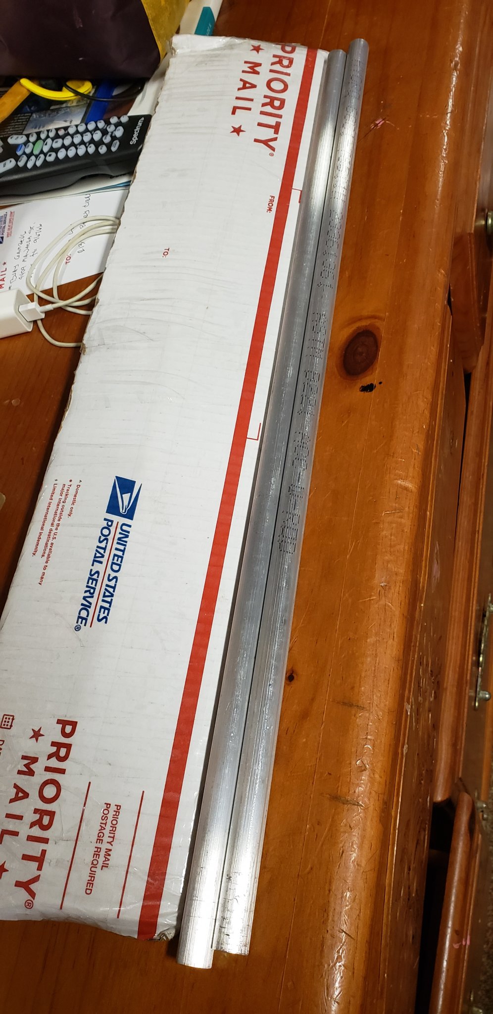

Ordered 24" 6061 aluminum rod..only reason why i might try them coz im from salty wind hawaii :)
Everything rust really fast here..little lighter but not much
Reactions: phlegethon
Bjay
From the looks of your package we must have ordered from the same guy on Ebay :)
I got 2lbs 2ozs on the steel rod and 11ozs on the aluminum rod.
Let me know your results. We could make them from aluminum. I've thought about doing threaded rods if the cost works out, put two 12" together for 23" rod, much easier to ship
