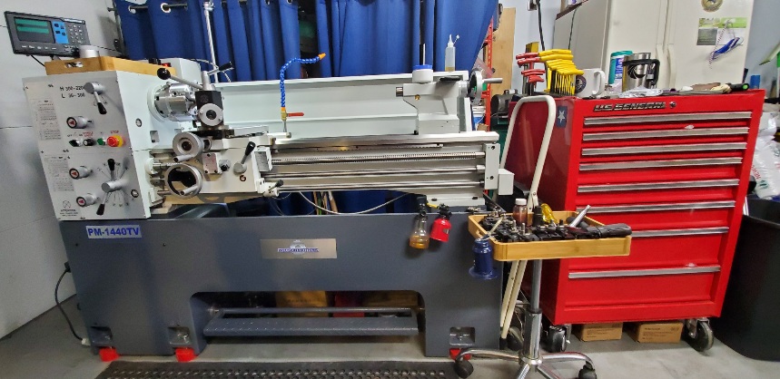

That's what I bought PM1440GT with DRO and I'm very happy with it . My first lathe was an old beat up Sheldon that got me started .

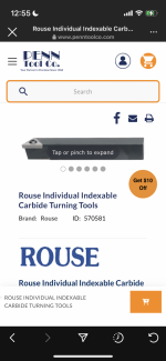

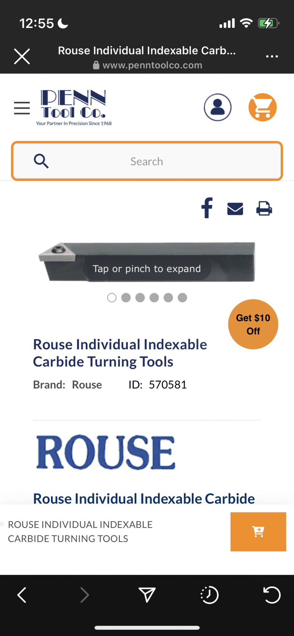

Alright fellas I purchased a lathe who sells high quality tooling I’m tired of the cheap Amazon junk I’ve been using are their brands to look for or any brands/sellers to avoid
Sorry about that atrocity of a run on sentence, I was sidetracked.
Looking at these

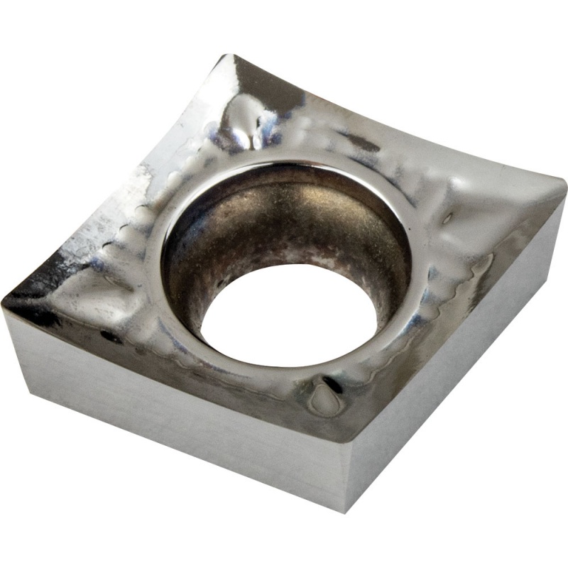

Compared to traditional carbide, I agree. But have you tried the polished carbide inserts for aluminum with the ground sharp edges? They provide a finish every bit as good as a well sharpened HSS tool, but without wear or the sharpening time. You can find them for most styles of inserts; worth a try if you (or anyone else here) haven't used them. Don't use them for heavy stock removal in steel, they'll chip, but for finish cuts they're great - I'm getting beautiful finishes in O1 tool steel and all types of stainless, if that tells you anything.
Caution is warranted of course - they're sharp like a good HSS tool and will cut you open pretty easy, speaking from experience.
Same goes for the aluminum-only carbide end mills that are available now - they leave amazing finishes, better than I ever got with HSS end mills.
Some of the tooling that has become more commonplace in the last 5-6 years or so is really a step above what we had before. Well worth looking into for those who haven't.
An example of the inserts I'm talking about:

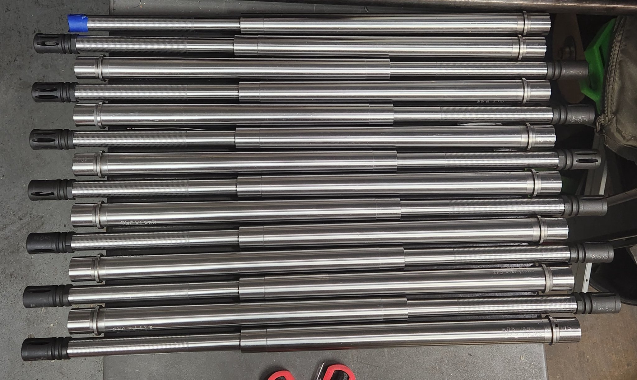

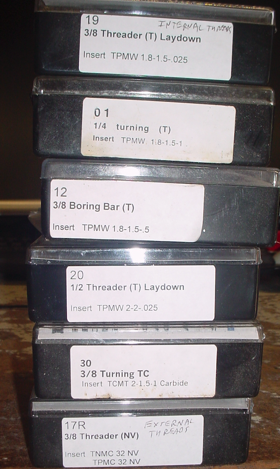

- Just this evening I threaded the OD of a Lee sizing die (making a trim die for the Dillon trimmer); the surface of those dies is case hardened and HSS just doesn't work for that. Trimming the base of a die, or other modifications are all within the realm of possibility for anyone on this forum with a lathe, and the work is easy with carbide but seems nearly impossible with HSS.
Those are just a few examples why carbide tooling is the way to go these days. I already pointed out the type of inserts above that will give the same or better results as HSS for finish cuts too, and any carbide insert can be resharpened with a cheap handheld diamond sharpening "stone".
Your concerns about breaking the tip of a carbide insert are overblown. It happens even to experienced machinists sometimes - but so what? We're talking about an insert that costs $2-$5 usually, and you just damaged one of the 3 or 4 tips on that insert. So flip it around and get back to cutting - it's not a big deal and the "frustration and expense" you claim is far less than the effort of constantly resharpening HSS tooling.
I really don't care if some old school machinist wants to continue using HSS tools; it makes no difference to me. But I hope this info above is helpful to the new guys trying to figure out tooling for their lathe or mill.
Spot on, brother. I never bothered to learn how to grind HSS bits. Instead I invested my time in learning how to run the machines using carbide inserts.
I use carbide trigon WNMG inserts for roughing. It has 6 cutting edges. Just recently I finished these AR15 barrels for the TX Juniors from unturned blanks donated by Shilen. Still on the same insert.
For finishing I use carbide VCGTs, CCGTs or the DCGTs.
For crowning with whatever form, straight, recessed, chamfered or not, I use the VCGTs 220.5.
For threading I use laydown inserts, 16ER AG60s On my 1440ev I thread with the compound at 34 rpms. On the 1236 VFD driven I thread at 300 rpms using left hand holders and 16IR AG60 bits running reverse. If I thread with a thread relief I use old 1024 with VFD. I can run at whatever speed I want, the proximity sensor will stop the carriage plunging in with the cross slide. I mostly use this on AR15 barrels using the original M16 barrel extension where a thread relief is needed. Plunging straight is because I have the compound set semi pemanently at the same taper as the 223 reamer for drill/bore/ream method.
All inserts are the ones cut polished, uncoated for aluminum. They are all indeed razor sharp.
Three benchrest gunsmiths, and a tool and die maker mentored me, I have no formal training on running the machines. I don't claim to be a machinist, nor a gunsmith, just a hobbyist enjoying my retirement helping the juniors, some friends, and my brother. I've done 7 benchrest barrels for my brother.
Most of our service rifle barrels we use the competition barrel extensions that are 0.300 longer and have 20 TPI thread as opposed to the M16 16 TPI.

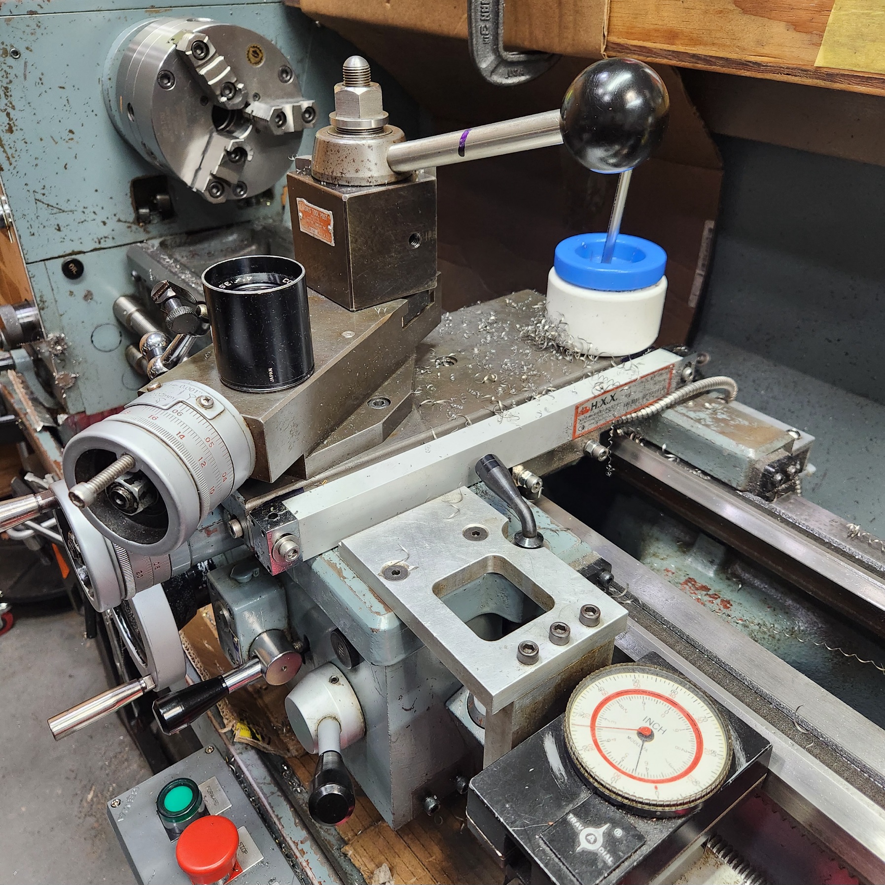

I've been meaning to try those WNMG inserts. Probably should go ahead and just order a holder and pack of inserts; they're cheap enough. I actually still use those TT style inserts for most of my heavy turning/roughing, and any hard turning for things like steel sizing dies, etc. They're old tech, but work pretty well and can give decent finishes even on a low speed older lathe.
+1 on those *CGT style inserts for finishing, like my pic above. Love those things. I think I use that same laydown threading insert # too, but it's been long enough since I ordered it that I've forgotten.

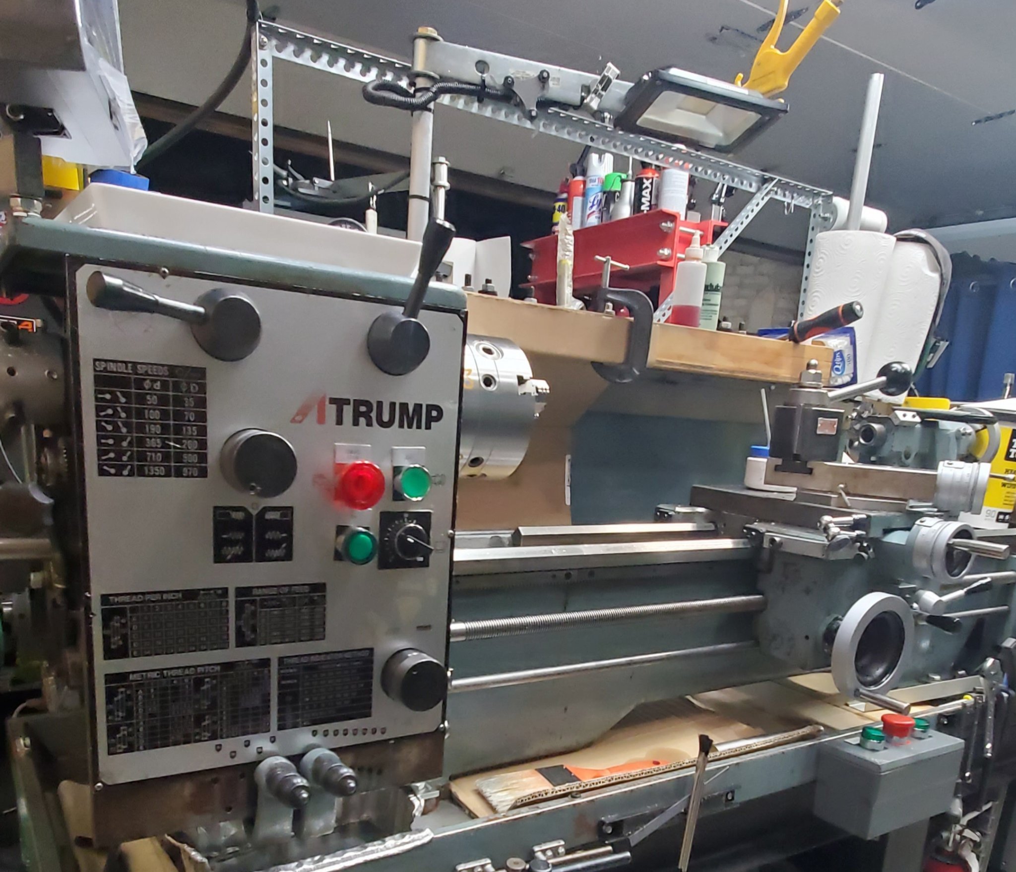

Do you really thread at 34 rpm, or is that a typo? I'm not knocking it if it works, just curious since it's so slow. Most of my threading up to a shoulder with 24 or 28 tpi threads I do at 300 rpm, or at 800-1200 if there's a lot of room after the thread. For coarse threads I stick to 300 though; that carriage gets moving pretty fast at 800 with something like a 13 tpi thread, lol.

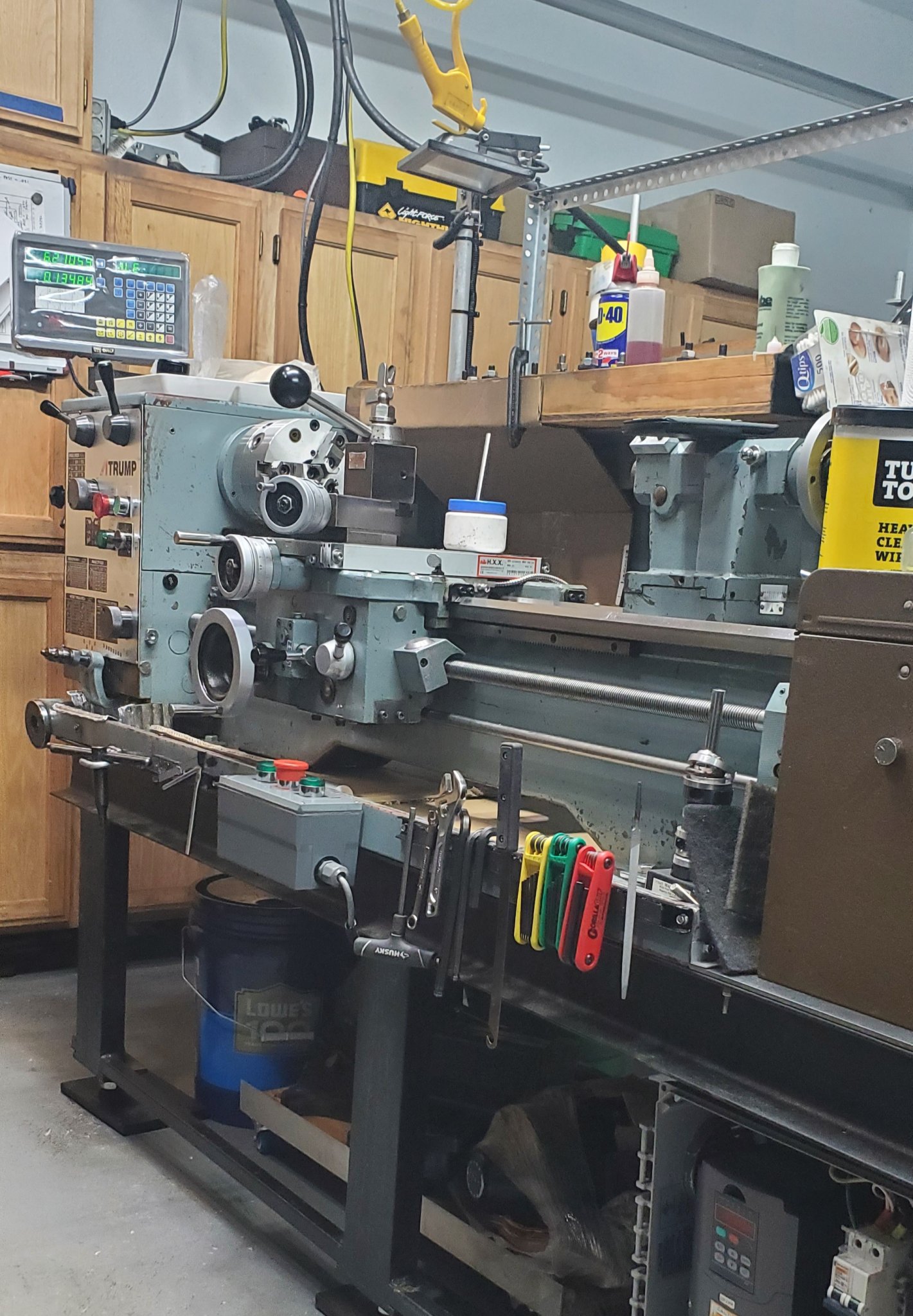

Wish I had a VFD setup like that. It's on my list, just need one of those "round tooits".
That's the lowest the VFD runs it, 34 rpms. Finish is real nice with carbide for aluminum laydown inserts.
I could run faster, there is really no need with the made for aluminum inserts.

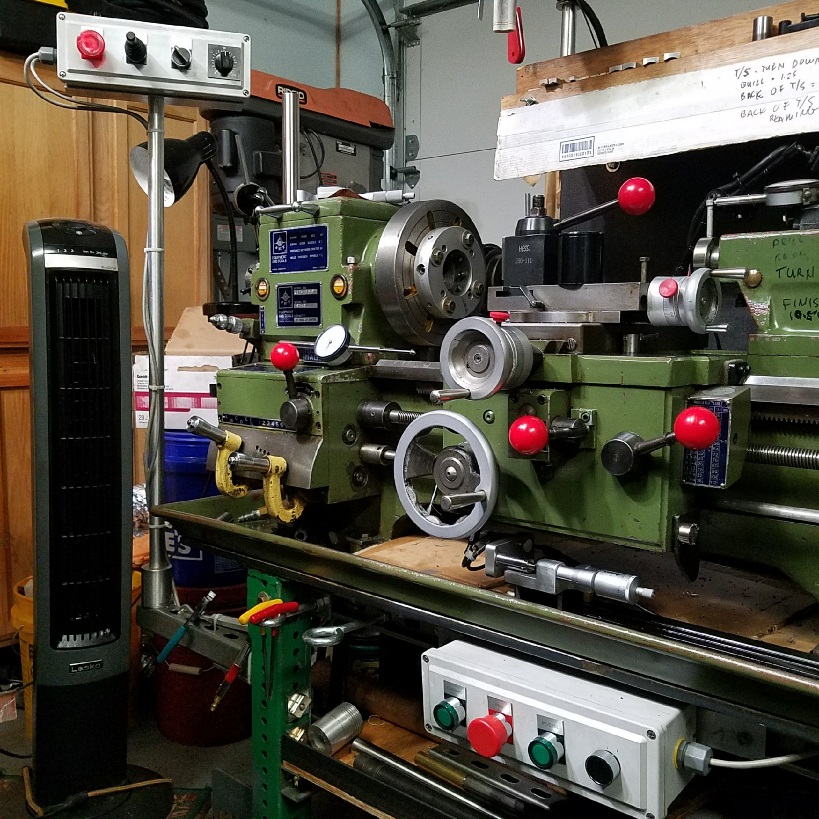

Have VFD on all 3 lathes I use for barrel works. The 1440ev came with a factory installed 7HP VFD feeding the 5HP motor. The 1236 and 1024 VFDs run 2HP motors. All lathes are Taiwanese made.
The DRO on the 1236 died after a year, re-installed the TravADial
