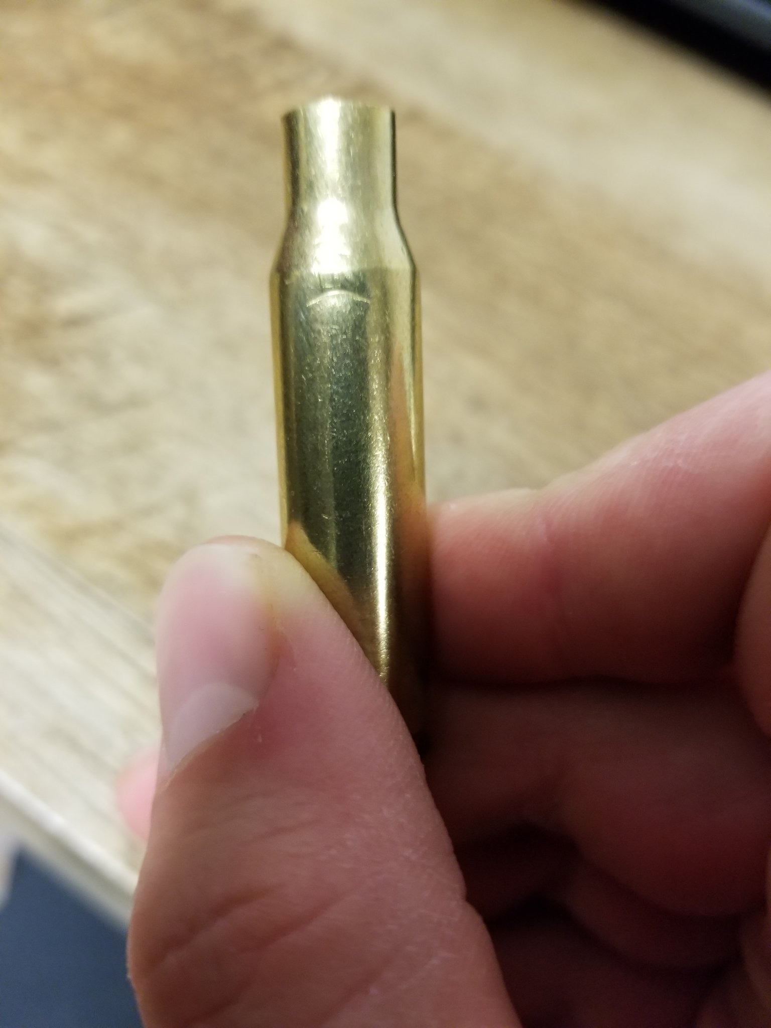

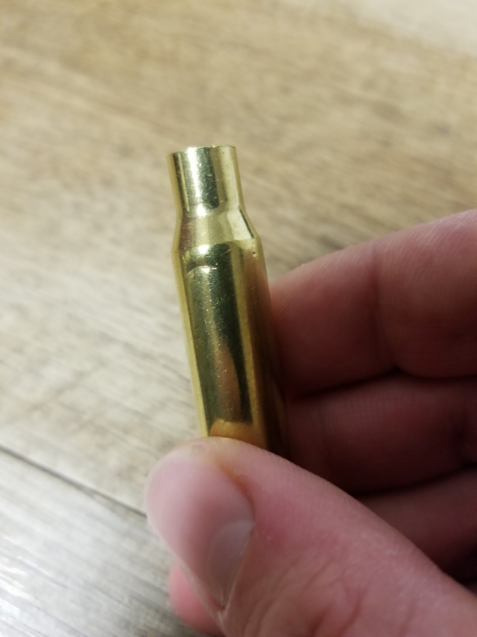

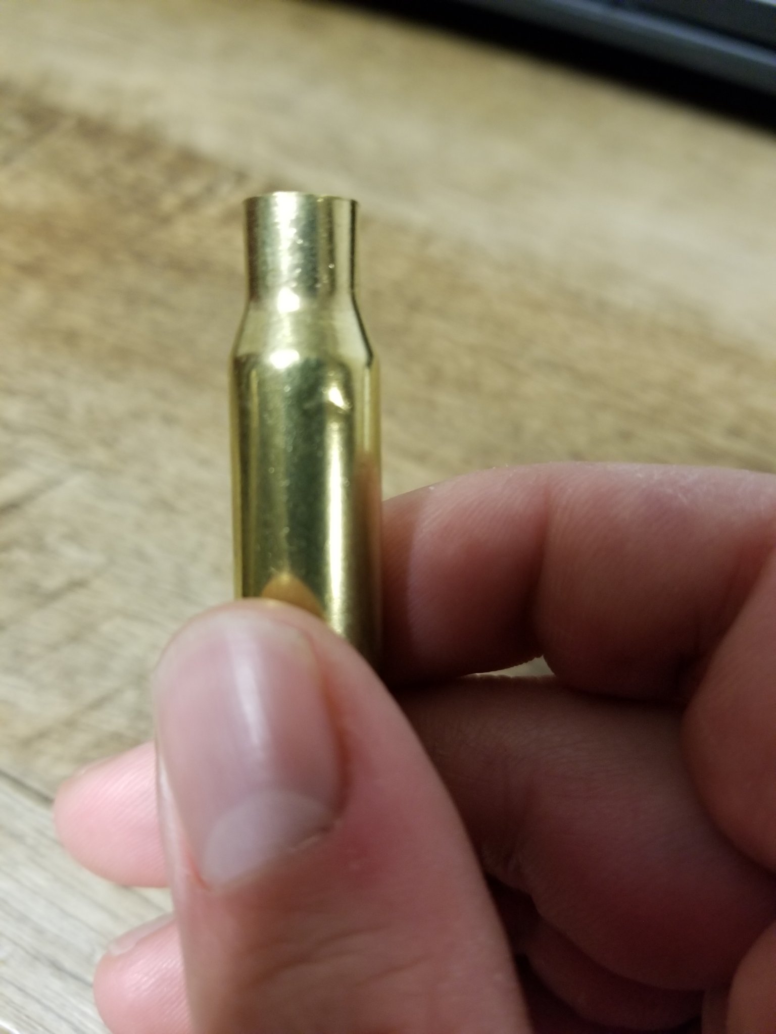

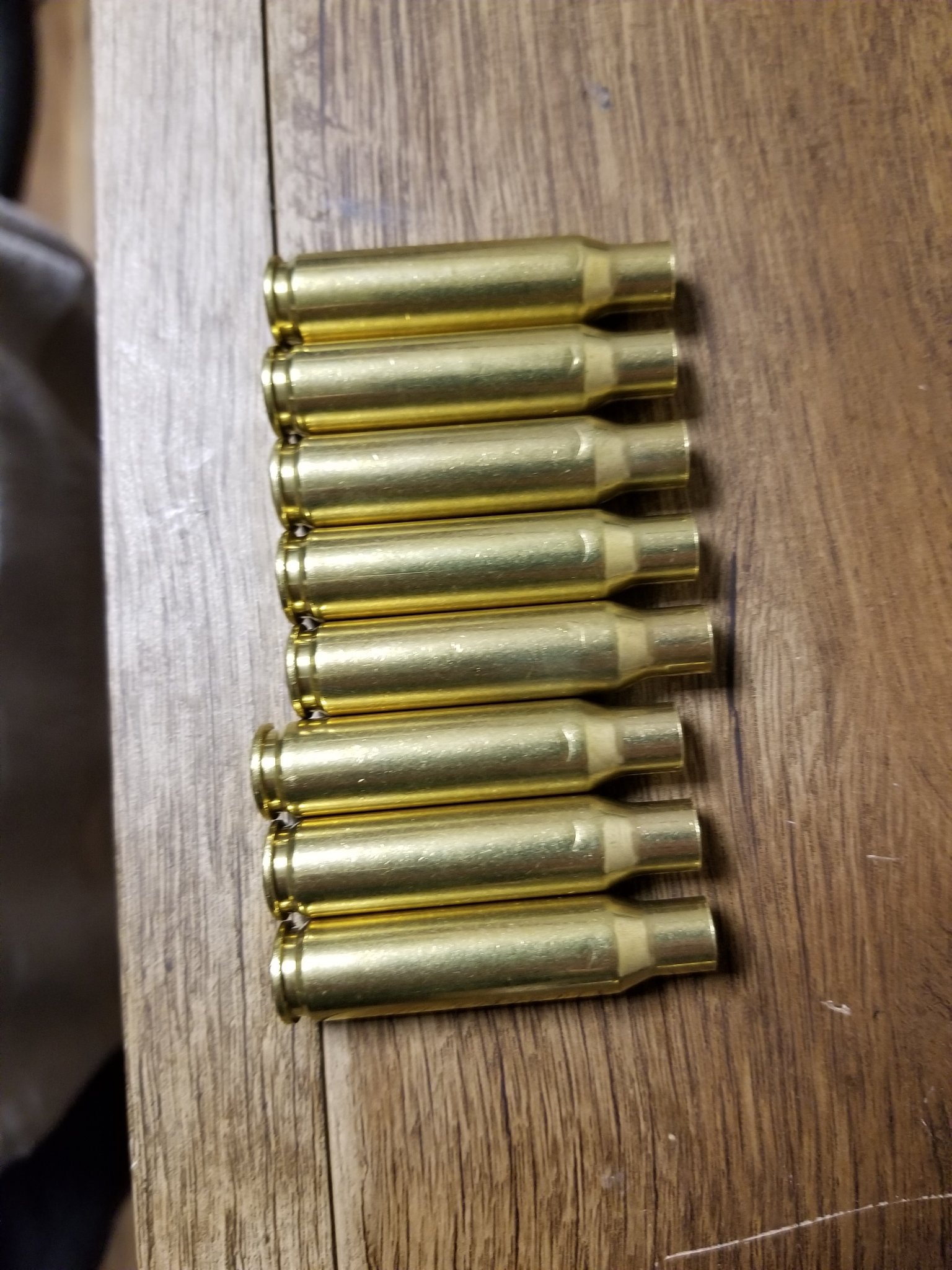

Just picked up a couple hundred pieces of LC brass and I'm wondering if the denting/creasing in the pictures is normal? Guessing they'll push right out on first firing. Just want to be sure isn't something to worry about before I start loading them.

With rounded corners it will push out just fine, its when they are sharp and angular that they can crack there instead of gently bending back to form.
