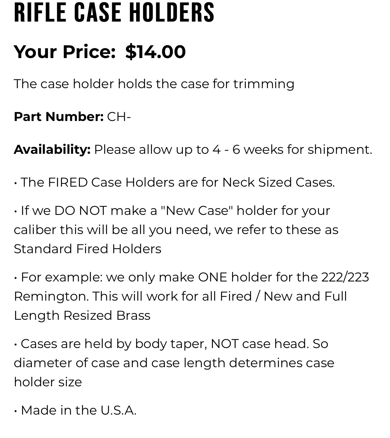

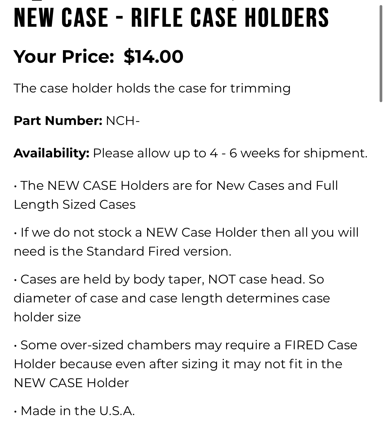

Here is the correct way to use them, straight from LE Wilson:
Fired = Neck sized brass (unless they do not have a NEW version of your cartridge, like 223)
New = New and FL sized brass

As I asked above, are you giving the case a good tap on a hard surface or just trying to put it on with your hands only? It does require a little bit of force. Sinclair actually makes a platform that works well for the Wilson trimmer with a place to do this: https://www.brownells.com/reloading...rimmer-platform-sku749003706-34717-67408.aspx

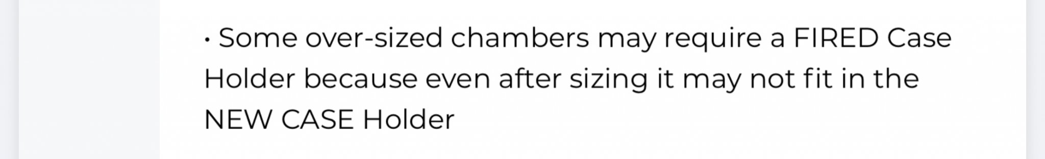

That last paragraph literally describes your situation, OP.

That last paragraph literally describes your situation, OP.View attachment 7678534

Good catch, I completely looked past that. That should help then if he is indeed already tapping, etc. I guess some measurements would also be useful to see if his chamber appears large for that cartridge.
