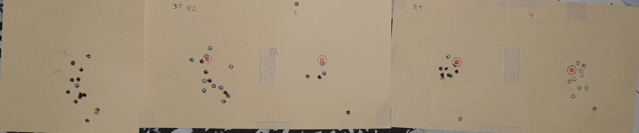

To get accuracy out of that 22LR I would recommend cleaning the barrel (soaking it with Bore Tech Rimfire Blend) and trying different stock screw torque values. Start from low torque (barely keeps the action tight) and shoot 10 round groups with ammo from makers below, always tightening both screws just a bit, around 1/6 of turn if you do not have torque tools. After you have found the best torque, and you will, test few lots of different ammo, namely SK Pistol Match Special, Long Range, Rifle Match, Standard Plus. From Lapua Center-X and Pistol King and from Eley just Match. 50 rounds well spent make enough for a proper test.
Grab whatever you can, and try if any lot you got makes good groups. If it winds do at 50, if it is windless 100 is good too.
While testing the 50 rounds, use 6 targets. 1 background target that is kept at the same place while all other targets are placed on top of that.
Shoot 10 round groups and try to spot anomalies. Like every few round landing somewhere off-target.
Here is an example from my testing, sorry for huge pic I cannot edit it here on cellphone.
I combine my groups with software so I do not use a background target.
Try to spot fliers and rate targets for extreme spread, but also look at how round the group is. Do not forget practical side, for training purposes an ammo that makes close 1moa groups with occasional fliers might still be very valuable, as long as you call the fliers accordingly.
22LR is very good for training optics use, both turrets and reticle. I suggest drawing targets around the target that you have to hit by using turrets, keeping aim only at the center all the time.

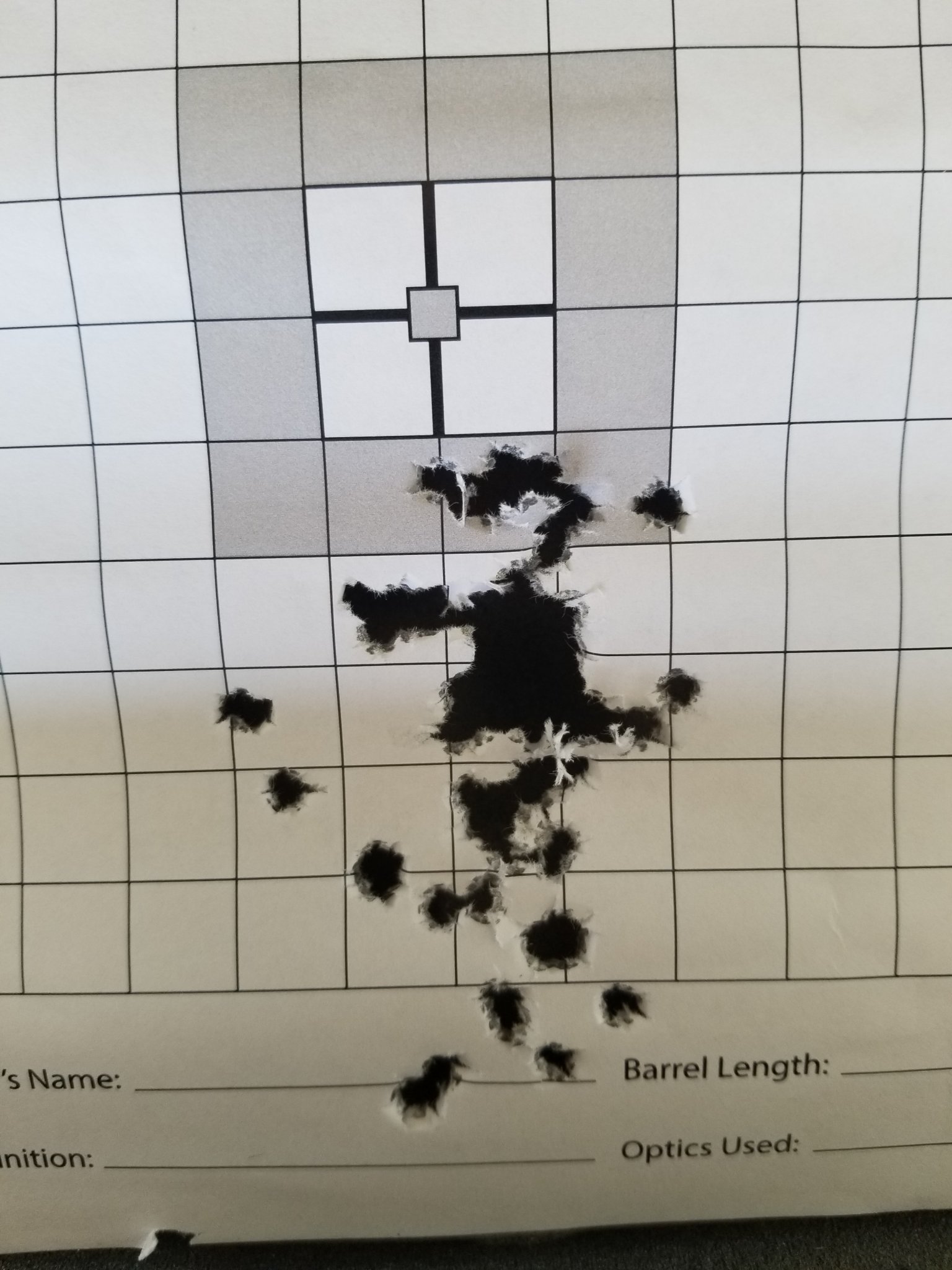

100 yards with a .22 is farther than the majority of gun owners ever attempt.
With a good rifle and match ammo you should be able to turn a decent group at 50yards.
At 100yards variations in velocity even with match ammo will cause vertical stringing. Try to group them as best you can left to right and dont get to wrapped up about the vertical.
There is a thread here called the "whole box" or something like that. I tried it with a chronograph using SK match in my "custom" 10/22, an 80fps difference made a shot drop off the paper.(Photo below.) Using a 36x bench rest scope, my POI (point of impact) was set to be 2" below the POA (point of aim).
Eventually your rifle and ammo will be your limiting factor.
As mentioned above, become a site supporter and watch the videos on the fundementals to start with.

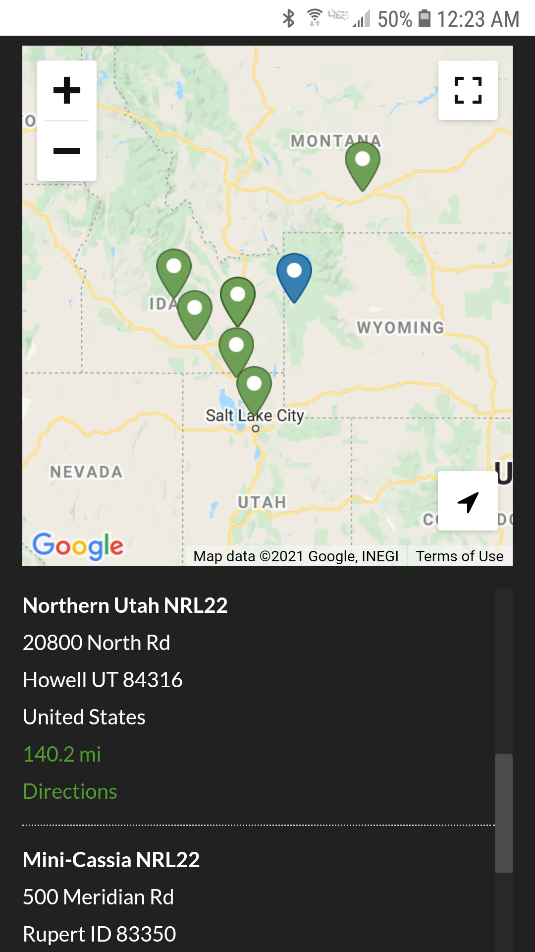

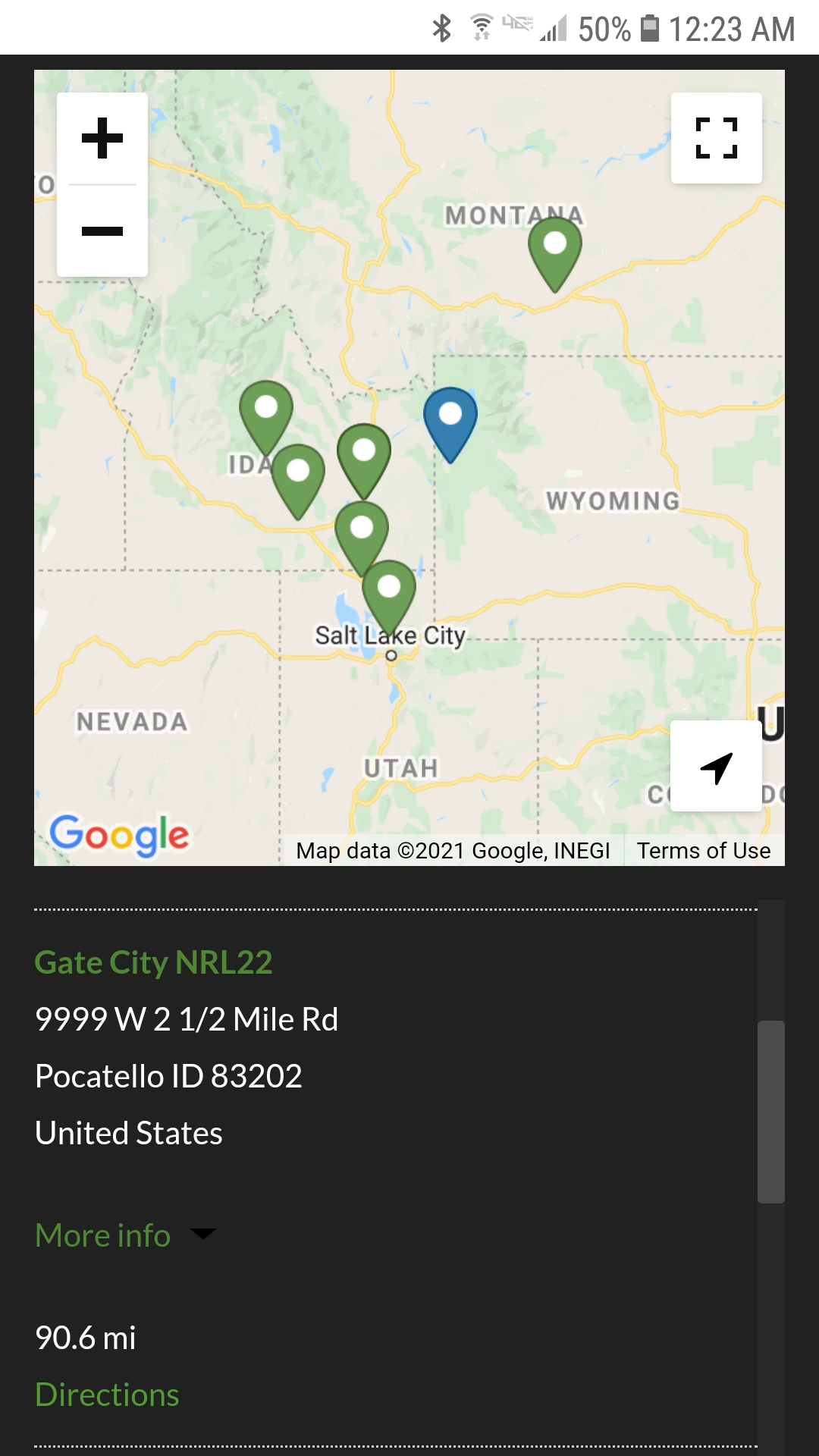

Looks like they have a match in June:
Perhaps contact the club/range and inquire about practice or smaller events.
Website https://www.facebook.com/groups/1188467724661756 Email [email protected] Phone 2088811975 Address
Oregon Trail Range
9999 West 2 1/2 Mile Road
Pocatello ID 83202

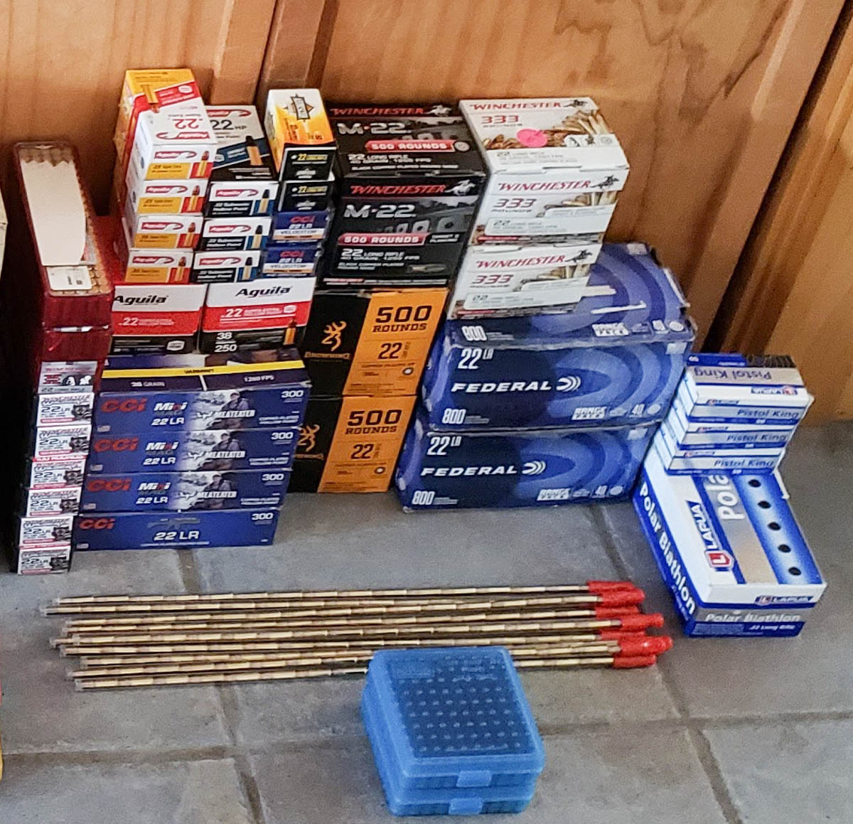

That is one of the things I have been struggling with is ammo availability let alone consistency. My local gun store has had ammo in once in the last 6 months. I have been driving 2 hours to the nearest city to try to get ammo and also mail ordering at a huge premium. My last trip to the big city was a huge score, and along with two mail orders arriving, I now have a better selection of ammo to choose from.
I now have more ammo than I know what to do with it, I guess i could shoot it. My ammo purchases are so random, in the 7000 rounds of .22, I have 14 different types. I did finally get some Lapua 150 rounds of pistol and 400 rounds of Biathalon. Up till now the only ammo I was able to get in quantity was hollow point, and thinking it was a possible reason my groups out at 100 yards fell apart.
I also have 1600 rounds of federal in a rang pack at 1200 fps. I figure that might allow me to do some practicing and improving before trying out the Lapua. Photo included to show how varied my collection of .22 ammo is.

Ok, I see your ammo stash. Yes, you can probably make progress with the super sonic at 25yds and 1/4 dots with a scope that can parallax down that low. But for 50yds, the subsonic should be more precise due to no transonic zone to encounter.

I'll send you a PM with the contact info for the Pocatello NRL22 matches. They don't do the practiscore stuff but he does send out an email each month before the shoot.
Not sure if its standard with all NRL22 but they also do a Benchrest class. You can shoot the stage off of a solid bench.
Last Friday was well worth the drive, I ended up with 2000 rounds.
