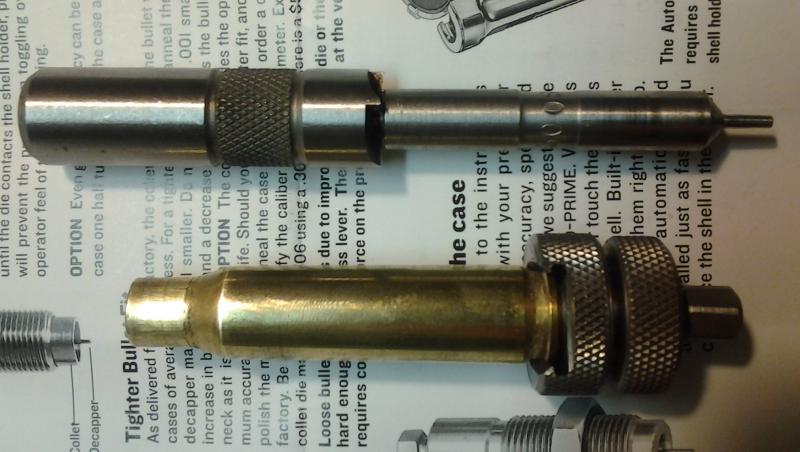

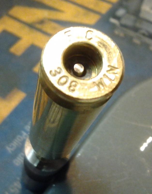

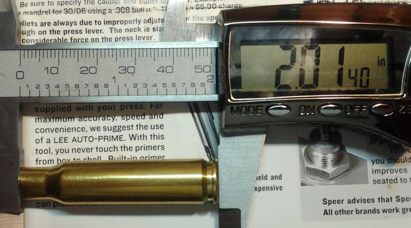

Not sure if I am using this tool right or if my gauge is short but my results have not been what I have expected. I am under the assumption the generally accepted case length for a 308 is around 2.0 (give or take). I took apart a factory FGM round and measured the case length and it came out to 2.014.

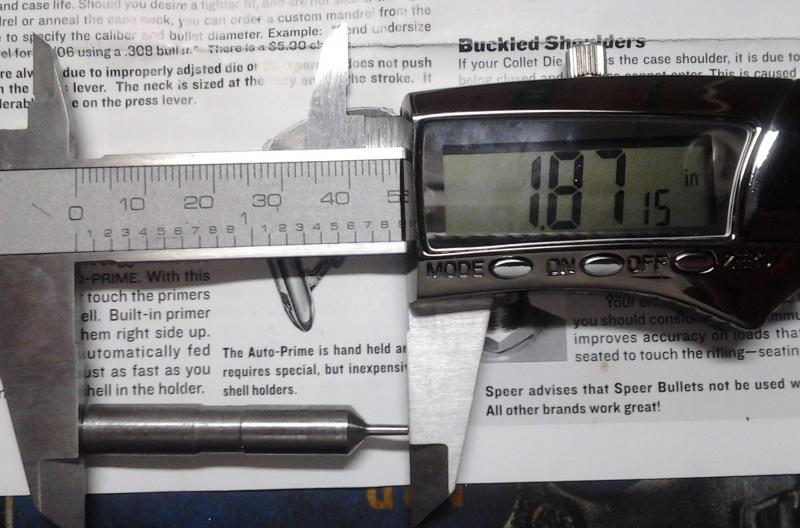

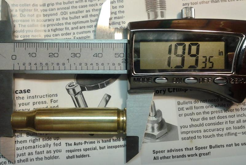

I then took a once fired Fed 308 case ran it through the Full Length Sizing die and it measured 2.017 after being resized. I put the resized case into the Lee shell holder and used my Lee Case Length sizing tool to trim the case to its proper length, and while doing so I felt like too much material was being taken off so I stopped and measure the case. The case measured 1.9935,too short? I then reviewed my Lee reloading book which said the Lee Case length tool is supposed to stop when it bottoms out (as it passes through the flash hole) on the case holder, leaving the case at the proper length. I noted that when I stopped trimming my case the end of the resizing tool was little better that flush with the flash hole and not touching the case holder. It appears to me my gauge is either broken or just short, I measured it at 1.8715. Do any of you use this tool? Could you measure the length of the gauge so I can compare mine?
