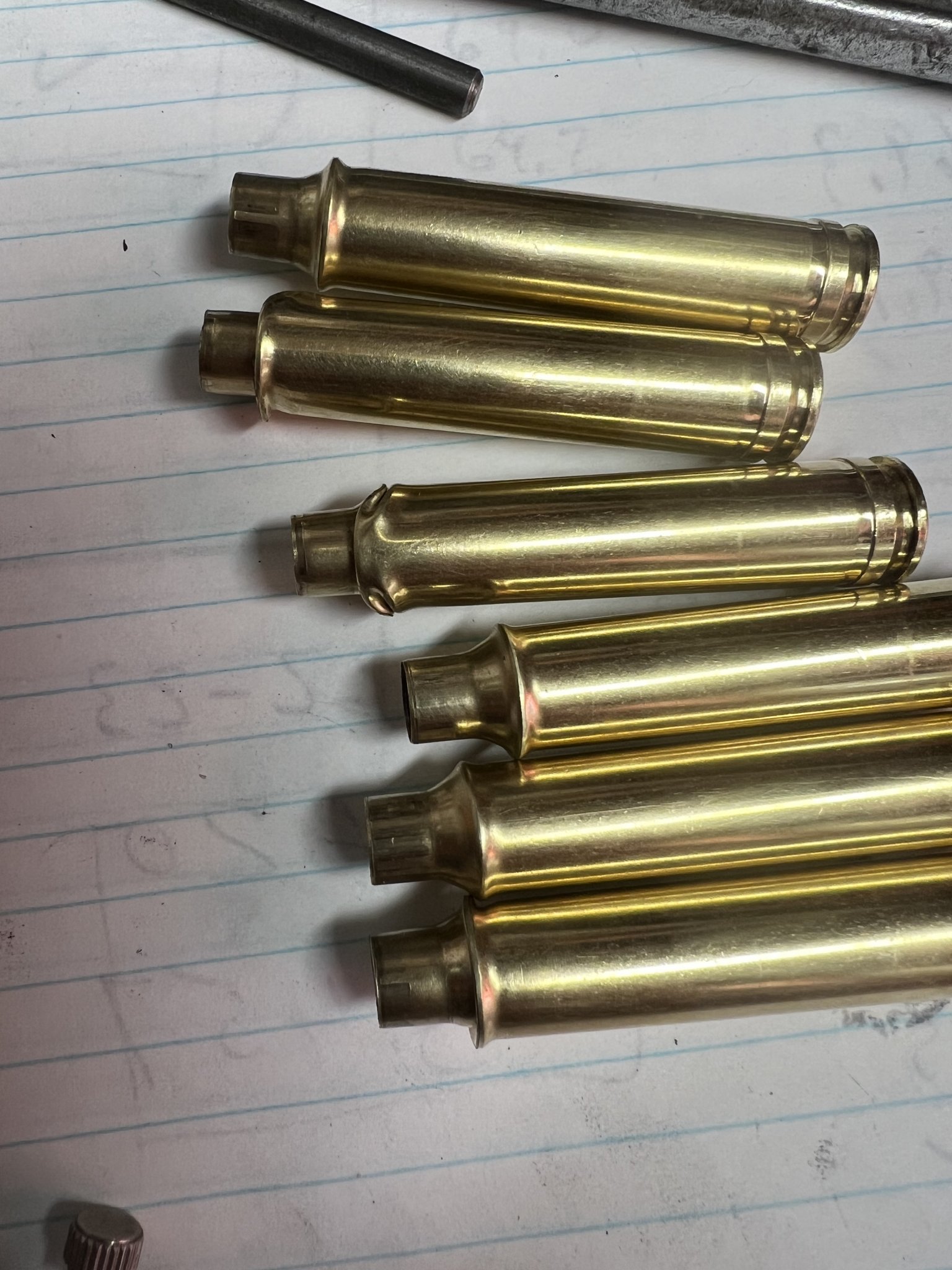

I have an issue with my Lee collet die with the sizer getting stuck inside the die and crushing my 300 win mag cases. Help Mr wizard…

Hay-zues look at the clamp marks on those necks. Screwed in way too far.
Did the handle feel a bit stiff when sizing, or do you do concrete work?
Holy shit, 6 of 'em dude, 1 or 2 wasn't enough to pump the brakes? 😜
Setting up a Lee Collet Die is sort of a "feel thing", screw it in like halfway and test it by slowly running a case up into it while trying to get a feel for how it engages the cases, and then adjust to taste. As you can tell, it doesn't take a whole lot of force to do a whole lot.

Thx everyone for your input... I will try mathman's instructions.... and yes I followed the Lee instructions for my rcbs press. So much for instructions. The die worked great for 15 rounds then you saw what happened after that :-(
OK... after reading mathmans procedures life is good. I am able to get a great tension on the necks without crushing anymore. I can even use the rcbs with cam-over... thx again for all the help.
