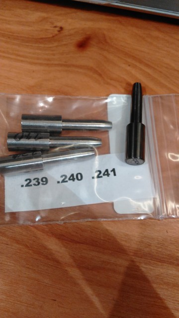

I hear pushing inconsistencies to the outside, brass would have to be red hot for this, you may make a straighter hole?
Here's some mandrels for 6mm, the one outside the sleeve is carbide, it's 65 bucks, most wont pay for this
