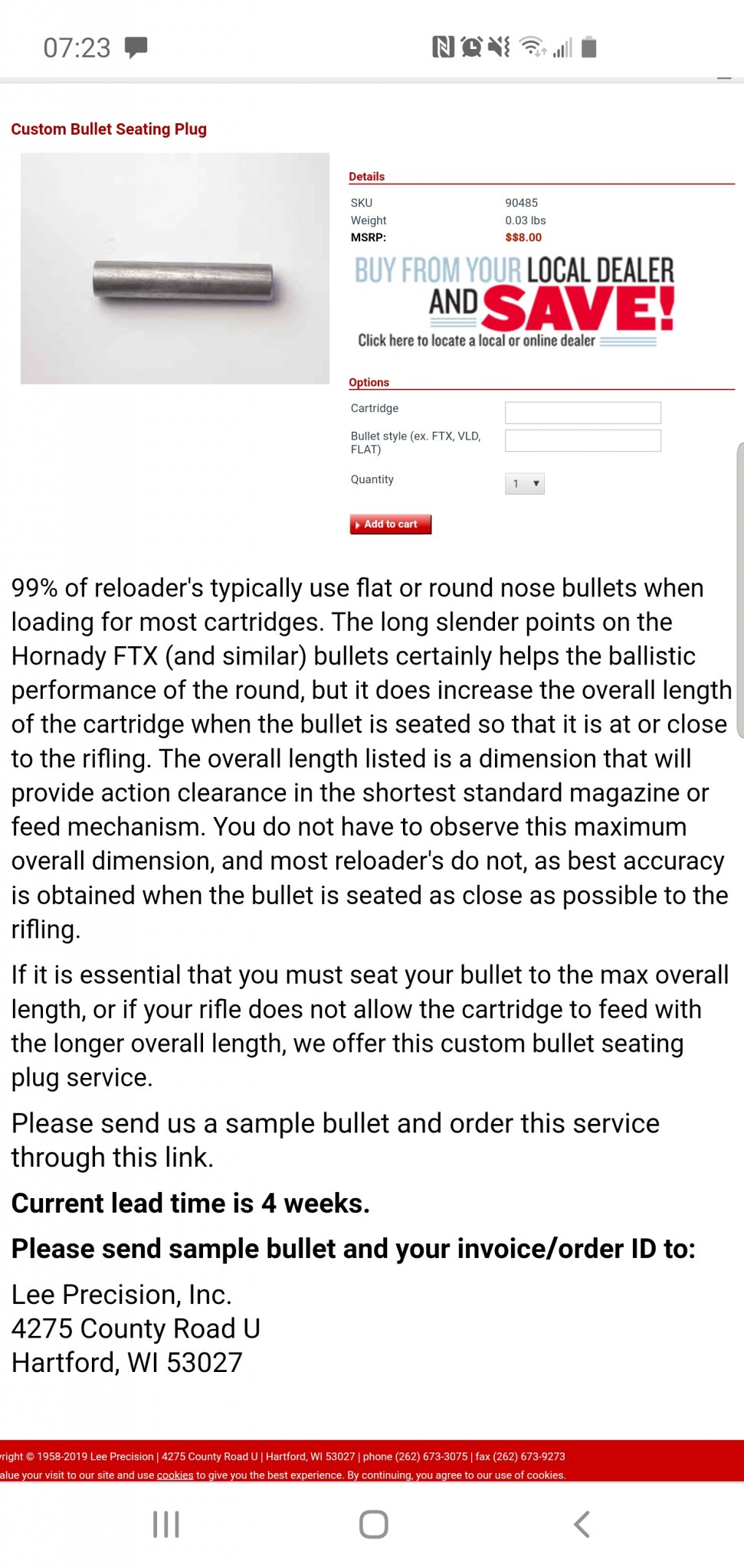

The seater is not good for the longer more slender bullets. Pull the seater apart and check the stem with a bullet, the 147, 122 Leigh high, and 130 hybrid all contacted the meplat in the stem. That’s not good.

Yes, the 6.5 seating stem does leave a ring on VLD bullets. You can actually contact Lee, send them sample bullets, and they'll make custom seating plug for the seating die.......... for $8.
That's what I did for my 147 ELDm, and 130 VLD. I also did custom diameter mandrels for my 7mm RemMag and 6.5 collet dies for different neck tension.
