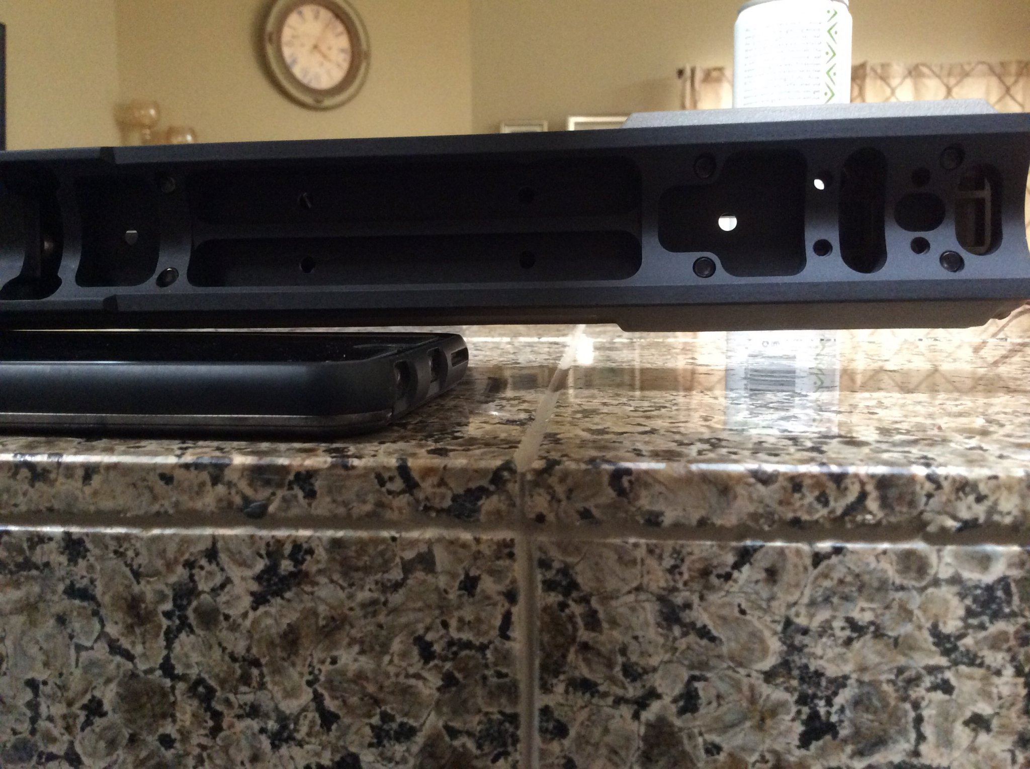

The safety lever and bolt handle slot is milled out on the left side on the Whiskey 3 LH backbone. I use custom actions,so I don't use the bolt release linkage.
All I had to modify was the bolt handle slot on the outer plastic shell on the left side of the Bravo stock.

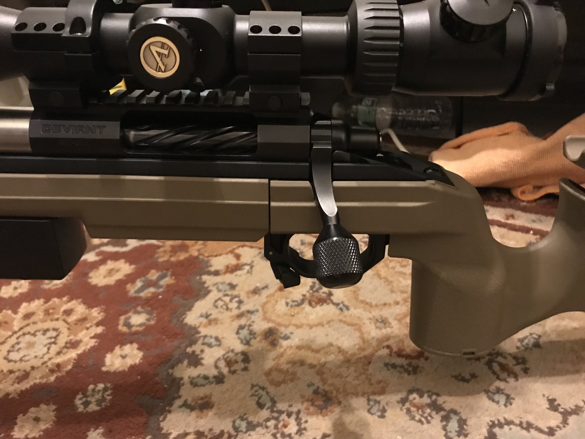

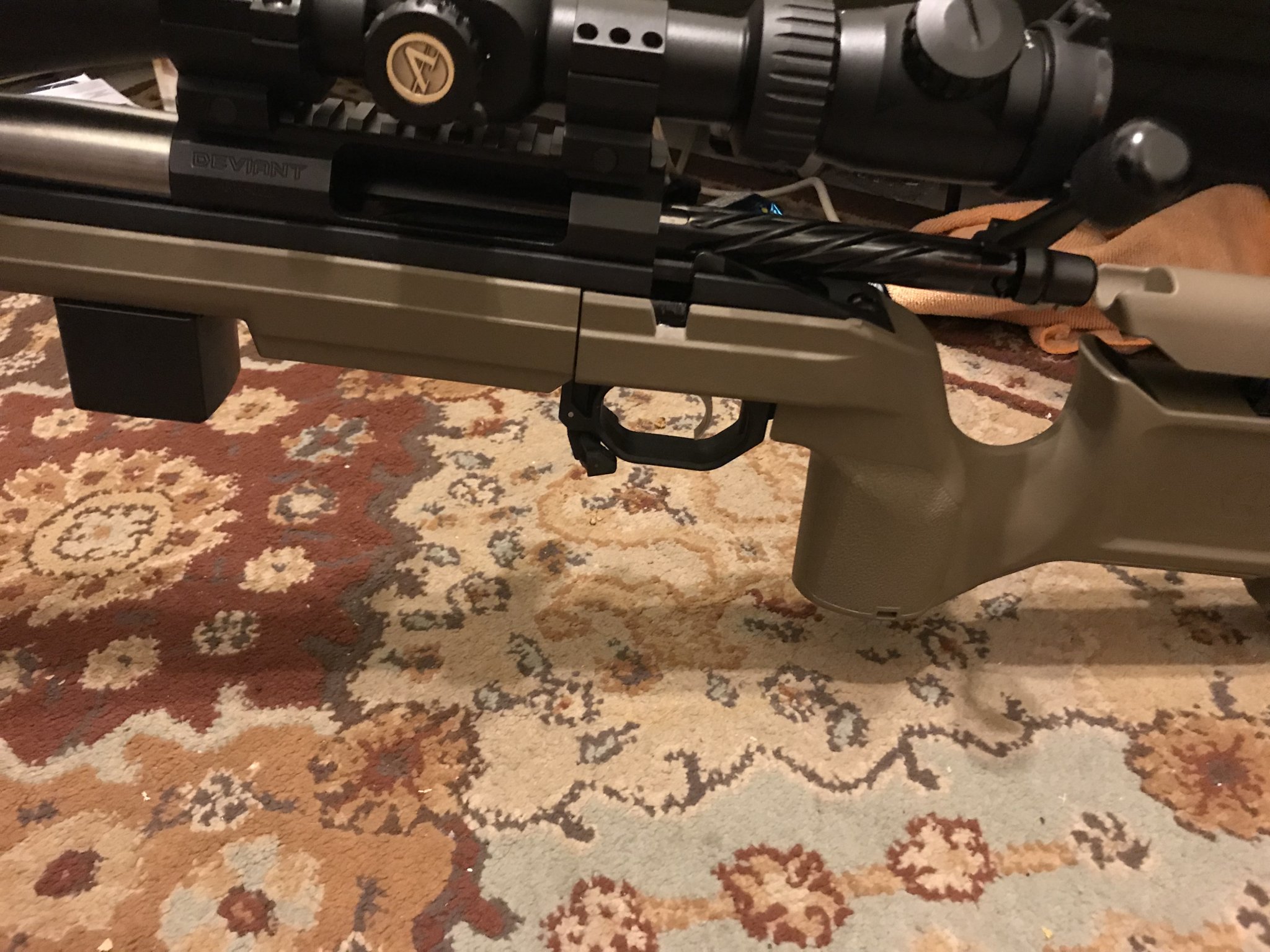

Here's my LH Bravo. I ordered it with the LH Rem SA Whiskey 3 backbone-
Nice work. Thanks for posting, it's a nice option for 700 based actions. No Tikka W3 lefty option though. I may steal this idea for my Nucleus.
I did spend some dry fire time behind this set up and can confirm no issues with the comb height adjustment knob for me in the prone.

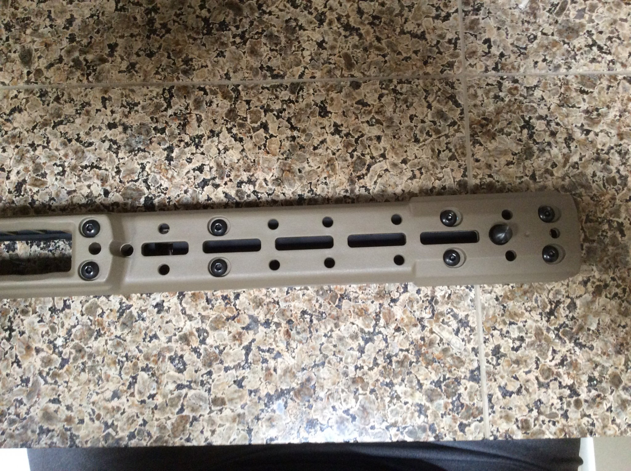

What is the block in front of your mag well?
I
a barricade stop that krg sells for there chassis I put this together to shoot my first prs type match this past weekend but didn’t have a need for it this time so I can’t really give any kind of feedback on it
