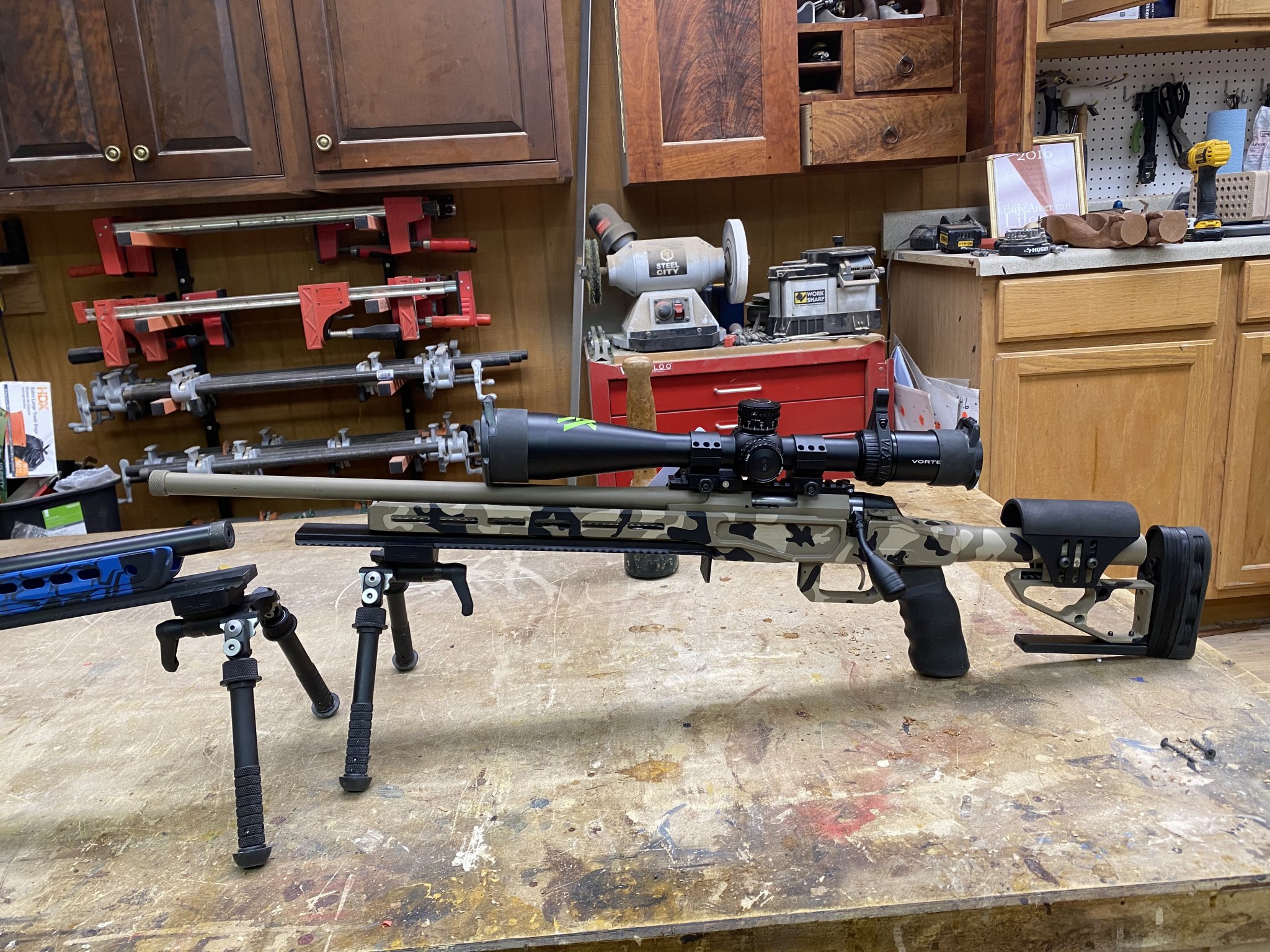

    I took a lefty Tikka T1x in 17hmr and swapped the barrel and extractor then dropped it in an ELR for my son who is a lefty. I needed to work on the extractor wire a little to get it to eject properly but that is about it. You also need to remember that if you order a barrel the cut out for the extractor will be on the opposite side or the feed ramp will need to be ground opposite.
    So really the only complaint for a direct transplant into the XLR is the extractor? I assume that the extractor issue was preexisting before the transplant, so we just need to work on the extractor from the factory.
    The extractor wire was about it. I think it could be that it’s a bent a little different on the 17hmr though. I bent it to match the one in my 22lr and all was good.
    There are several companies making aftermarket barrels for the Tikka. You would just need to call them and let them know its for a lefty.
