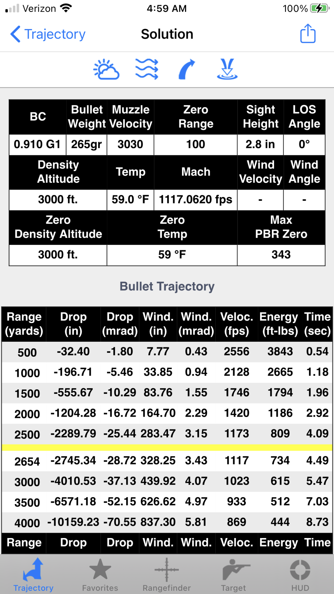

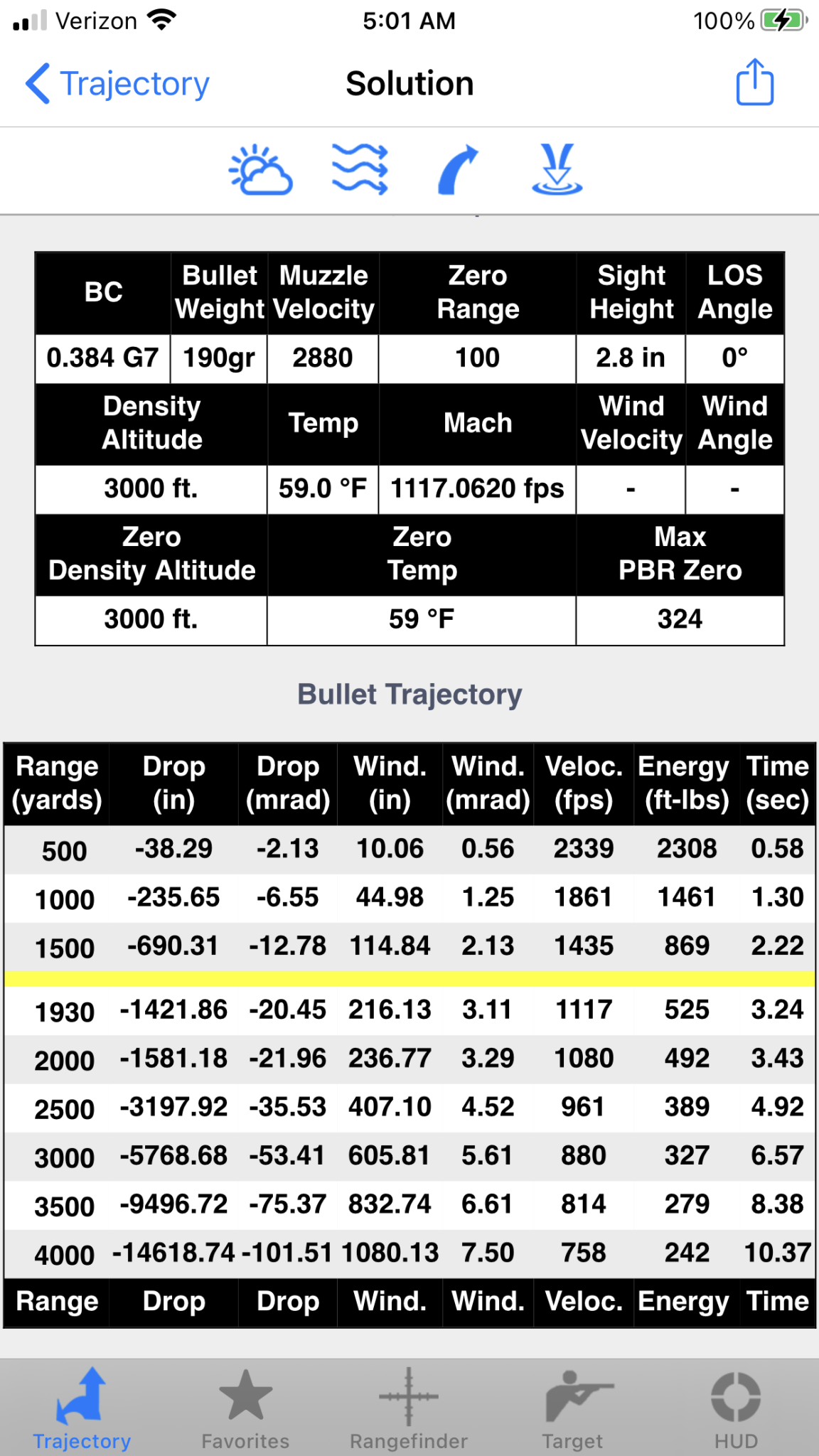

7mm
338
So what that tells you is that shooting that 7mm at 2K is going to require a really wide target or a wind call +/- .5 MPH.
1 MPH of wind moves the bullet right at 22", more than half the width of a 36" target. Supposing you could hold a 1/2 MOA group at that range, which is a tad optimistic, with a .5 MPH wind error about half the group is off the target. More like lotto than deliberation.
