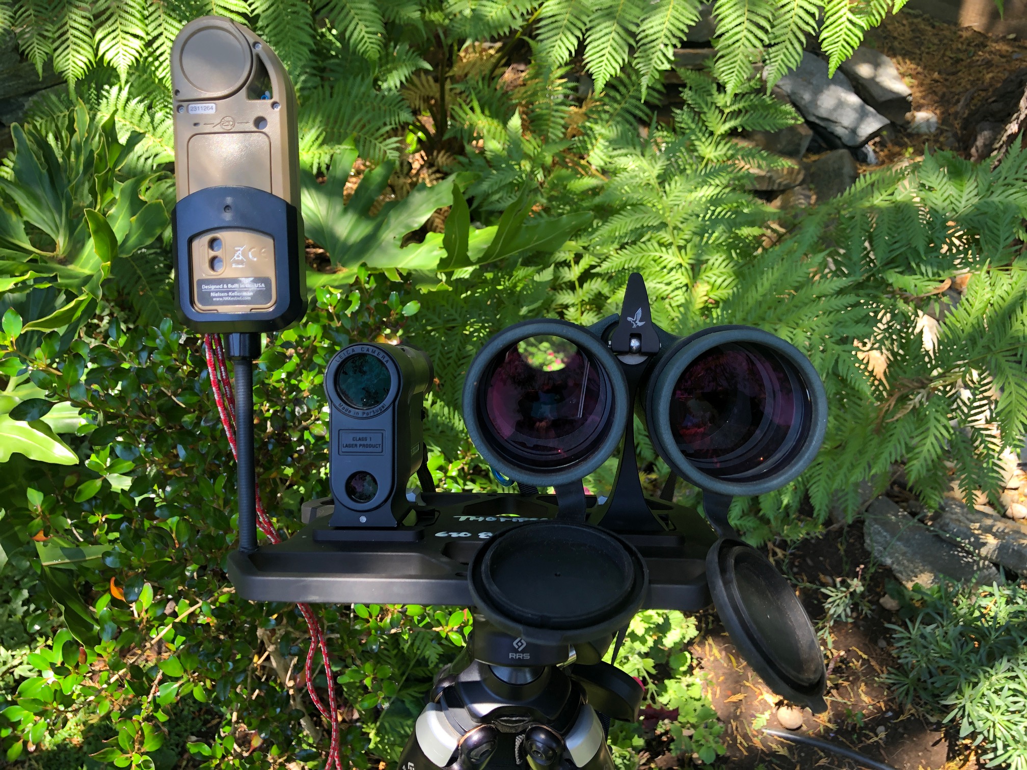

I use an Anvil-30 with a small cheap ballhead stacked on top of it. My binos and LRF ride on top of the ball head on a wide Arca bar/plate, and the ball head rides on a small Arca plate clamped to the Anvil. I can pop the Anvil lever open, take off the ball head, and mount my rifle in a few seconds with that setup.

I added the small ball head only because it was easier to make minute adjustments with the bino/LRF rig using it than the Anvil itself, and the ball head has a dedicated panning function. A wide ARCA bar (like the RRS cinema bar) is going to be lighter and lower profile than the gamer plate, too.

You don't need QR plates on the type of rail I am talking about. My bino mount is attached with a 1/4x20 screw. I could do the same with my LRF, but I used a micro ball head (attached to the rail with 1/4x20) instead to raise up the LRF to be roughly level with the binos and allow me to point the LRF to line up with where I am looking with the binos. I did buy a cheap Chinese one off Amazon to play with the concept, but I will probably eventually replace it with a RRS rail instead. Even on the RRS rails with a double dovetail, you can use a simple screw through the center slot to attach your glass, you don't have to use a clamp.

That's the beauty of that wide rail - I can still take it off my Anvil or the plain ball head just as fast as a gamer plate to make way for my rifle. The gamer plate might have the advantage if you have items (bino mounts, etc) that already have arca/RRS dovetails on them (and don't need a 1/4x20 at all), but everything I have has to use a screw to mount at some point, so the wide Arca bar is going to be smaller and lighter every time.

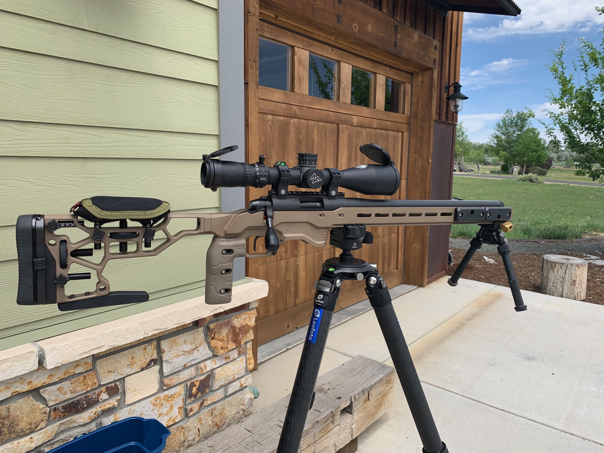

Got it all set up. Should I loctite the threads on the bolt that holds the anvil to the tripod? Pretty impressed with this setup RRS Anvil was as expected, but the tripod exceeded my expectations. Lot of tripod for the money. Wow!

@Redfisher60 Any issues with the anvil coming loose on counterclockwise pressure with the lack of the set screw engagement?
Yes and no. If everything is locked down hard it will loosen. But the idea isn't really to lock down the lever on the Anvil, but to tighten it to a point that allows a little movement. Also the plate that sits in the area where the bowl would sit can be tightened or loosened, I again keep that tightened to a point where there is significant drag, but it will turn.
