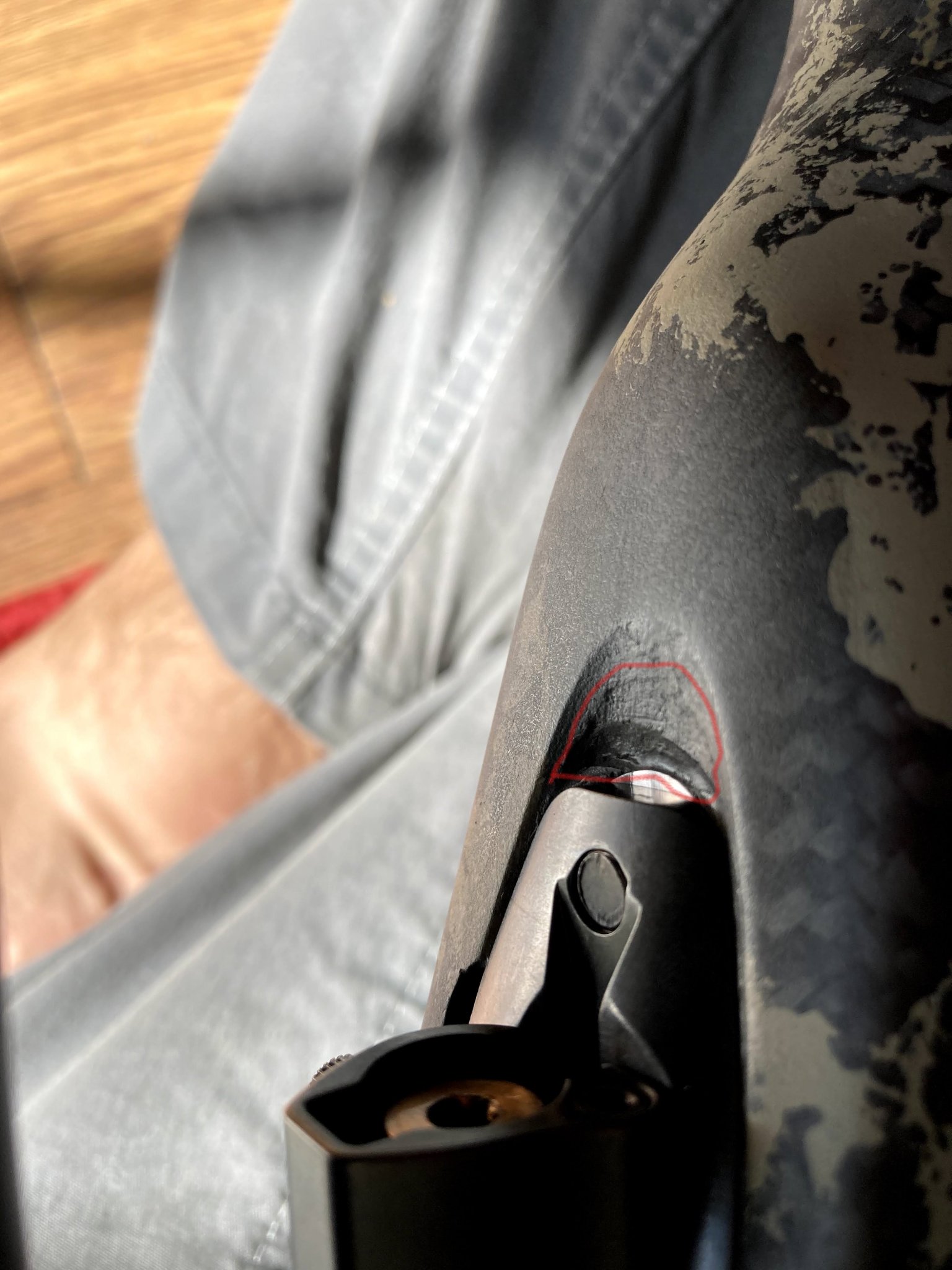

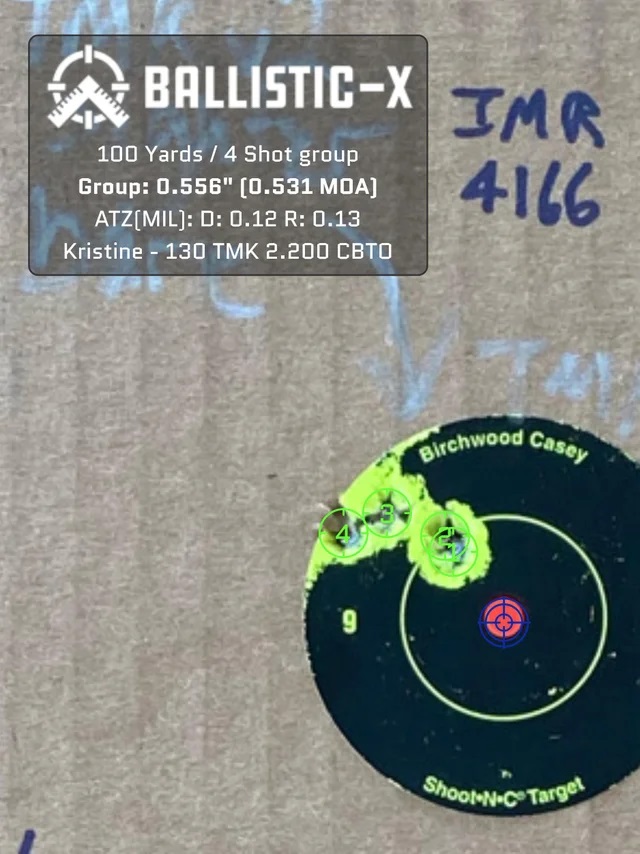

Looks like I'll be testing just how much bedding matters to my rifle project here over the next few outings to the range. The bedding didn't survive the first 45 rounds intact, sadly. If I were a betting man, I'd bet that the disappointing targets that comprised rounds 26-45 were the result of the bedding breaking/pinching under the action. The ARC Nuc doesn't have much of a tang. It looks like the Nuc's chunky butt just absolutely wrecked the bedding. You can see the pillar sitting underneath the bedonkadonk and with the action pulled you can see its outline. Interesting learning point there (for me, anyway). I also had to clean up the bedding around the recoil lug. It looks a little rough, but might just be functional.
The horror!  Oh, the humanity!
Behold... there used to be bedding under/behind the tang... no longer.

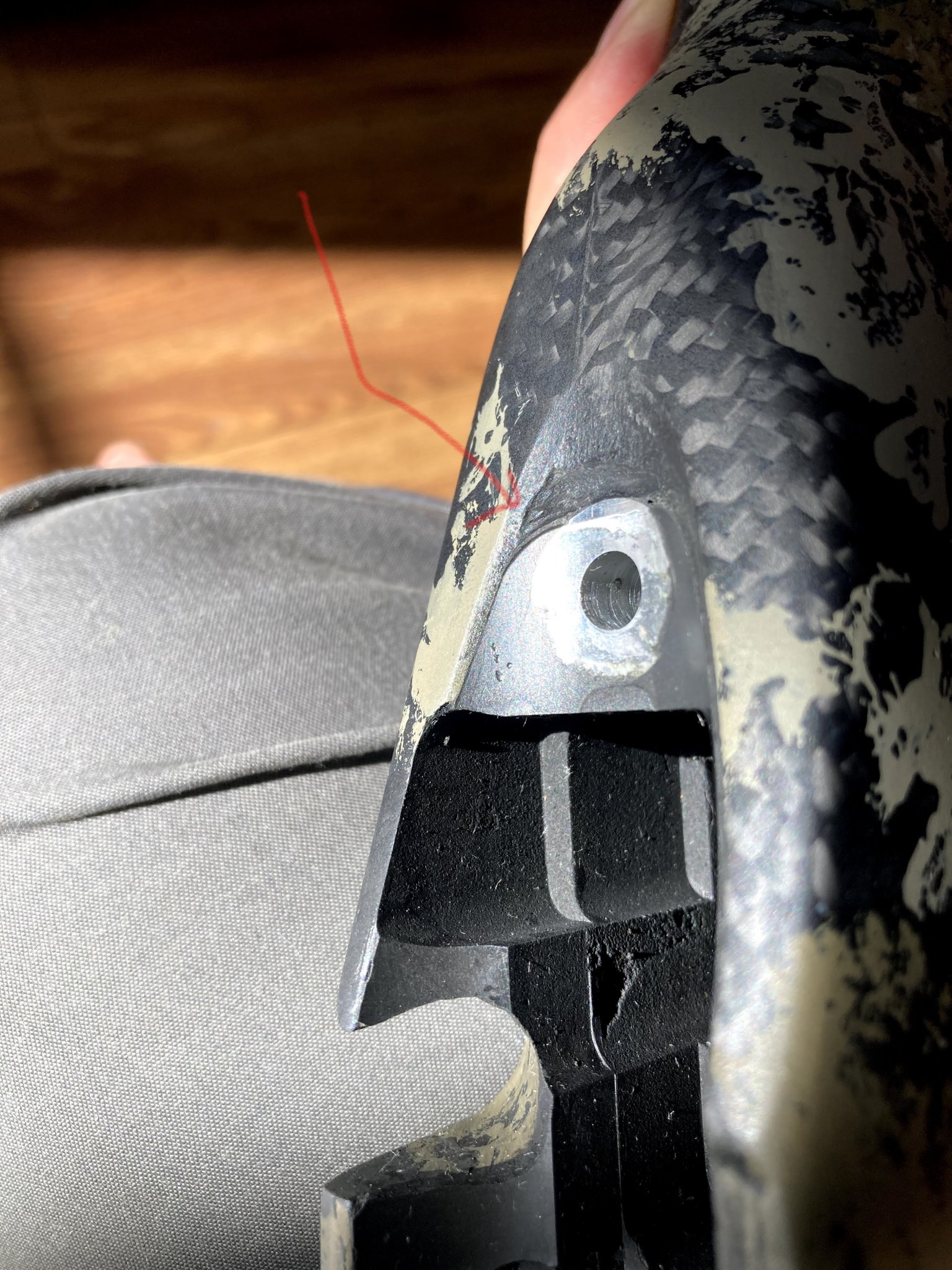

Looks like bedding was pretty thin in that area and cracked. Skim bedding is fine, over aluminum, as long as bedding is sandwiched between alum and action. That area should have been relieved more for a thicker bedding pad. I guess it's also possible that to much hardener was used and made it brittle.

Call me stupid but, could you draw some arrows where the bedding is bad?
From what I can tell it looks normal?
I'll see if I can fire up my sweet MS paint skills sometime tomorrow. It's a shame I don't have a before photo...
You can see where the texture changes and there's a big step/divot/gap. Originally, that was filled with bedding. The bedding extended to the rear of where the tang would be on a longer action.
The change in texture is more obvious here. I would guess the ass end of the Nuc acted like a 60 ksi hammer and that was that for the bedding bedding it.

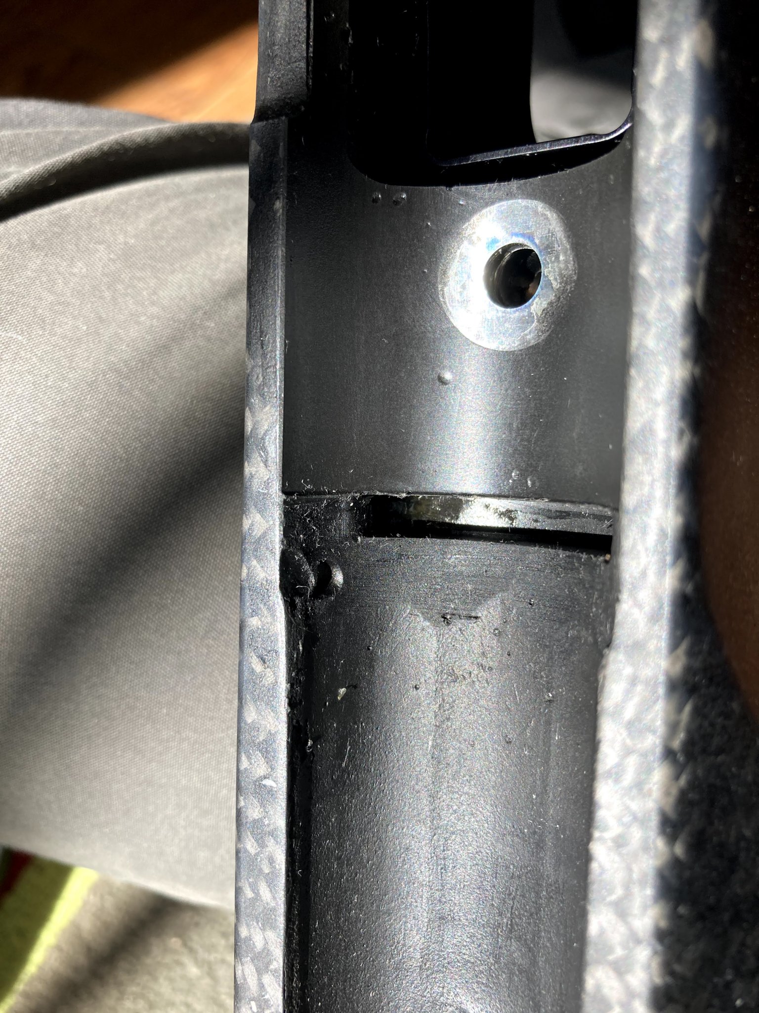

That broken bedding is superficial and doesn’t affect accuracy. The area should have been clearanced to allow some vibration. I’d be a little more concerned about the chatter looking marks where the bedding is broken. Looks like multiple impacts, like the action is loose. What’s the recoil lug area bedding look like? You said you had to “clean up” the bedding there. Can we see a pic?
You can't have the bedding contacting the back end of the action. If you want to recess the tang inside the bedding, you have to leave a gap between the end of the tang and the bedding so it won't break out.
Reactions: Vodak
The action was only loose if 60 in-lb qualifies. The action sits primarily on the pillars if the finish wear is anything to go by.
This was a before pic. I didn't snap an after... at least not that I recall (or see uploaded).
Indeed, and one would assume that if you do this sort of thing professionally and command a premium for said service such a thing would be known. In this case, one (me) would be wrong.
The rifle double groups, so that's that really. Minor cosmetic shit that no one but me is likely to notice isn't a big deal. A rifle I don't trust, on the other hand...
