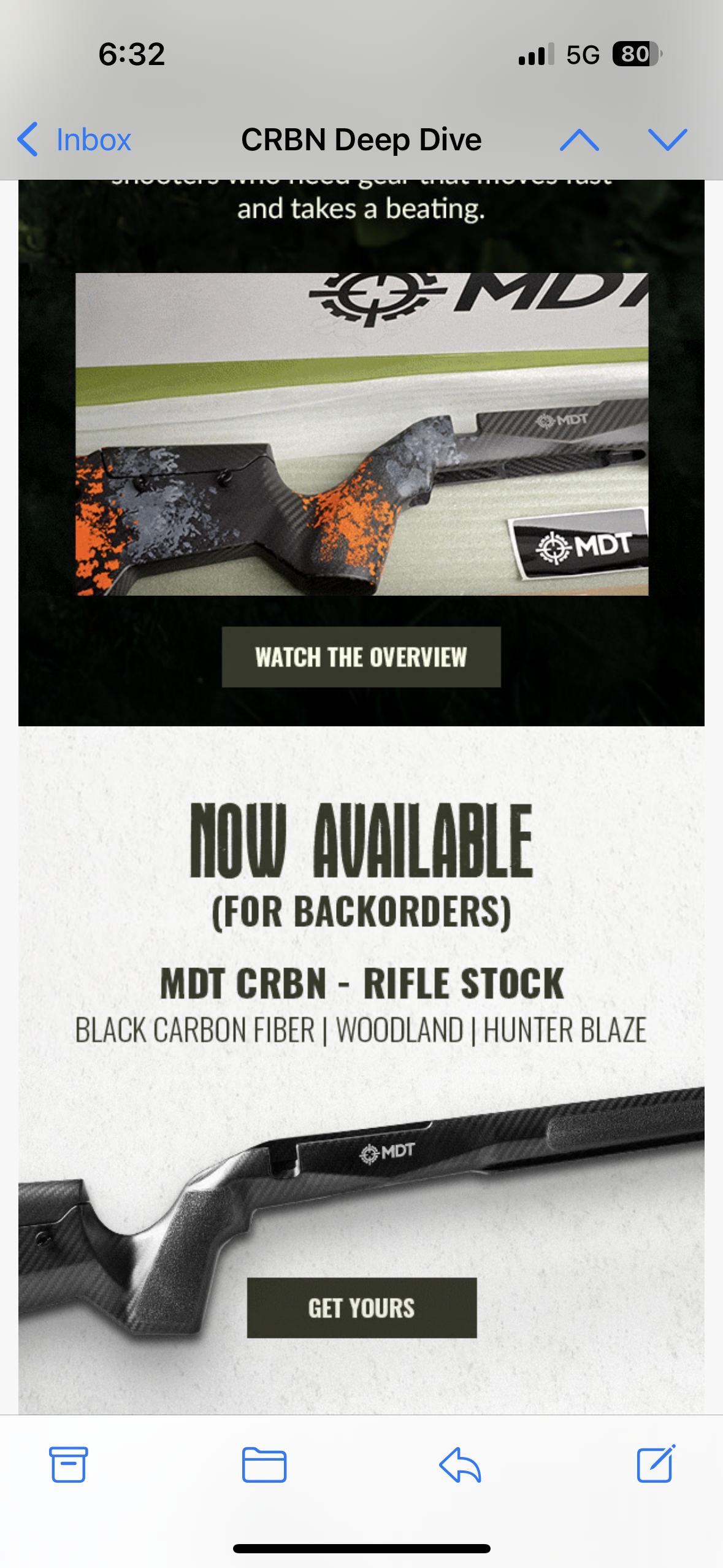

I have kind of been jonesin for a MDT CRBN too..

That's not new, they've been in peoples hands for over a year.
Interesting, they sent me a email today saying they were available for back order which made it sound like it was new.
How are they?
I have a McMillan carbon fiber game warden on a 300wm Tikka I like it. Just now I am waiting to get it back from JDusco getting my check riser hardware installed. It’s been a minute.
How are they?
They're a decent stock, the slightly swept grip for some might take some getting used to if you're a vertical grip guy. I'd preferred a completely flat forend to the barrel channel, at least the bag rider interface in rear is parallel to barrel. They're not the lightest, a Hnt26 will prob finish 4-5oz lighter and fold but the Crbn has a lil more forend length.
