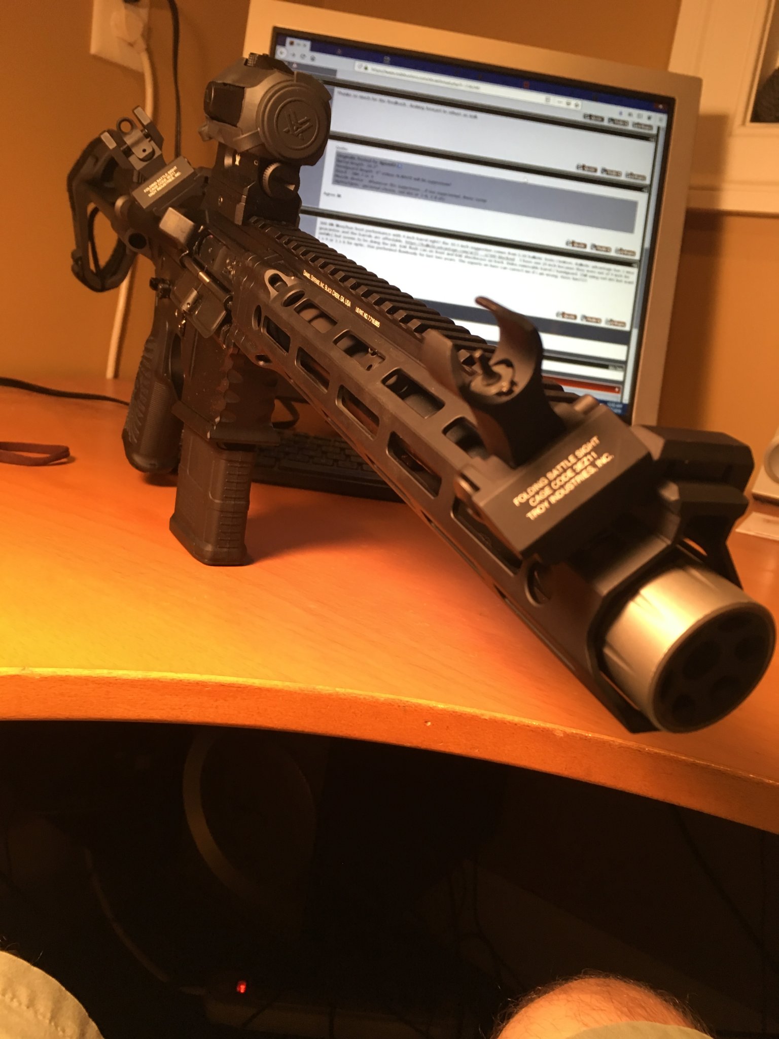

11" Heavy .950 to carbine length .875 gas block with 5/8" x 24 muzzle thread. Going to wrap this with a 12" m lock HG with a SLR blast forward comp.​
Should be a fun pistol.​
I'll report back qhen I get it together.​
It will be set up very sim to my 300BO pistol pictured​

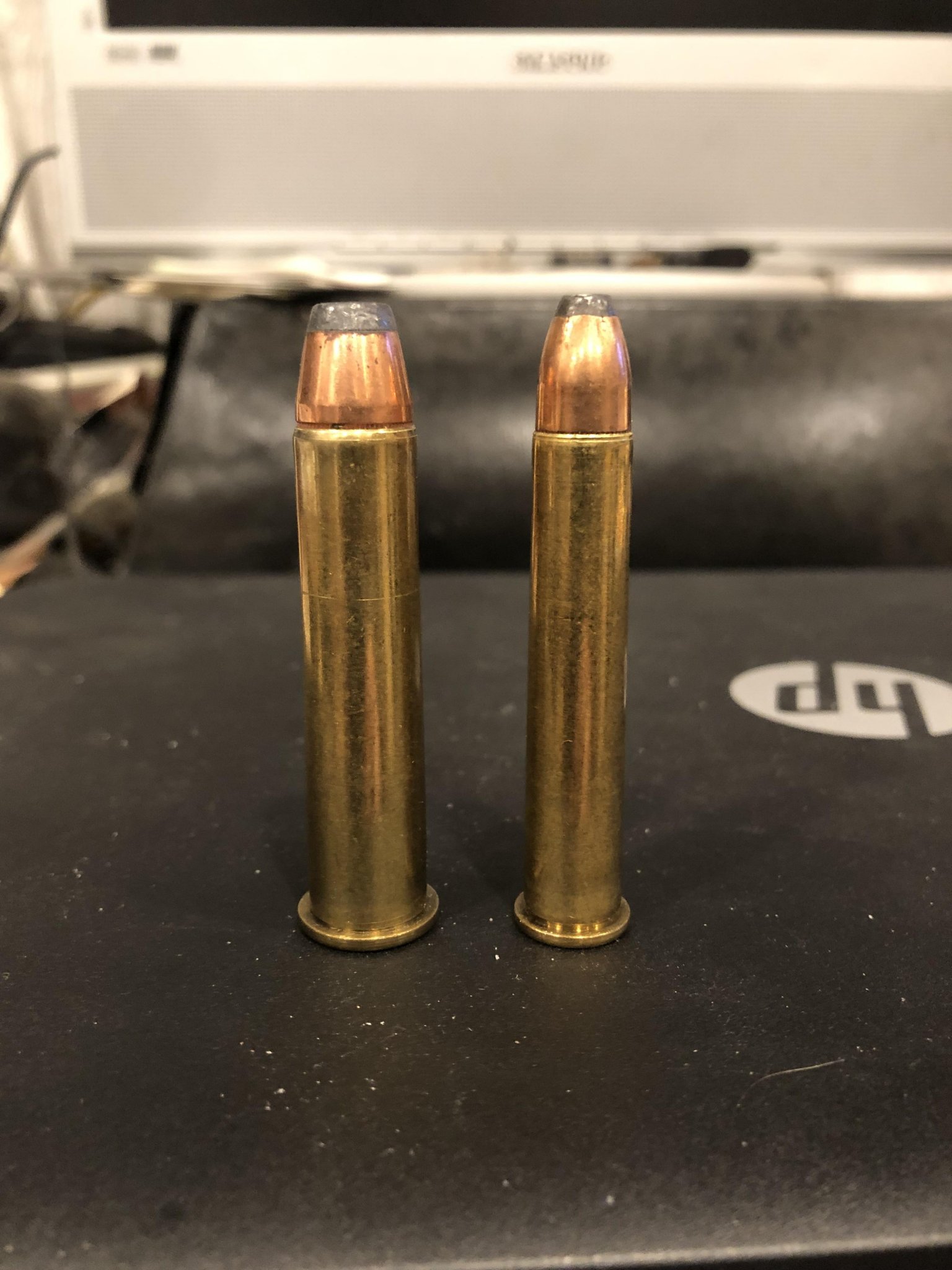

I keep seeing this cartridge in a bunch of applications and firearm. I see it as a 9mm Mag/Rimless 357 Mag-ish cartridge.
Put it in a .350 Legend Automag-ish Handgun, .350 Legend Lever Gun, Ruger 350 Legend PC Carbine, a Moon Clip Revolver. and yes, an AR.
Just wingin' it...
There is a decided lack of bullets that can expand at the expected velocities. That should change quickly, maybe even by factory sizing .358/35 caliber rifle bullets down to .355/.356. Some already available ones could work. New bullets, specifically configured, are already available.
I'd really like to see a .355 180gr Gold Dot with the right construction for the .350's velocities. I'm thinking PD with some whack!
What would be the downsides of seating a longer ogive deeper in a straight wall cartridge ala the 7.62 Nagant? Might any of those downsides be mitigated?
Many users of this caliber (7.62 Nagant) handload their own ammunition, though the proper brass cases are also expensive and difficult to come by. However, Starline has been developing and perfecting brass for the cartridge, and handloaders have had success using dies for the .32-20 and .30 Carbine to handload the rounds. 32-20 brass cases are inexpensive, readily available, and can be reformed and used safely in guns chambered for 7.62×38R, but the resulting cartridges are too short to achieve the gas seal. Cut down 223 brass reformed in 30 carbine dies can be utilized to load for the Nagant also. These will achieve the gas seal, but case rims will be undersized.
Three other cartridges—.32 S&W, .32 S&W Long, and .32 H&R Magnum—will also generally chamber and fire in the revolver, but will not achieve the gas seal. The case head of the .32 S&W/H&R is about the same size as the case diameter of the Nagant cartridge, so the case head will sometimes actually end up moving into the chamber, thus preventing an adequate primer strike. Due to the dimensional differences between these cartridges and the original 7.62×38R cartridge, this practice is done at the shooter's own risk. The .32 H&R Magnum in particular develops much higher pressures than the 7.62 Nagant or either of the .32 S&W cartridges, which are both late 19th century developments. The most common anomaly when firing these cartridges is bulged cases.[4]
Looks like Starline is doing something somewhat similar in .308 diameter. Would .355 be such a huge jump?
Not looking to achieve anything like a gas seal, but putting some taper into the case mouth might improve feeding. .350 Legend Auto, anyone? Forget about a Collet Puller...
